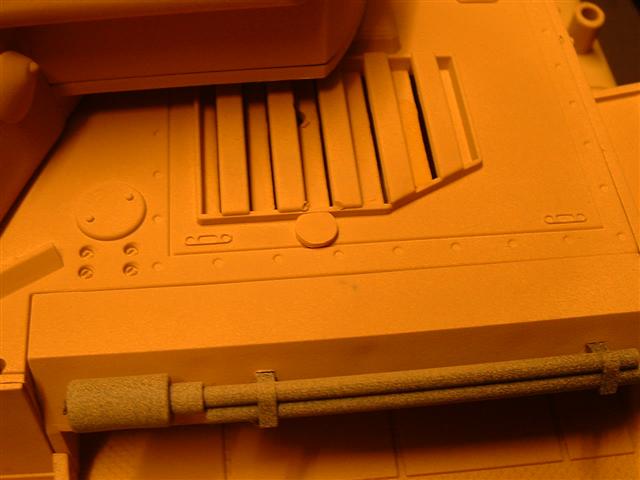

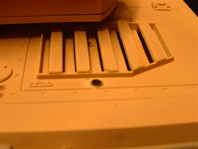

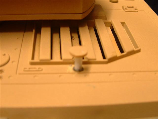

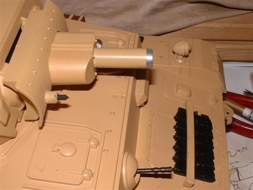

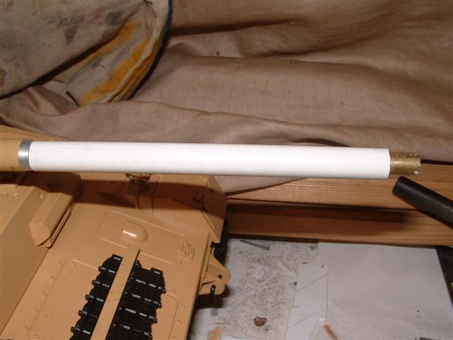

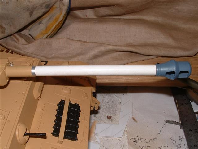

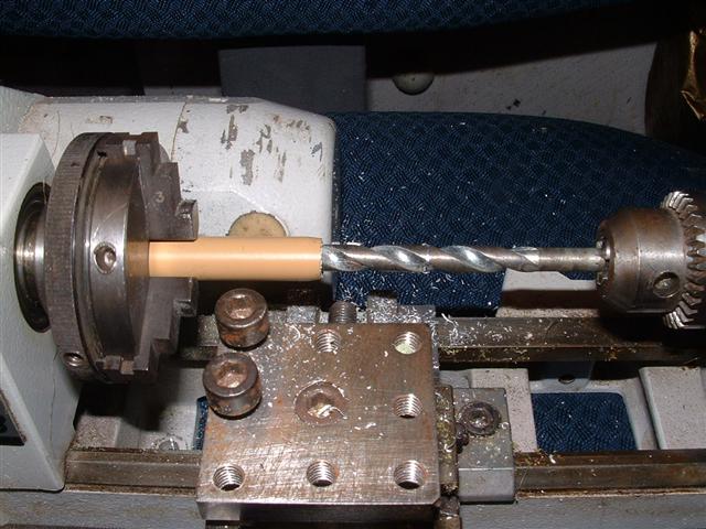

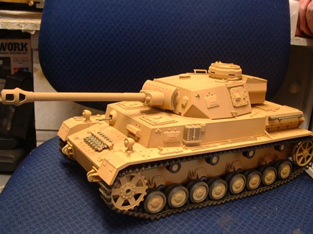

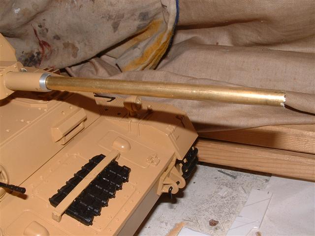

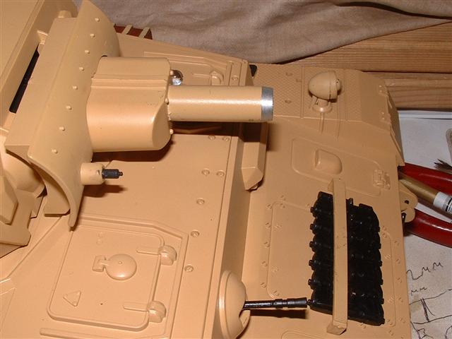

Hello Folks
A couple of pics of my Panzer 4 now with the scratch built barrel upgrade thanks to Steve
( jukebox) for the info on length etc.
Now painted in DAK yellow to go with my DAK Tiger which I have just about finished.
The panzer 4 has to be totally weathered yet and detailed but its comming on.
An interesting mod I have done is to add a smoke unit filler, this was very easy to do as the standard model fills through the exhaust and is a nightmare to do as the oil goes everywhere.
As the smoke unit on this model is off center All I did was to drill a hole into the top of one of the outley pipes and extend this with brass tube and silicone tubing up to the hull again brass tube into the top hull and a bung made from plastic card, see pics.
Regards to all Sub.

Overall, it looks good. A couple of questions:
Which Ausf did you build? I can't tell if it's a G or a J from the photo. And, is that just the Tiger 1 muzzle break? Wonder if that would be correct for both ausfs...
Also, why add the styrene tubing to the copper tube? What should the outer diameter of the gun tube be?
Thanks.
Sub
Posts: 732
Location: UK
Re: panzer1V ausf f1. modification to later model
Post by Sub »
Hi.
It will probably end up being a J, thats the length of the barrel I chose.
By the way it is no where near completed there is a lot to do before its converted, I put the styrene tube over the Brass tube as it looked a bit too small but now Im not too sure but its easy to remove it just slides on, yeah its an old tiger muzzel brake from a spare tiger barrel i had lying about, it is simmilar to one I have seen on a late panzer 1V used by the Finnish army.
I am no rivet counter, and if it looks ok then Im happy.
The point of the post was just to show how easy it was to extend the barrel thats all and fit a smoke oil filling point.
I will refrane from any more pics till I have finished it.
Regards Sub.
