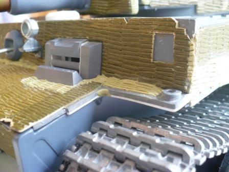

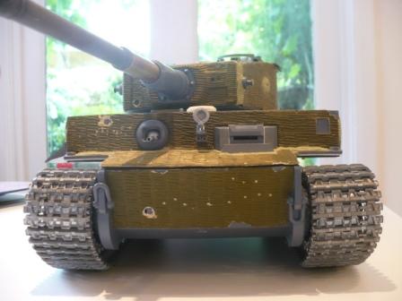

Of course you don't have to replace the missing mudguards - they often came off in combat or were left off after transport - although the rest of them will have to come off!
Personally I have always liked the look of the Tiger without the front mudguards - here's some shots of my work in progress.
P1040856 small.jpg (34.3 KiB) Viewed 3496 times
P1040828 small.jpg (40 KiB) Viewed 3496 times
As for metal upgrades, they are a nice addition but cumulatively can cost quite a bit. My advice would be to choose the ones you think you really need. The 'correction' of the gun mantlet, for example (by which I assume you mean turning it the right way up - the gun should also be slightly off-centre to the coaxial machine gun side but this is hardly noticable) is pretty easy to do with the Heng Long part and a little patience.
