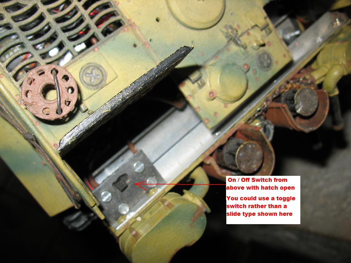

It's really the first three points on that list that will benefit me from an accessibility point of view. Assuming I'm able to get it all sorted to switch the tank on and get things rolling you'll unclip the top half of the turret, flick the switches and then pop the top half back on; with the same being true for turning the tank off. Alternatively I may try and simply move the switches under the commander's hatch; the downside being that it removes the ability to install a figure at some point but the big plus would be you wouldn't need to lift the top of the turret off. We'll see!
