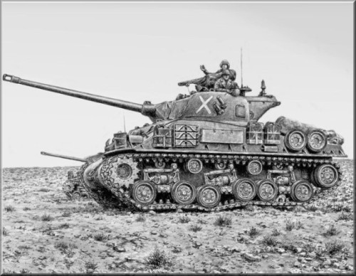

Hi
Found this on the net
if it helps
Jon
if it helps
Jon

hi Jon thats a great drawing you found there,Israeli Super Sherman,I wish money was no object and I'd have the new Tamiya one,but the price,considering the kits running gear goes back to the old 80's kit I assume,as Mr Tamiya is not shy about recycling old stuff and selling it for top dollar,but I do like Israeli armour,the way they upgrade old designs,how about a Centurion Mr Heng Long,you could give us Brit,Canadian,Swiss,Aussie,Indian,Israeli,and a few others,making a lot of people very happy,

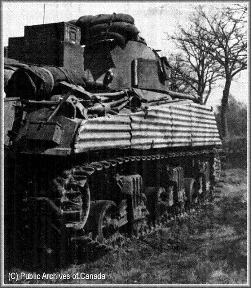

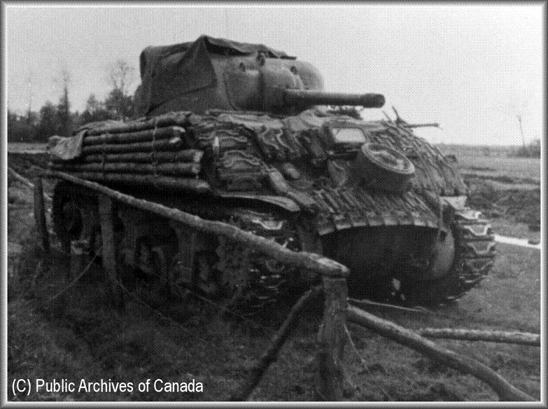

Hi
How about these then
Jon
Jon
