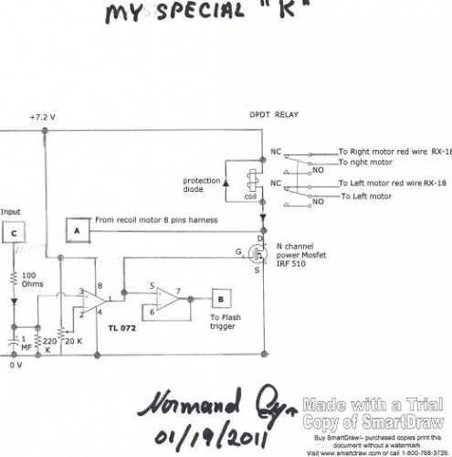

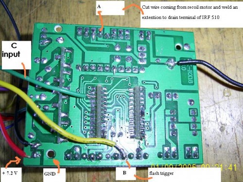

Found a way to use the " K " button to do more than just the sound and the annoying track recoil ...
I modified the schematics of an home-made anti tracks recoil system to have the K control to actuates all the functions of the gun firing : ( recoil , flash , sound , smoke and anti tracks recoil ).
It allows me to free the upper left control for something else ...
Here's a short video ans some pics ...
