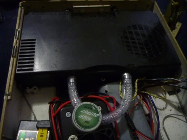

Ok, here we go.
After getting there new smoke unit from Rccommand I wanted to put it into the Tamiya Tiger1 WITHOUT changing the way the Tiger fitted together, ran and sounds.
This is what I did to install there unit and still retain all the good things about the Tamiya tanks.

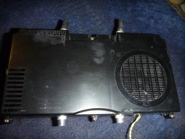

After deciding where to place the unit I then had to work out where and how the smoke was to be plumbed to exit through the model exhaust pipes without removing the sound box for the speaker.

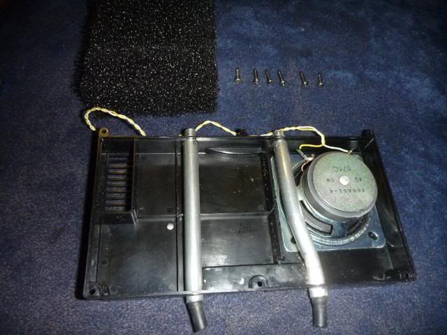

What I did was mount 2 pipes running through the speaker box.

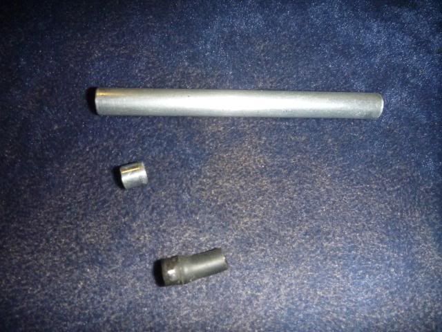

I used alloy tube that I had lying around.
I marked the box and drilled the holes to match up with the exhaust outlets. then I placed the tubes through them. One of the pipes had to be dent to go around the speaker

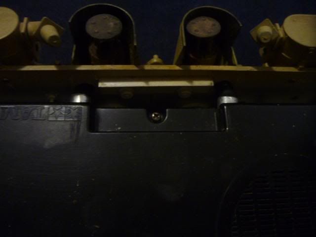

I then drilled 2 holes in the rear wall of the hull where the pipes run into the exhaust stacks.
On one end of the pipes I added some smaller pipe to fit the plastic tube that comes with the unit and on the other end some rubber tube to go through the rear hull wall
I then put the speaker back into is original spot with the new tubes going into the exhaust pipes

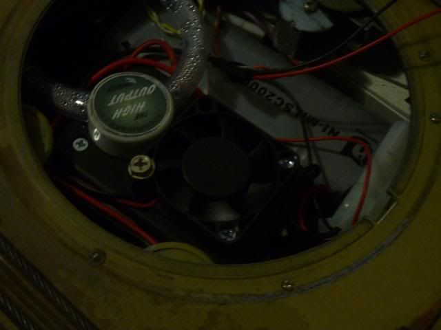

Then I connected the smoke unit up according to the instructions that Rccommand sent with the unit, filled it with the fluid and turned it on. I worked very well straight from the start. By now I was VERY happy.
Next step was to install the hull top and check for any problems. None at all. Fits very well and sit on top of one of the batteries
I then mounted the turret, tested for any binding or tight spots and again no problems
So what could I do but go outside and play See video above
One of the best additions to my Tiger, looks and sounds great now. Money well spent
