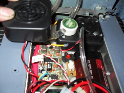

The transmitter idea works well for me,4 tanks two transmitters. Here is the smoker you asked about as well. Blake
Tiger Asiatam hull with Super Smoker
