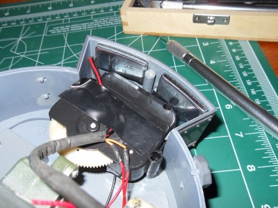

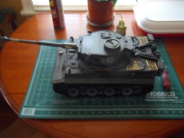

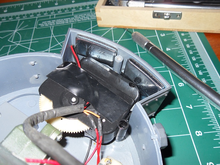

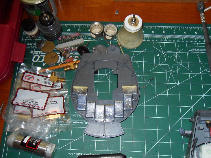

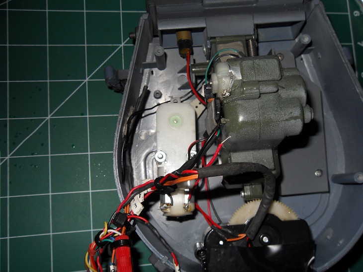

I'm at about 20.8lbs,this was achieved by several things but mainly due to wheel weights with adhesive backing placed in different location in my tank.It has a positive effect on my Tiger,it move better over objects the control arms moving first instead of the hull just riding over the object.The Asiatam hull had very stiff springs originally,causing my Tank to ride high,but progressive additions like tracks,metal sprockets,heavier gun turret with metal barrel.and a few other metal parts still left me with a rigid movement.The added automotive wheel weights was the answer,they are easy to place and once in position are very difficult to remove.These can be purchased from Harbor Freight for a few dollars depending on the oz.rating.Also they help my turret to be more stable as they cause the turret to rest on the turret ring eliminating bounce effect of my Tamiya barrel which due to being airsoft is a bit longer than scale.They work well under the fenders inside the tank over the tracks.
Bottom turret plate
Bottom turret plate
storage bin weights
storage bin weights
Airsoft turret w/recoil and Tamiya Barrel

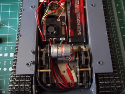

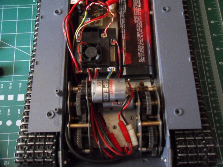

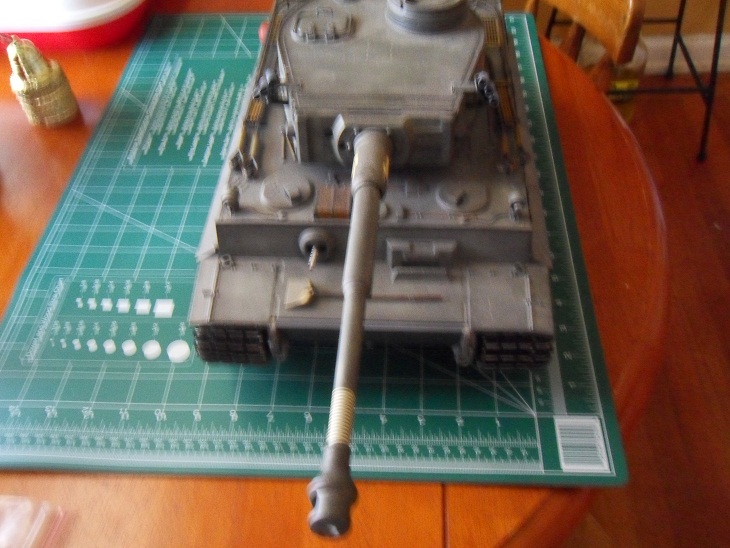

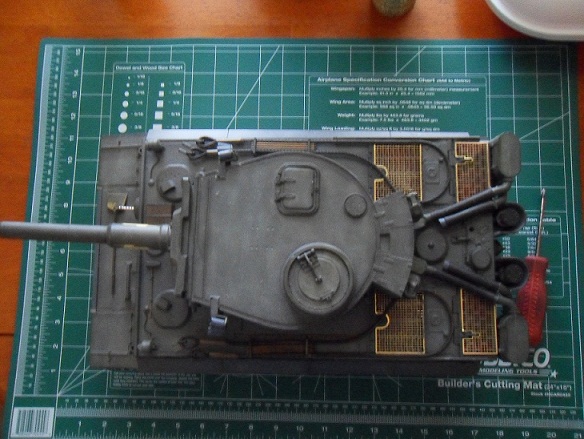

I have the best I could find.Asiatam lower metal hull,steel axles,metal tracks and sprockets,Graupner speed 400 motors with 12 tooth pinion driving the older steel Asiatam 3:1 gearbox,super fan cooled RX-18 WITH DUAL FANS elevated,3300mha battery.All contained in the Asiatam hull with a Creeping Death turret with modified Tamiya Barrel w/recoil and a VS airsoft gun.
