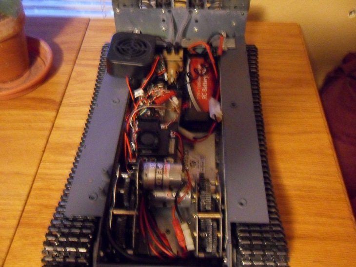

nice work on the internal layout on your tigers hull
Re: Asiatam Lower Hull 1 year later
Thanks Stew,I worked pretty hard to get it organized.Blake

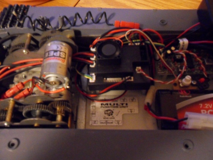

blake what size Graupner motors did you use, I ask because I want to replace the motors in my HL tiger and pzIII
Graupner speed 400's with 12-tooth pinion gear.Had to make a spacer bushing because the pinion gear drags on the large gear.I did try speed 480 motors first but they require boring the gearbox frame as they have a larger output shaft facing,and would not mount flush.The Asiatam gearbox is different and the stock H/L Metal gearbox does not require the spacer bushings to offset the motor.Phil sells these motors with the pinion gears but he says they mount flush.Also I cannot praise these motor enough,they have all kinds of power and torque,I have connected a cable between my Tiger(24lb) and my stock Jagdpanther with H/L gearbox and at full speed with tracks spinning the Tiger will drag the Jagdpanther backwards.The speed 400's are great.I also have double fan cooled RX-18 as they do pull more amps.Blake Note:If you look closely at the second picture you will see a gap between the motor and gearbox,the spacer is just a bronze washer about 1mm thick which the mounting screw passes through,once tightened the motors are rigid and have never been a problem. Cheers
