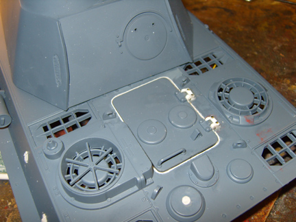

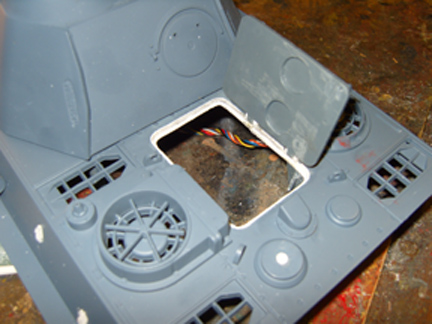

rear hatch can be removed and hinged to open

Hi jrc, did you use the thread method?
Thanks.....Nic
jrc
Posts: 387
Joined: Wed Aug 19, 2009 3:42 pm
Location: Ayrshire, Scotland
Re: rear engine hatch
Post by jrc »
I used a 1mm drill Nic
Ross
Nic.H
Posts: 270
Joined: Sun May 17, 2009 7:30 am
Location: South Wales
Post by Nic.H »
jrc wrote:I used a 1mm drill Nic
Ross
One steady hand there... :D
Nic

I cut round the hatch Nic with a 1mm drill in a dremel. I left the hinges on the hatch cover but sanded off the hinges from the rear deck. On the underside I attached some 0.5mm plasticard to form a lip for the cover to sit on. New replacement hinges I made again from plasticard.

Hi Jrc,
Thats a good way of doing it :thumbup: . I used a very sharp knife and to be honest wasnt over impresed . When My G comes I may try your method. On My Pantiger or as I like to call it now a Panther A . As its all been choped up like Gras. I also opened the front hatches , drivers vission block , escape /loaders hatch and the rear bins to.
