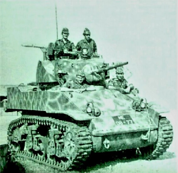

The Angolan liberation guerillas called them "Elefante Dundum", yes spelled "Dundum". Major Joao Luiz Mendes Paulo saw the need for better protection for the Portugese convoys in 1967, so fought with his higher ups for some tanks. He ended up getting permission to get 3 old Stuart's from a Portugese tank depot holding about 90 of them and some Shermans. How'd they get all of these Stuart's? They bought them from Canada!
In 1956, Canada offered up its old Stuart's it had bought from the USA in 1946 to any NATO countries that wanted them. Portugal was the only taker. Once in Portugal, some were put in use, while most sat in the tank storage depot. Here's the full crazy story, and if you see a M5A1 in a museum today, it might be part of that dealio!
https://canadianarmsandarmour.ca/m5a1-stuart/
The 3 Stuart's that were selected by Mendes were refurbished and sent to Angola. They were nicknamed "Milocas", "Gina", and "Licas". Their serial numbers are prominently displayed on the glacis so it's fascinating to see their changes over their service ('68-'73).

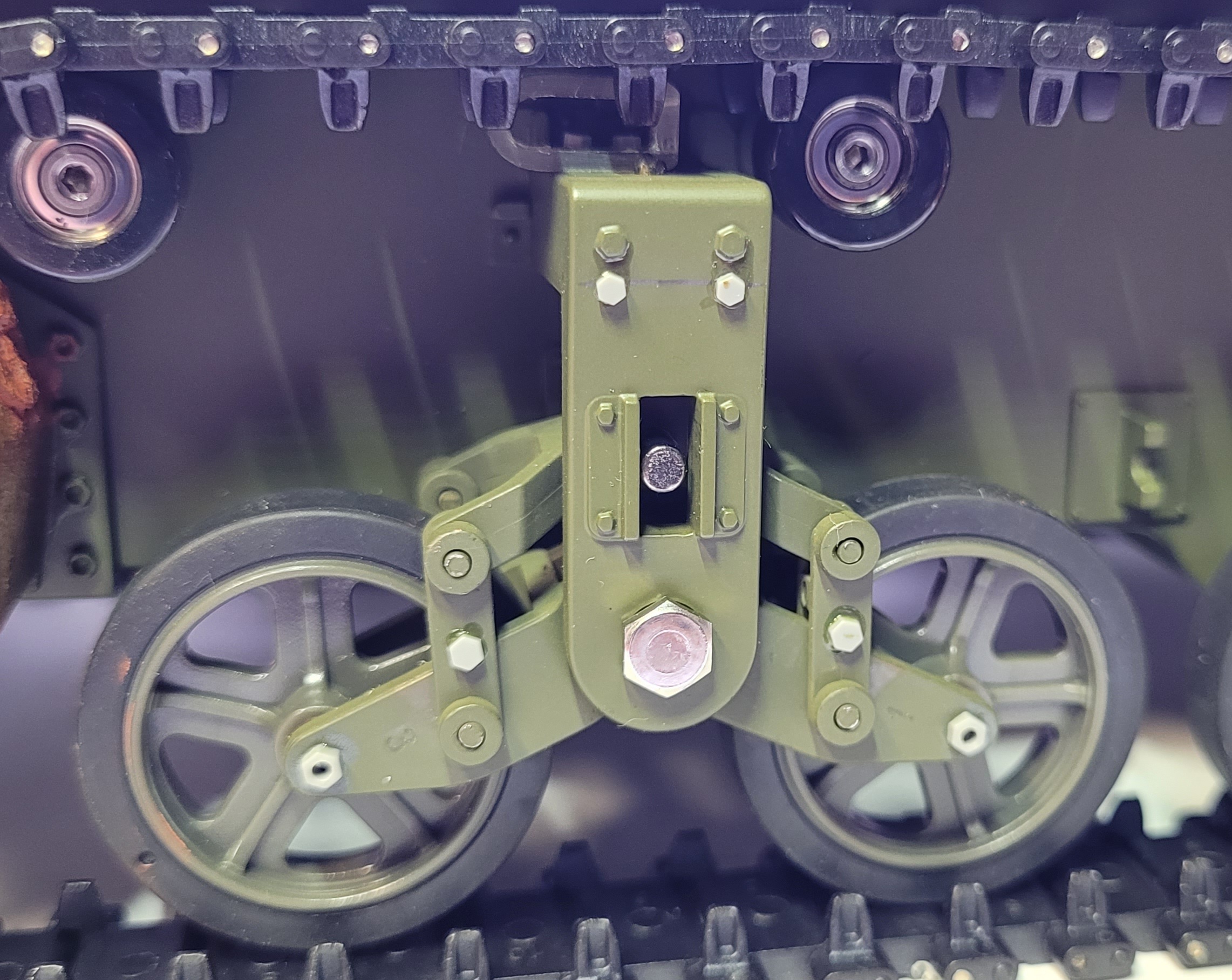

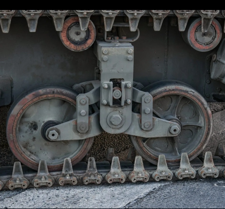

Figured I'll get the suspension sorted first. Coolbank's suspension is pretty crisp, but lots of missed details. But that's the fun so I acquired the usual hex head bolts everybody uses, plus added some boltheads to get things a bit more Stuartish. Anything not green is new.

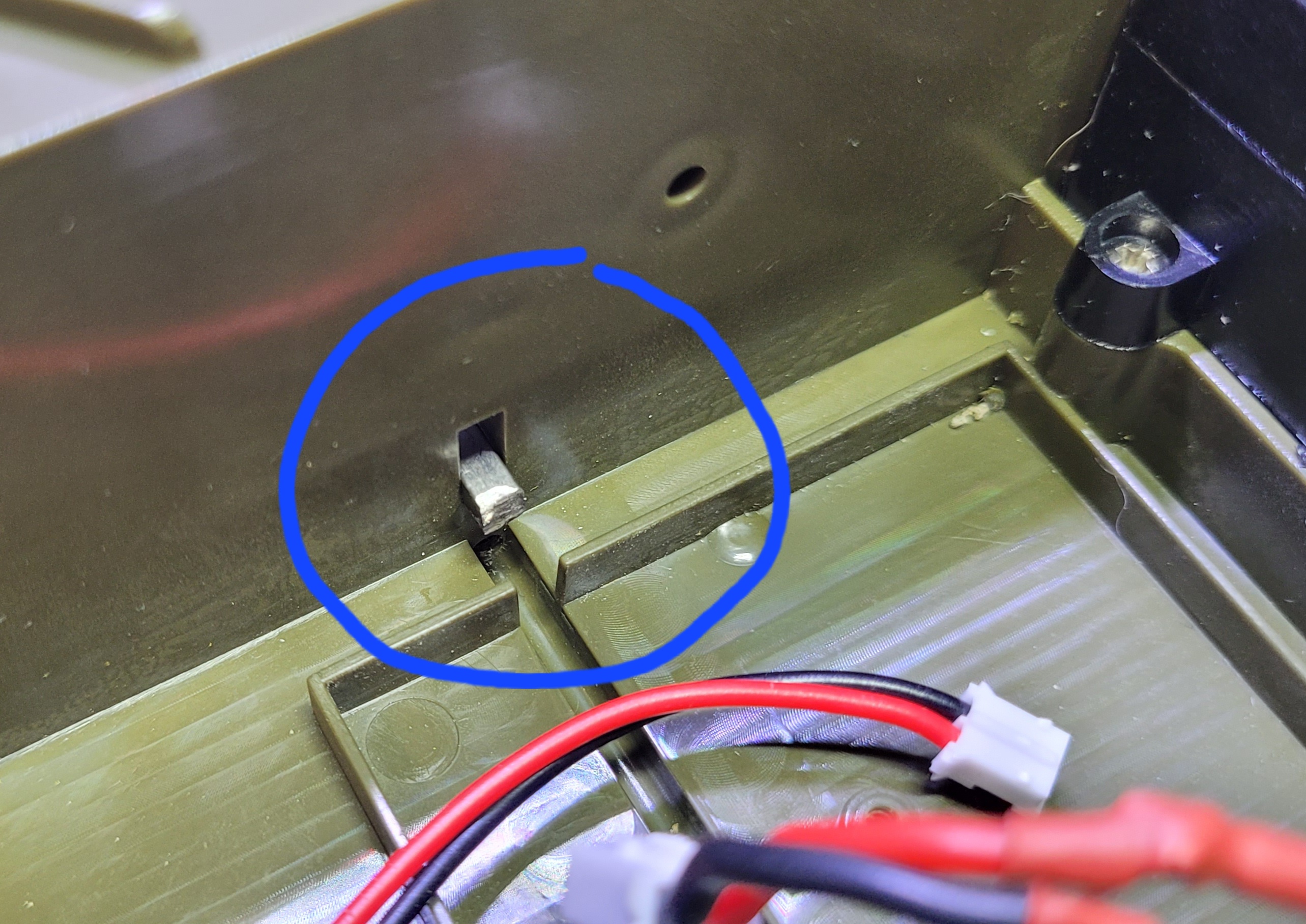

Ecam posted his excellent study of the ride height issues in his M5A1 build and used weight to make things right. I used small spacer blocks (2mm x 2mm) to get the hvss sitting at the right angles.
Hey, it also gets the bar in the middle of the vertical slot on the suspension to sit in the middle like on the real deal. Cut down the inner guide pins by several mm as well. I suspect Ecam's leadsled will ride more tank-like with the weight. Less-sproingy is the technical term, I believe.
Before--note the crazy angle of the vertical links, and also the Phillips screw for the bogies. I've noticed on many people's Stuarts that the phillips head is on the inside of the bogie arm
(tried an M1 bolt for the bogie axles but too out of scale)
With spacer blocks
An actual Stuart

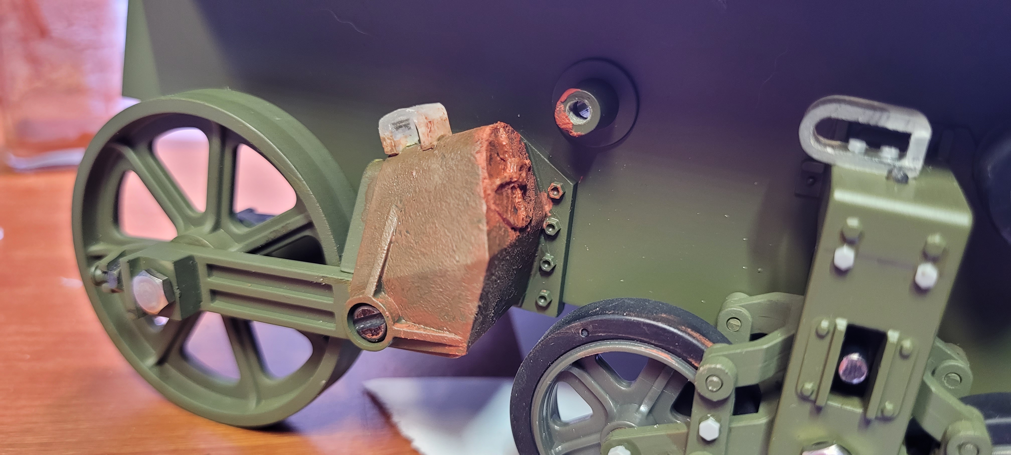

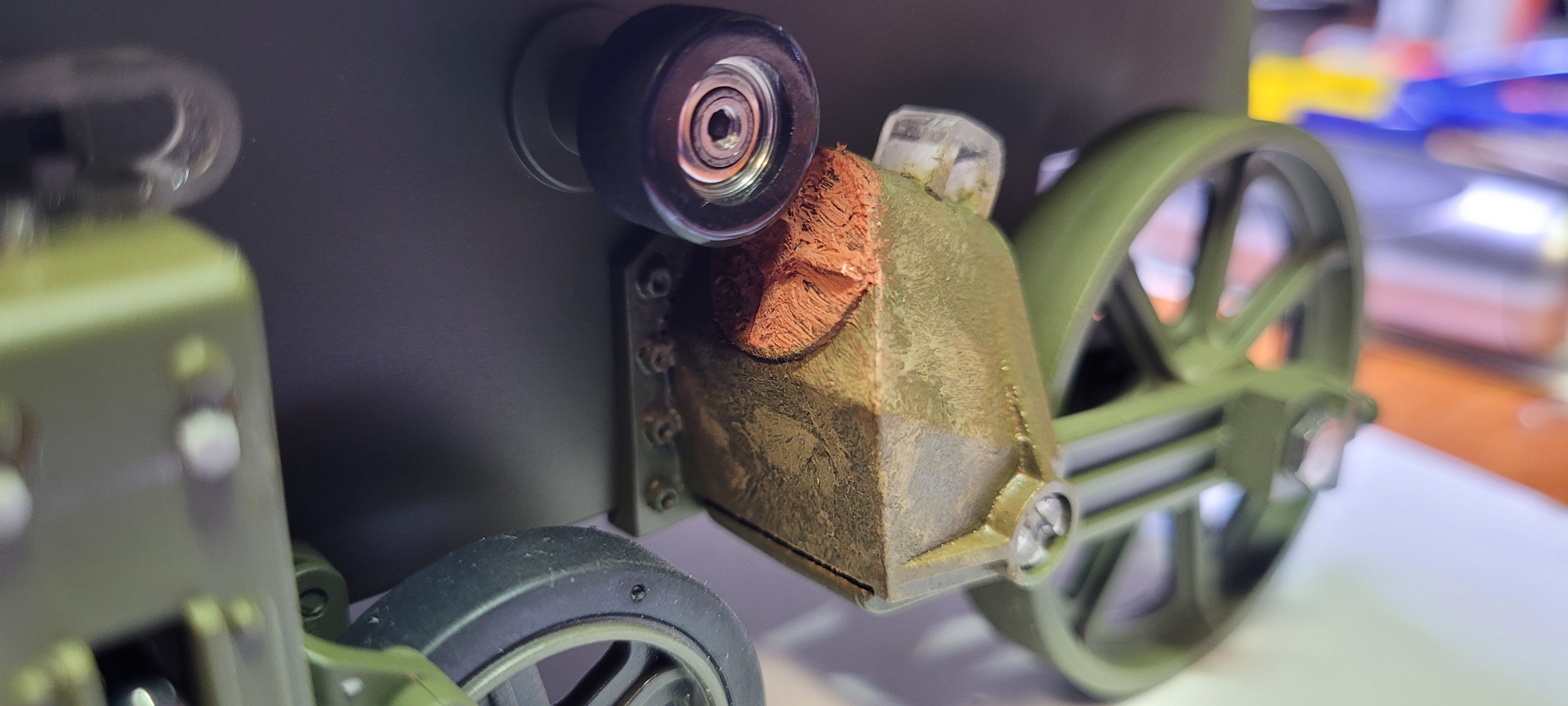

Since the Coolbank suspension is very simplified, I added the track skids on the suspension uprights and on the rear idler assembly. Thicker than scale but hopefully stout enough to put up with use.
And finally, the very plainly molded rear idler mounting got an end cover like the big boy tank and some cast texture.
