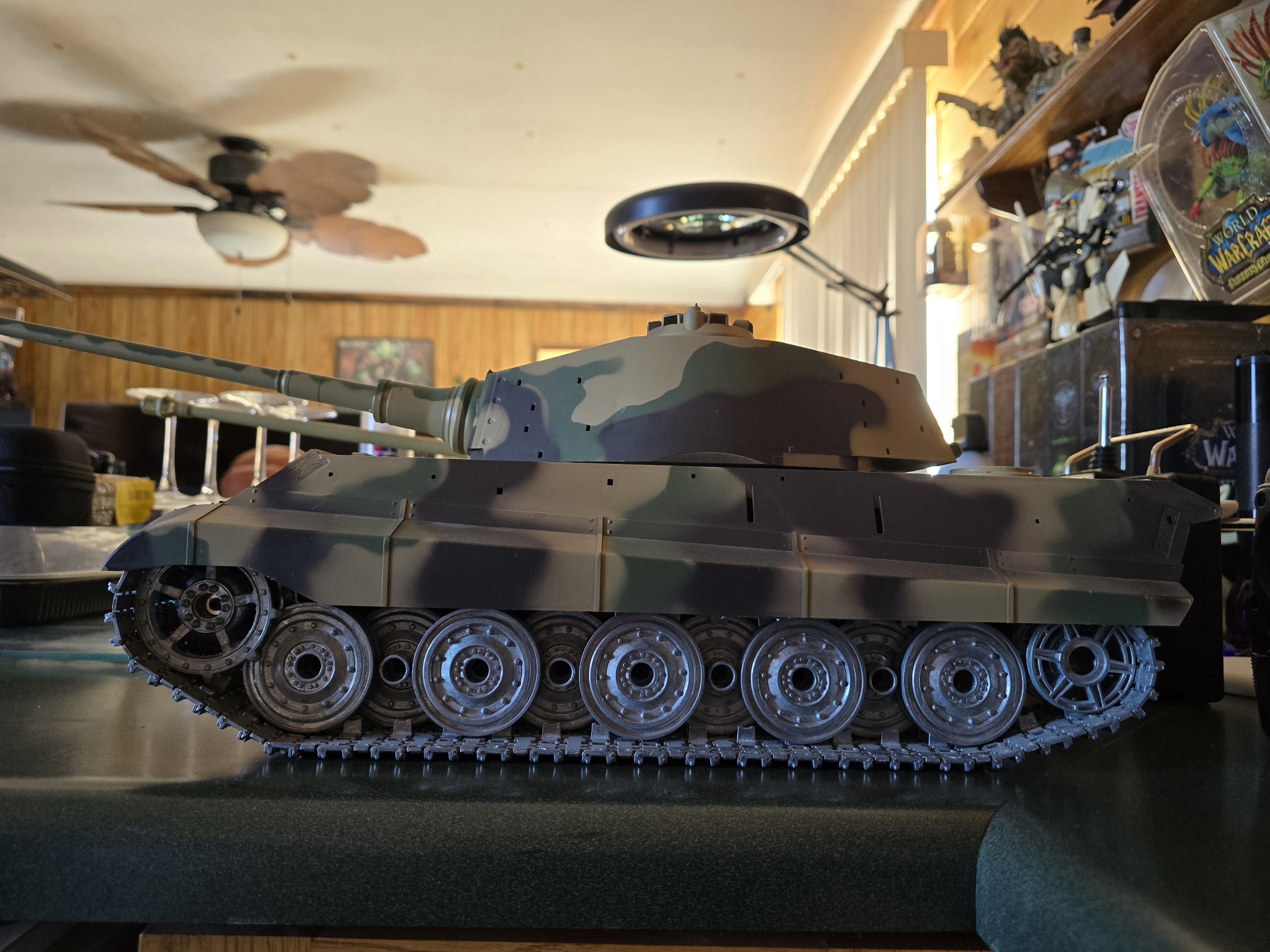

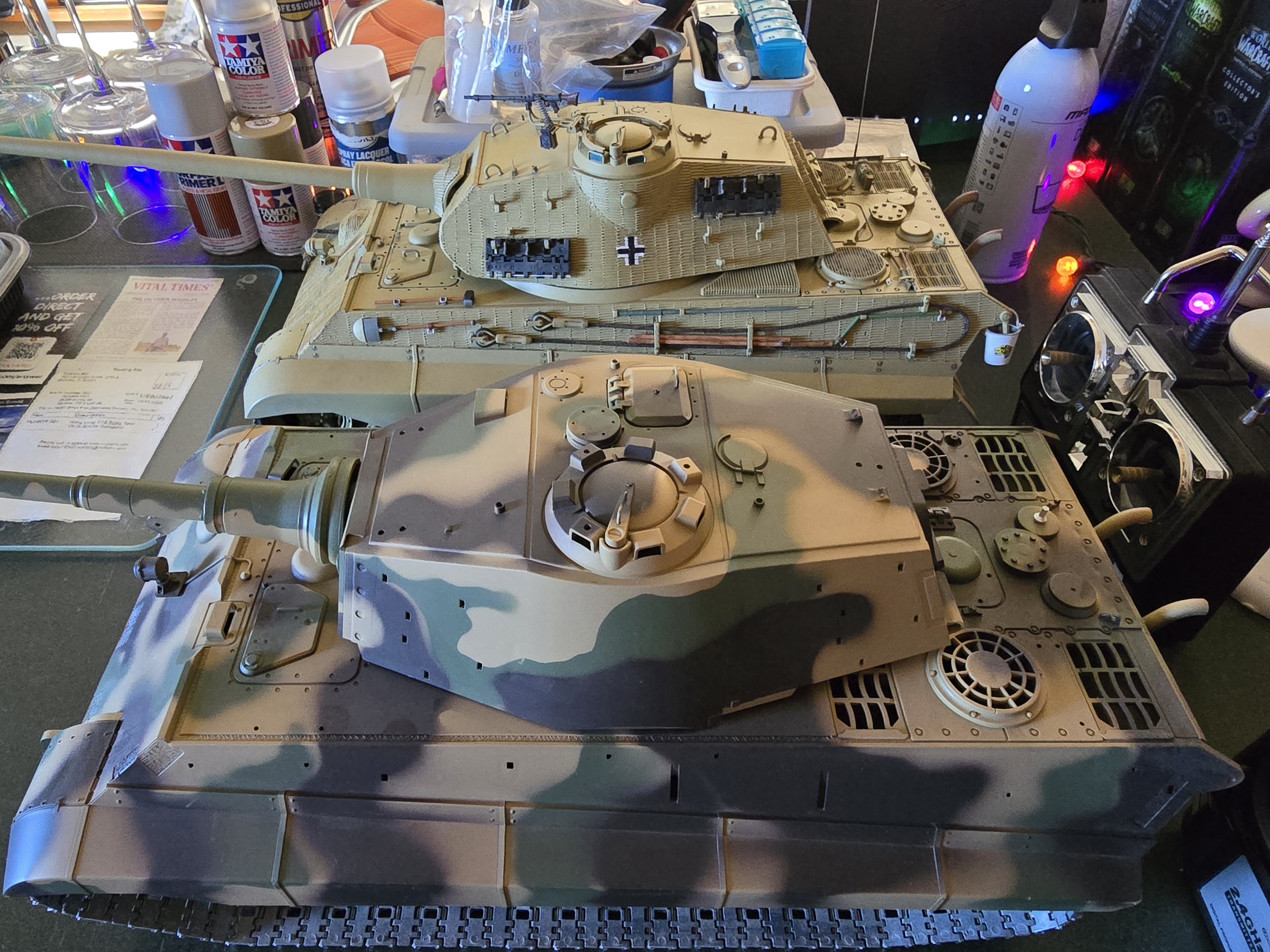

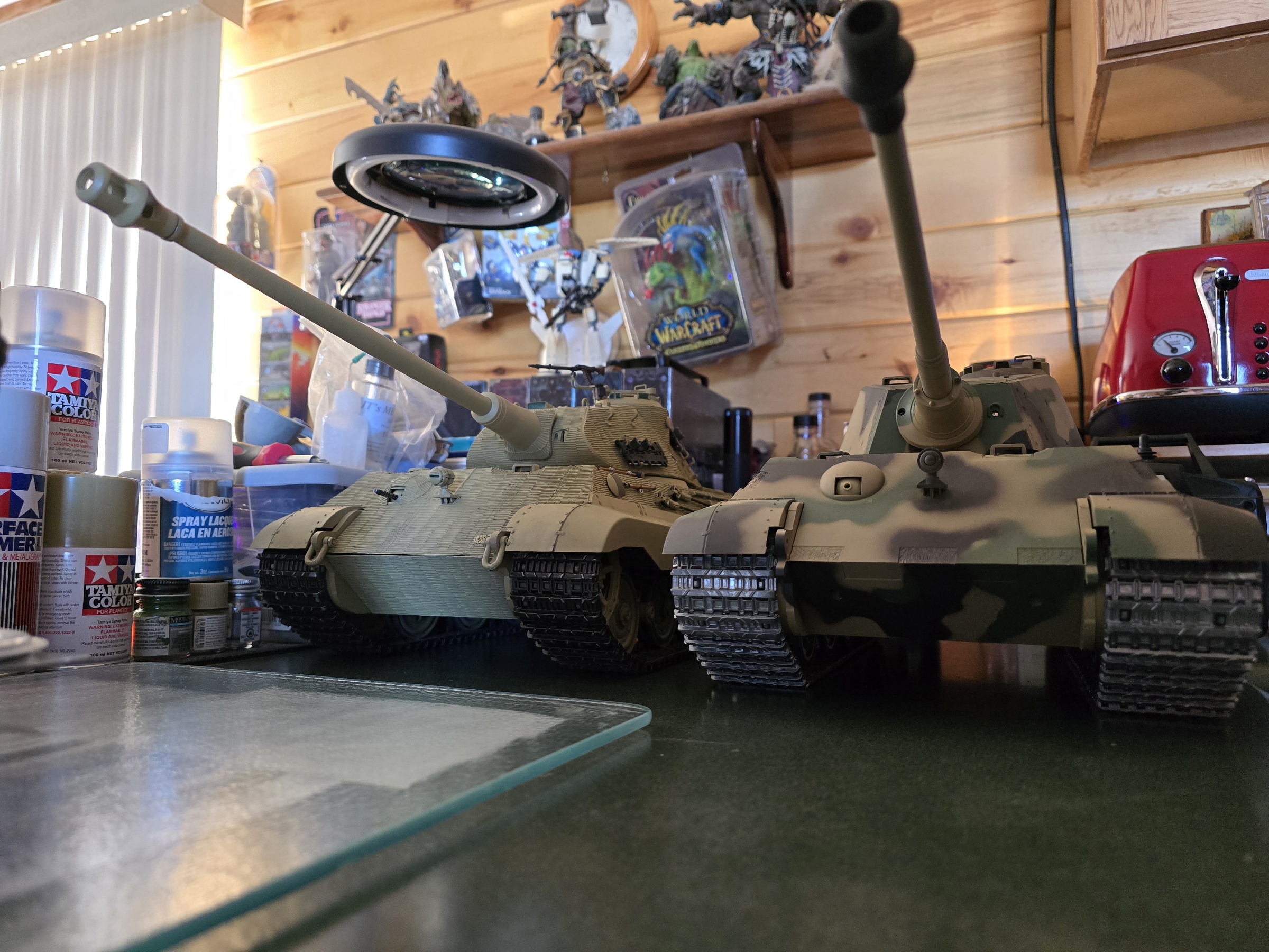

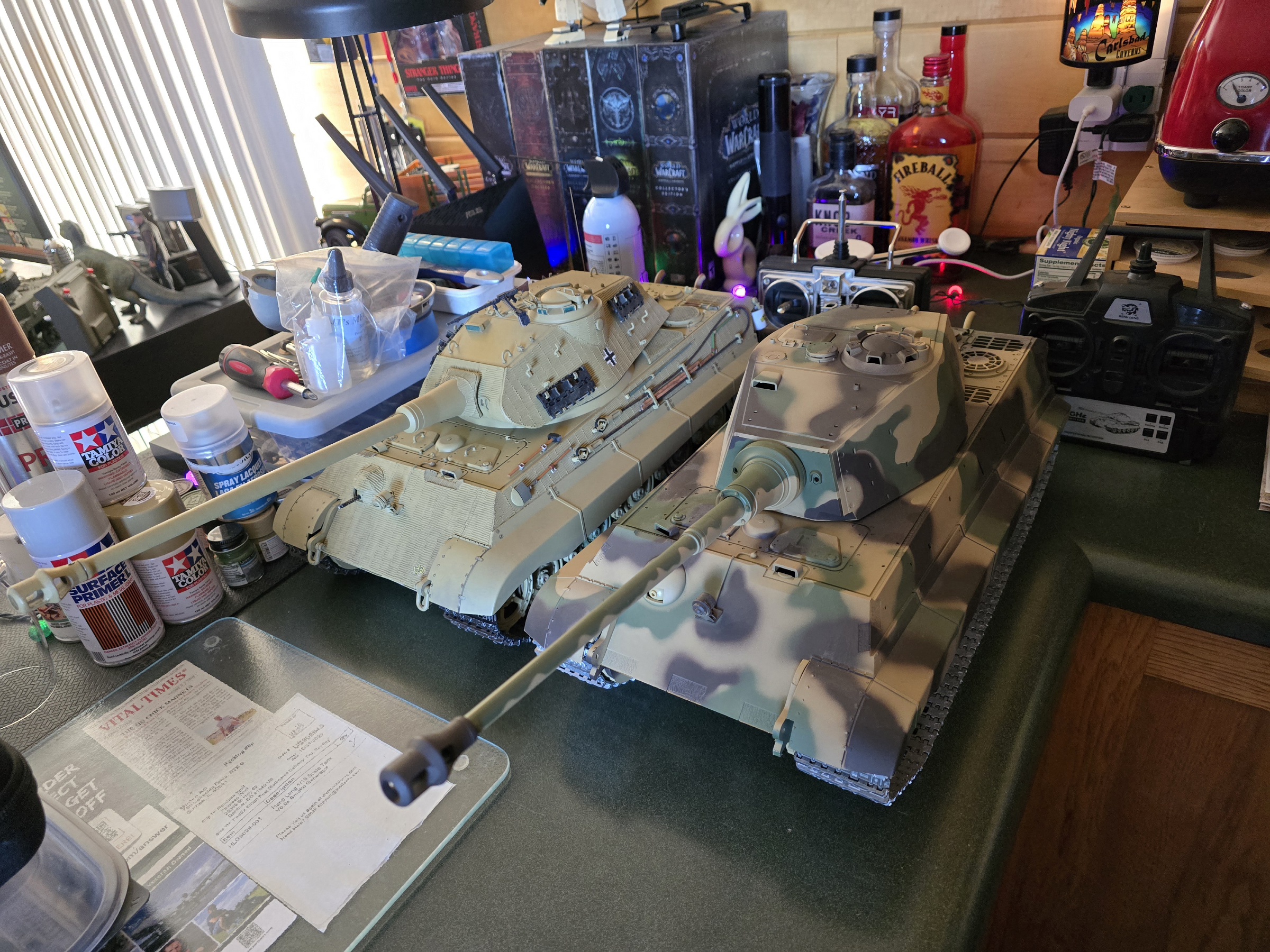

Good Afternoon!
First Post of Part Two of the once 'Winter' Dual Build. The Prototype Production Turret King Tiger has had the Battery taken out and is posing in the Spot where the new King Tiger was sitting in the Tank Room. I put a charged 7.4 L-ion battery in the new Tank and tested it again after a year + wait. Everything worked perfectly, Sound, Recoil, BB Fire, Smoker, it all worked. Here are a few pics of both Tanks side by side to start out the new Build Thread.
