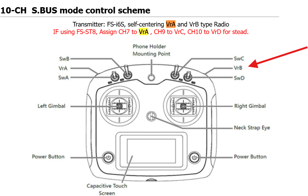

The switch that fires the canon is the VRB roller switch on the very top right of the radio. You pull the round switch one direction and the MG will fire, push it the other way and the canon will fire. The VRA round switch on the top left should have another MG sound when you use it, but it only has the MG and nothing else.
Screenshot 2025-11-01 005134.png (287.33 KiB) Viewed 1307 times
If you are having an issue with it firing at weird times, I would go back through the radio configuration from here and verify everything is correct.
