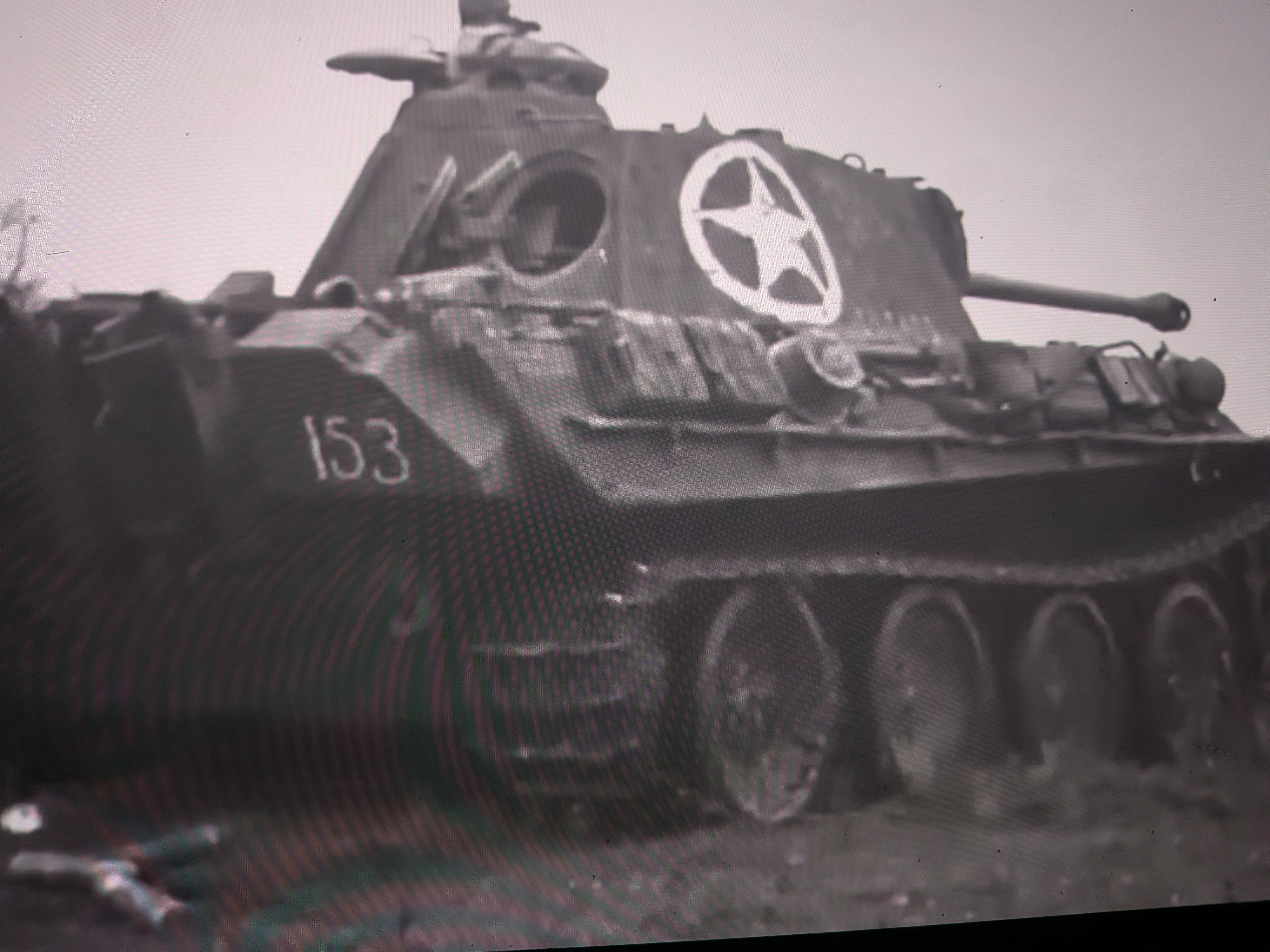

Watching a video on the 83rd rag tag circus infantry division and there was footage of cuckoo from behind
