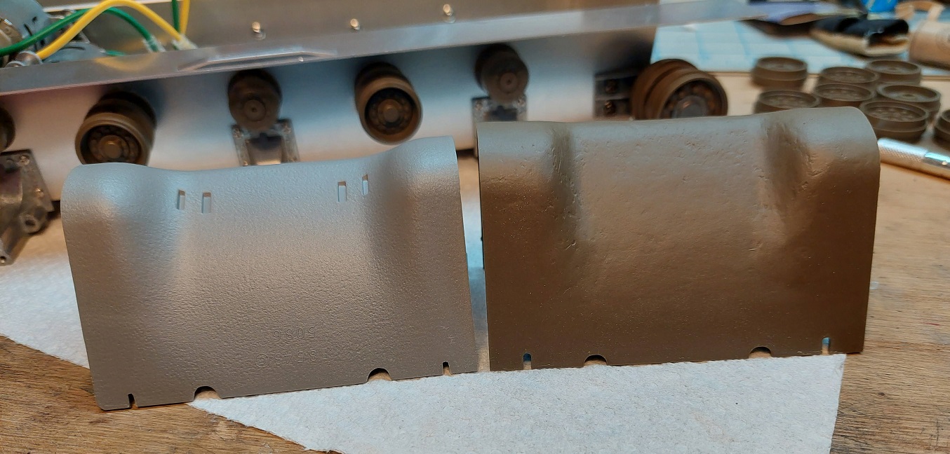

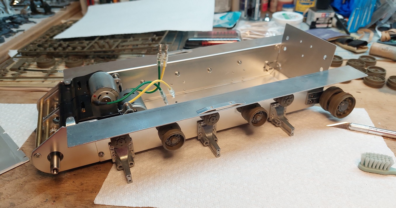

Basic Tamiya assembly began. The molding on the Tamiya plastic isn't amazing, required a lot of scraping mold lines and sharp edges of plastic for all those wheels. .

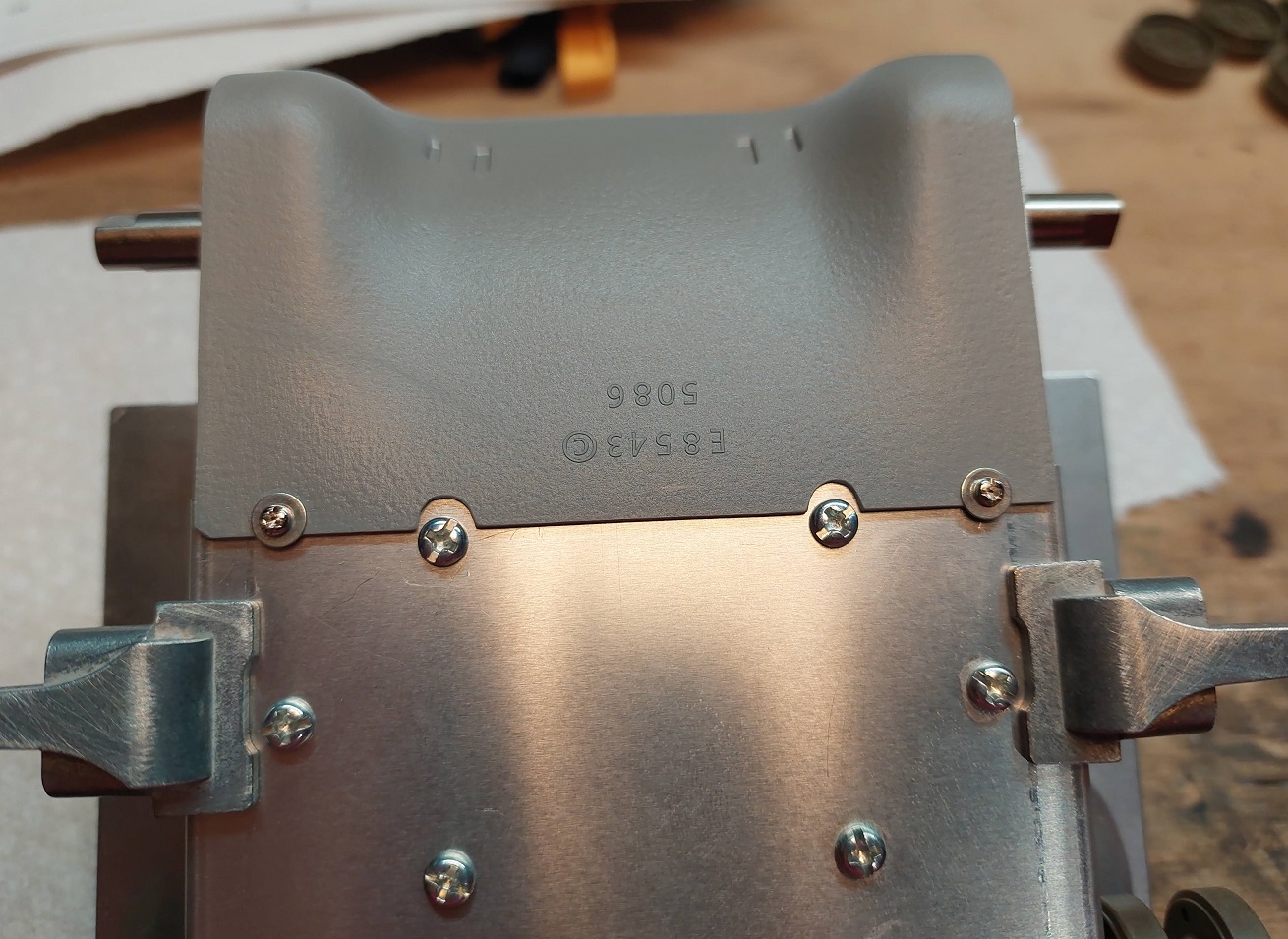

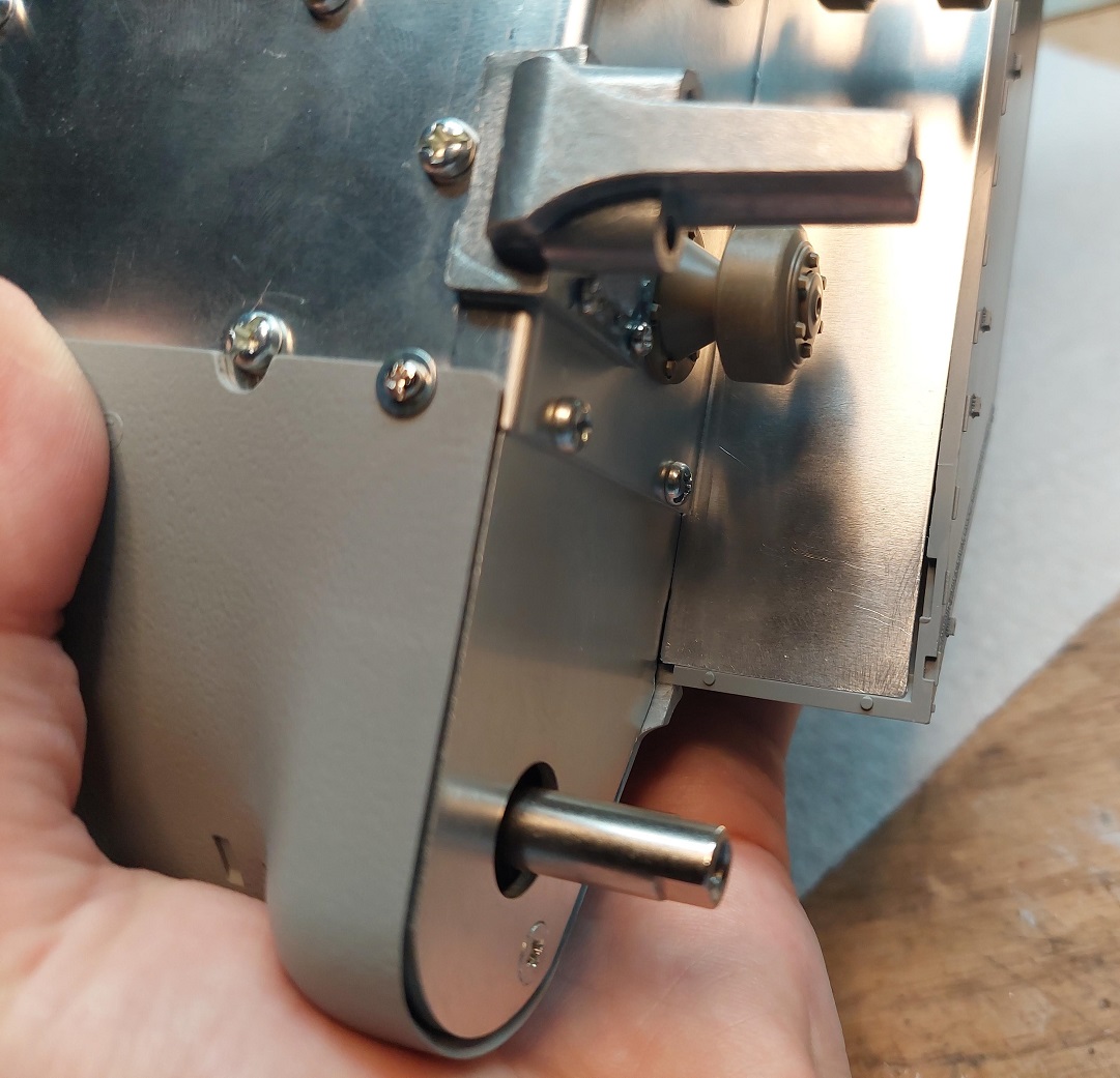

First real challenge/hiccup, which front transmission/cover to use and how to fit it. Stock fit of the AHH/Takom part is not great, this is after shaving some plastic away on the inside. It's pretty tight. .

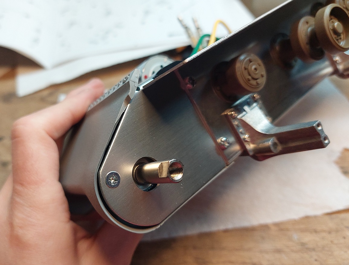

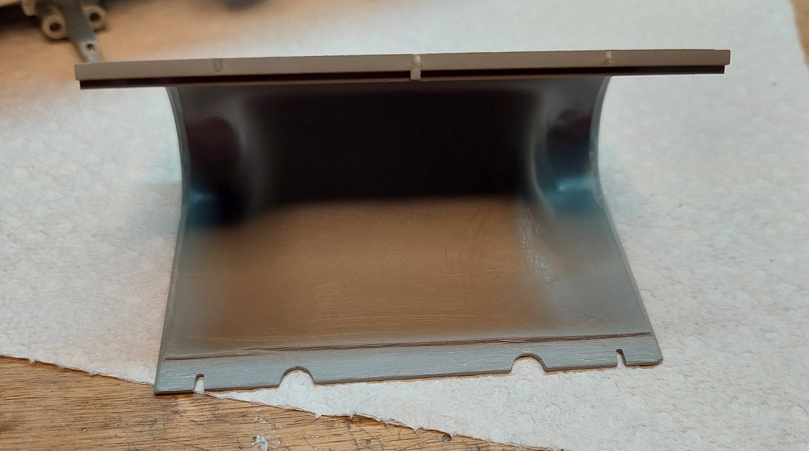

I felt determined to use the AHH/Takom front section and carved out some holes/slots to match the Tamiya mounting options. .
Also carved out a channel to fit the metal hull a bit smoother. .
Here it is mounted to the hull with just some screws to hold it in place for examination. .
Had to tilt the upper bolt bracket that mounts the Sherman transmission to the upper hull due to the fit and gaps. Held and gap filled with epoxy to make it look less obvious. .

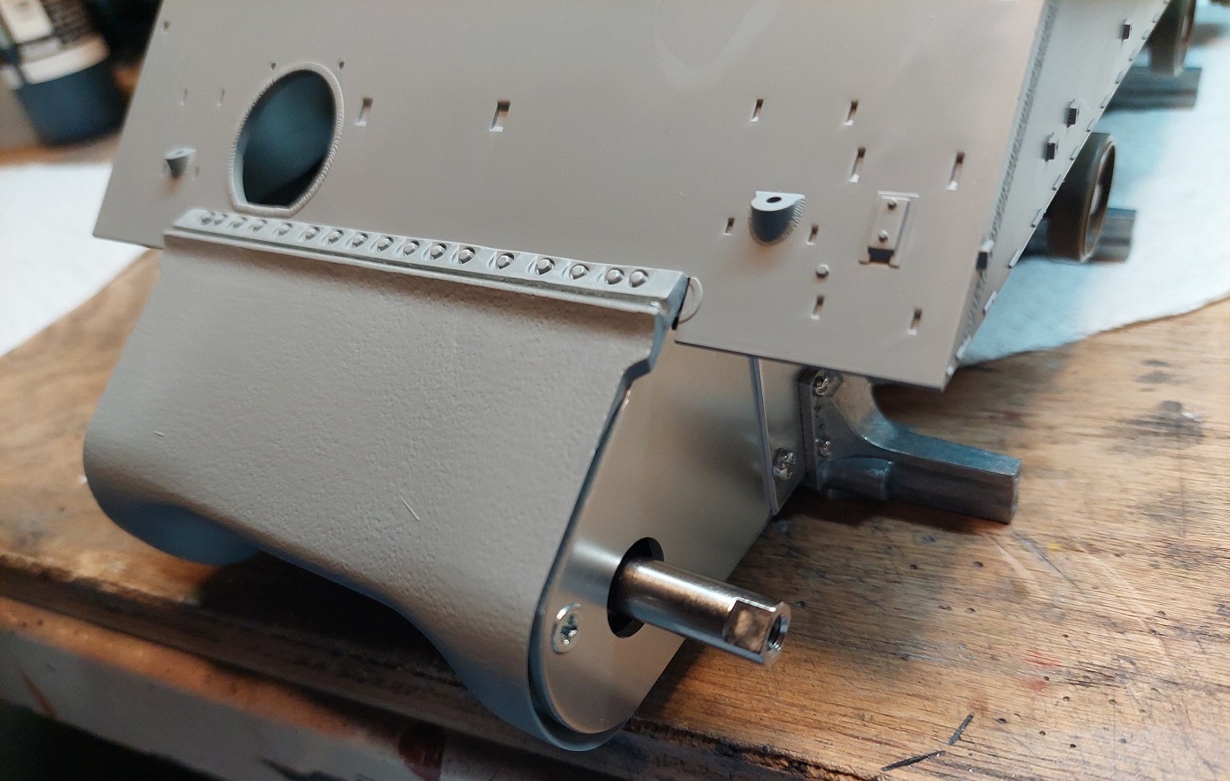

Upper Hull meeting the chassis and transmission. .

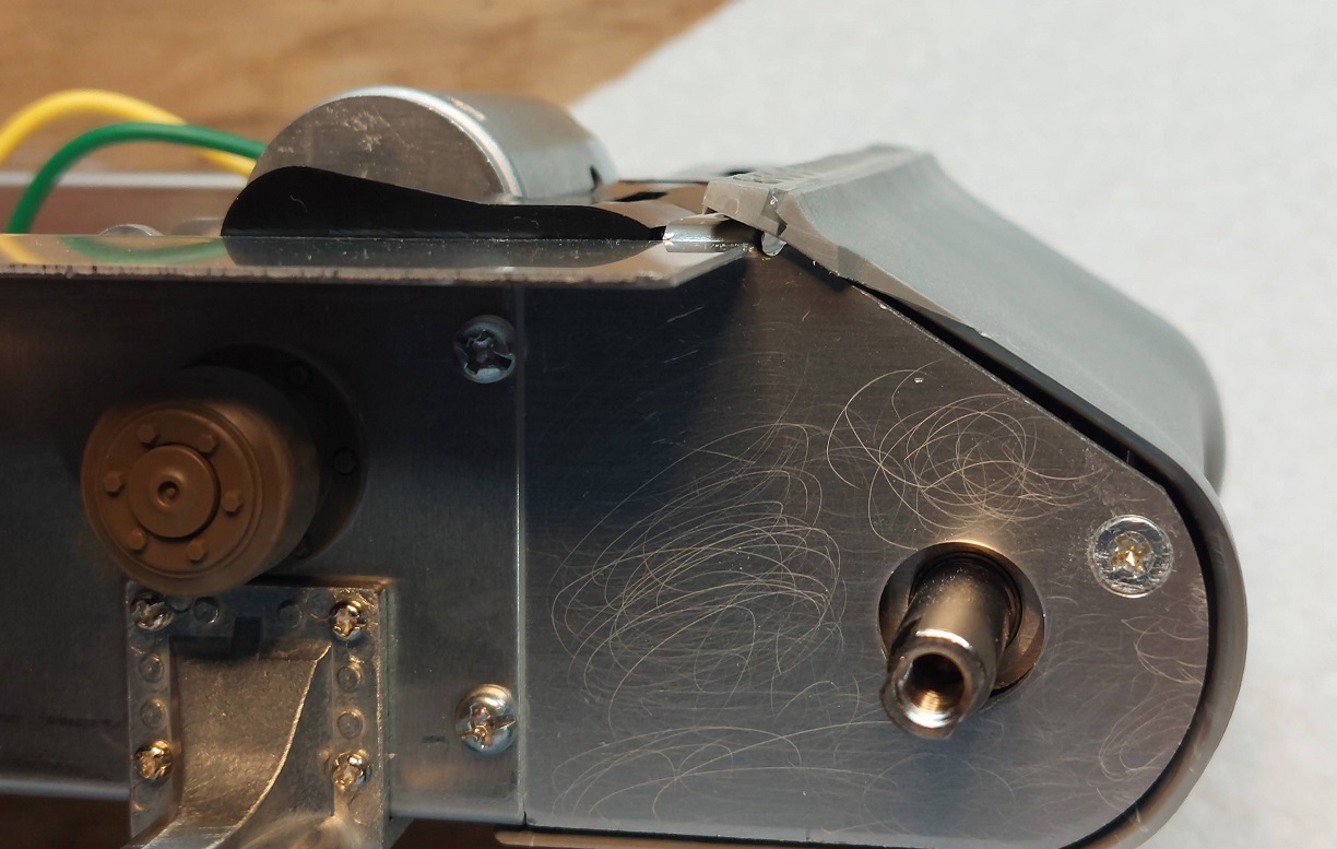

Had to do some filing to get the metal chassis to fit the upper hull. There's a beveled edge on the metal, it fits quite nice now. .
A bit of a fast forward, but it matches the progress. Here is the entire nose permanently mounted, with epoxy and gearbox covers. It's solid now, no gaps, nice tight fit and looks natural enough. I used a heat gun to slightly deform the transmission/cover to fit this Tamiya chassis better and it worked great. I'm quite happy I decided to use this cover, even though it was more struggle to make it work than I can properly represent. .

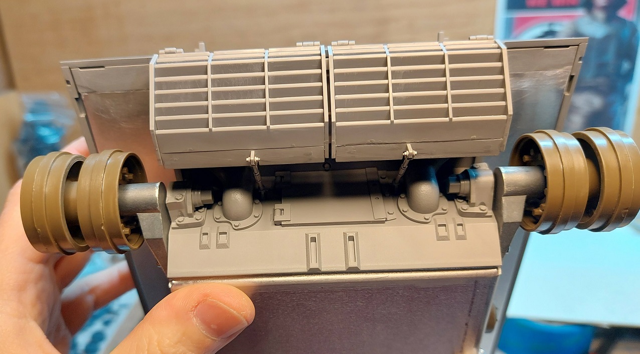

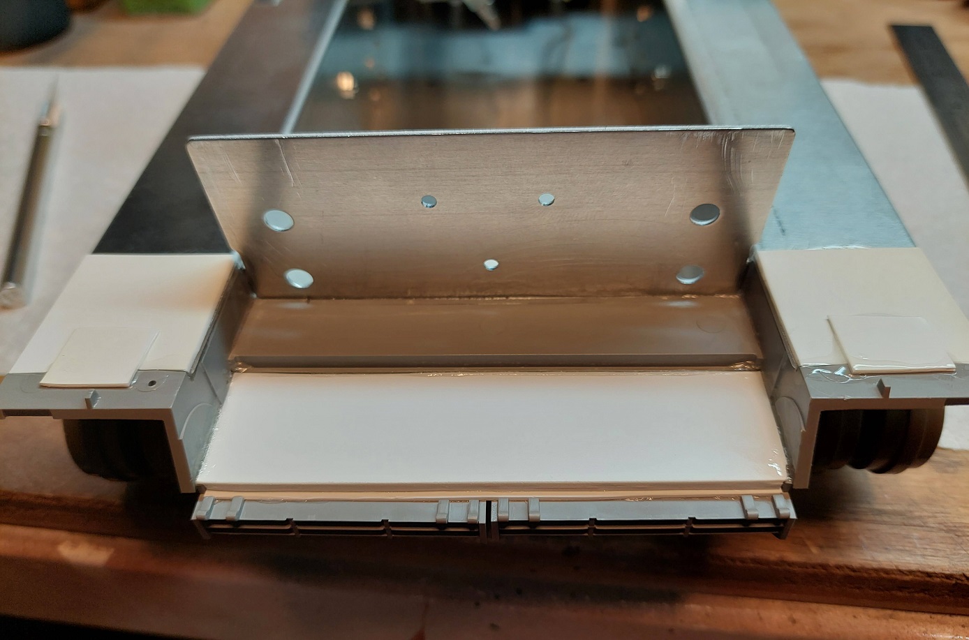

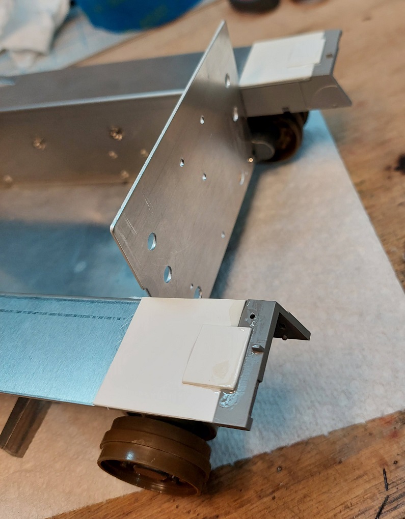

Added these lower hull extensions from the plastic hull to the metal Tamiya hull. This is so the plastic upper hull will properly meet the lower hull when the two halves join. Next I wanted to get the lower rear hull in order. Some minor modification to the rear hull plate and the exhausts so that I can make a smoking engine. Brass tube into the exhaust pipes. Next I wanted to use the late/post war style exhaust diffuser. These were solid plastic and not designed to actually vent on the static model, so a lot of grinding, cutting and filing to open them up cleanly was in order. This will make more sense once mounted.

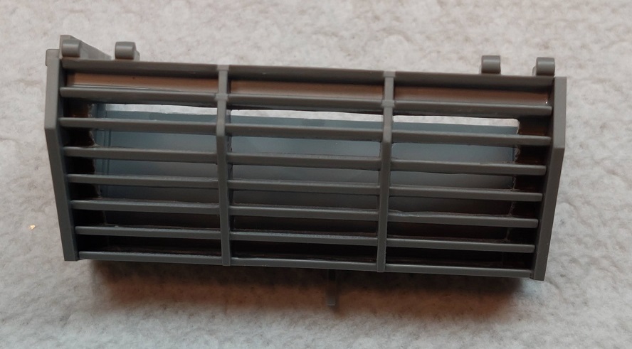

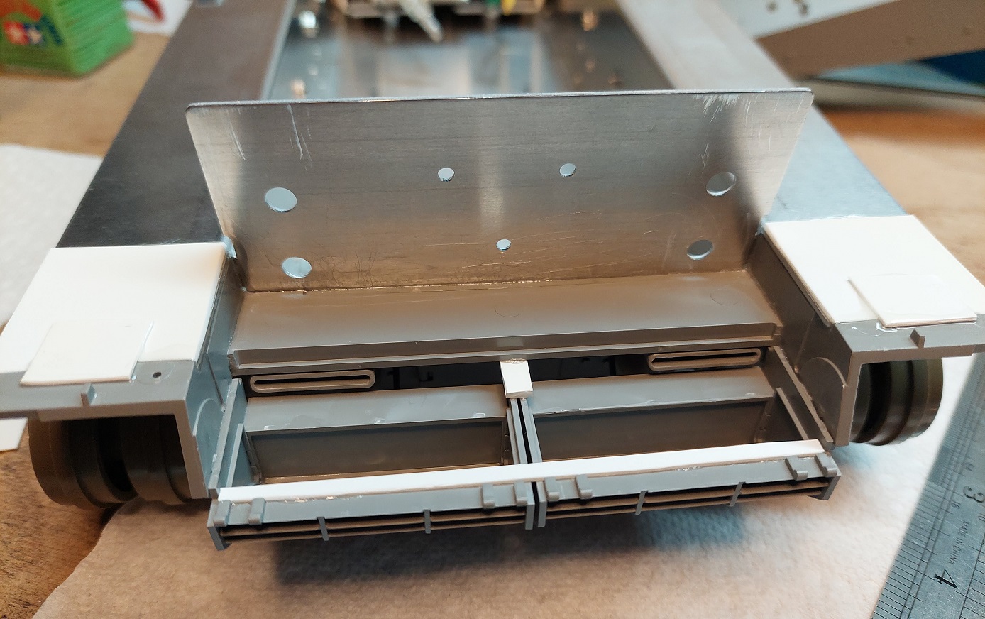

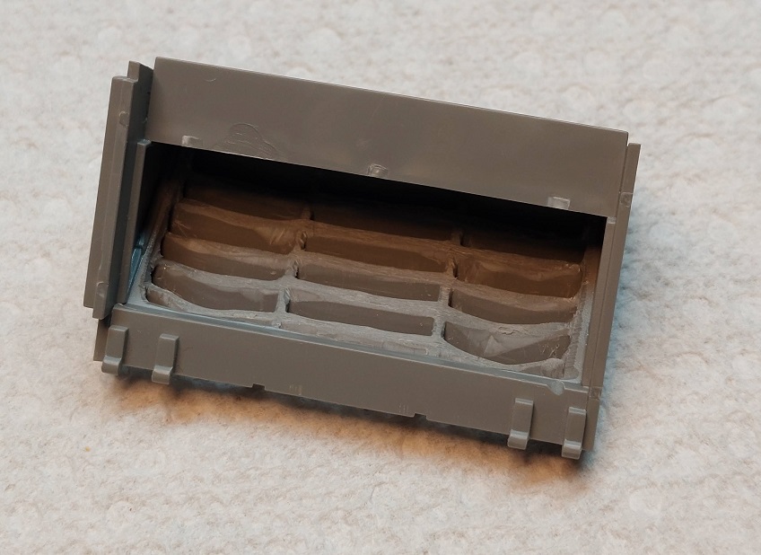

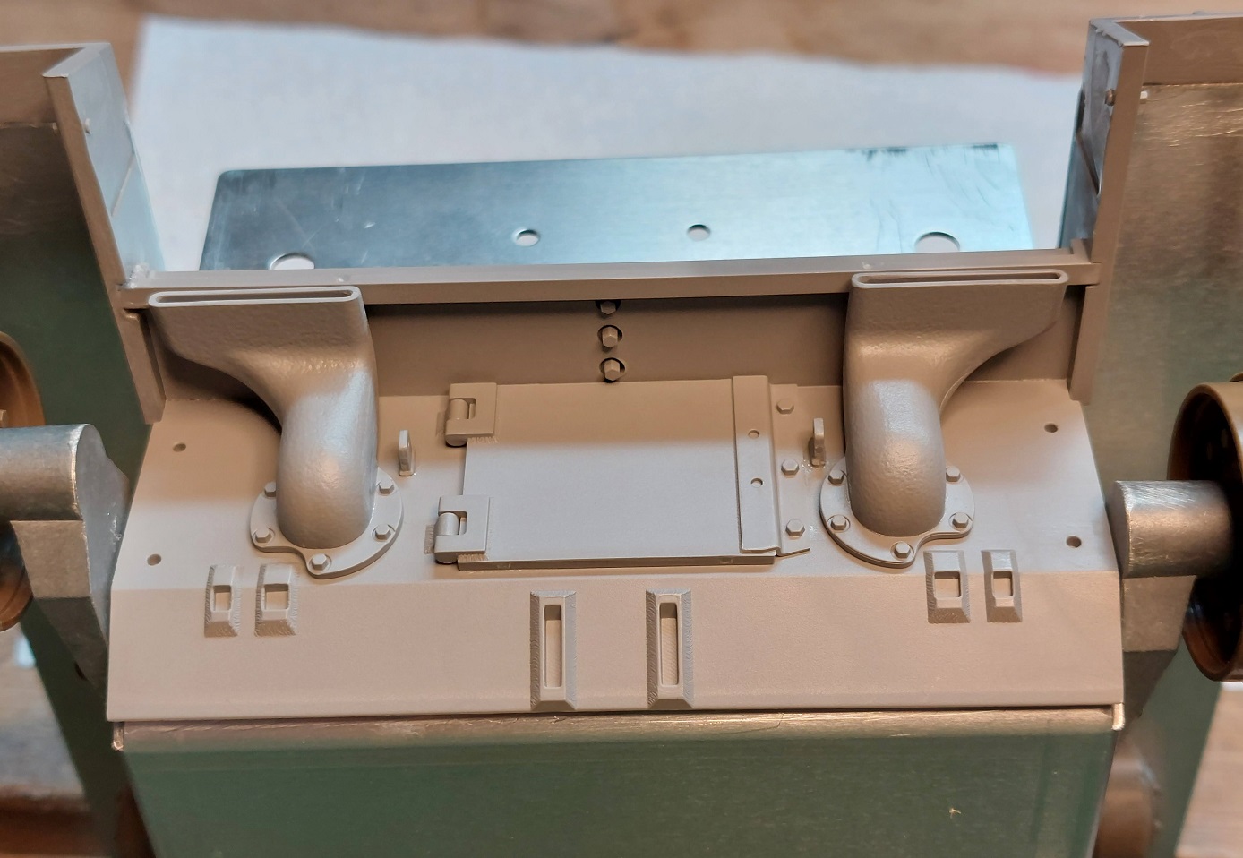

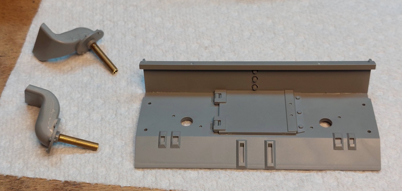

Here are the two diffusers mounted. You can see the thin slitted exhaust pipes venting into them. I used some plastic strips to secure it more solidly for RC operation that you won't see when fully assembled.
And then fully covered the diffusers and exhaust to keep the smoke flowing in the correct places.

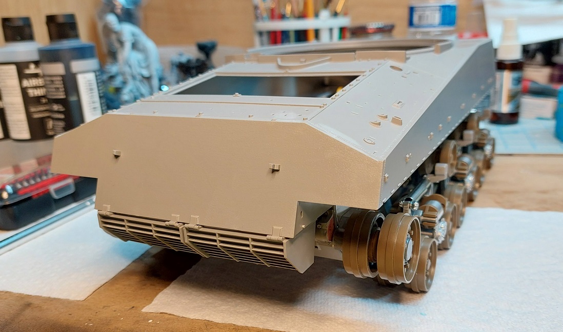

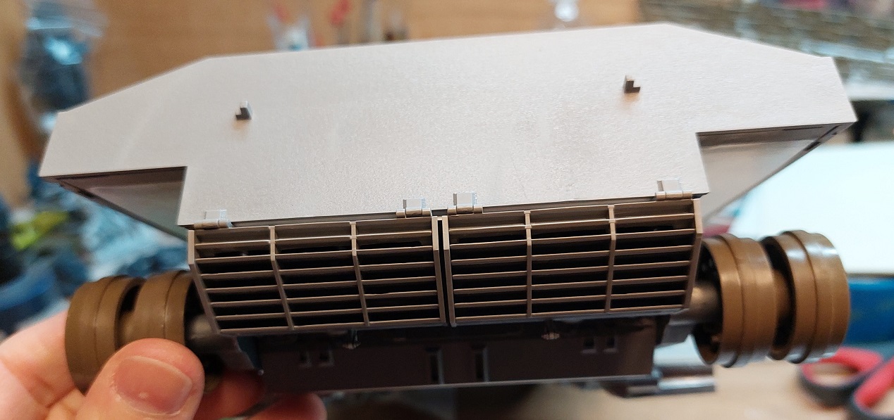

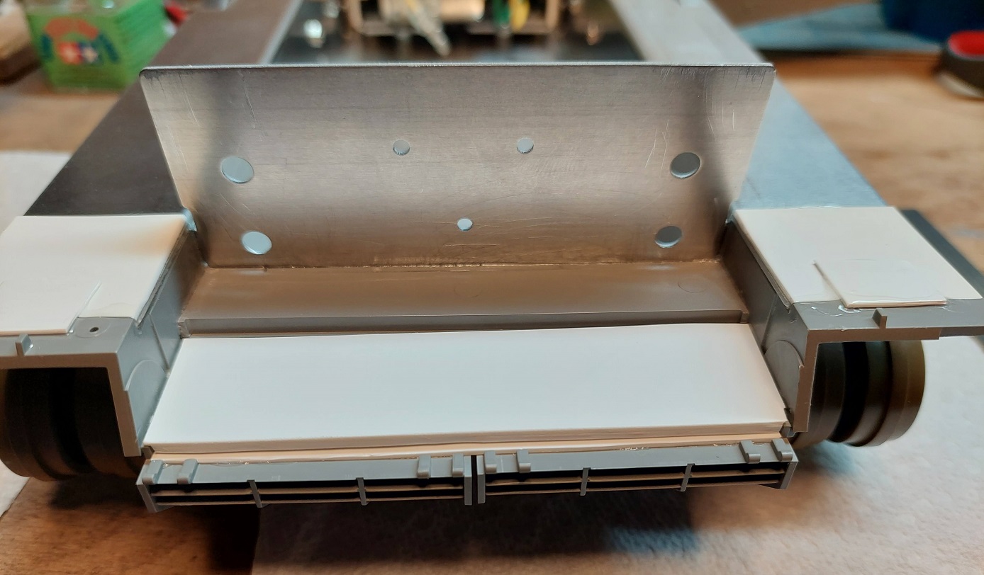

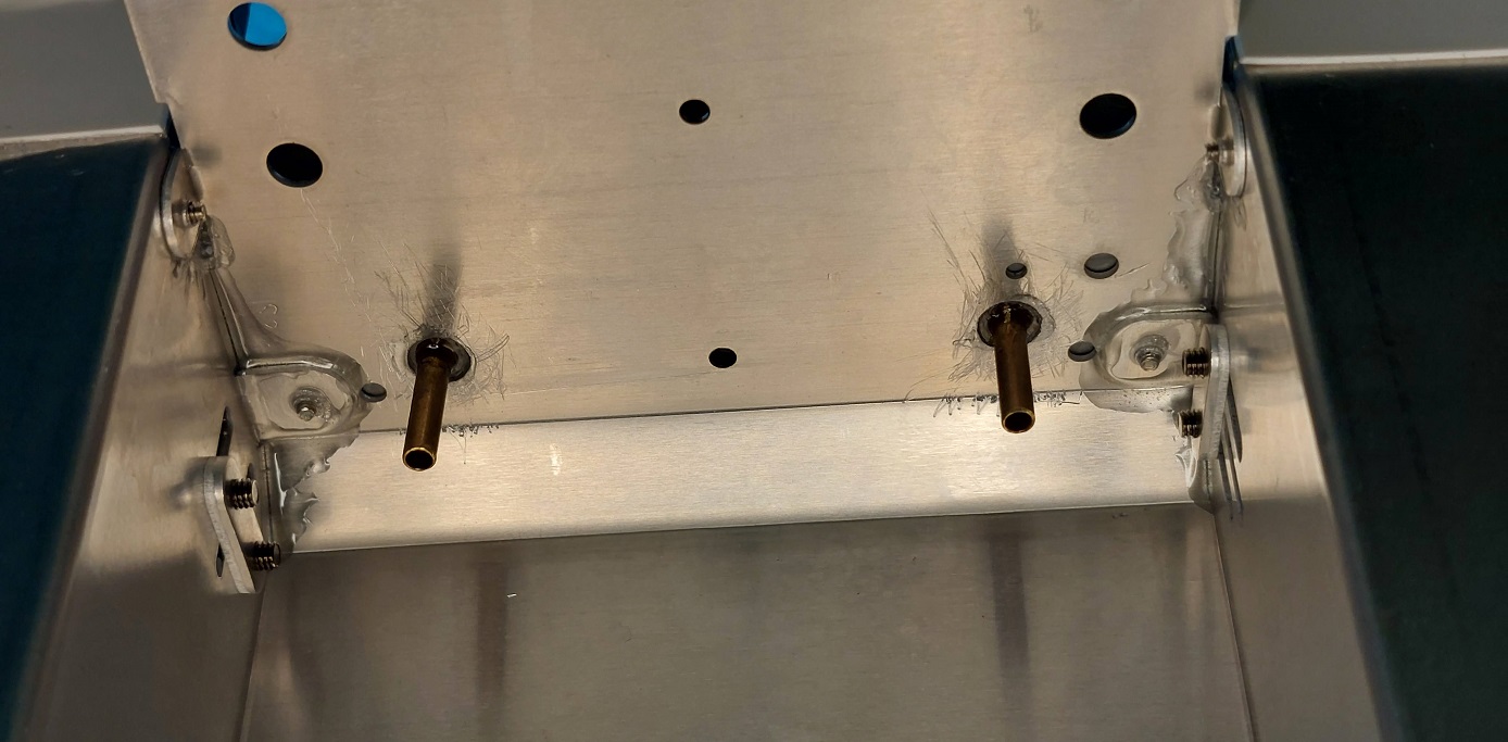

Here is a view from below, with the upper hull test attached showing the nice fitting of the two halves. The diffuser props are here now as well as the rear axle sections glued on. The floating rear idle wheel axle is adjustable on the Tamiya, so I lobbed the plastic ones in half and filled them with filler. They are not a perfect show piece, but more convincing than not having them at all, and leaves the rear idler still adjustable for RC. I'll save the more delicate bits to glue on later when the model is more functional.
And the rear view test fitment. Very nice and accurate fit so it will look nice even without gluing the two halves.

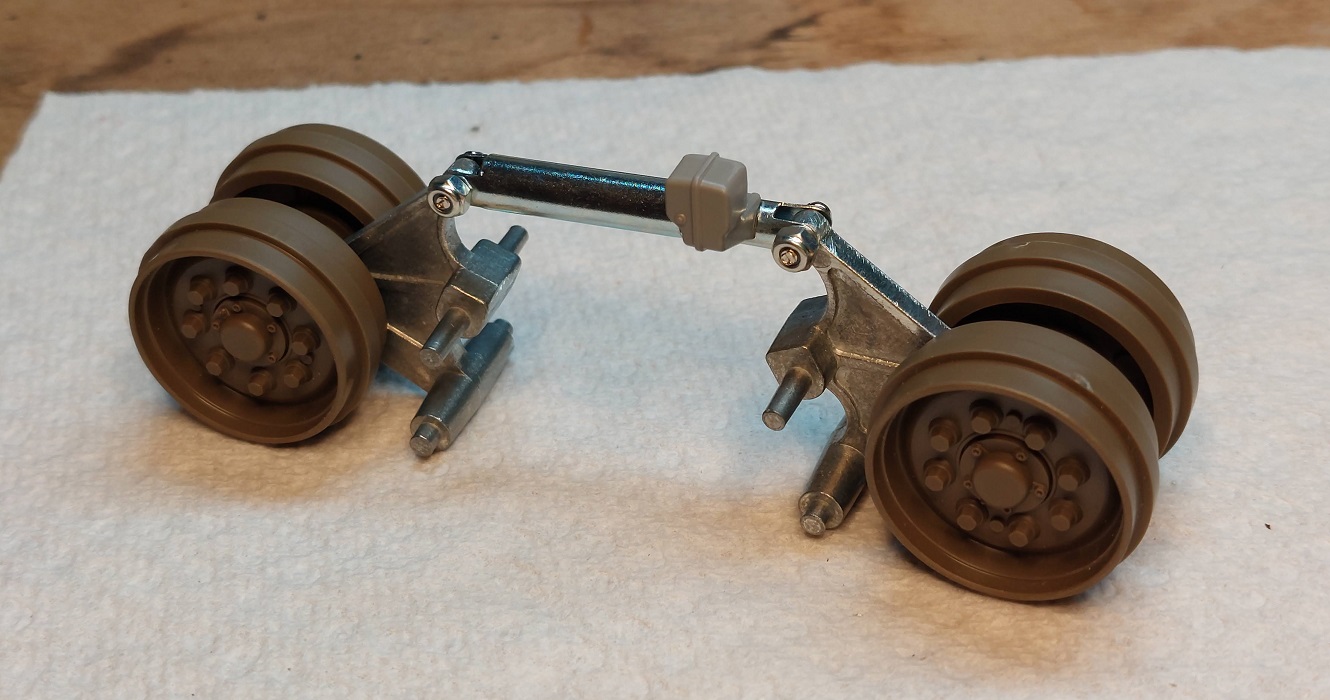

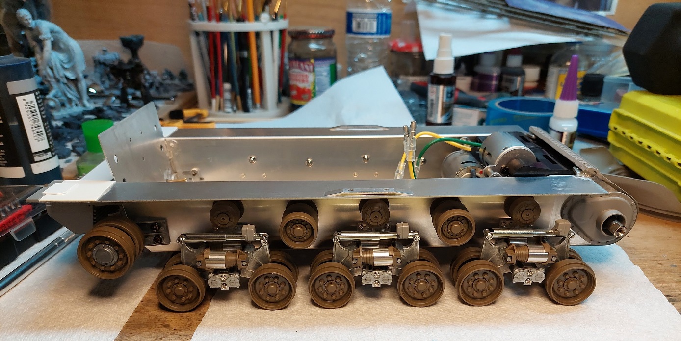

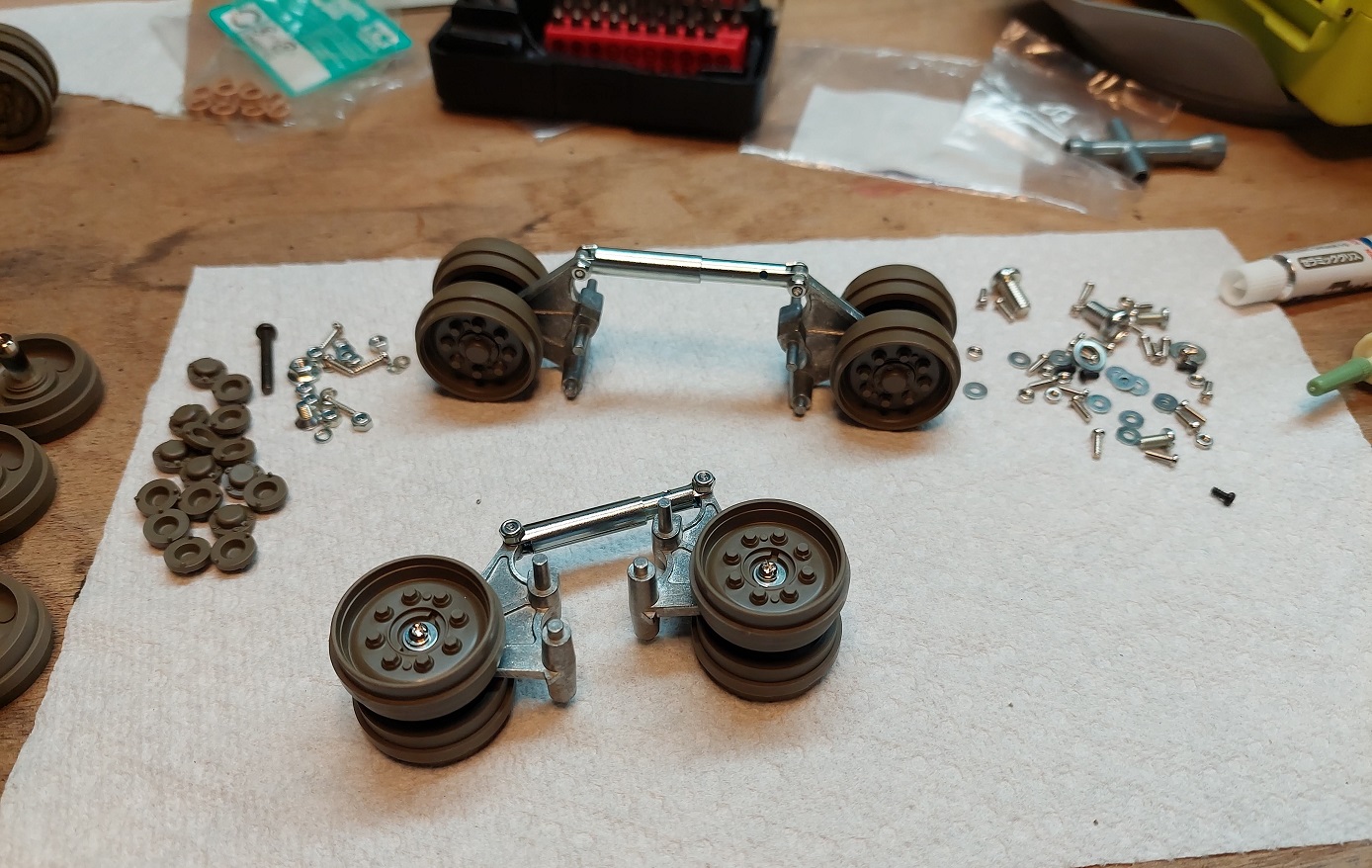

Finally I went into the wheels, perhaps the most repetitive single step of this model. Sanded and softened many edges that were overly sharp on the Tamiya molds, including the metal parts.
I used the Takom oilers here on the piston. I also preferred to use the Tamiya bolts here "backwards" with the nut on the outside, as I don't like the look of the exposed Phillips head screw on the outside. To me it interferes with the sense of scale.
All the wheels complete and mounted, tires will come post painting. I realized I have a few pistons in the wrong orientation after looking at it later and will fix this soon. I lubricated all the wheel shafts before gluing the caps on during assembly.
And one more shot, feeling happy that the two hull sections meet nicely.
