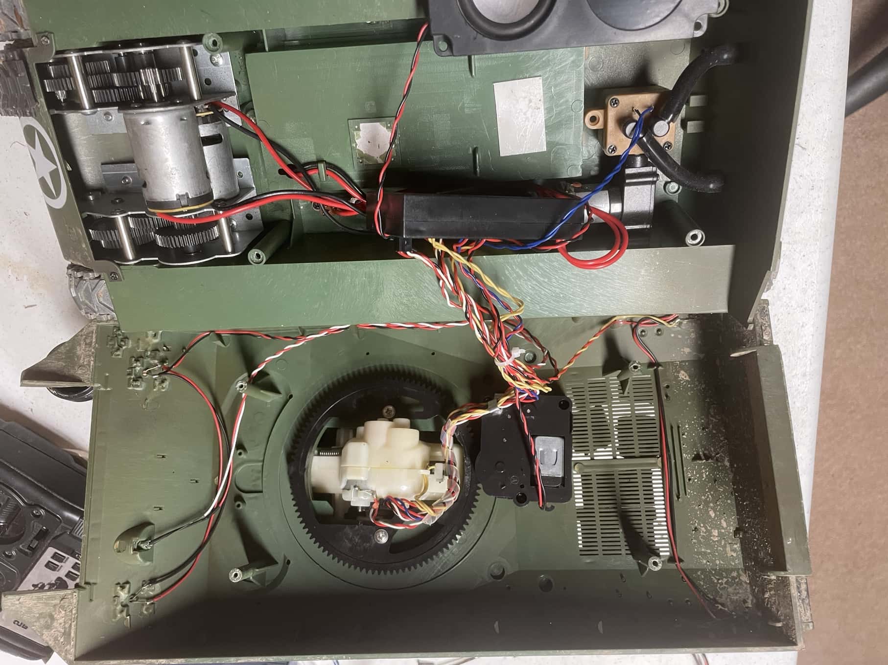

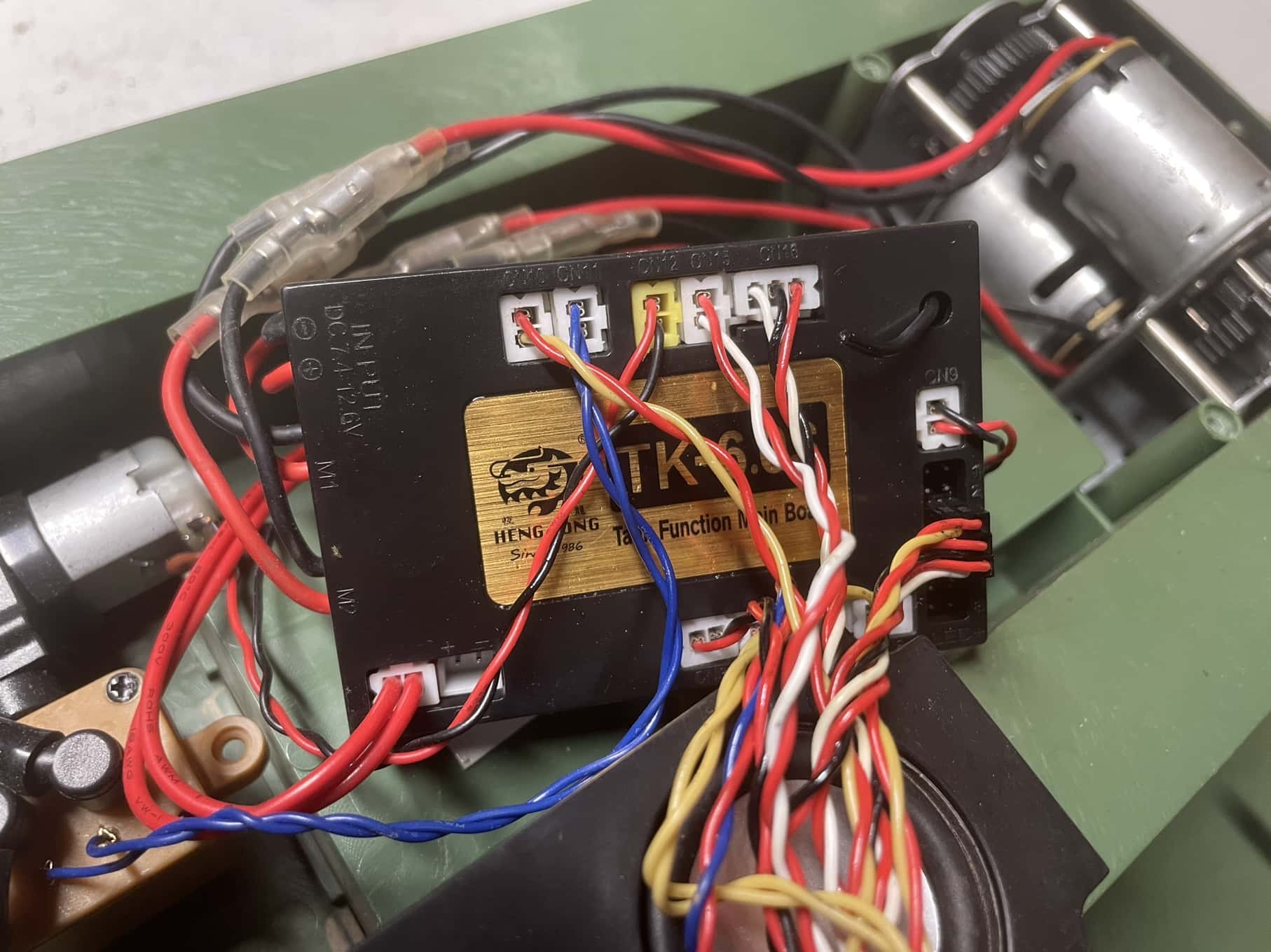

The batteries i use are as displayed in the attachments, as well as multiple angles of the interior electronics of the tank. From what I can tell, no connections are loose within the tank.
I do not know how to tell if there is water damage towards any of the components, however.

I cannot see any evidence of moisture exterior to the MFU (the TK6.0S or other such board we often call a "Multi-Function Unit" because it controls motors, sound, smoke, turret, etc.). However, there is some slight chance of some inside the MFU. Usually the cases around the MFU can be removed after removing all the connectors. I have opened lots of Taigen/Torro 2 and 3 and HengLong TK5.3 and earlier MFUs, but I have never opened a HengLong 6.0S. Whenever I remove any connectors, I still take lots of photos first so I can see what wire comes from what component and to what connection spot on the MFU.
