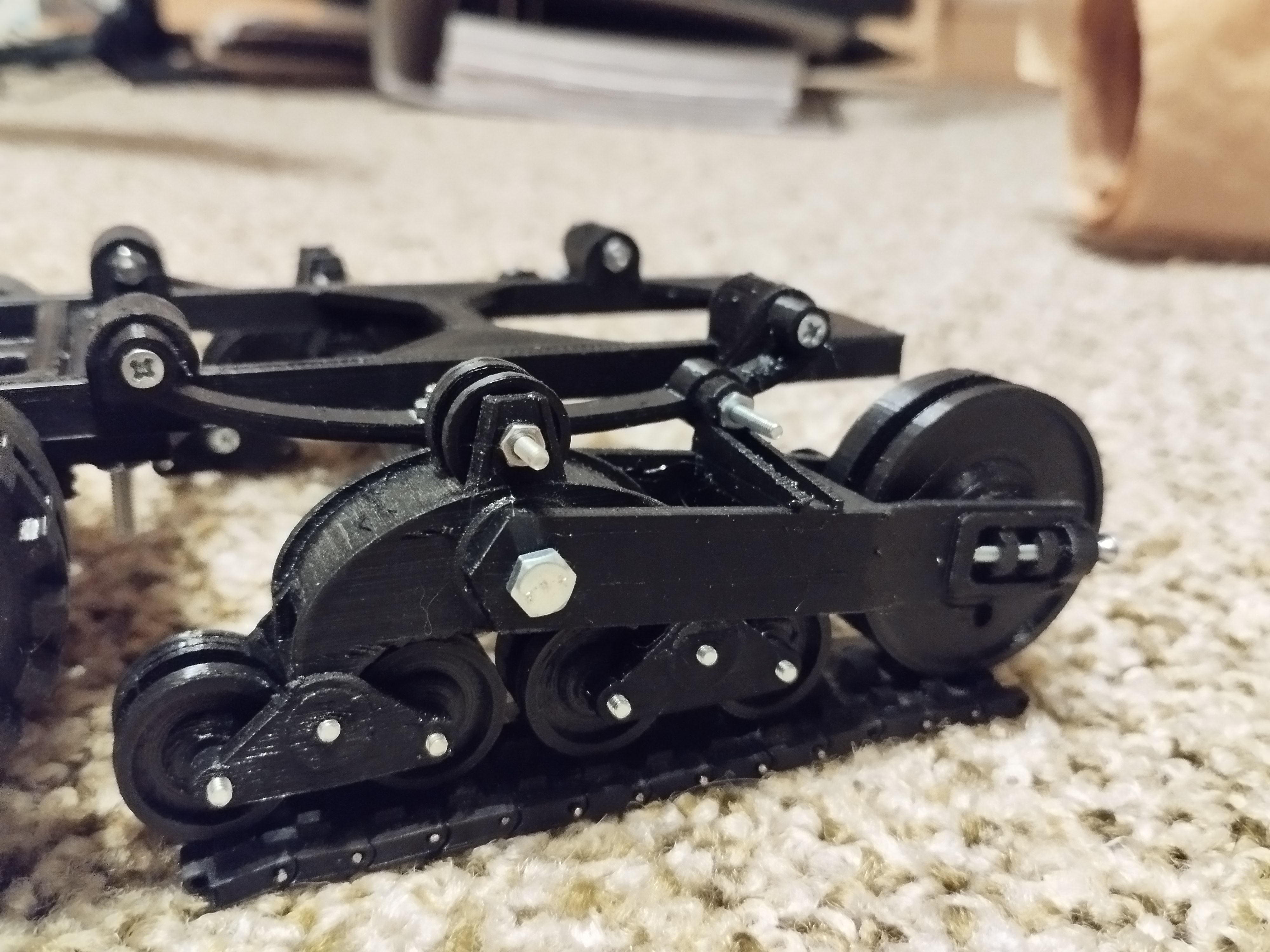

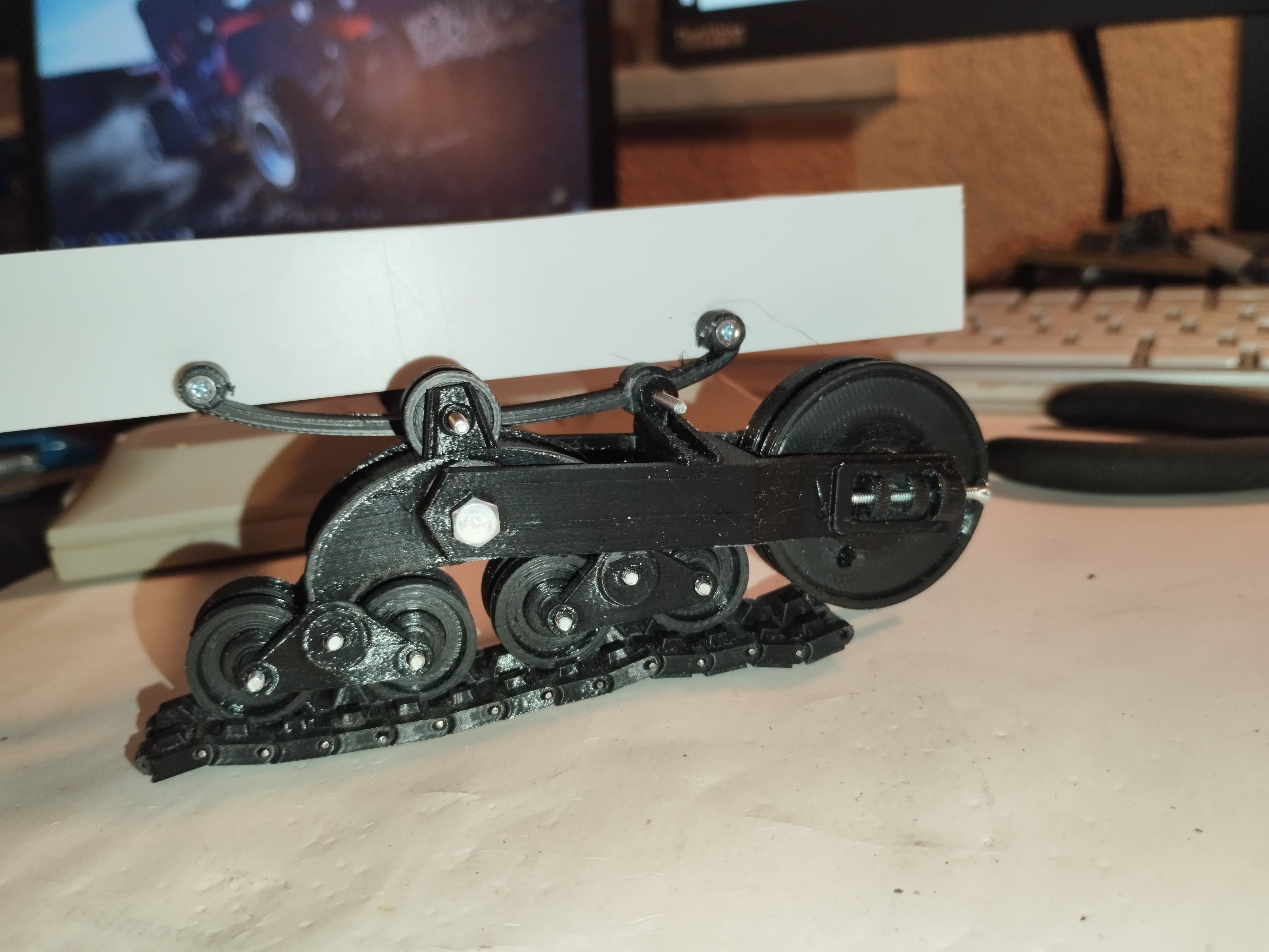

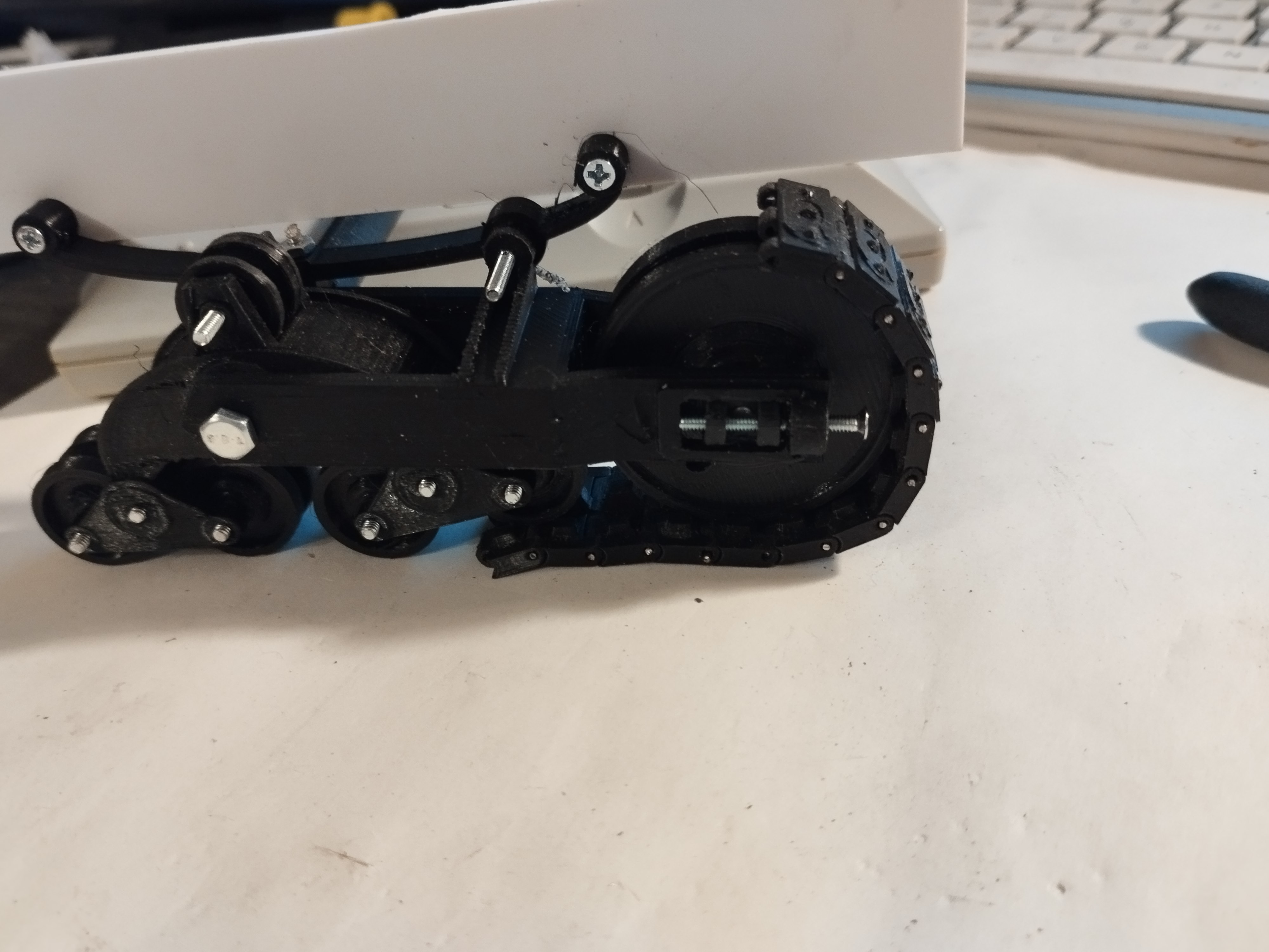

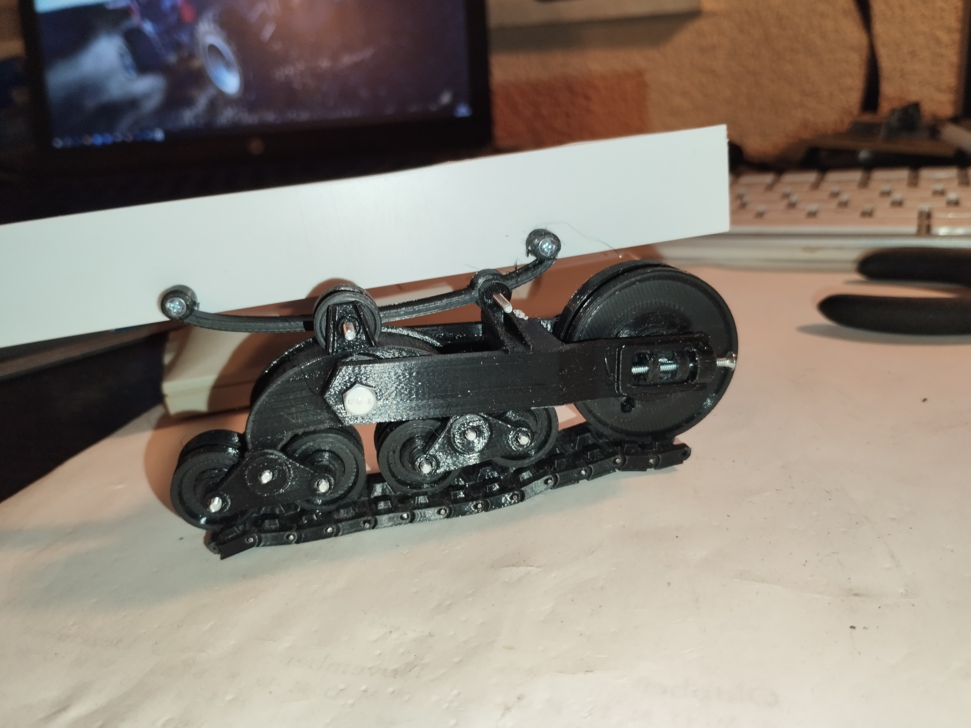

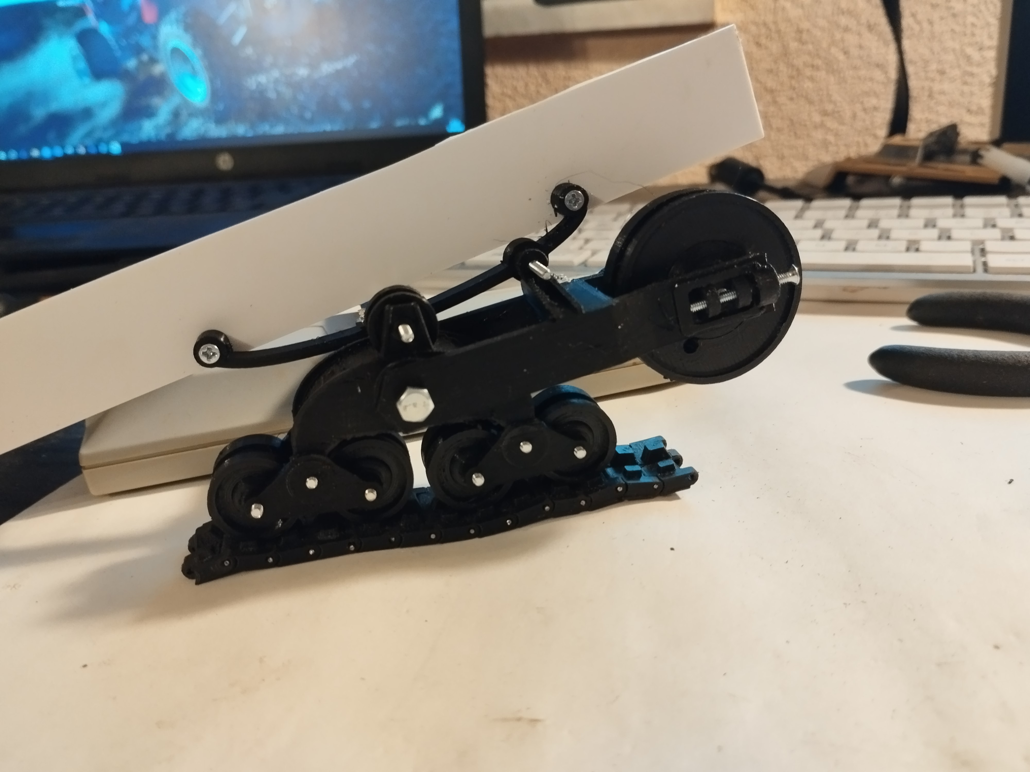

The first thing I did was print the runninggear to see if it could be done at all. As always, proceed as normal in FDM.
It was printed from PETG, as this is the only one still available. Unfortunately, the printing parameters don't quite match yet.
But I'll show you the first attempt

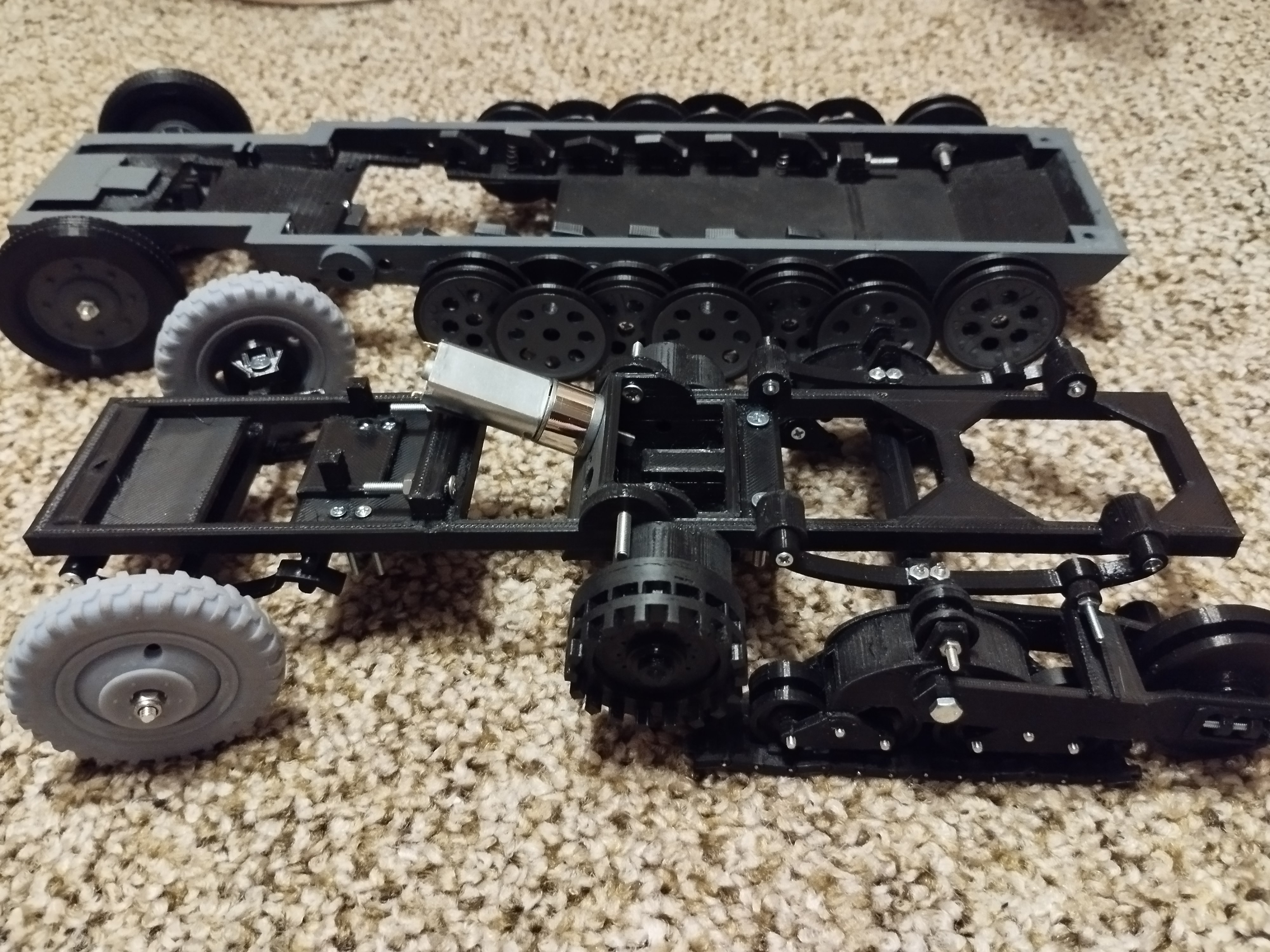

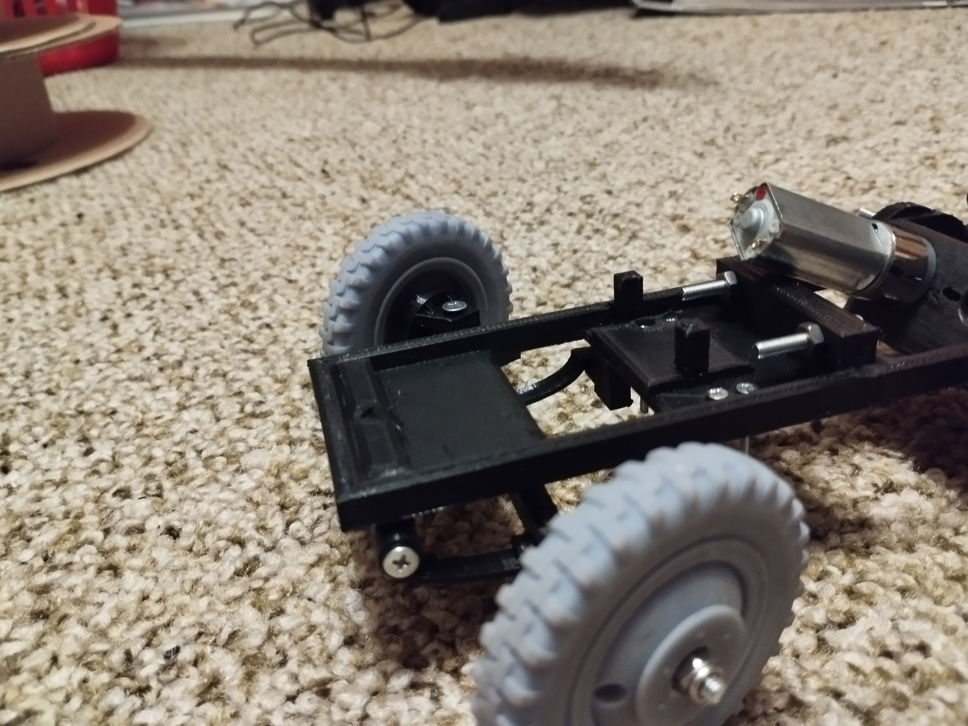

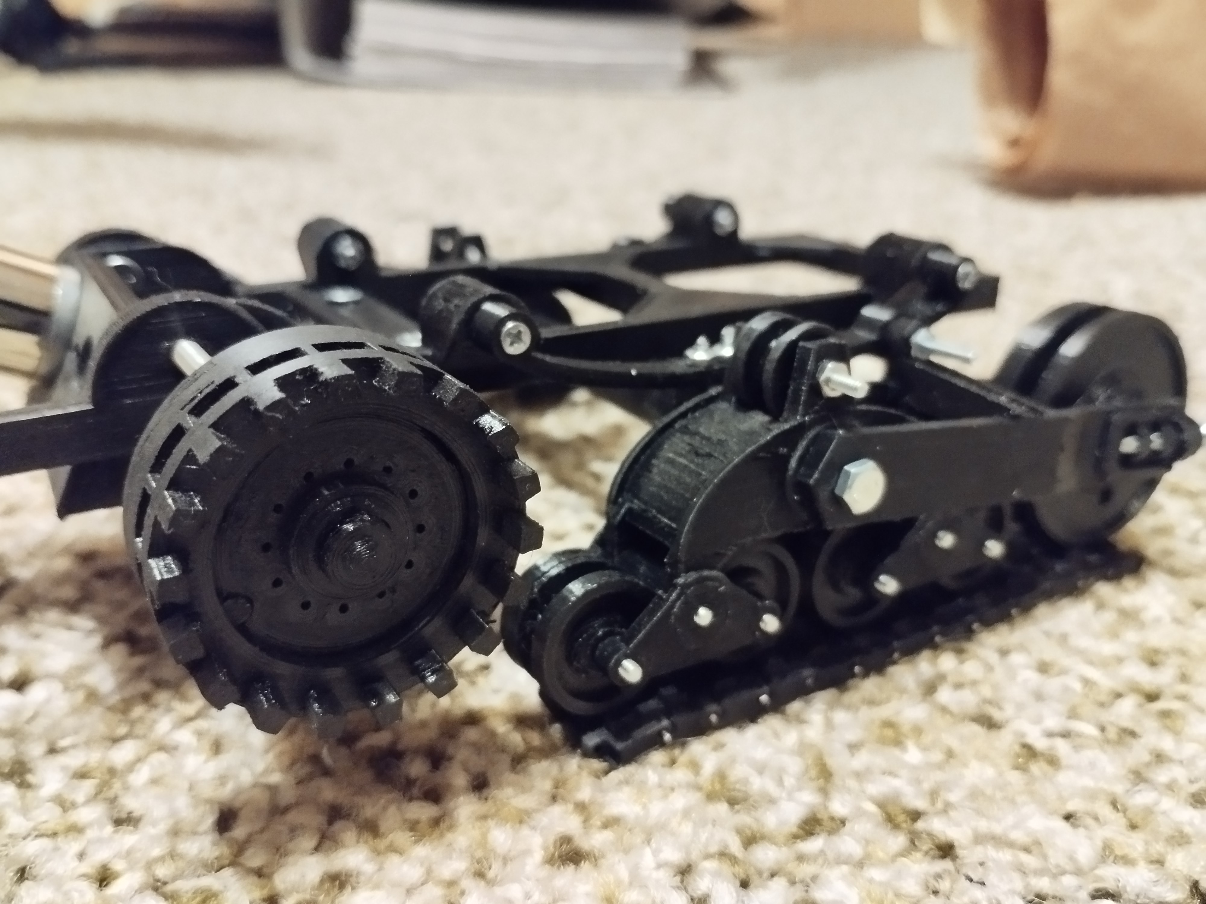

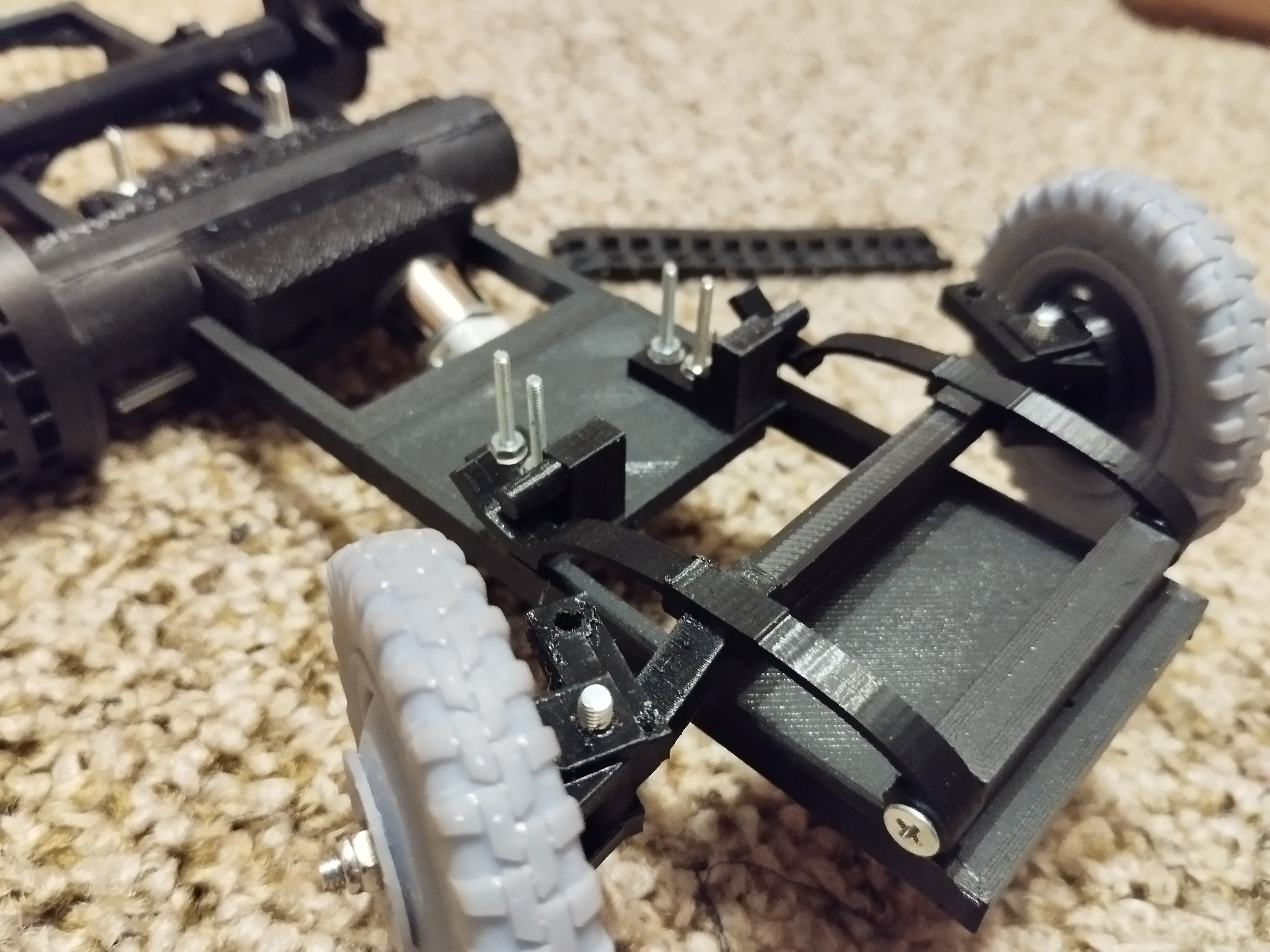

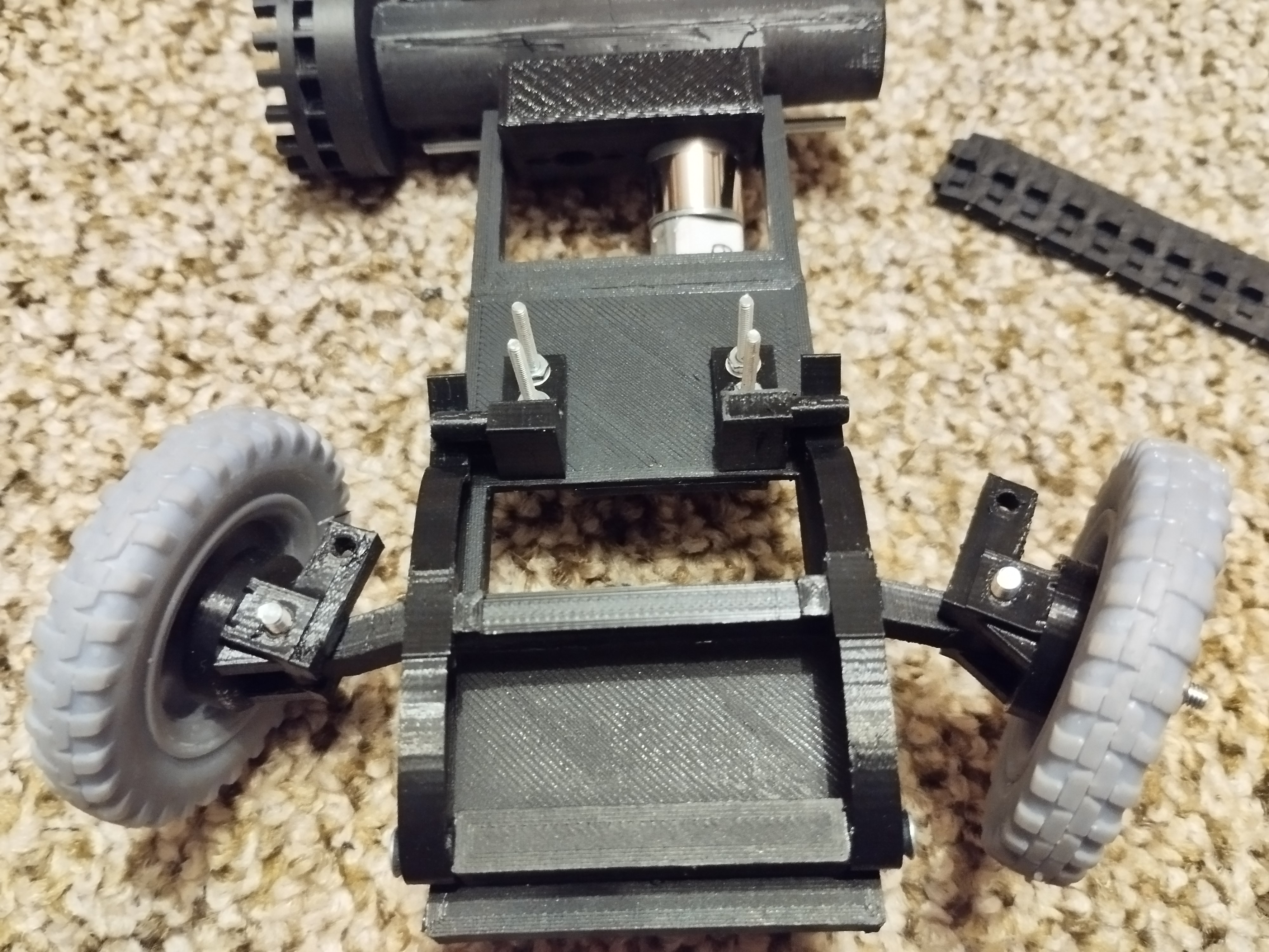

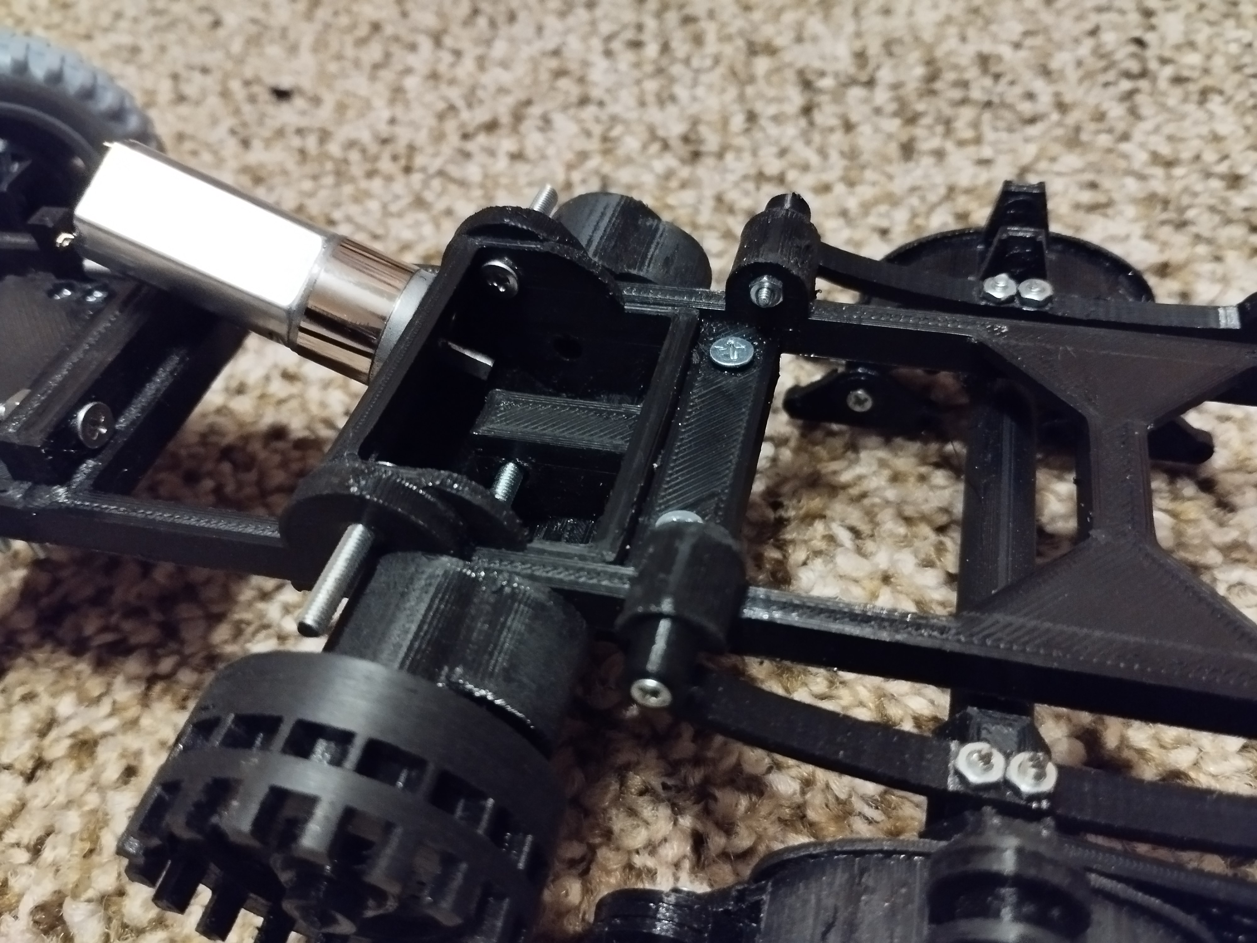

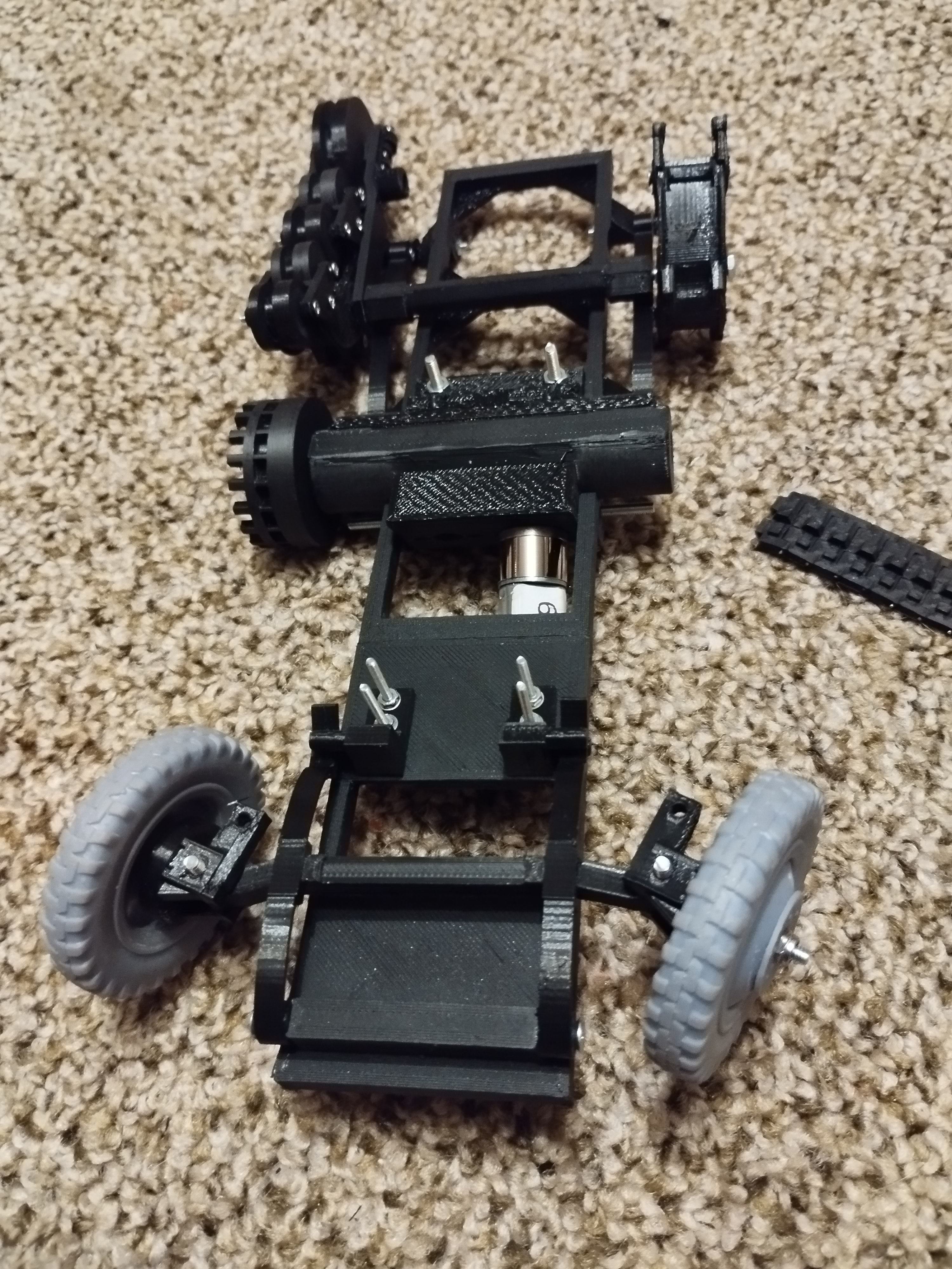

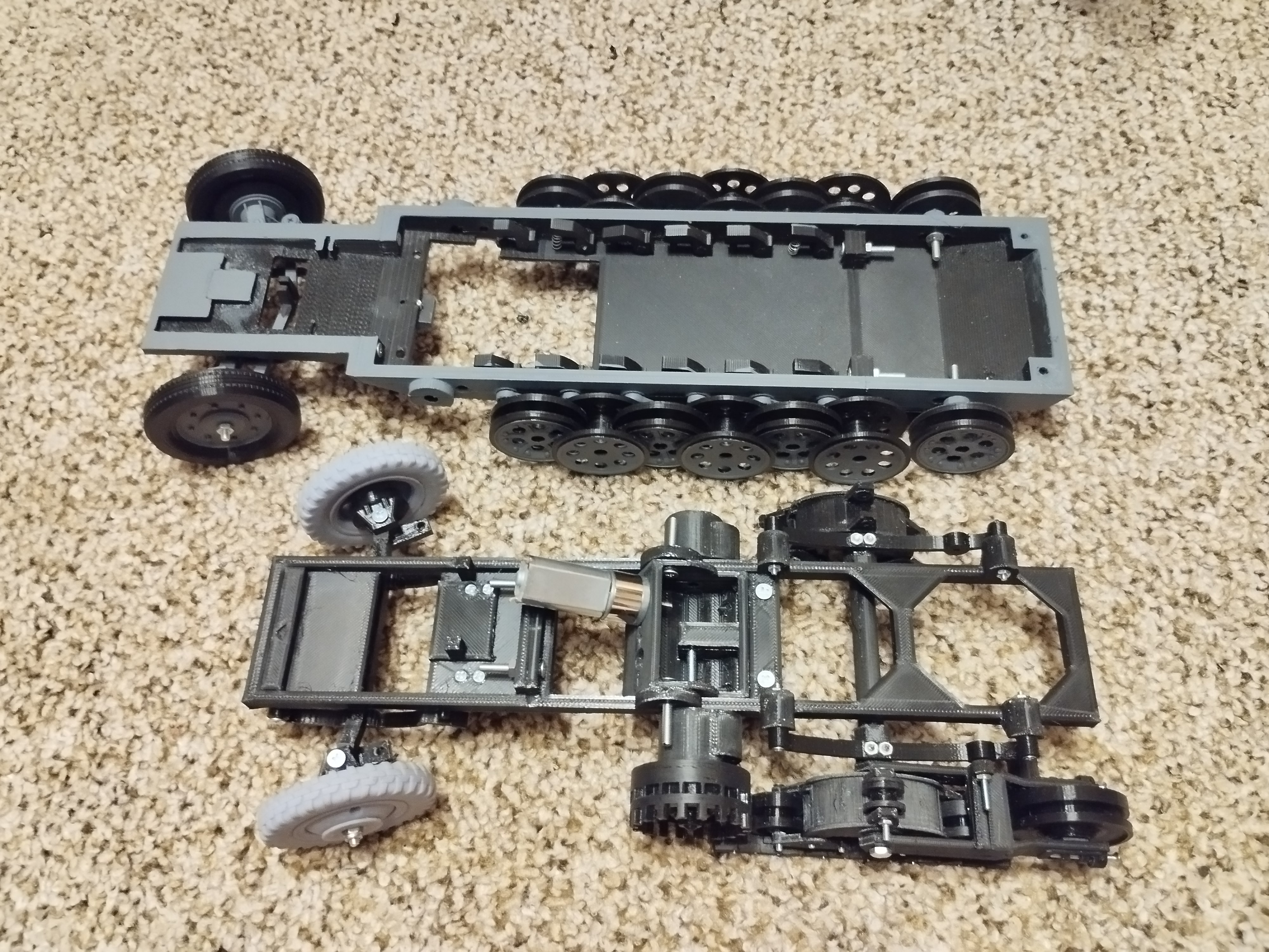

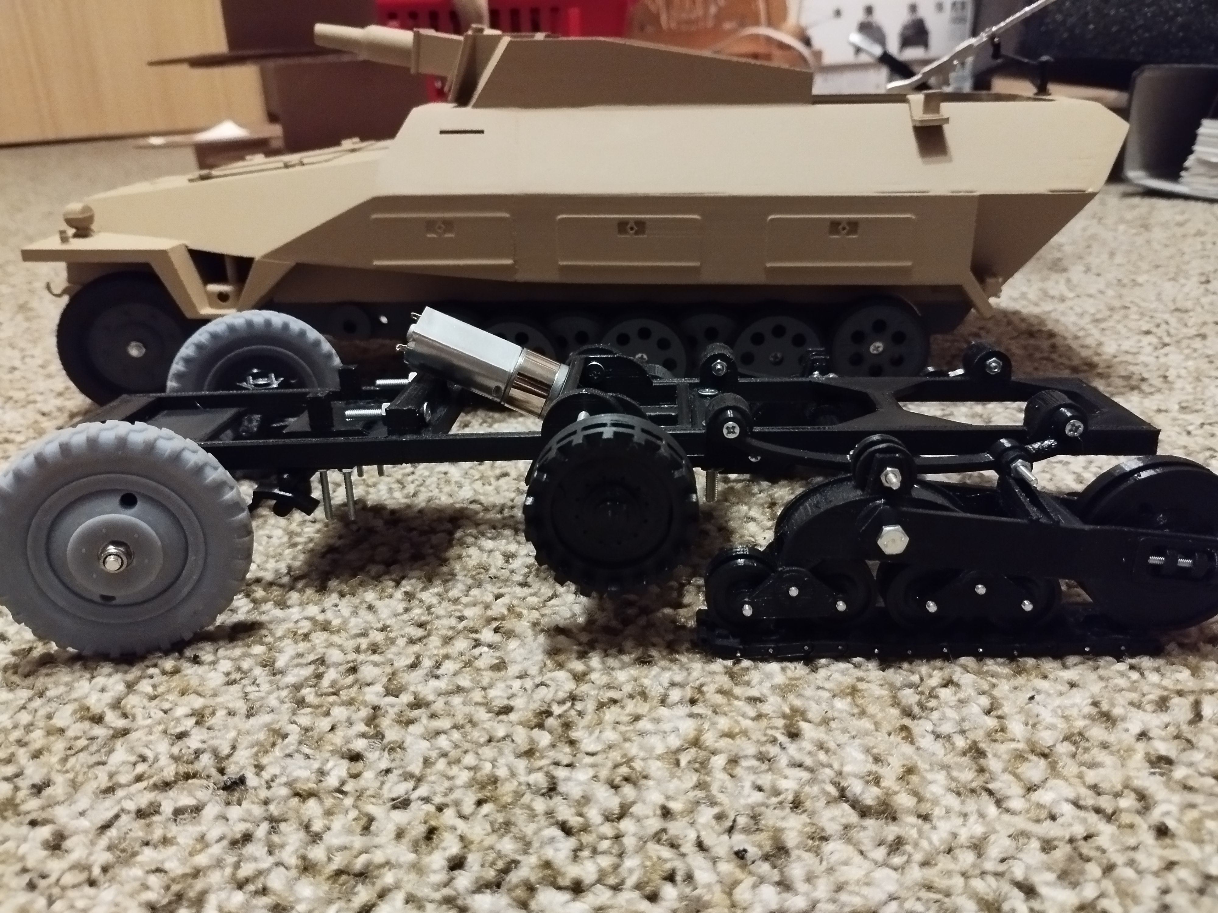

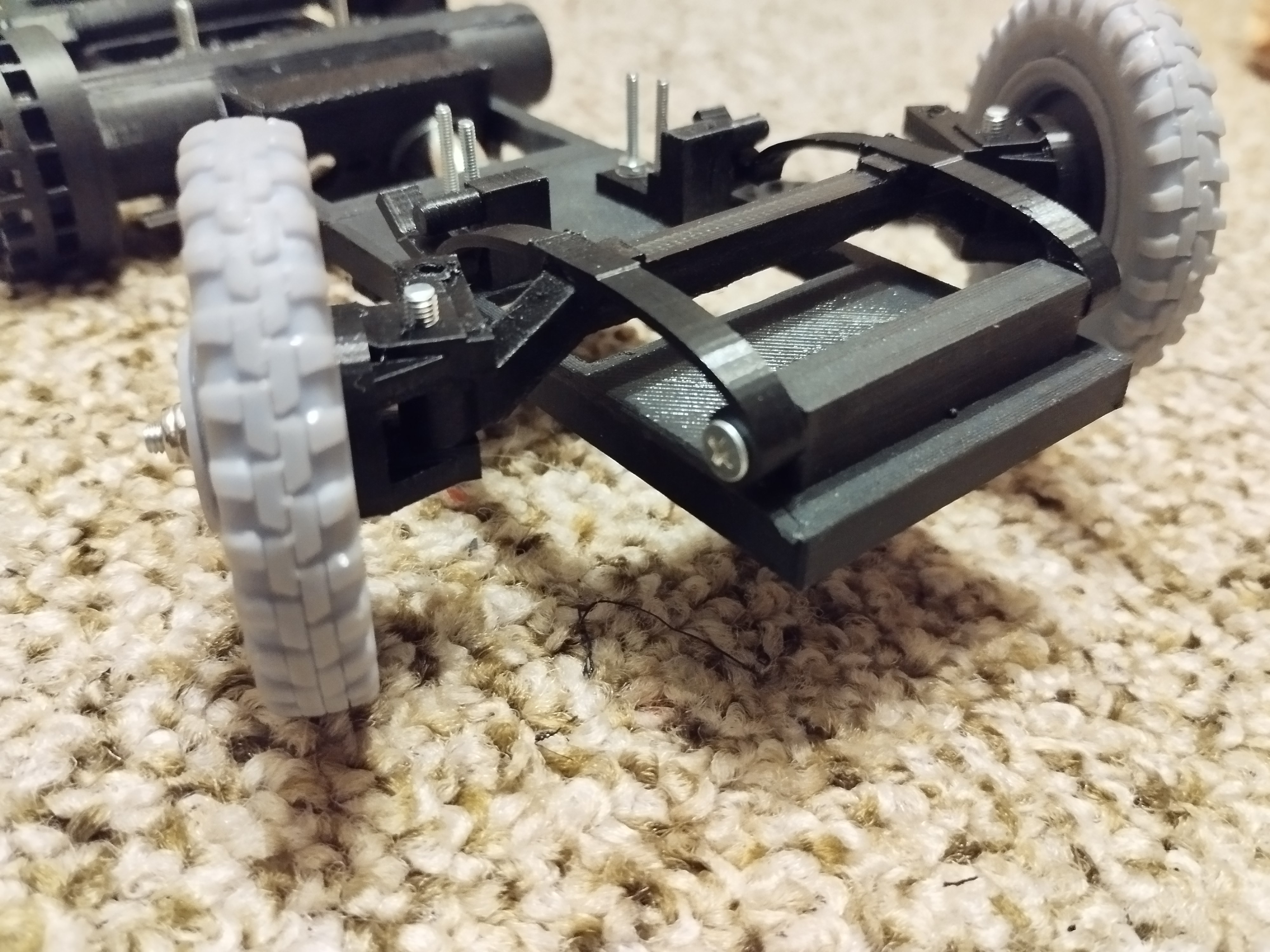

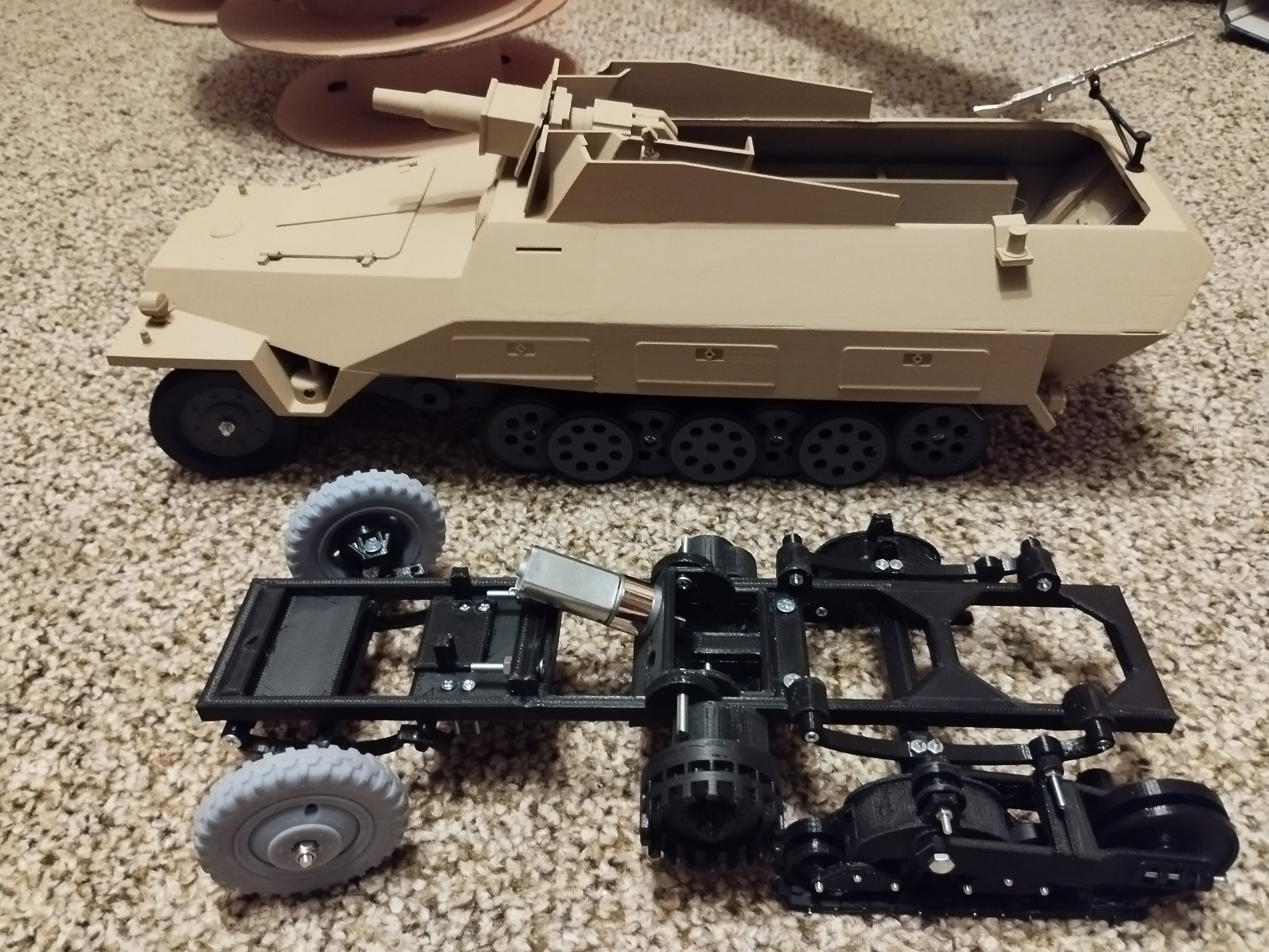

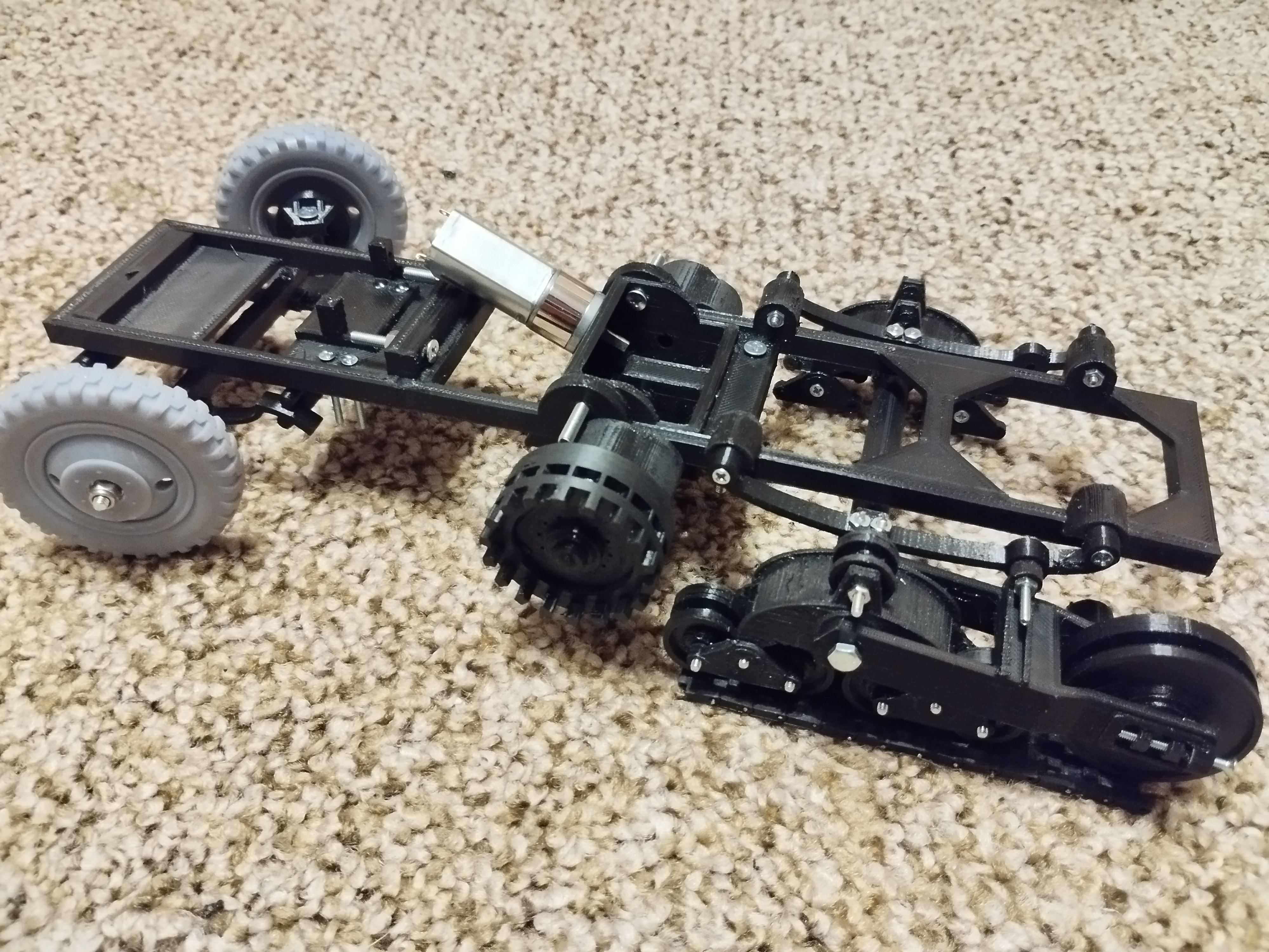

Hello, there's a little more to progress. I looked into the feasibility of the frame, the front axle and the gearbox.
And what can I say, the front axle is based on the WPL principle and the transmission is again built with durable bevel gears.
I'm currently printing the right running gear. 16mm motors are used as drives. But you can also build in 20mm motors.
As a size comparison, let's take a look at my printed SD.kfz 251/9.
The front wheels are only on for testing. These come from the SD.kfz 232 and are still being replaced
Winterhammermodels
Posts: 62
Joined: Fri Feb 11, 2022 1:17 am
Re: Somua MCG with 7,5cm Pak 40
Post by Winterhammermodels »

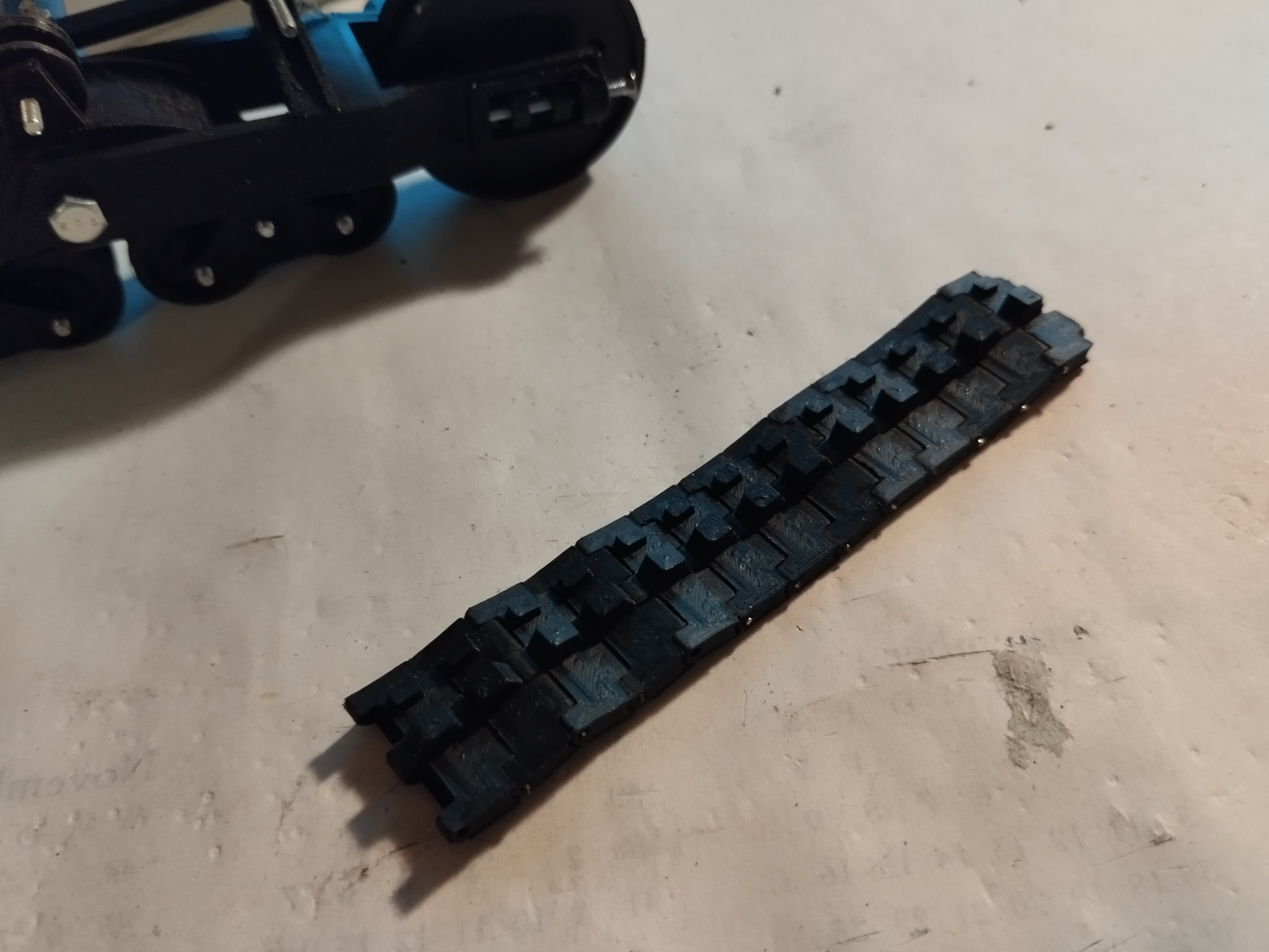

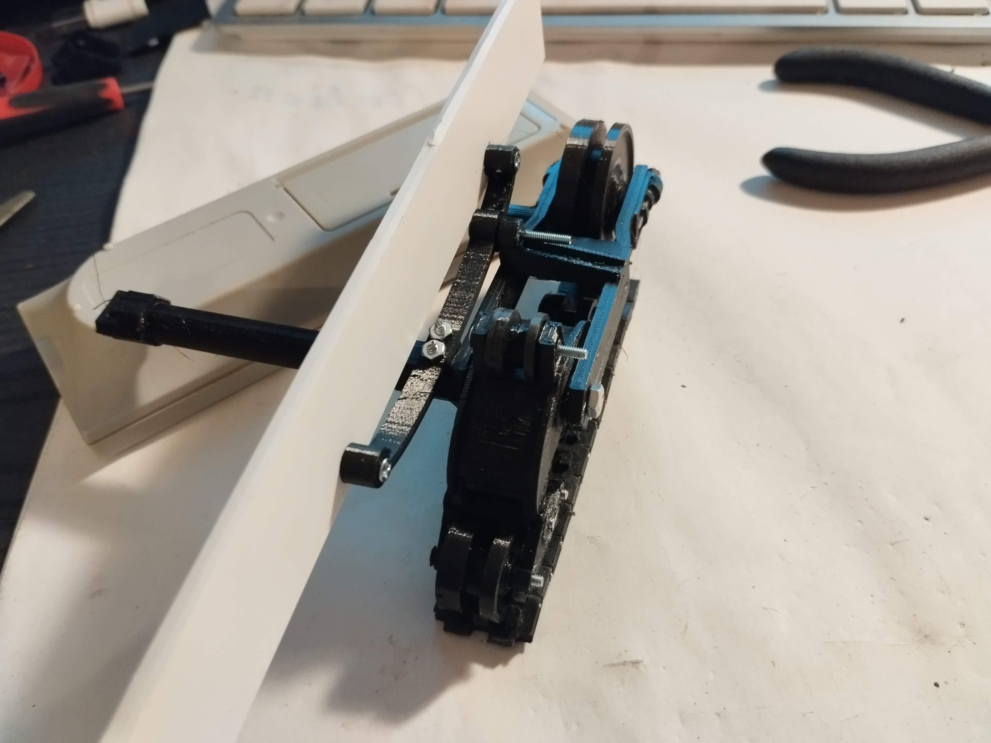

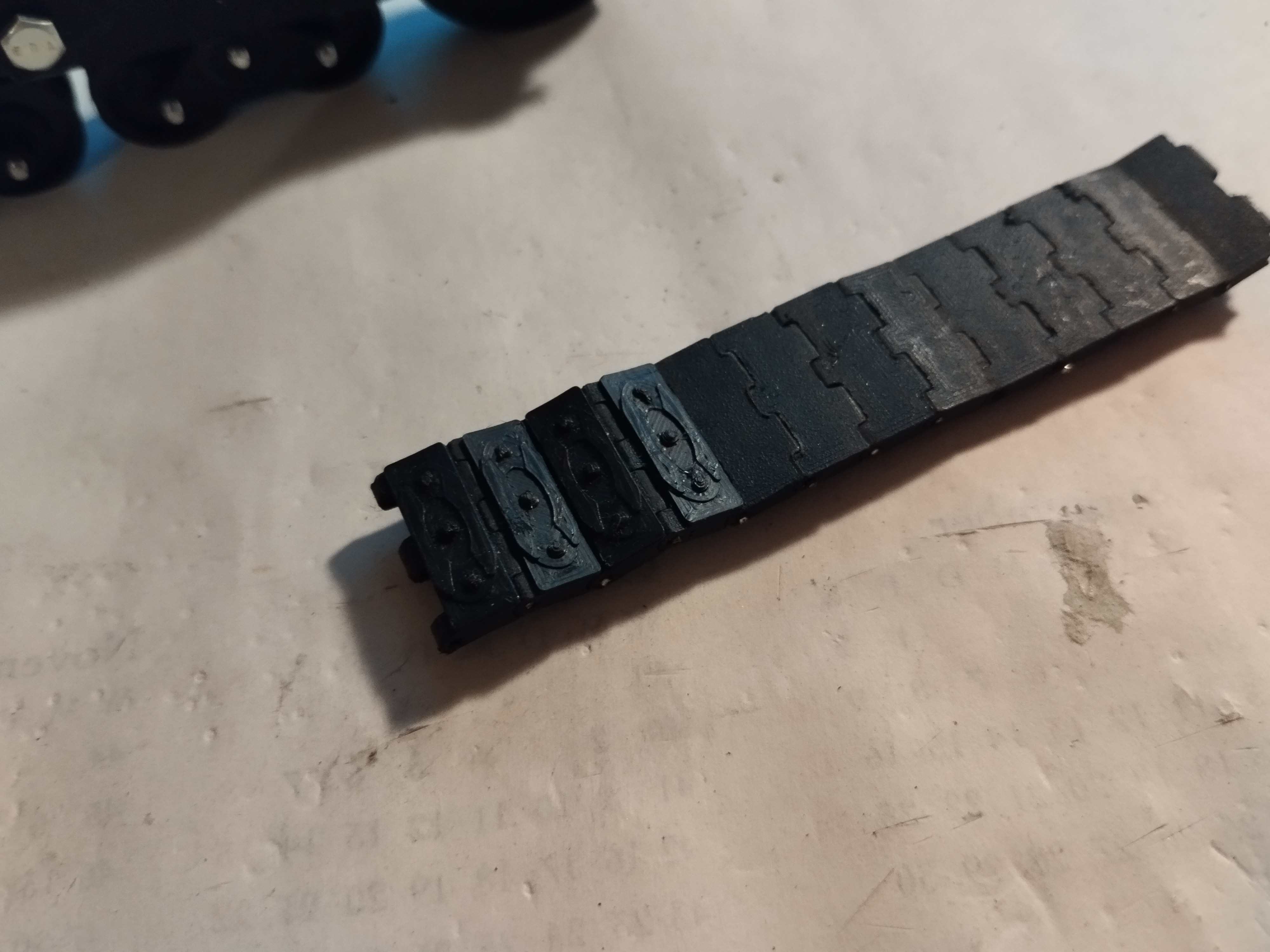

Short Drive Test.
I need to glue the trackpads on to the Tracks. Actually it Had no real Grip without them
https://youtube.com/shorts/WBn6CJ7WiHM?feature=shared
