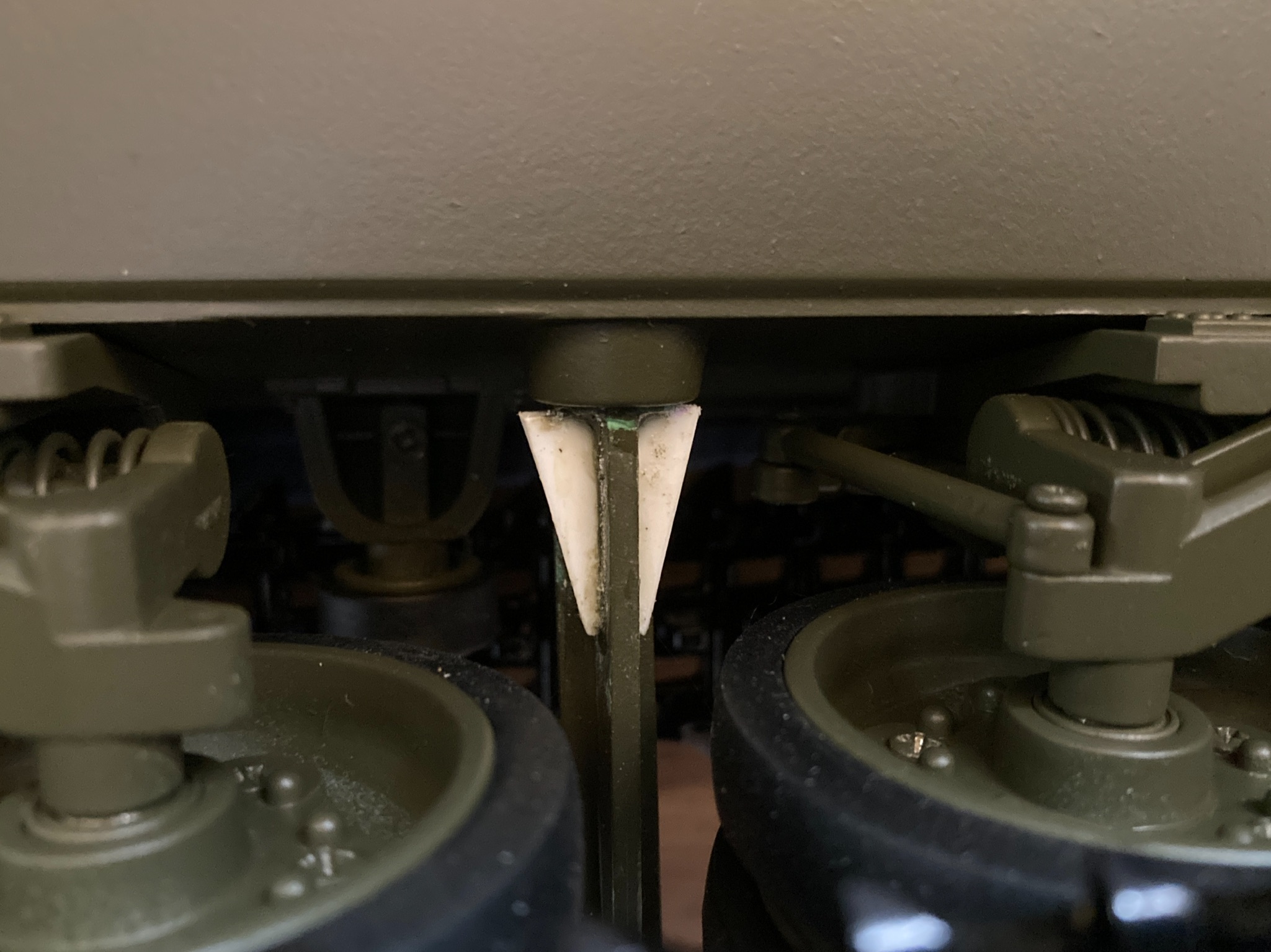

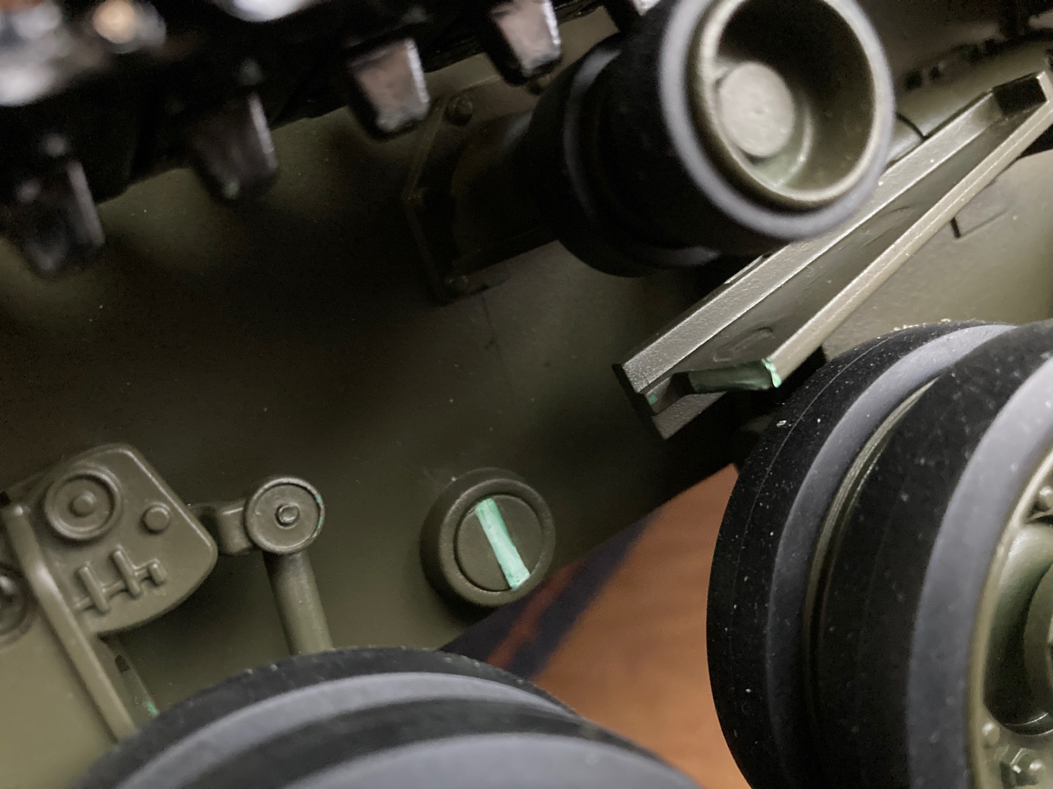

Two of my struts snapped off (as pictured).
I was pleased that mine were not glued at all - if they were glued-in I may never have been able to extract the 'stump" that remained embedded in the lower chassis tub.
This is where my struts broke off

All you would have needed to do with issues like that is get something strong and pointy and tap it through. I end up with broken stumps quite often when I strip em down and I just tap them through with hammer and watch screw driver. Other make shift tools are available

Exhibitedbrute wrote: Wed Oct 09, 2024 4:10 pm All you would have needed to do with issues like that is get something strong and pointy and tap it through. I end up with broken stumps quite often when I strip em down and I just tap them through with hammer and watch screw driver. Other make shift tools are available
Hi Exhibitedbrute,
I am guessing that you do not own a HAYA Centurion?
The sockets that these Bazooka Plate supports push into (on the HAYA Centurion) are BLIND - they are not hollow and have no through holes drilled in them - so it is NOT POSSIBLE to tap or push any sheared-off stump through from the reverse side in the usual way (we would all choose to do it this way if we could - nice and simple!).
Hence the need to pull them out from the front - not easy when you have nothing to get a grip onto!
Please take a look at the picture as it shows that there is nothing above the socket to provide any sort of a grip to pull the broken stump back out of the hole.
Sadly the only place that I have seen any of these HAYA Centurion struts snap off is at at the root (as shown) where the thick moulding transits to being much thinner, so unsurprisingly this is the weakest point and is exactly where these particular struts shear off.
Previous pictures also show the inside of the HAYA Centurion chassis tub - there are no holes inside the location sockets that these struts push into, so any sheared-off stump has to be extracted from the outside by pulling them out.
Bob.
