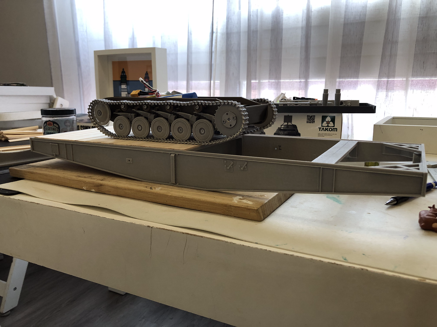

With a panzer I (takom 1/16) to see the size:

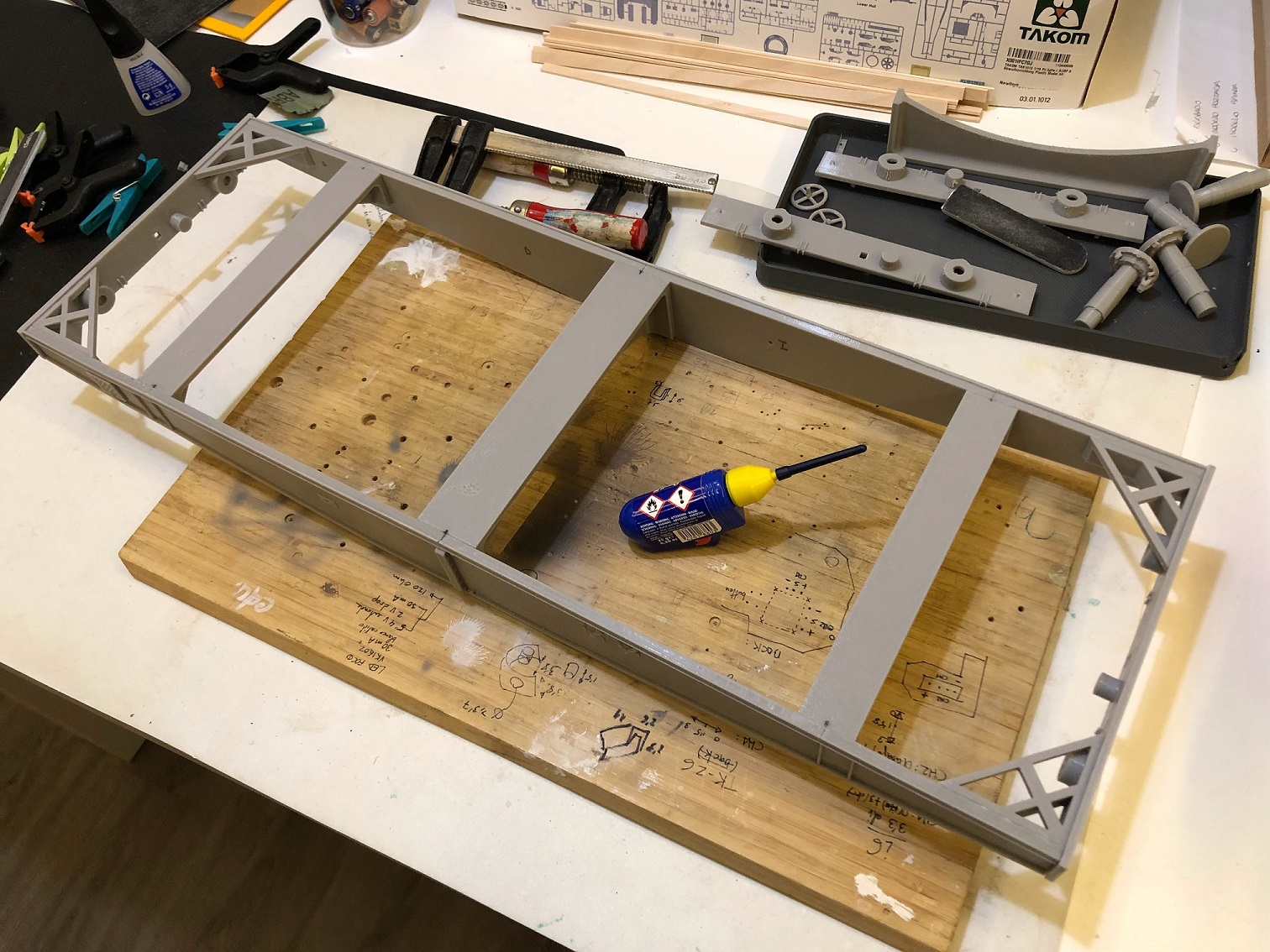

The frame. corners and beams are own design to achieve robustness:

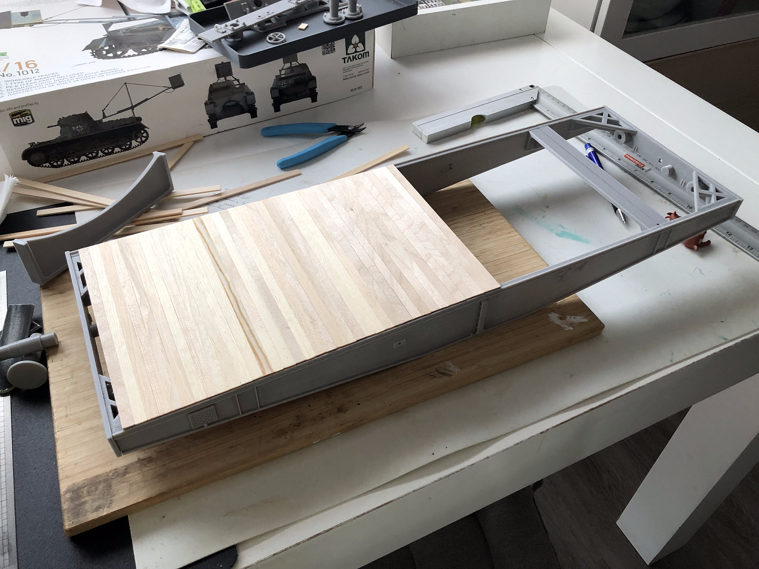

The wooden desk, it will be a lot of slats:

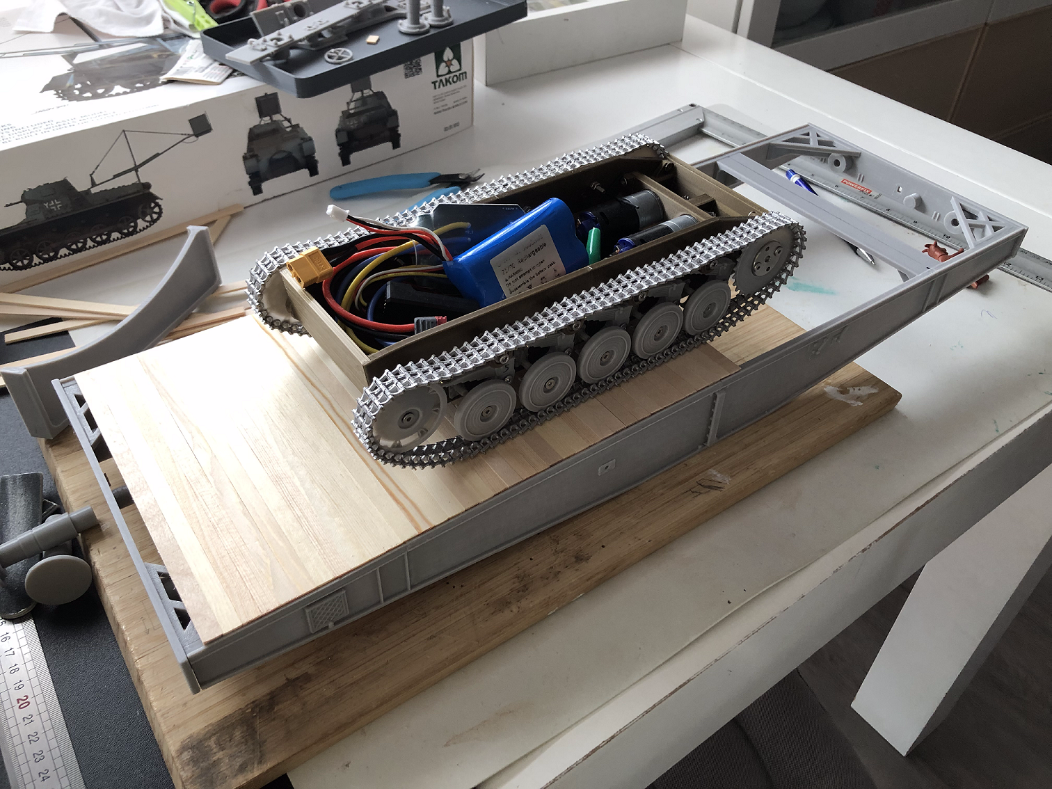

Glued more slats:
Checking the size. Here with a Panzer II, I think two fit in a row:
New details on the front. I usually print the large, flat parts on one side, and the detailed parts individually. This allows me to play with the layer height and orientation when printing.

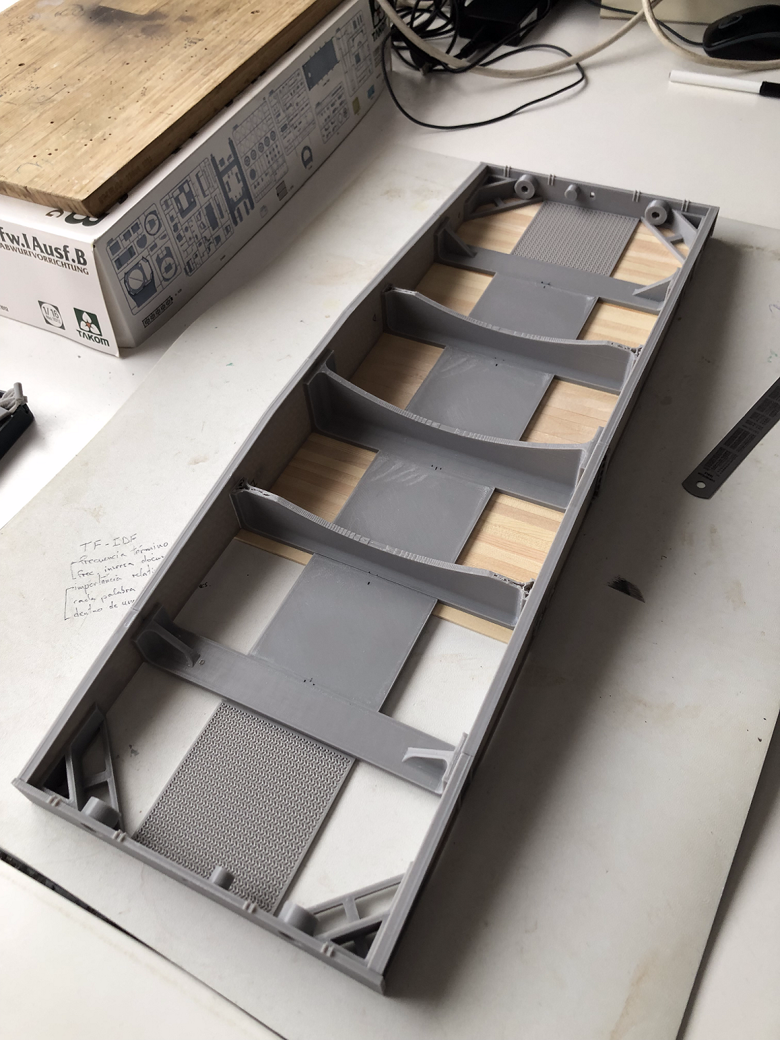

Internal reinforcements:
