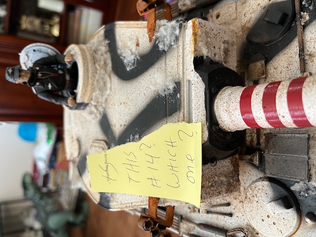

Re: Is the any way to revive birger's old post about fixes to the HL Tiger 1?
mr chef or anyone; see the pix.

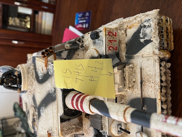

which hole?
which hole?
Mr Chef is from one of those weird countries that drives on the wrong side of the road so when he says drivers side he means left so your number 1 is right but wrong side. But it is the drivers side of the tank as the Germans also drive on the wrong side of the road.
Your number 4 is right. To me it's a lot of work for little gain
Your number 14 the hole you have you piece of paper over is the turret mg the 2 on the other side are the gunners sights. Birger's post are old so had an older tank heng long use to put the red bulb right next to the barrel so it's possible that's what he meant. If you only have the mg and gunners sights then you don't have the extra hole I can't see it on your picture.
