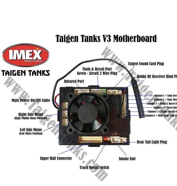

Hi all , had the panther out today , but the bow MG and main gun will not fire , anyone know where best to look ? all other parts work , sound moving , turret and gun up n down and gun mg . thanks glen

Hi All , its the standard torro / taigen board , and the gun does not work at all , no flash , no re coil no sound , all wire s seem ok all plugs seem firm

so it's a V3 type card? Asiatam ball or recoil firing system?

yes its the v3 recoil IR version , it was working 100% , the main power switch broke , i replaced it , now everything is ok apart from the main gun flash recoil gun sound

Did you ensure the earth onto the on/off switch was reinstated to factory configuration ?
