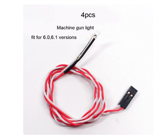

My machine gun light is not working, so I decided to disassemble it, I disconnect the cables, reconnect, check the cable throughout the line to the LED unit on the turret but I still don't find any damage, I'm not sure what's wrong with it but it's not working.
I wanna know where I can find machine LED ligjt for the replacement?
Also I found some spare part for machine gun light online but it's for 6.0, so the question is, will it work on 7.0?

When you checked the connection from the HengLong 7.0 board through the wire to the LED, did you do a continuity test and/or did you read the voltage pulse? If you did neither, no worry. This LED should be an easy and inexpensive fix.

It is possible it was installed backwards. LED = diode (one way path for voltage).

Okay, I did check and try both ways and it still doesn't work.
BUT here is some progress, I tried installing the Tank headlight cable (LED3) into the LED5 (machine gun) and firing, and the headlight blinked like a machine gun!! so now I can assume my machine gun LED is busted?
and can I just find another LED light for the machine gun?
like I said, on the website I found it said fit for 6.0, 6.1 but it looked Identical to me. Do you think just this LED can do a replacement? will it work since it's just an LED? or does it need something specific for the 7.0? Thanks!

Is the tank one you've just bought? If so, I'd give Heng Long a call and see if they'll send you a replacement. Your checking it with the headlight is a great idea and good proof that the MG light is defective.
