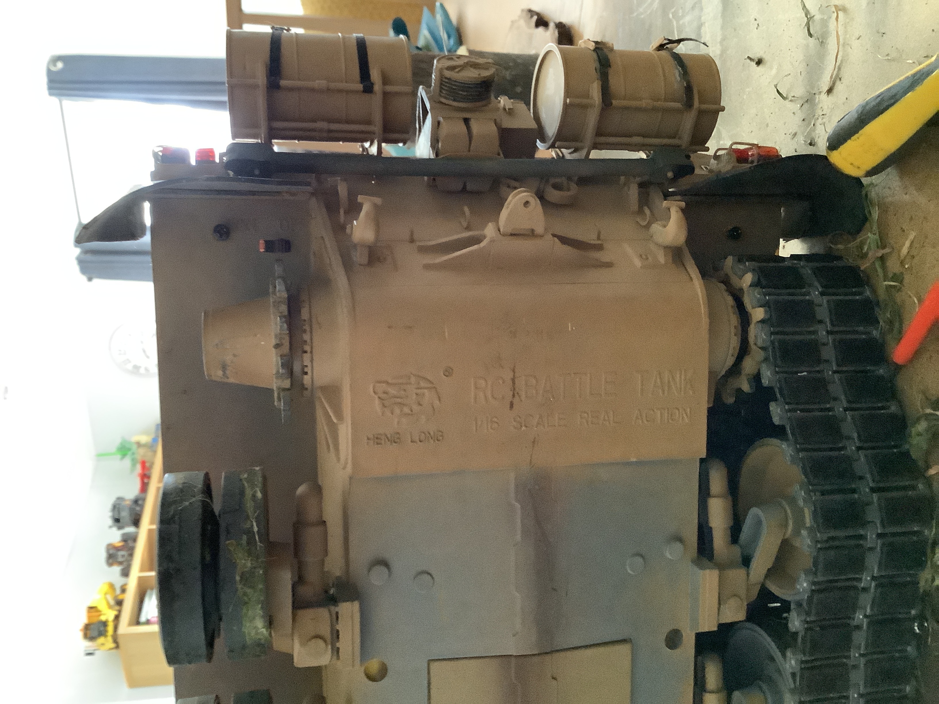

Working through the suspension on the Challenger and installing stiffer springs on the front and rear road wheels, I am trying to work out how to remove the gear box. There appears to be screws coming from the bottom, but not showing on the lower hull.

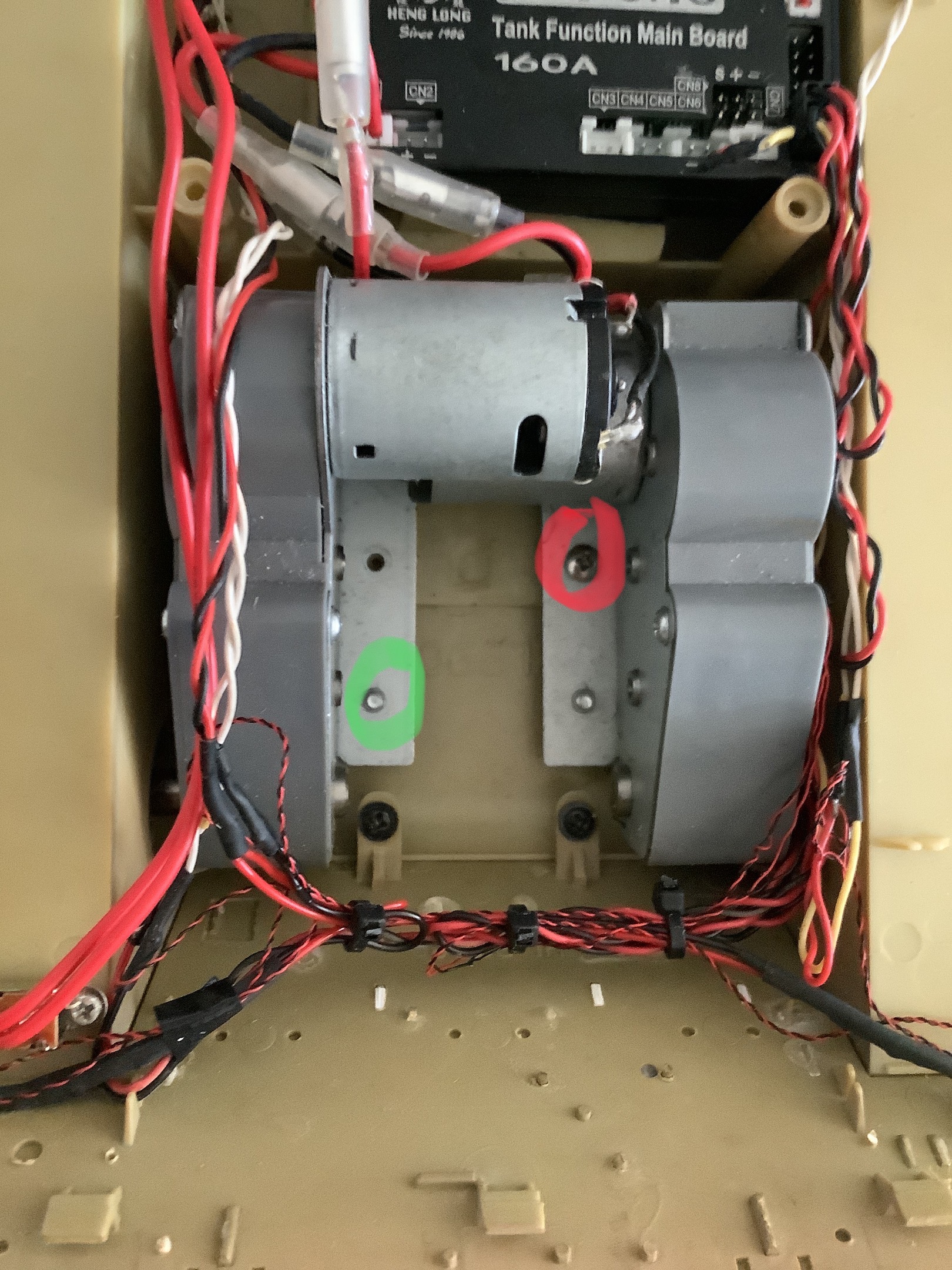

I join Kaczor, and Tank me, have you removed the plastic lids? as Tank says me? there are generally screws inside, and as on the attached photo, in green for assembly, in red for fixing, do not forget to remove the tracks, and the drive sprockets :thumbup:
