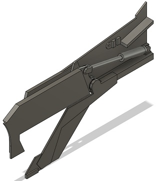

I've been getting more and more interested in armored engineering vehicles. I've been working on CAD modeling and test prints for a scratch-built US M9 ACE and a M1150 ABV conversion (HL M1A2 Abrams). Both projects have hydraulic features that I keep getting bogged down on the best way to replicate.
Some features I've decided to skip (hydraulic suspension for M9 due to lack of space around front suspension), and some features I've decided to go with a mechanical solution (control wires for M1150 MICLIC lids and gear motor actuator for M9 ejector). However, I'm still trying to come up with solutions for raising/lowering the M1150 mine plow/dozer blade and the M9 dozer blade.
I've seen a traditional Abrams mine plow done with gear motors. I've also seen a C2 Mexas dozer blade done with some large, partially concealed cylinders (not sure if air or fluid). While both are options, I'd like to find something that has a more appropriate scale look and function if possible. Either way, I'd be interested to hear what has/hasn't worked for anyone that's tried something similar.
For the ACE, the big issue is the hydraulic cylinders on each side that raise/lower the dozer blade. These are both very visible and relatively small with a short stroke. Scaled up to 1/16, the cylinder body O.D. is only about 8mm. I've found a number of options that are readily available, but much too big. I've found an option on ebay out of China that has the right O.D., and may be able to be modified for a shorter stroke, but if my guess is right about their internals, they're going to be weak. Even with 3D printing, the dozer blade is a large portion of this vehicle.
Any suggestions would be appreciated. If I need to provide more details, please let me know.

Just for reference, here's a close-up of the left-side hydraulic cylinder for the M9 blade. Thanks again for all the advice.
