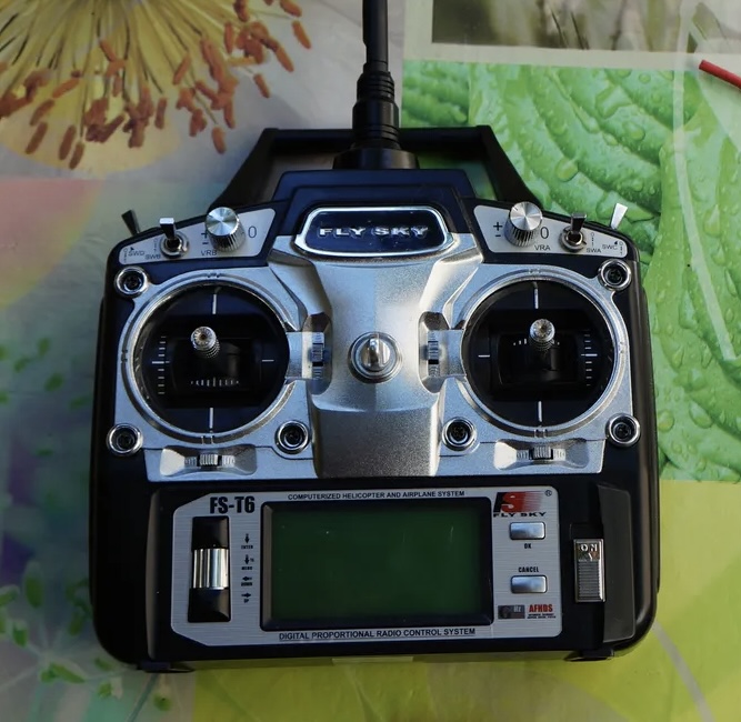

this kind of radio is very good, 2.4 Ghz 6 channels, delivered with the RX and easy to use, there are others of course?
It's a Flysky FS-T6

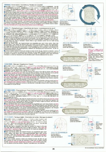

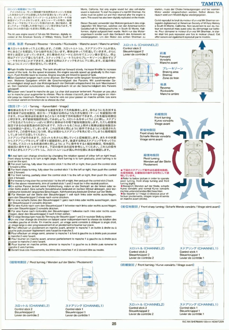

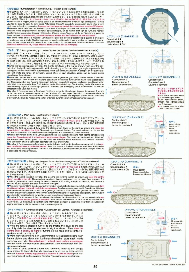

From the way you are talking about your tank, I assume you have the original Tamiya radio that looks like it has two channels with trim tabs.
That radio does have 4 channels, the problem is that the extra controls are through the "trim levers" on the remote.
Channel 1 (Multifunction control, right side)
Channel 2 (Throttle, left side)
Turret rotation and elevation, main cannon, machine gun, and lights only work when you are not moving (aka no touching the Channel 2 throttle stick).
They also use the channel trim levers.
Turret rotation - Channel 1 stick left or right
Turret elevation - Channel 2 Trim down, then Channel 1 stick left or right
Main Gun - Channel 1 Trim to right, then fast Channel 1 stick to right
Machine Gun - Channel 1 Trim to left, then quickly Channel 1 stick to left
Turn lights on/off - Channel 2 Trim Down, Channel 1 Trim to Right, then quickly Channel 1 stick to right

:D Good evening, I want to work in 4 channels? but at the cost of a lot of gymnastics between the sticks and the trims to modify the position, I think it's easier with a 4-channel radio, programmable, no need for the trims, all the functions with the sticks.. now it's not is just my personal opinion :)
