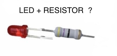

Hi Guys, I have just got a new Taigen v3 board for a Sherman and am wondering about my flash options. The Sherman does not have a mussel brake so I would like to use a 5mm clear/yellow led so that the light shines forward. I think that the Taigen high voltage flash shines to the left and right, making it best for guns with a mussel brake which can conceal the diodes.
So, can anyone tell me how to connect a 5mm led for the main gun flash. I am not sure about the wiring. Can the 5mm led just replace the Taigen diodes or does it need a resistor? Or can I just replace the high voltage unit and connect a led ?

for Led flash, on the CN3 plug you have
starting from the left,
1: red = the most of the Led
2: green (strobe) not used
3: black, less led
4/5 green and black, inter switch of the ball shot, here it should work, some recommend the installation of a 150 Ohm resistor in the plus of the Led, I personally haven't put any, rt still works?

Rectification, following me mistaken!!! the plus of the Led is connected to the 2nd pin of CN3 and not the first? sorry

I'm not saying you don't know what you are talking about, but I'm confused why you posed a wiring diagram of a HL 5.3 system? The Taigen v3 has a completely different wiring diagram than the HL 5.3 version you posted. I'm sure the BB diagram is probably correct if this is a HL Sherman converted to Taigen electronics, but I'm not sure what tank he has (whether it is Taigen or a HL Sherman). We know Taigen doesn't have both BB and IR on the same tank. Their tanks are either sold as IR or BB, but not both like the newer HL. The Taigen V3 doesn't have a specific cannon LED slot that is separate from the high intensity slot like the HL v6 or v7 boards. I'm not sure what the voltage is that comes out of the Taigen LED port. I think that is the big question here. If it puts out too much the LED will need to have a resistor on it to limit current. I've seen a lot of posts adding the high intensity to all kinds of boards, but can't find any fitting a standard LED to a Taigen V3.

So or am I explaining myself badly or are we not understanding each other? The photo of the HL plate is just to show the wiring of CN 3 which for me is the same on a Taigen V3, For the Led? I forgot to specify, that in my case I bought this LED from RCTank.de, and not used a standard LED? For the resistance? I admit moreover the memory if installed one? I did not invent anything, this being from a post from the RCU forum that I copied, for a PZ 3 since at the time there was no flash with LEDs, which could fit in the existing barrel?

I am using Taigen v3 electronics but want to use a 5mm led instead of the Taigen led. Does anyone know how to change this ?
I am thinking it is a matter of replacing the Taigen led with a resistor and a 5mm led.
