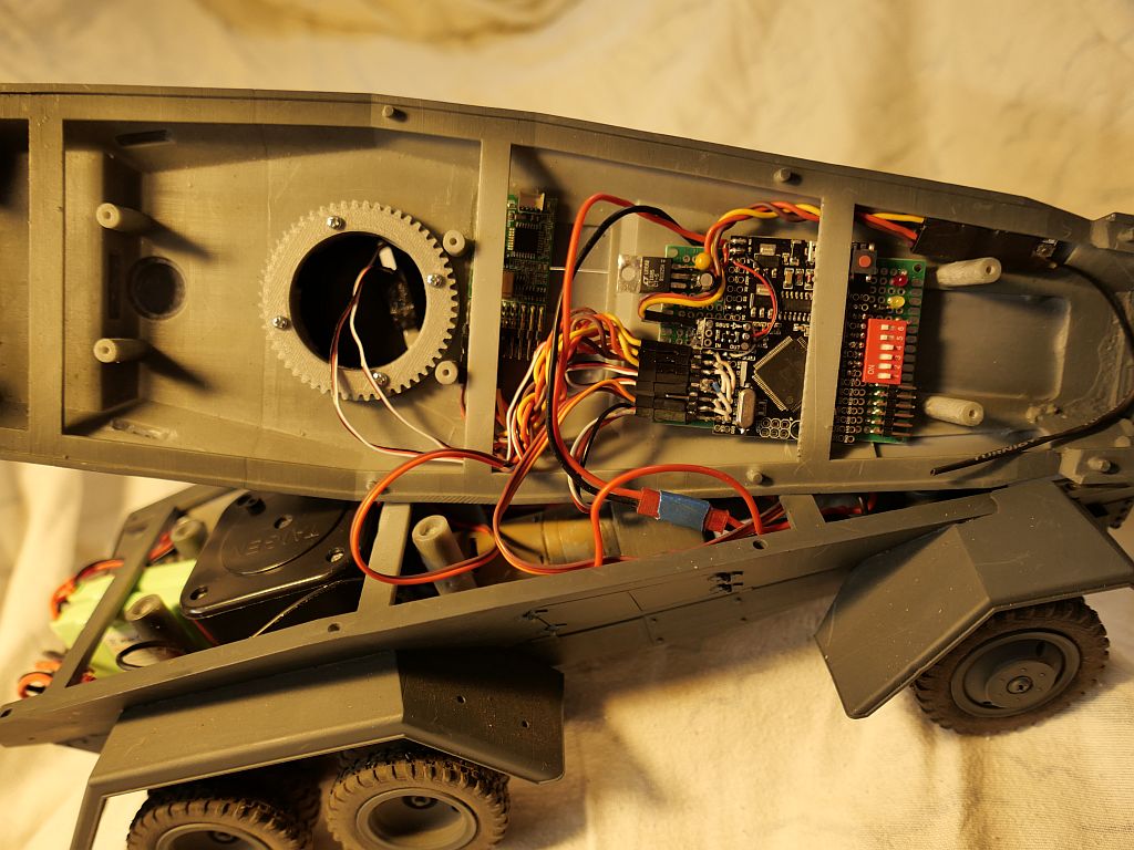

Woah man, first of all I applaud your effort and skills, but I have a question. Please don't take it wrong.
I'll start saying I have one Open Panzer TCB with the Open Panzer sound card prototype in my King Tiger and I like it a lot. I just had to add the dual ESCs, receiver and done, but the question is: What is the sense of building the TCB you have created?
I mean, you still have to wire speed controllers for the motors, you are using servos for elevation, recoil and other moving parts, you are also planning to use a benedini mini for all the sounds and lights... What I mean is, besides IR battle capability, I don't see any need for using a TCB because you can do all that the TCB does just programming your radio.
I have a tank that way, dual ESC for motors, mini ESC for smoke, servo elevation, servo recoil. The benedini mini takes care of all the motor sounds, user sounds, 2 machine guns, headlight, spotlight and noteks. Inertias, curves, speed of recoil, track recoil and all of that, are programmed with the radio using erskytx or open tx software. So what I mean is I see no use for the TCB itself as it is.
At the other hand I'd find all the sense in the world if you make an all in one package with soundcard and ESCs integrated. There is a guy in the OP forum, Heclo, which has created his own version, all in one, and added even more functions, and sells it for a very reduced price. That is really, really cool.
Hope you end making something similar :thumbup: please don't take it like a critic, I am just curious, and hey, you might end making your own ultimate improved version!

Hi Rick, I'm very impressed. You went from a self-confessed novice to a professional circuit board designer in very little time! And now you absolutely do have something you made yourself which is very cool.
I'm interested in the green and red connectors on your final design. If I had to guess it looks like you've provided convenient power taps to your two drive ESCs (green), and I guess the two reds are one for the battery and a second for powering other stuff?
As you mentioned there have been several other users who have made up their own designs and it's always interesting to watch as each one takes a slightly different approach. I very much like what you have done, it is clear to me you put a lot of thought into what you needed and what could be let go. Some features have been left off, but what remains probably does 100% of what 90% of users would ever want, and in exchange you have gained something easy to assemble, small, and I'm guessing also inexpensive; all worthy advantages.
My hat's off to you, and I'll look forward to seeing it in your next project. (I just checked out your Brummbar by the way, it's fantastic!)
