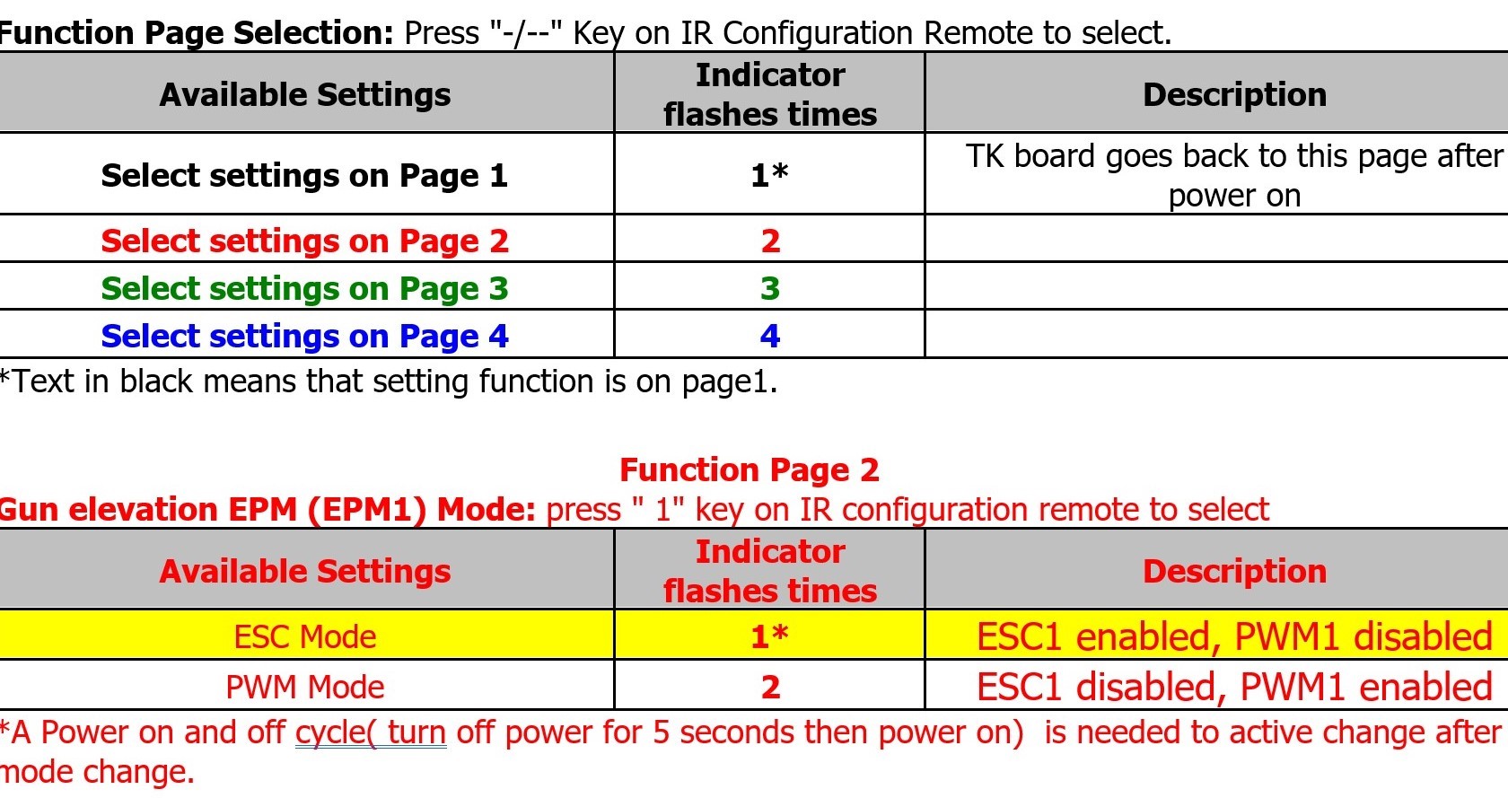

Yes, I think it's in the second page of settings. If you're in esc mode then it'll do some very erratic things with your servo!quitcherbitchen wrote:So elevation is as easy as using the tv remote to activate? Wow I did not know that. That explains the weird servo movement. I will read the clark manual for the thousandth time and see what I have to do. Can't believe I missed that. Thanks for the tip.

So which button shuts off the ESC1 and activates PWM for elevation? Nice little cheat sheet.

You have to go to page two of the config:

Yes the recoil is always on. The other two slots have to be activated. Do I hit the 1 and then the 2? Or push 1 twice?

It will be in ESC mode already since that is the default indicated by the *. Hitting 1 will move it to PWM mode as the light on the battle system will flash twice. If it doesn't flash twice then hit 1 until it does. If it flashes more than twice...you are changing the wrong setting... You have to have a battle system installed or use the Clark "IR Programming Line" attached to the board. The remote signal is being captured by the battle system or IR Programming Line sensor and then uses the LEDs on those to show the mode it is set to. You can see from this video at time index 5:56 and example of how to program the Clark board. https://www.youtube.com/watch?v=yam654wo2hg.
