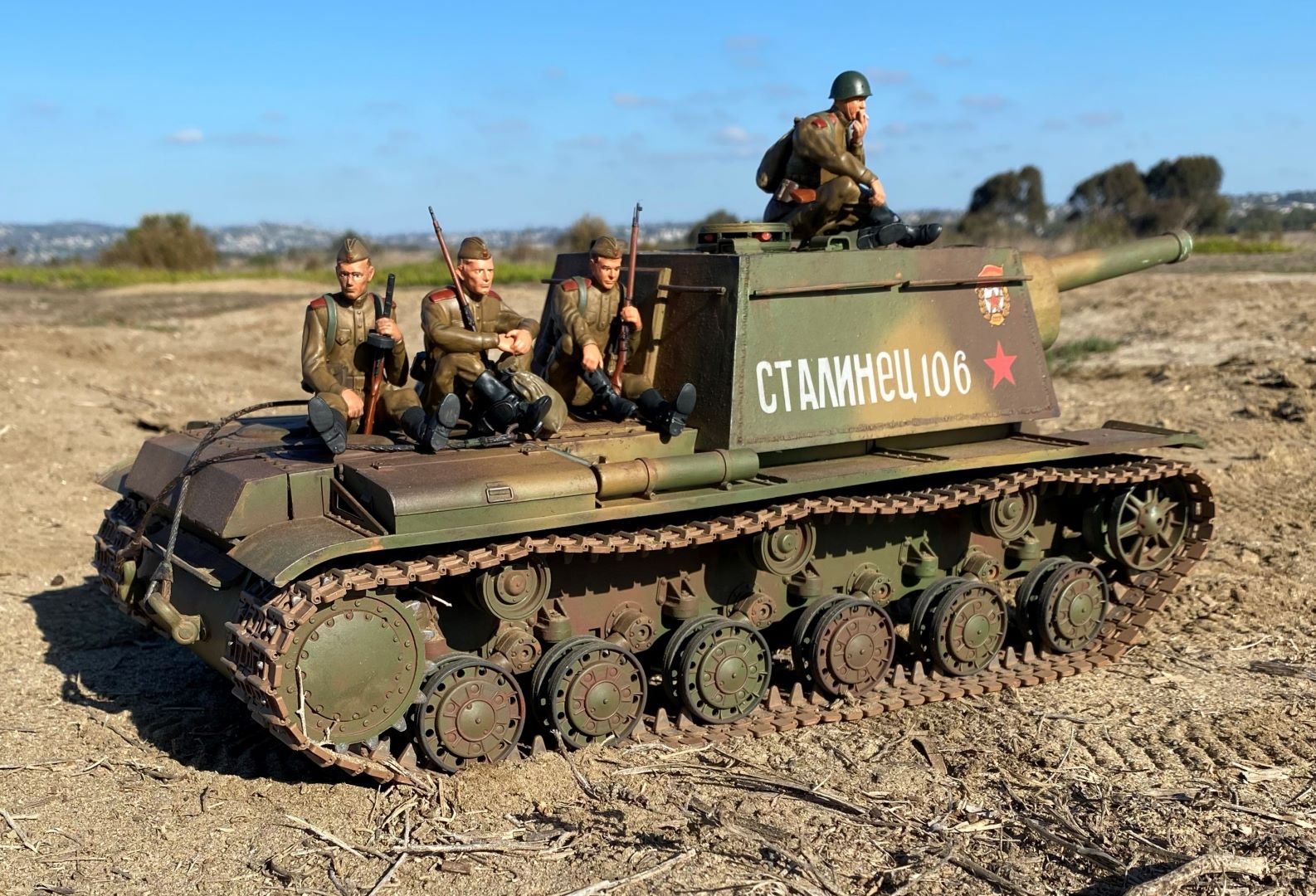

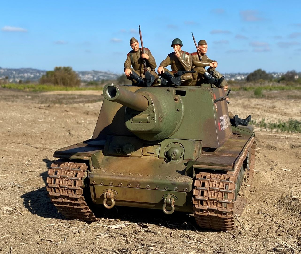

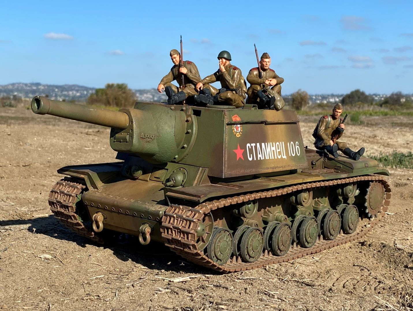

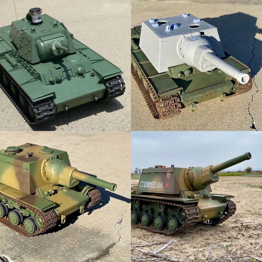

This is a conversion kit from Vandramodel.Hu based on the Heng Long KV-1. The Zik-20 was a "fixed turret" tank as the Soviets termed them, to be armed with a 152mm cannon. The design was developed but never got past a wooden mockup stage. This made it easy for me since I could ad-lib as desired. The kit is very simple; remove the turret and fit the new casemate on the body, and install the mantlet and barrel. I used a Heng Long motor to elevate the gun and did not install any traverse.
I use the Zik in IR battles, which is why there is a LegoDEI IR receiver mounted on top taking the place of one hatch. Discerning eyes will notice that the flush mount and height will improve incoming hit resistance! My IR emitter is in the barrel, which required the most work. I had to buy a long 5mm drill bit to open up the bore.
The camo scheme is the "official" Soviet scheme, which was used infrequently in real life. The decals are Peddinghaus originally designed for the KV-2. At least I kept it in the family! The riders are 3D-printed from files on CGTrader, painted by me.

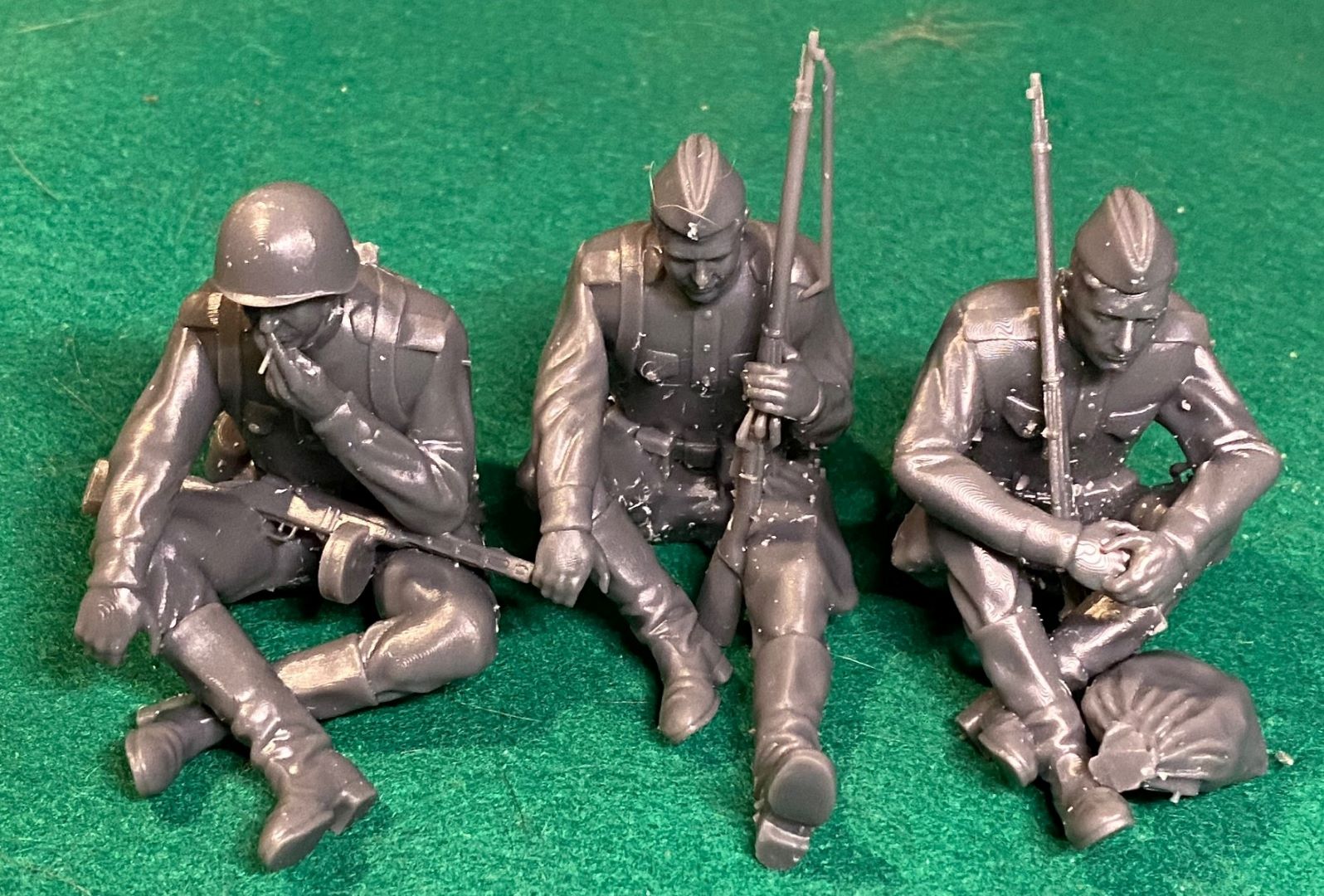

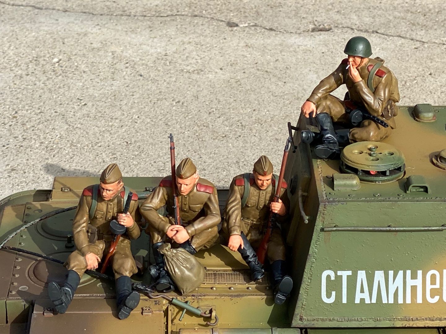

You guys seem interested in the figures. I know I was excited when I found them, I knew just where I wanted to use them. My friend printed them in resin, so the surfaces were smooth. Wonderful sculpts, makes painting easier.
Each soldier is a single cast, with detailed and accurate weapons as part of them.
There are similar figures for German and I think American soldiers.
