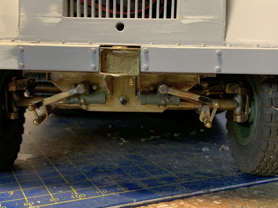

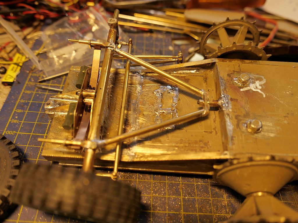

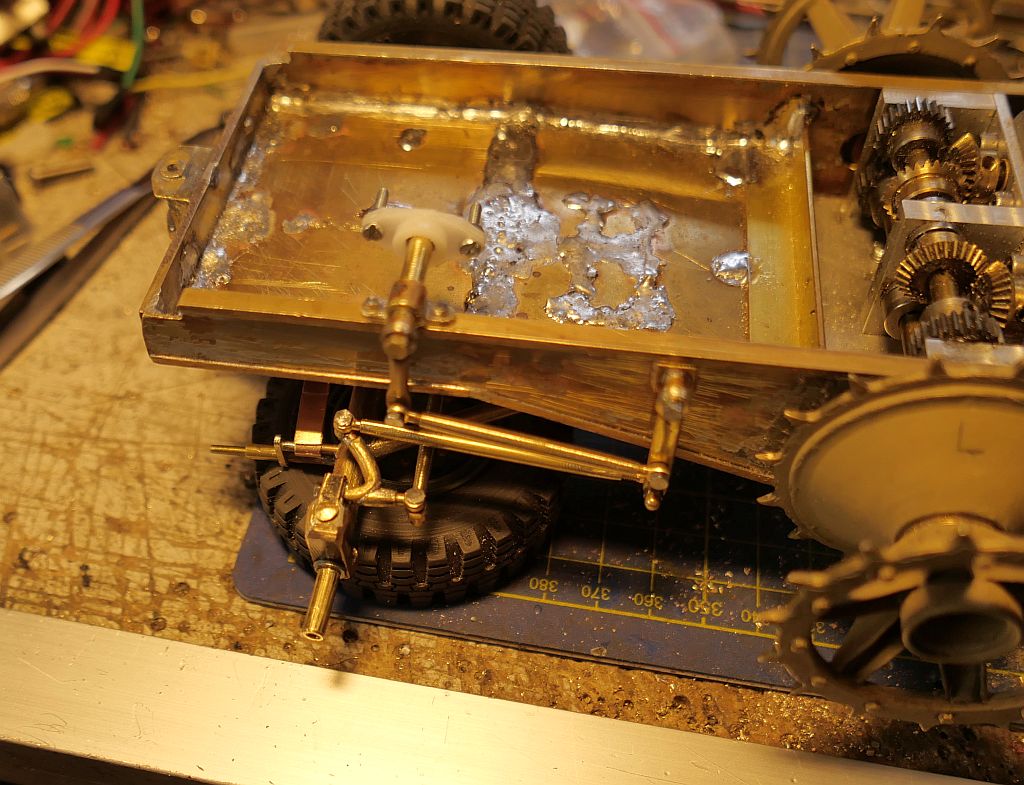

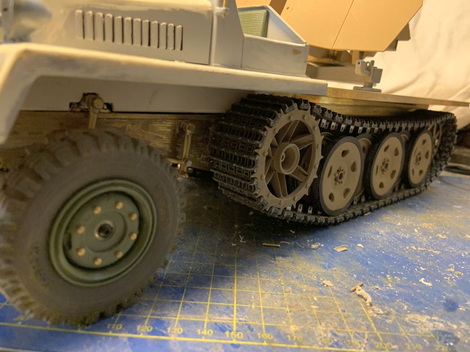

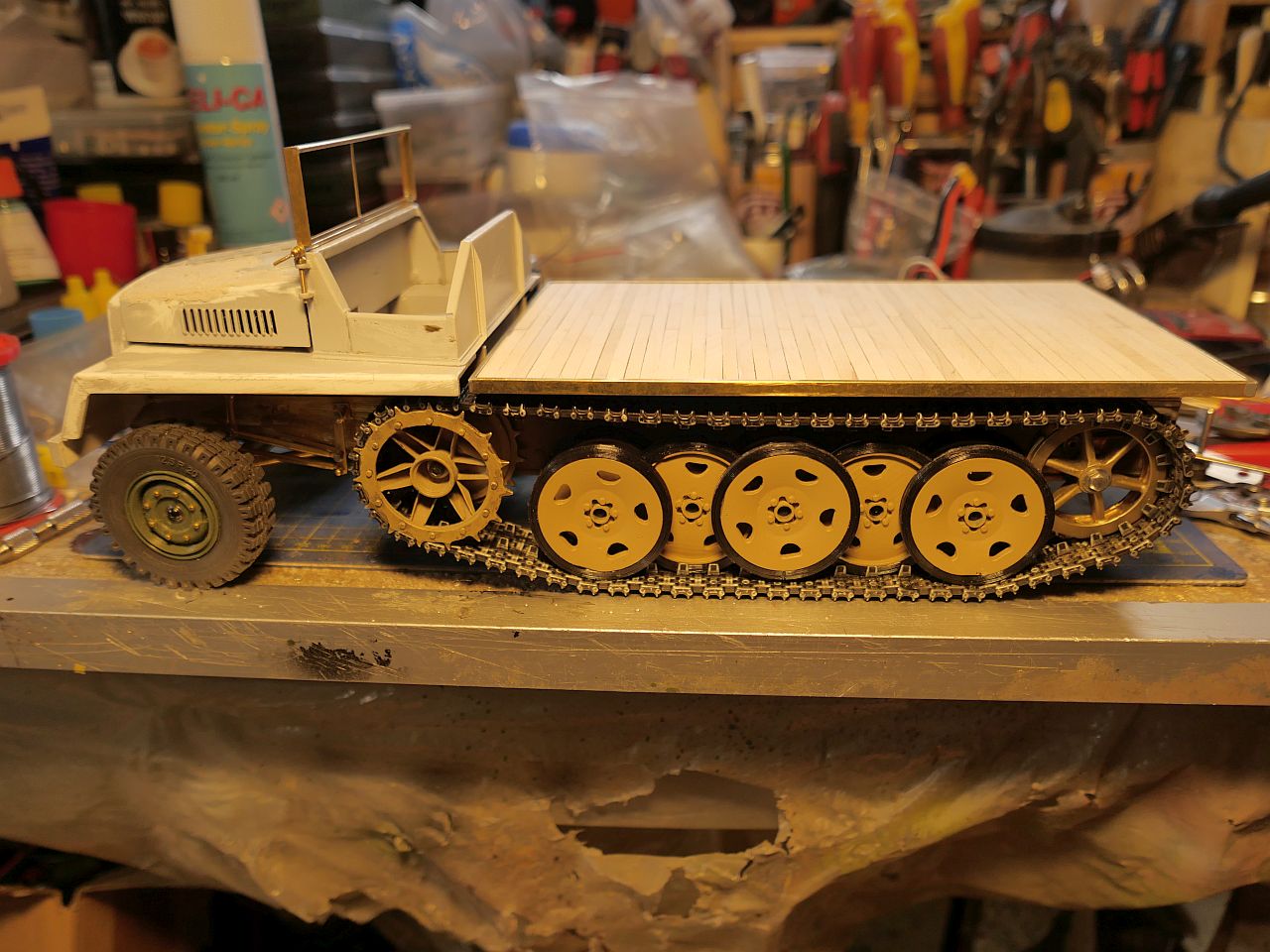

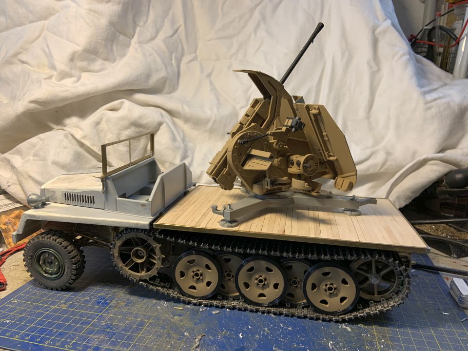

here some pictures of my actual Build the sWS schwerer Wehrmachtsschlepper with 3,7cm Flak 43

A very well executed piece of unusual hardware not often seen on these pages. Looking forward to the next chapter. :thumbup:

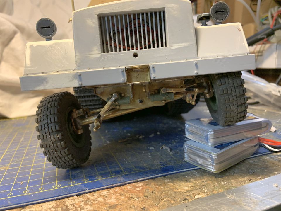

Sheer magic, Jürgen :clap: Ohne Zweifel- you have the mastery of lead solder, and linkages!. The pic highlighting the suspension (wheel propped up on books?) almost harks back to the days of Tonka Toys!, That made me smile!. :thumbup:

Looks great, i really love the front axle setup, love those extra little details

That brass work is spectacular Mr Jhamm, perhaps you have a job in IWC Schafhausen ? :O

HERMAN BIX wrote:That brass work is spectacular Mr Jhamm, perhaps you have a job in IWC Schafhausen ? :O
Not really.
1976-80 I completed an apprenticeship as a precision mechanic.. now i work as a sales engineer.
Re: sWS "schwerer Wehrmachtsschlepper" 1/16
Posted: Thu Dec 16, 2021 9:45 am
by HERMAN BIX
Well I'm guessing you are very good at it................
How do you come up with the ideas and method for such fine work ?
Its things like this, Barry C, and Mr Mcq11's work that defies belief, just to pop those off the top of my head.
Exquisite work.
Posted: Thu Dec 16, 2021 10:23 am
by jhamm
HERMAN BIX wrote: How do you come up with the ideas and method for such fine work ?
It is the material and the possibility to create something out of it with simple means.
Brass is easy to work with a file.
It can be joined by soldering with a soldering iron.
You can also create shapes with solder.
The same with polystyrene and super glue.
The idea is born in the mind...
