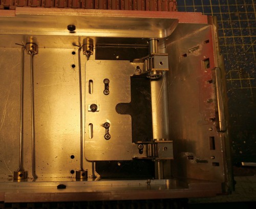

Yes it will fit in a Taigen/Torro KT Hull.
But, it's not the right thing for realistic driving in KT.
Imho the Taigen Premium Gearboxes 7.1 version 3 for King Tiger would be better.
The Heng Long Dual Current Driving System is quite sensitive with the gears on the drive shafts.
These should definitely be mounted with additional ball bearings near the sprockets.
The lasered base plate does not have enough stability to support the drive shafts properly.
Here is an example of how I mounted the base plate in the metal chassis of the T-90:
