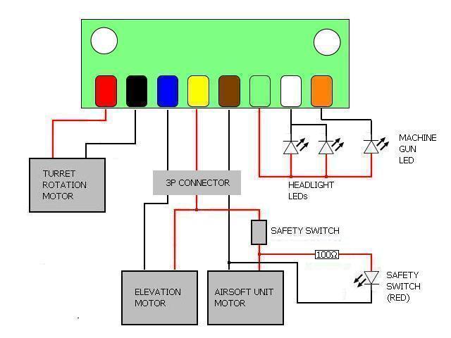

This is the wiring convention I initially followed together with switching round the 3 pin connection:- elevation (-), recoil (-) & common (+). Resulting in constant recoil & LED OR constant elevation.
I’ve sorted this sort of issue before on a Panzer IV, however that used a Taigen combined recoil ‘elevation unit.

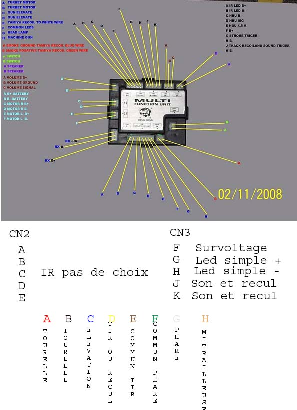

:D Hello,
In view of your photos, for me there is a connection error? :{ indeed it seems that there are common connections with CN2 and CN 3 if I follow your wiring correctly? CN 2 is only intended for Infra Red mushroom and CN 2 specific to flash, whether Led or Xenon
here is how plugged into CN3, J / K being the swicht andGH power supply Led flash, hope you will solve your problem
