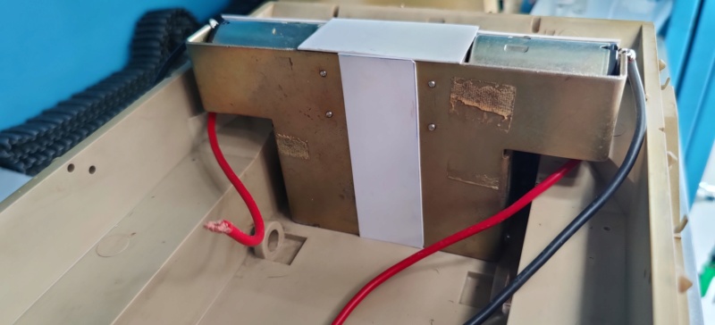

Since those engines have practically never turned, let's see if they still work:

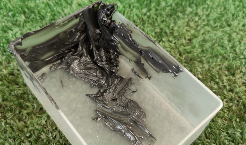

The grease has become a sticky clay. A couple of suspension wheels have play. We clean everything
We apply molybdenum grease:
We isolate the transmission compartment:

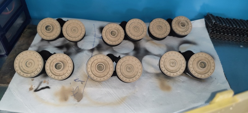

Let's move on to the rolling train.

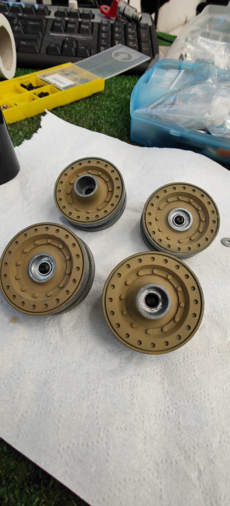

Each wheel is opened, cleaned, reassembled. The metal couplings are blocked with a drop of medium loctite (with the heat gun you can go back). In place of the Phillips head screws, cylindrical-head screws with hexagon socket are installed in the visible points.
Each element is locked with loctite 222.
Transmission area isolation completed
Reinforcement on the crack
Suspension wheels ready to be re-loaded

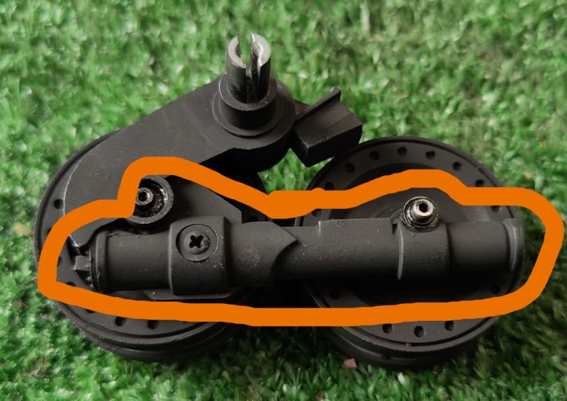

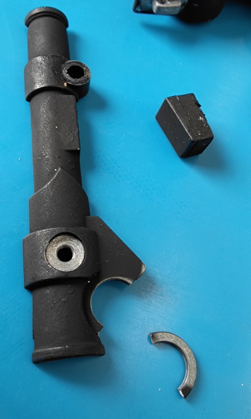

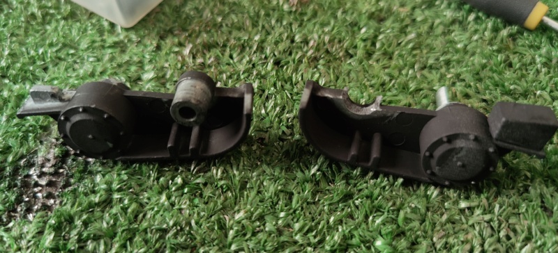

The flaps of two trolleys split apart as I pulled the bolt over. I put everything away this morning and I start to understand why:
[url=https: //servimg.com/view/19377001/3332]Image[/url]

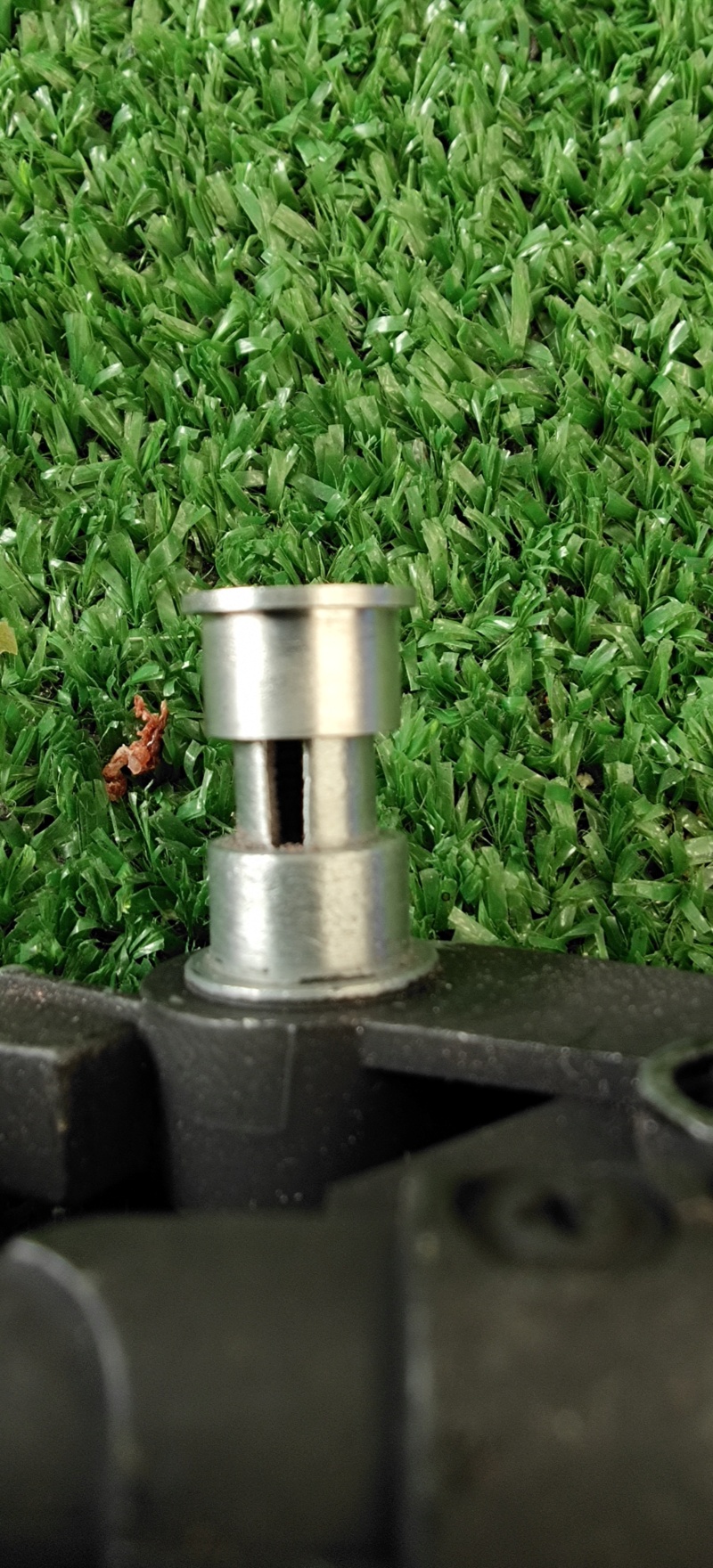

Third break ... In practice, the spring that creates the suspension opens the fins. Sometimes the material resists, you can see the cap that goes in effortlessly:
On the other hand, when he strains, he puts pressure on them and breaks them. I start to disassemble:
There is no shortage of surprises. But let's continue with the other carts:
Another break
Another break
Every three parts you take apart you find two broken. The material did not hold up to the springs. Too weak ..
Yesterday I ordered the canted arms, the ones where the lugs are. They cost € 3 per couple. € 9 for spare parts and € 20 for shipping.
With today's news I wrote to Asiaam if by chance they also have horizontal arms.
If they are not available, I see no other solution than ordering the entire rolling train.

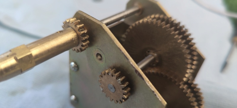

The other G. Box:

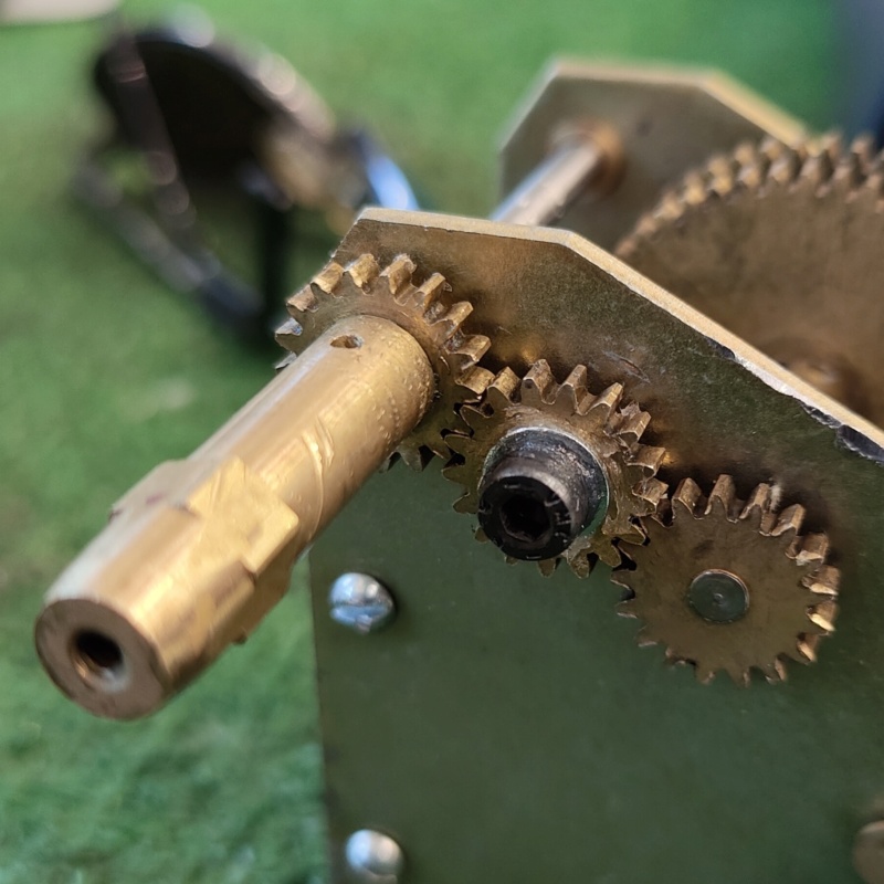

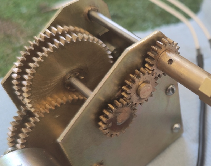

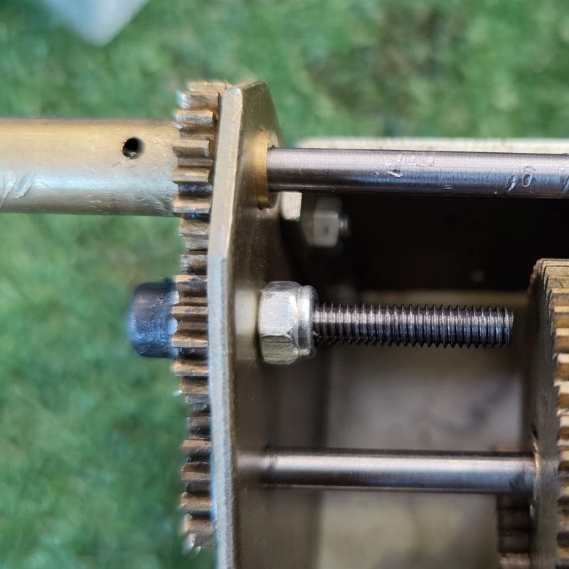

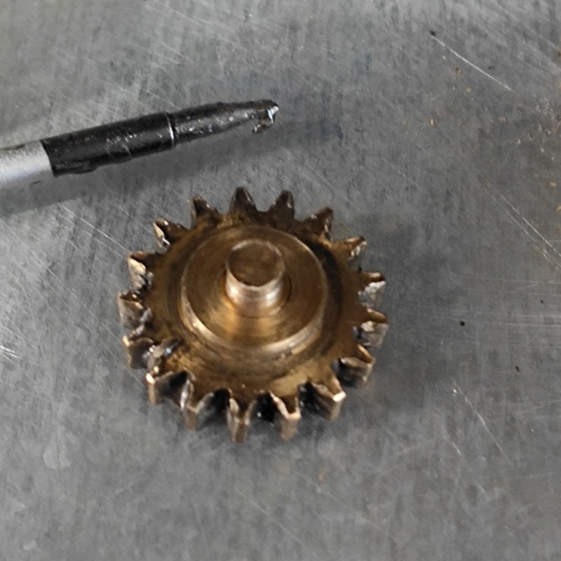

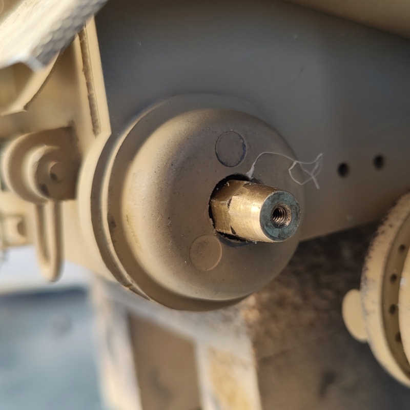

The toothed wheel has an axis which is pressed into the hole made in the sheet:
Oh well 40 years ago they built like this. We accept it. At this point, take the repair drawing (approved by the technical area) and off you go to get the materials.
Obviously the repair will also be applied to the other side
Very unworthy. Treatment:
The unthreaded portion of a bolt acts as the shaft on which the brass gear idles. The threaded stem was naturally shortened after installation.
The bolt head had to be reworked: the hull wall is damn close to the Gear Box:
The change has also been applied to the other Gear Box. Fortunately, the slot on the hull allows an inclination such as to insert the two Gear Boxes complete with drive shafts:

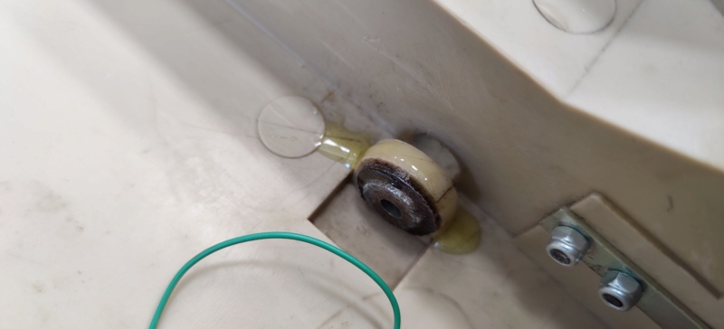

While we were with the engines in hand we improved the isolation of the positives that went dangerously and easily to mass.
On this installation:
We would have liked to put a bumper. Unfortunately it is not possible:
From the left the bearing cannot pass (there is the toothed wheel) neither from the right (there is the hexagon that engages the drive wheel). So let's make peace with our conscience by installing the cover that covers the hollow from the eyes:

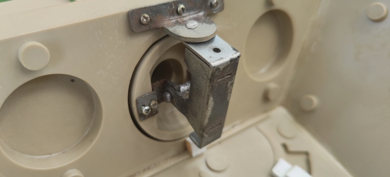

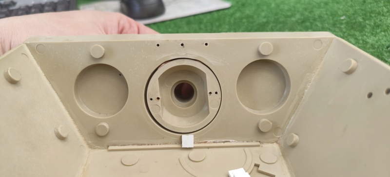

Now I'm struggling with the handling system of the 88. Imai had a very primitive way:
Hooben & Asiatam solution are not good. I am in contact with an industrial design to have it built in 3D printing. But let's go for the long .....

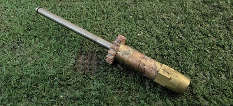

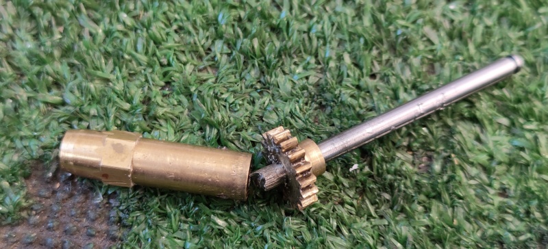

Time passes quickly. The first test on the inclined plane led to a breakdown of a drive shaft.
Repair (brazing) and new testing.
After all, the tests are used for this: to bring out latent problems.

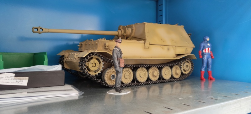

a very long job but which has led to good results
First installation, some adjustments to be made, some problems to be solved but in principle everything works.
