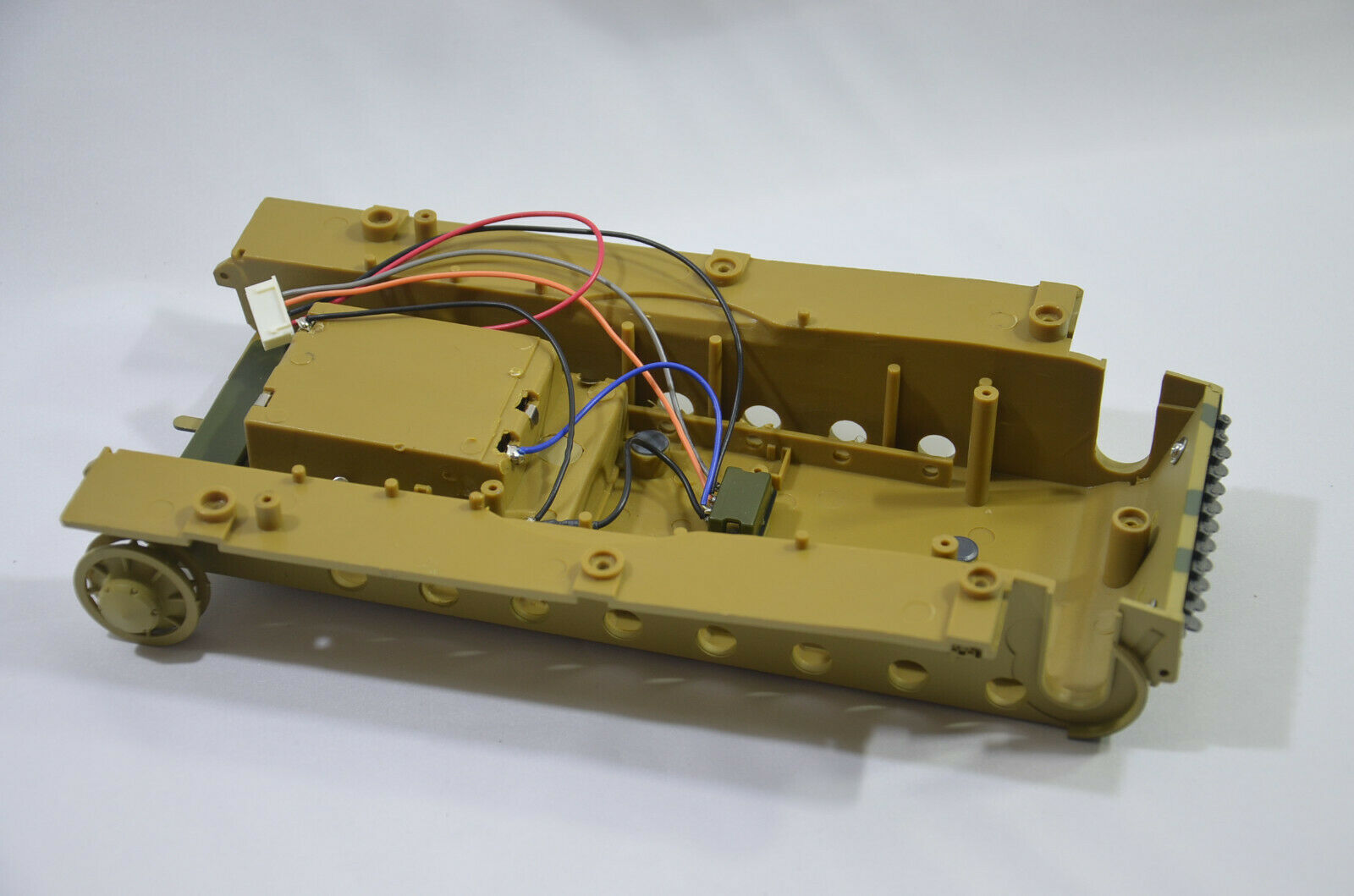

Ok, so I am new to the RC world. About two months ago, I stumbled upon a random mix of 5 Rc tanks (1/24 and 1/16), mostly vs tank. However, with no controllers, I never got around to finding vs tank controllers or replacing receivers. I finally got a controller for the Tiger 1 vs tank. However, I feel like the AA batteries aren’t making a connection somehow. I want to simply find the power wires and bypass with a nicad battery—but I have NO idea which are the two battery wires. Please, any suggestions would be awesome!!!!

I included some pics in Imgur

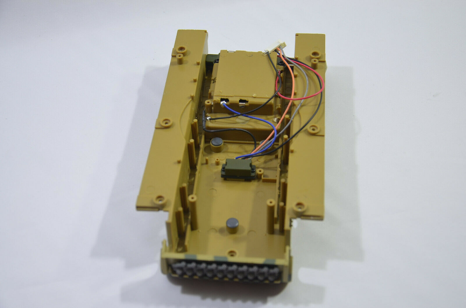

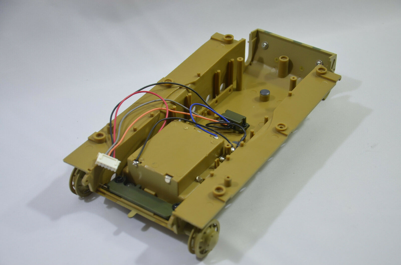

OK.
I have added some images of a lower hull from a VS Tiger I. Your routing may be different...
The VS uses two sets of AA batteries that are mounted perpendicular to each other. That means there is a connection between the upper and lower battery "trays".
Looks like the blue wire (-ve) to the switch and the red wire (+ve) to the 6 pin JST connector.
Maybe this will help you?
