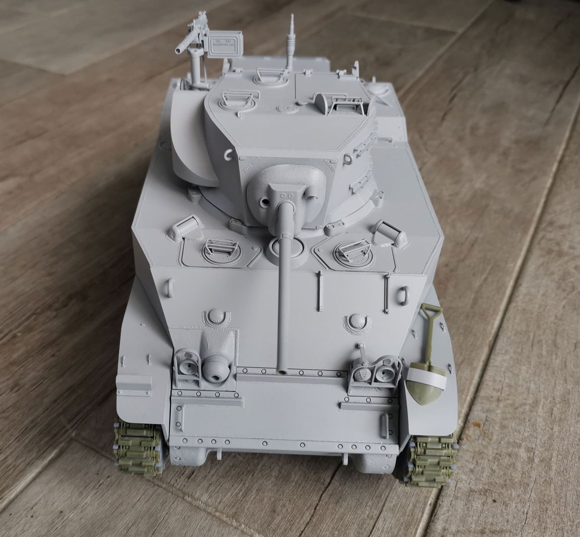

Some weeks ago I found Louis's awesome conversion of the Classy Hobby Stuart and I decided I should give it a try, the Stuart is one of my fav tank !
Here's one I've seen last week at the Saumur Museeum :

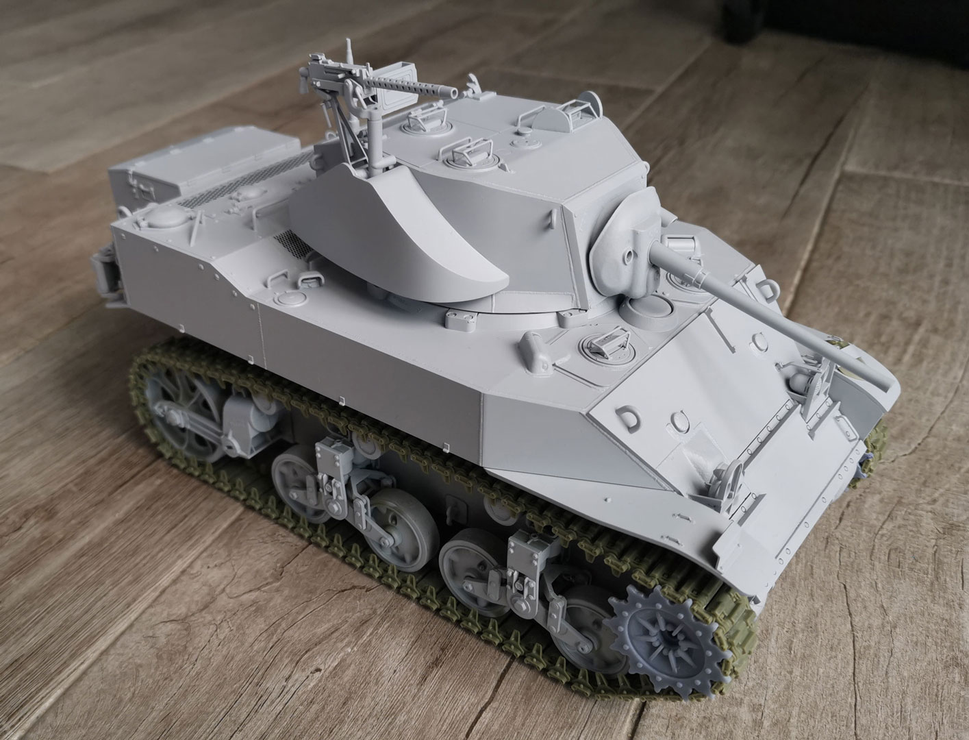

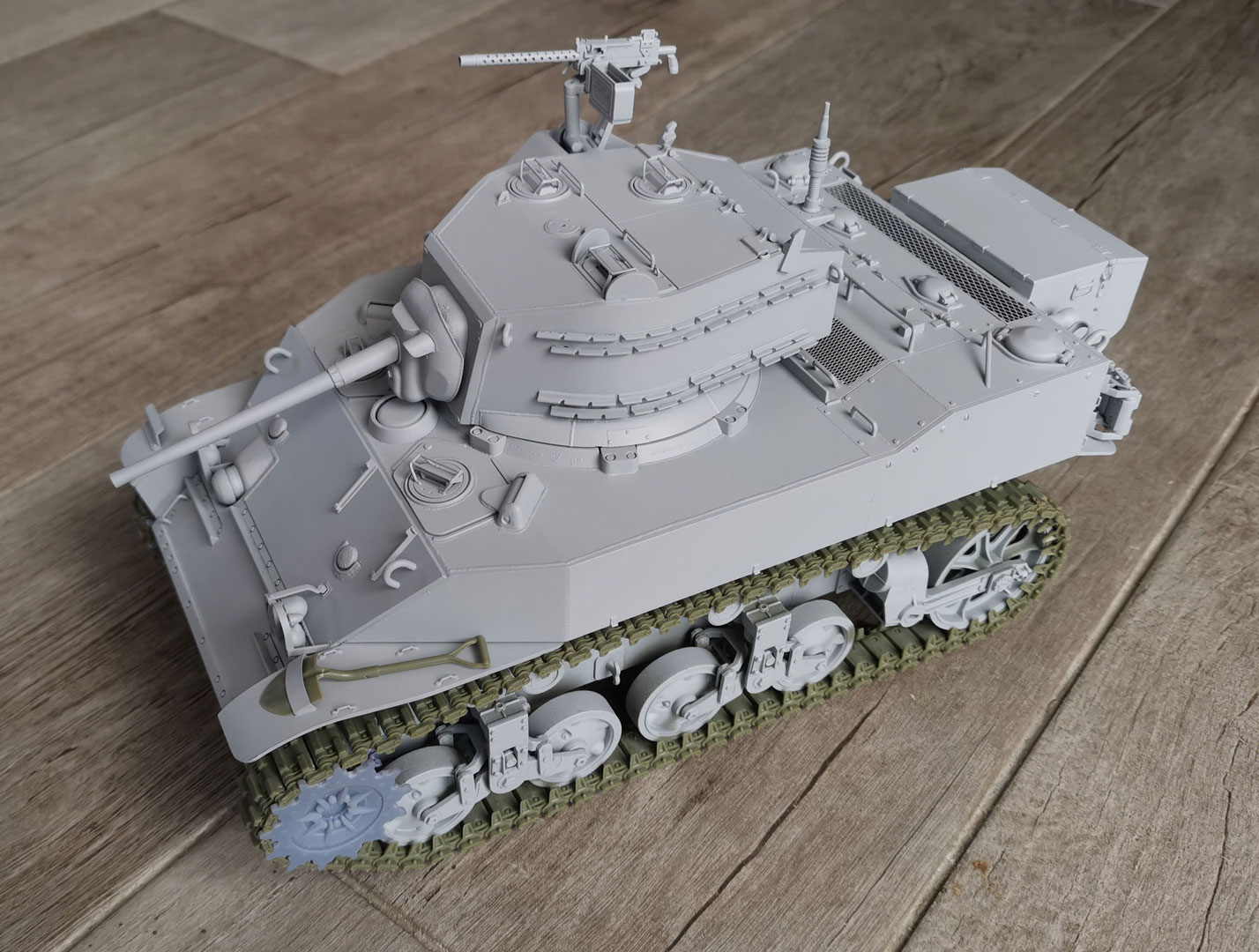

Unfortunatly I haven't taken any pics during the building process, however it's pretty much what Louis did on his Stuart.

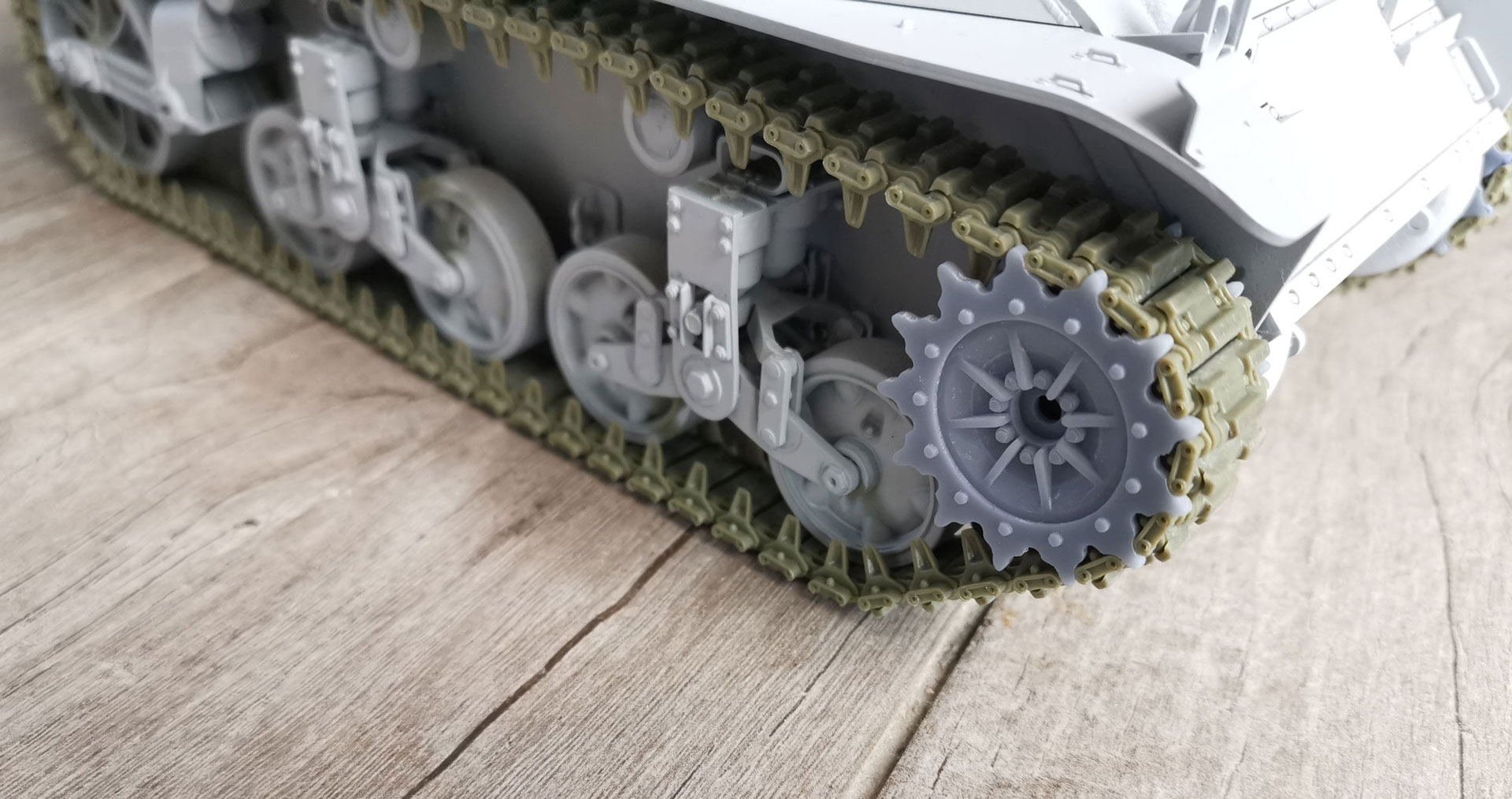

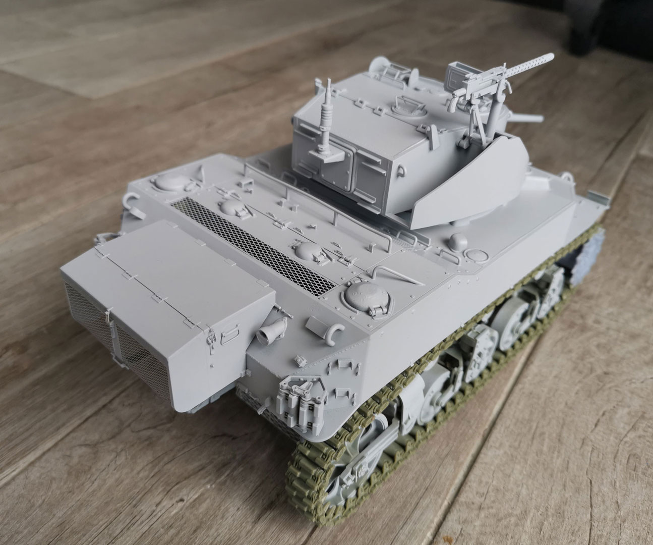

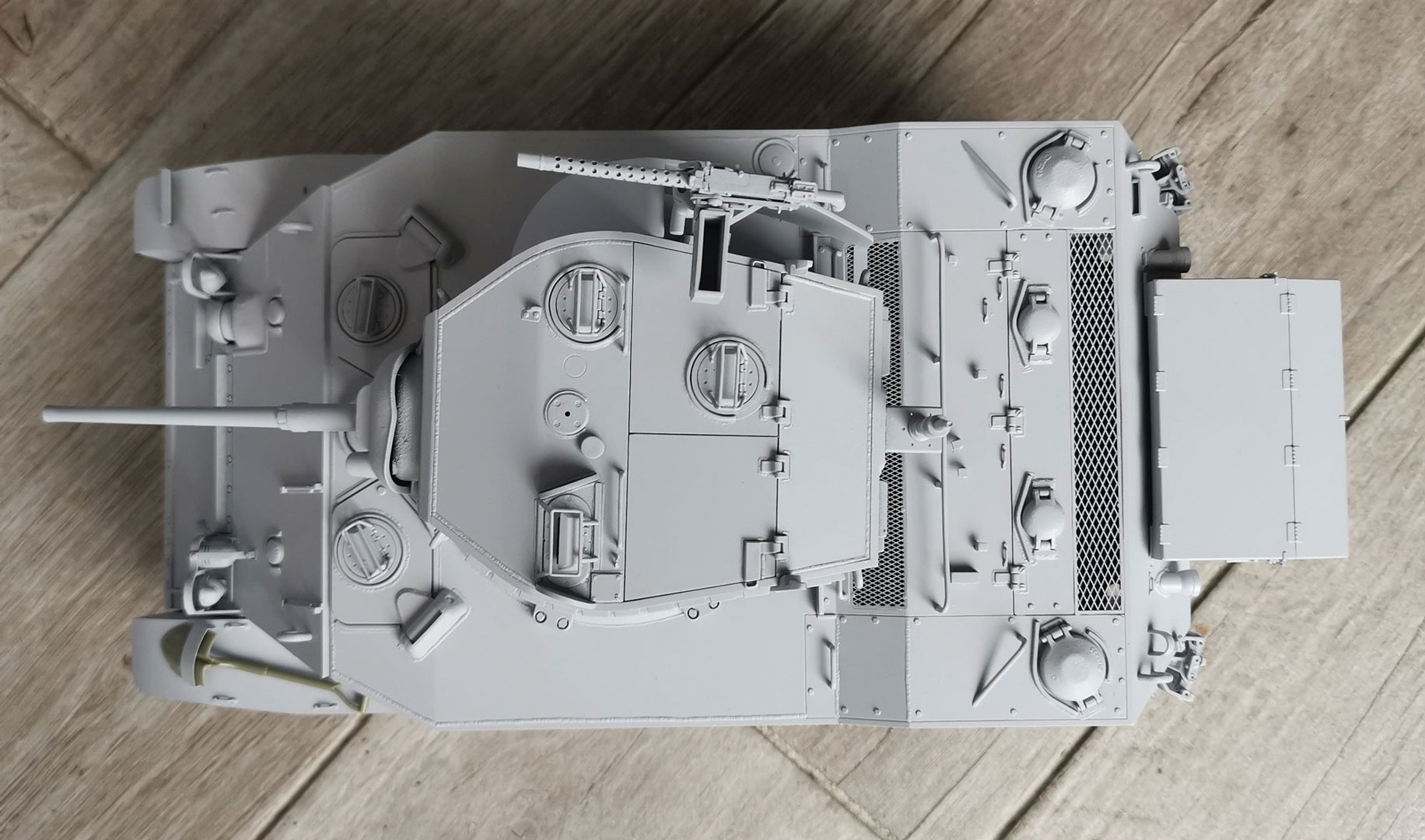

I turned on a lathe brass and aluminium bushing and axes. I have also used the lathe to get the idler and road wheels perfectly flat (removing the mold line and the slight slope).
I first used the kit drive sprocket, I 3D modeled and 3D printed an insert but I messed up when I glued them into the kitparts, they turned not very round (but the tank was still running well).
I modeled and 3D printed new drive sprockets, I need to modify the 3D model a bit and print new ones so I can insert the drive shaft 1mm more into them.
Some pics of the model, the suspension are pretty simple (like Louis did), the idler wheel have a spring (from a 1/12 Tamiya F1 car ;)).
I will try to turn on a lathe new Browning barrels. Or I'll buy some Aber !

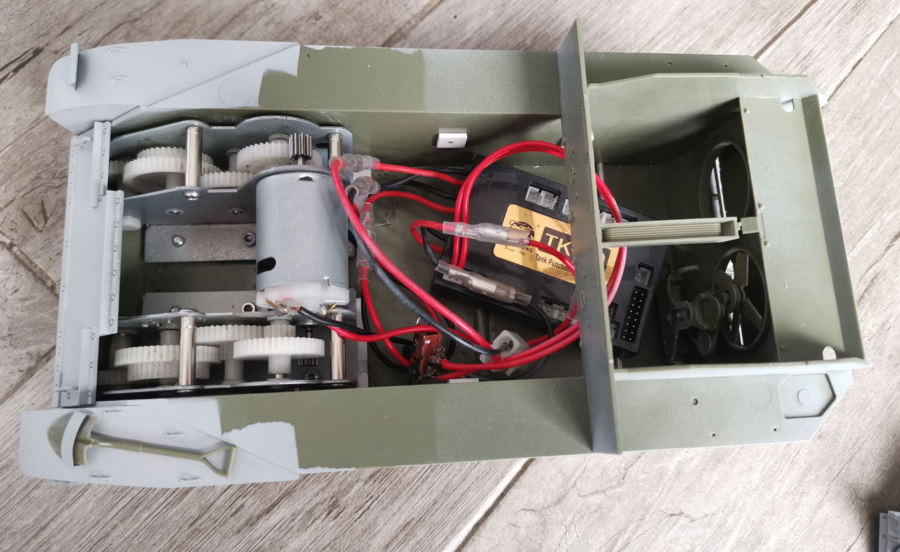

I initially bought Heng Long steel gearboxes for the Stuart, however I decided to used them on my Heng Long Sherman and used the plastic Sherman ones in my Stuart.
The gearboxes fit like a glove, I just have to mill a bit the frame at the front but I did not have to grind the plastic hull like Louis had to do.

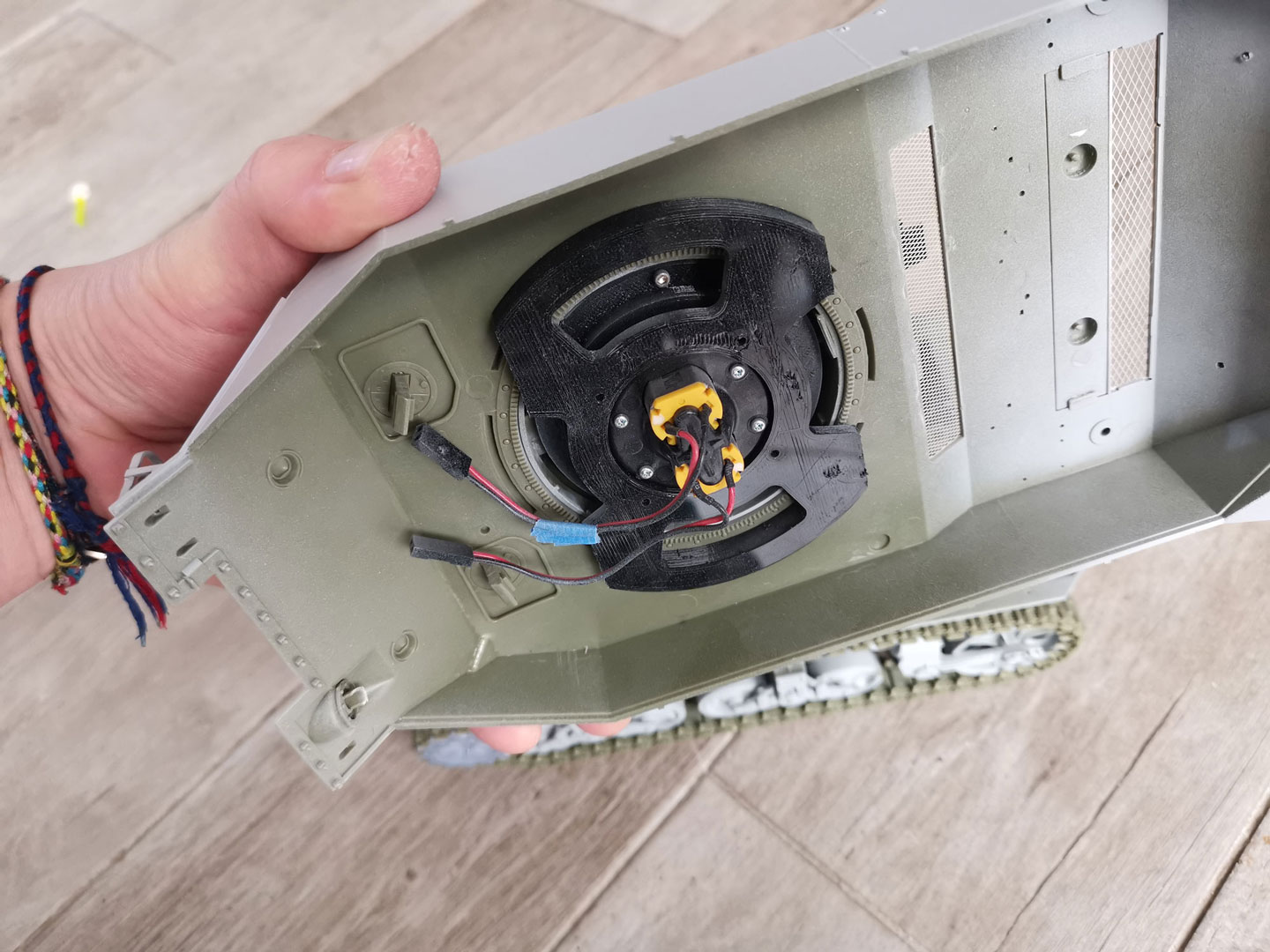

I'm using a 2 in 1 rotation and elevation unit from a 1/25 Tamiya Chieftain kit. I had to create in 3D custom parts so I can attach the unit to the hull and so it can be screwed to the turret. As for now, the turret rotation is working nicely, nice speed and all. I haven't linked the gun to the elevation shaft (it works with a magnet for those who are not familiar with that Tamiya unit). This means I can do 360° rotation without the need of a slip ring because there's no servo or motor inside the turret for the barrel elevation. The bad thing is that I don't have recoil, I may add it at some point though and sacrifying the 360°turn.
I am waiting for a small speaker I found on Aliexpress and some micro LED for the lights.
Let me know if you have any questions of want to know more details about this build !

The Stuart is a sizeable model, I’m pleased to see that you have been able to install a regular but light RC Gearbox inside, but I suspect the HL gearbox could be hard on the fragile plastic tracks if it kicks in with too much energy at once.
The static kit itself is also difficult, I see you were able to achieve good results with the tricky periscope guards and the PE grills at the back.
Louis
Thank you Louis, your build has been of a great help!
The plastic tracks handle well for now, I even did several trials in the garden on rough terrain and grass. Of course I am much more careful when I usually drive it and I'm gentle with the sticks!
I have more concern about the idler fork tbh, but if it fails I'll machine a new one out of Aluminium.

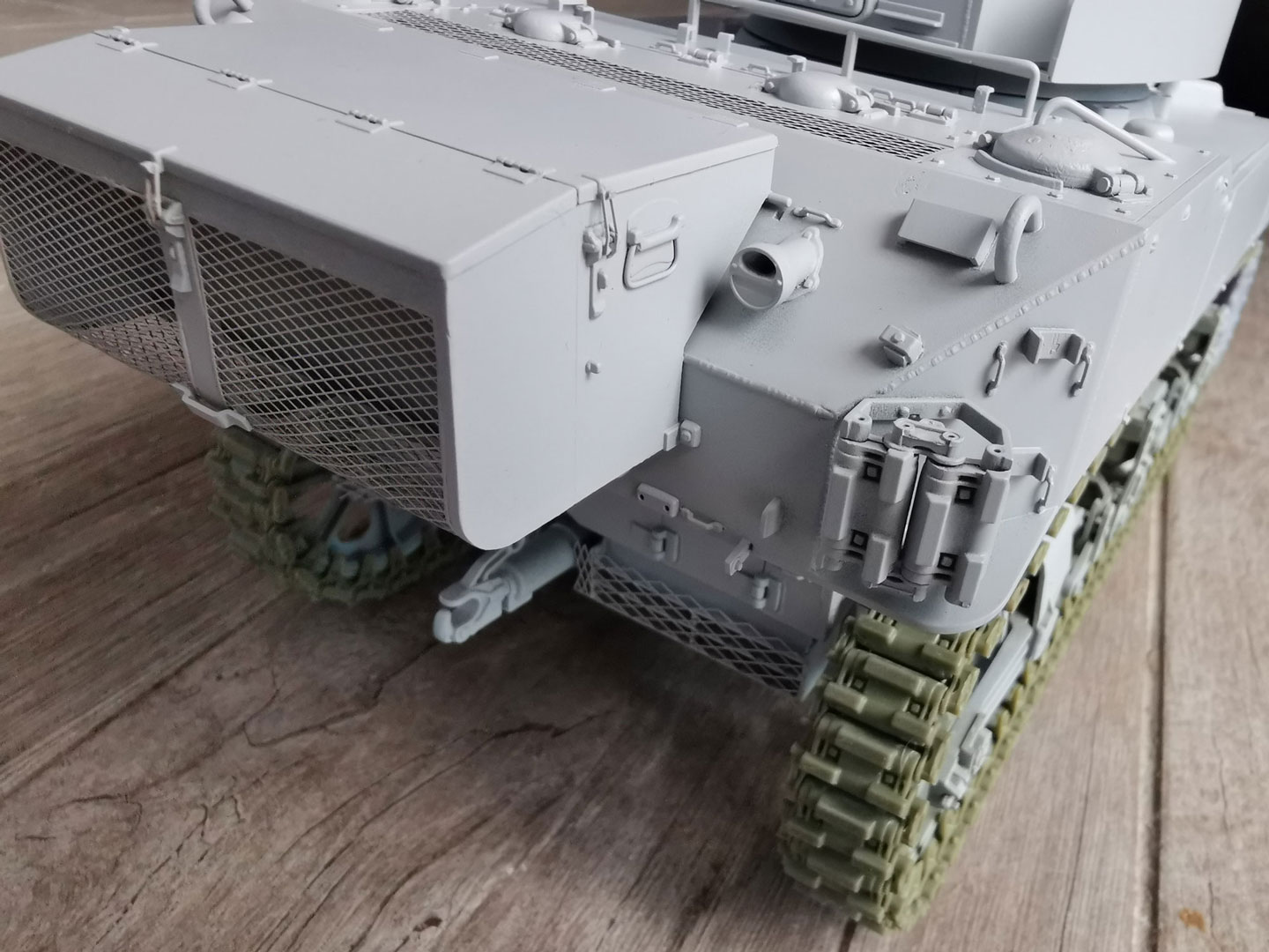

Yes the kit has some flaws, some of them are the small handles or whatever they are that are all over the hull. There are 4 per sprue but I found that the 2 middle ones were all broken on the sprue (fortunately there are something like 16 sprues), I think they broke when the sprue was ejected out of the mold.
Several of the parts for the periscope guards were also broken on the sprue, I had to cut the unbroken ones very carefully off the sprue with several light knife passes on the both sides. I also did not cleaned the mold lines until they were glued, the parts were much stronger and could survive the abuse of cleaning.
The engine PE grills were also a challenge, I used 0.5 styrene to build a recessed frame on which could sit and be glued the grills, this way they are pretty strong.

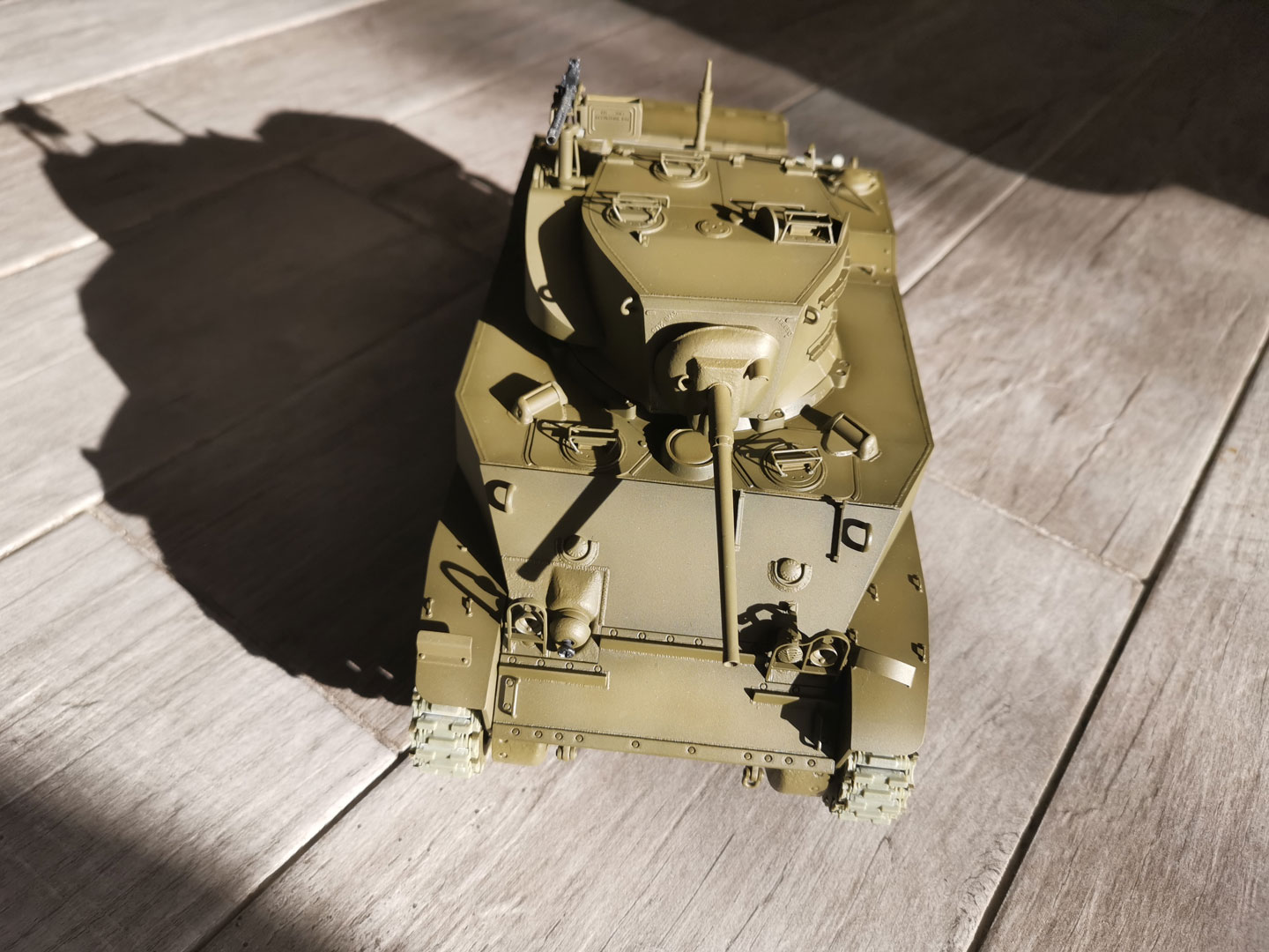

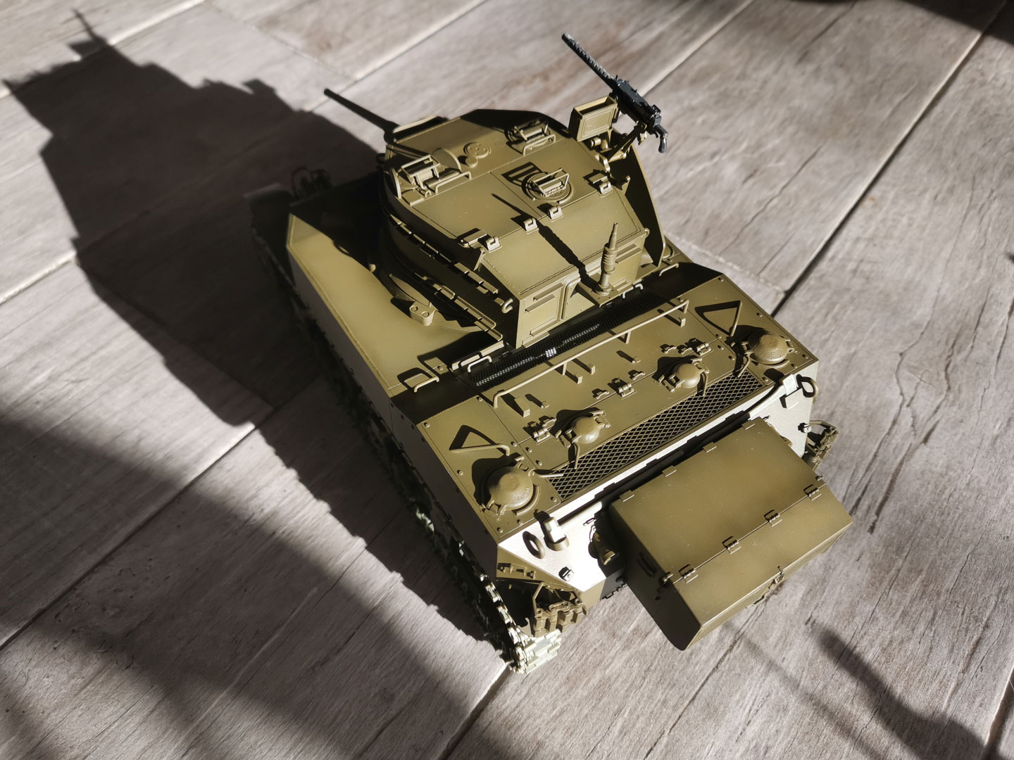

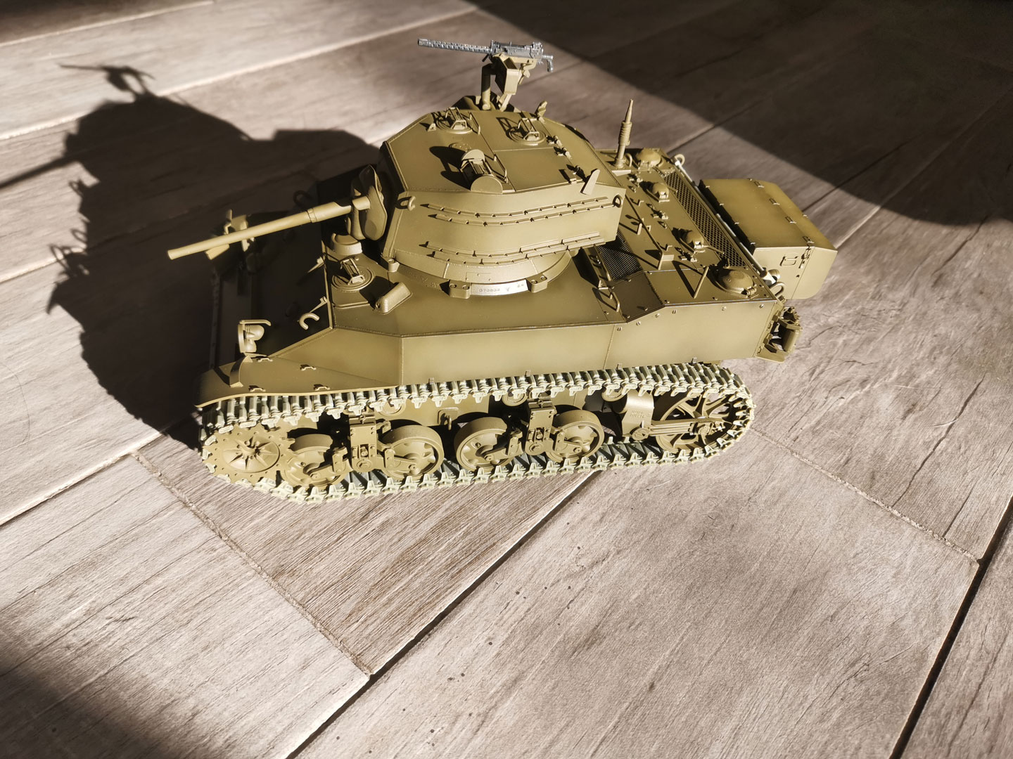

Hello guys,

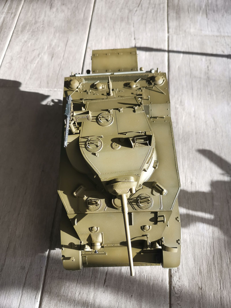

I'vet started to paint the Stuart. Unfortunatly I notice the paintjob is washout by too much sunlight in the pics... Well, there're more nuances :)
Please disregard the MG, I used a very old tin of Revell Dark gray that said "MATT" on the lid, unfortunatly it turned out to be glossy (and thick :(). I have removed the paint since then.

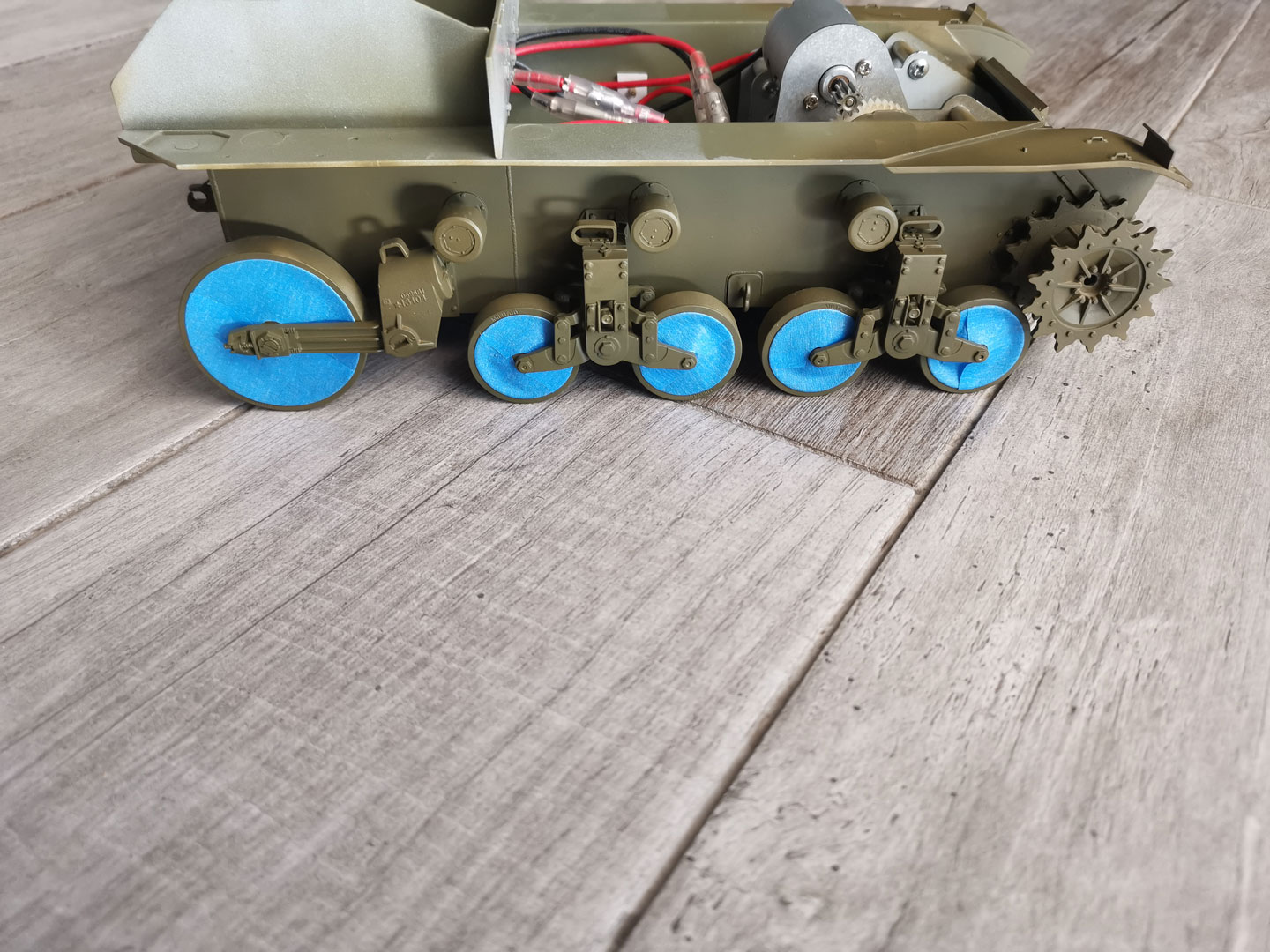

I have also masked the wheel in order to paint the tires.
Next step will be the weathering.
Ah yeah, forget the screw in place of the hull MG... My 5 years old had obviously some fun :)
