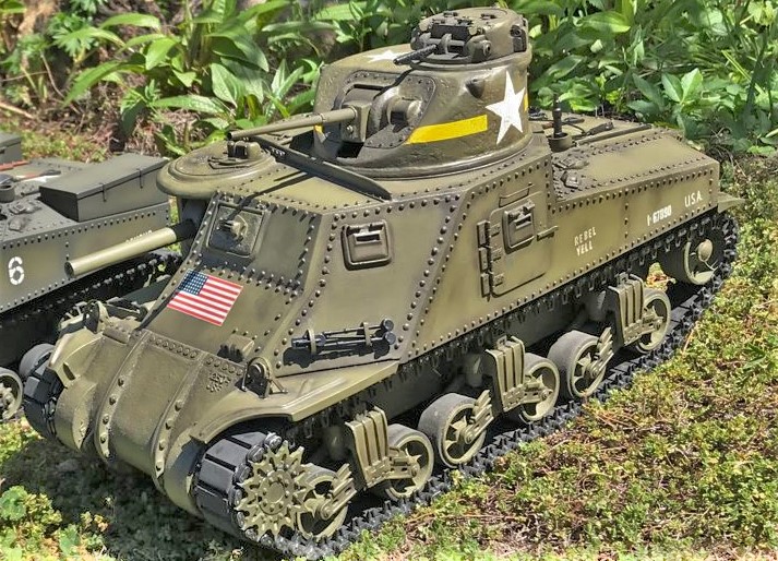

As for the popularity of the M3 Lee. If the June 2021 Tank of the month contest is of any indication, i did present what i thought was a pretty good rendition of the M3 Lee after a major kitbash of the Vandra kit, with new turret, commander's cupola, modified hull, early suspension and T41 tracks. It almost came in last position.

lmcq11 yout M3 is fantastic and you had my vote ;)

*The missing top turret on the Lee is a disappointment and Imcq11's M3 rectifies the problem (as well as makin' a great model)! If you make the Lee available, I wonder if there would be a way for someone wanting to build the model to get a 3D printed upper turret.
*Of course, Kaczor is right about the need for "proper early bogies" (there were some late ones and Aussie ones with the later, Sherman type offset return roller), and Imcq11's model fixes that, too, double-bubble evidence of his work). Again, a readily-available 3D kit would help and could be applied to some early Shermans.
*Another problem with the conversion seems to be the main gun elevation: there just isn't enough room for it, so it lifts the upper hull a tad.

It would definitely need a new main turret of the right size and shape, and with a commander’s cupola. However, the turret ring and maybe the whole upper deck plate will need fixing or replacement to integrate them.
After doing four suspension conversions for my M7, Ram II and two M3, I recommend creating new M3 core bogies but with the use of HL suspension arms, metal pins and springs. It’s very difficult to achieve the proper height with Sherman conversion plugs, Sherman core bogies are too high. Spoked road wheels and idlers are also required for accuracy. They would certainly sell as separate items like the ones on Shapeways.
