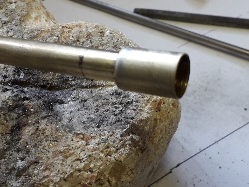

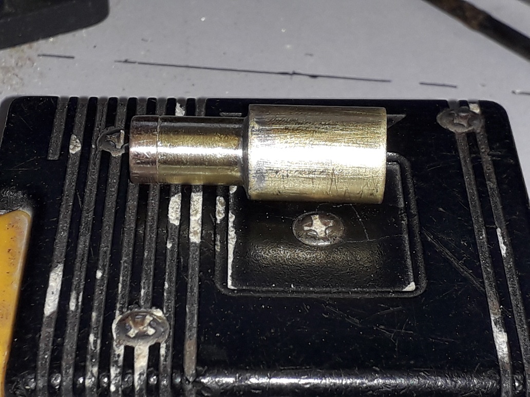

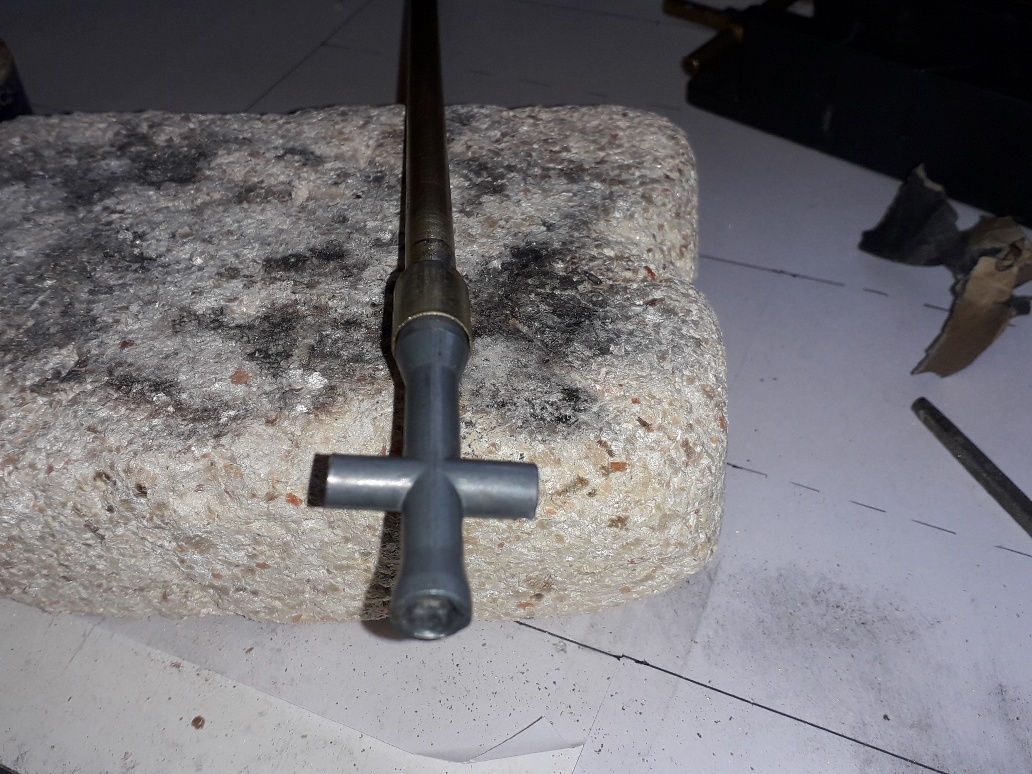

"[W}hen the pivot mount is engaged the coil springs are already under slight compression; this is to stop them popping out." If I have any sense of mechanics, the slightly compressed the coil springs will also stabilize the vehicle as it moves.
- 43rdRecceReg
- Posts: 6294
Re: Scratch build SDK.FZ 251 / 23 Ausf D Recce vehicle in 1:
Small scale engineering at its enviable best
Thx,
Mr Midlife and Mr RecceReg.
Herr Dr, you are most correct in your thinking, adds pre load.

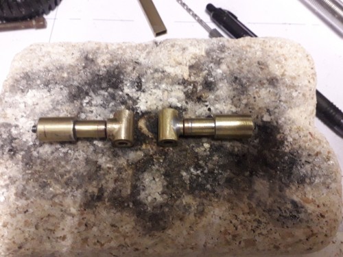

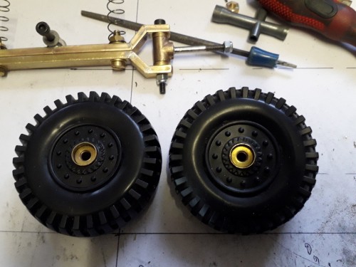

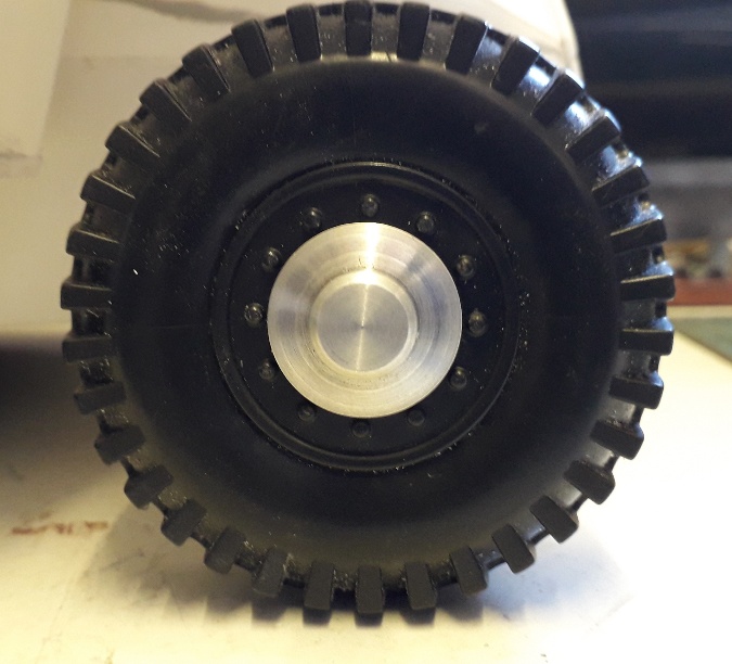

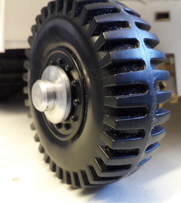

Hi.
The front axle now just needs the upper chassis mounting beam cut to fit the tapering front of the model and the 2 long steering knuckle pivot bolts shortening and it is finished.
Moving on to the wheel hubs.

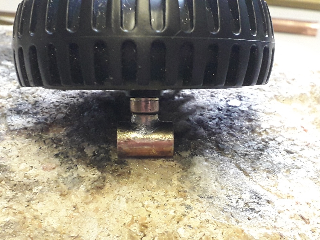

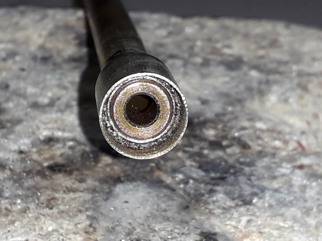

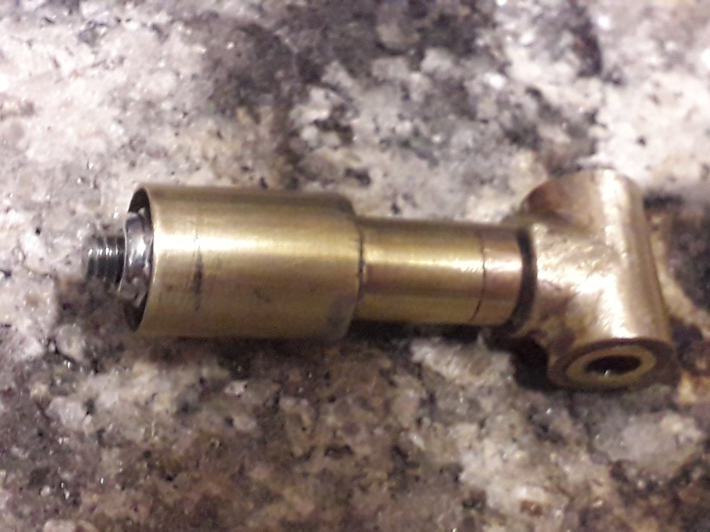

As mentioned earlier i am making this model from various items i have left around from previous build or items not used and in the parts bin.
The wheels i have chosen for the front wheels of this model are left over from a UN 6 wheel drive APC i made a while ago, 6 wheels were changed for WPL units and the original ones kept for further use.
The Tyre pattern on these is identicle to a real SDK.FZ 251 so off i went, although the wheel is slightly wider but the correct diameter for my model.
The issue with the wheels is that they did not have a through axle and were only pushed onto a stub axle to hold them on, this would not be good enough for this model so i hollowed out the wheels in order to fit some brass wheel hubs with phospher bronze bearings that i made that would be glued into the wheel giving it a through axle mounting and secured onto the stub axle via a 4mm Nyloc nut.
These wheel hubs will be recessed into the wheel itself so that the nut and axle do not protrude beyond the face of the wheel.
I then turned up some aluminium wheel centers that matched the full size vehicle, these are hollow in the inner center to fit over the nyloc nut and locate into the recessed brass wheel hubs and can be prised out to remove the nut and wheel.
Pics should make this clear.
Sub.
Sub.
One more pic.
Just need to alter the studs from 12 bolts to 8 (maybe)
Sub.

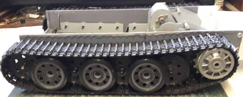

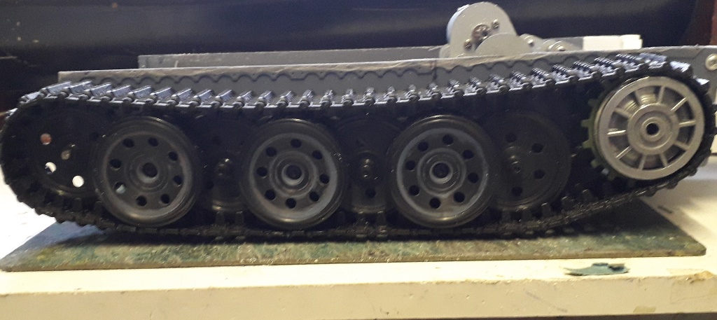

A couple of pics showing the tracked section that i came up with, hopefully all the previous splather i was on about now makes sense.
In order to disquise the panther sprockets and make it look more scale true to the originals fluted sprocket i looked at the original Tigers idler wheels, i checked the diameter and they were perfect to fit over the panther sprocket just leaving the teeth visible and were nice and snug where the track overhang sits where the sprocket engages , obviousy way too wide but i decided to cut them in half and thin them down a bit and glue a half reversed onto the panther sprockets, they came out quite well i think.
Still needs more work on the wheels.

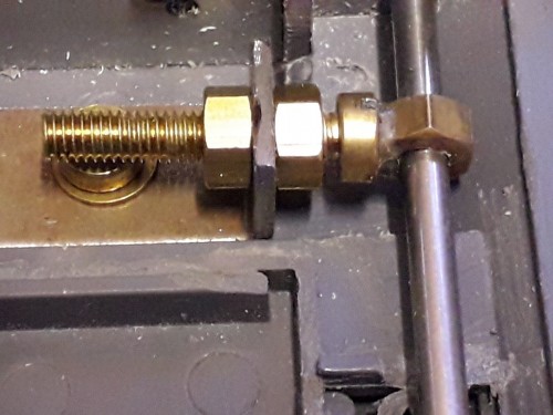

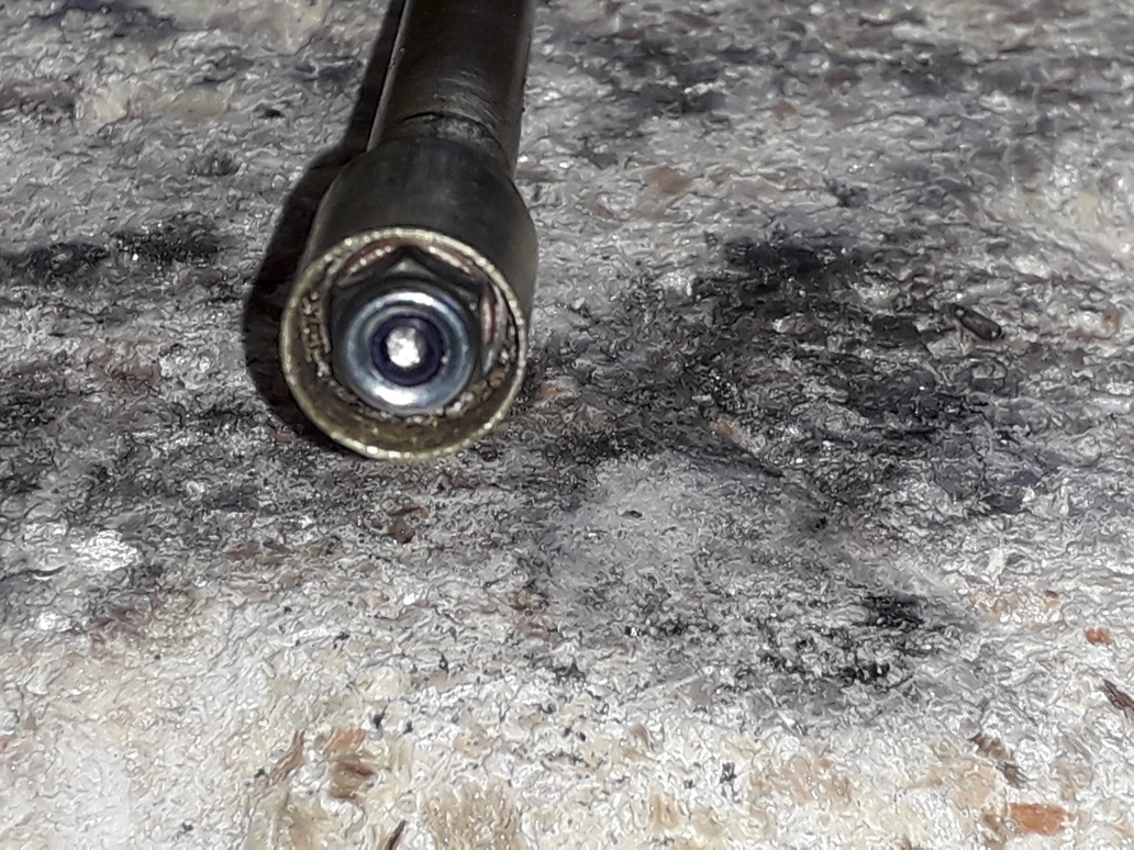

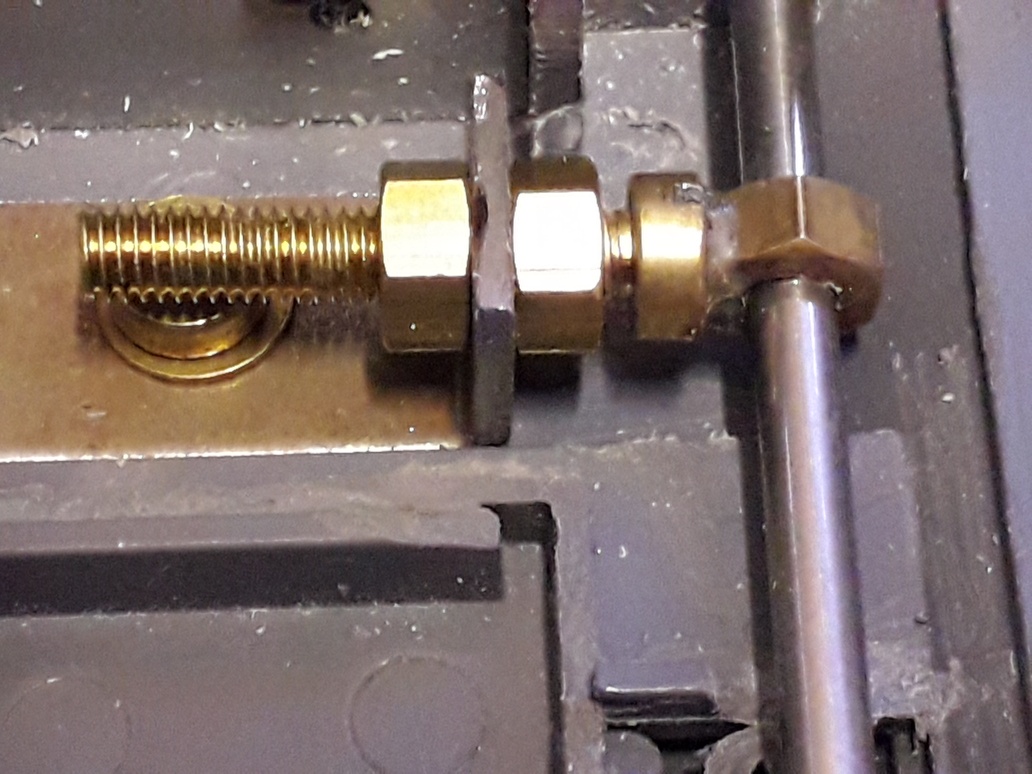

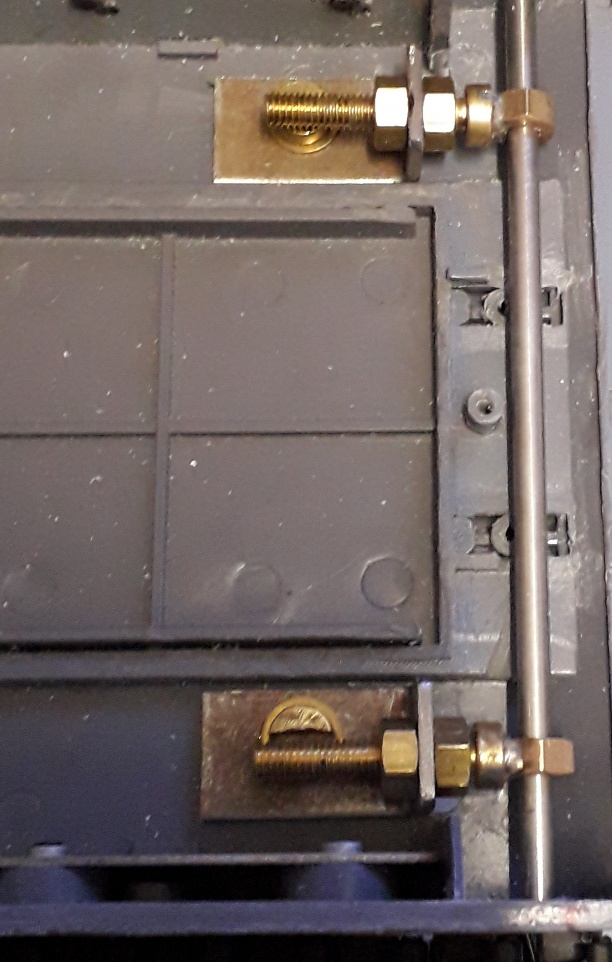

Rear idler wheel adjustment completed.
1/16 thick steel bent to 90 degrees to the height of the axle and drilled to bolt to the hull and for a 2ba brass bolt to pass through with 2 nuts either side of the steel bracket, a further 2 ba nut soldered onto the end of the bolt head which the 4mm axle is a good snug fit with no play, to adjust the tension on either track just undo and tighten the corresponding nuts, which moves the axle and lock it up.
Prefer this than the original set up as its inboard the hull away from any muck, mud etc and is so easy to adjust, and its so simple. ( i operate the K.I.S.S. system where i can)
It may look a bit agricultural to some but this design has been in use for decades on motorcycle rear wheels to adjust the chain drive and it will be ok for years of use.
Few pics.
Cheers.
Sub.
Few pics.
Cheers.
Sub.
- tankme
- Posts: 1990
- Joined: Tue Oct 31, 2017 3:51 pm
- Location: Elgin, TX
That track adjuster is the same concept I use in my 1/6th scale tanks and it works great. Nothing wrong with that design. My old Suzuki SV650S worked that way to align the rear wheel.
