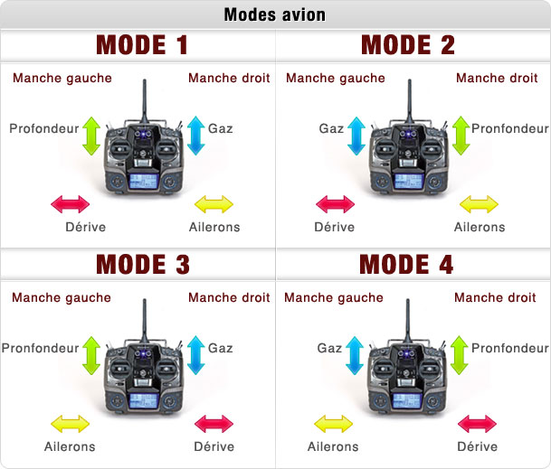

here, who does what according to the type of transmitter mode (this for airplanes) in general it is mode 2 the most used
