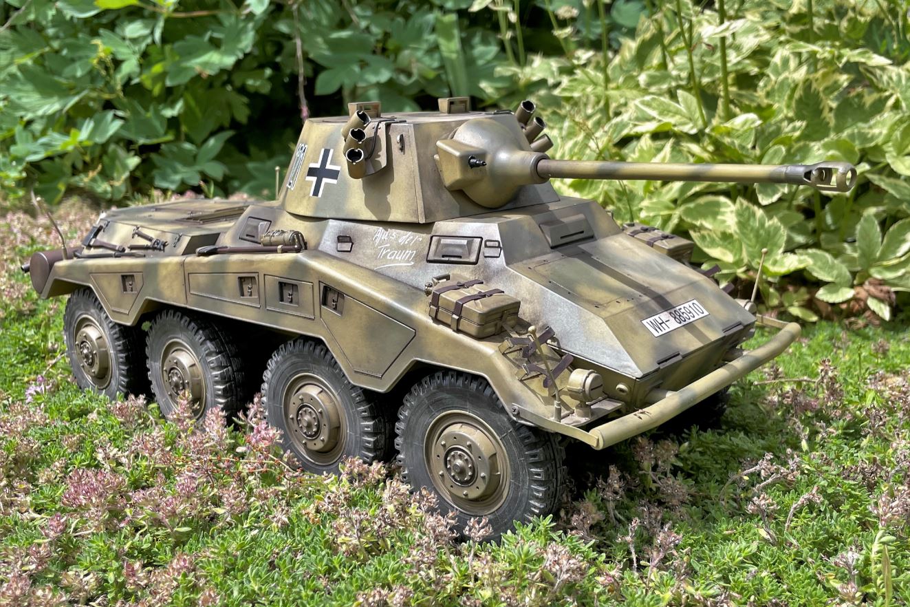

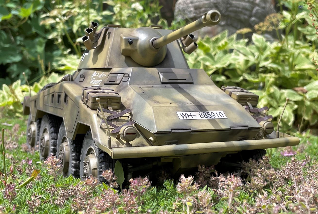

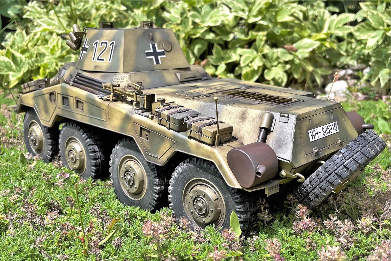

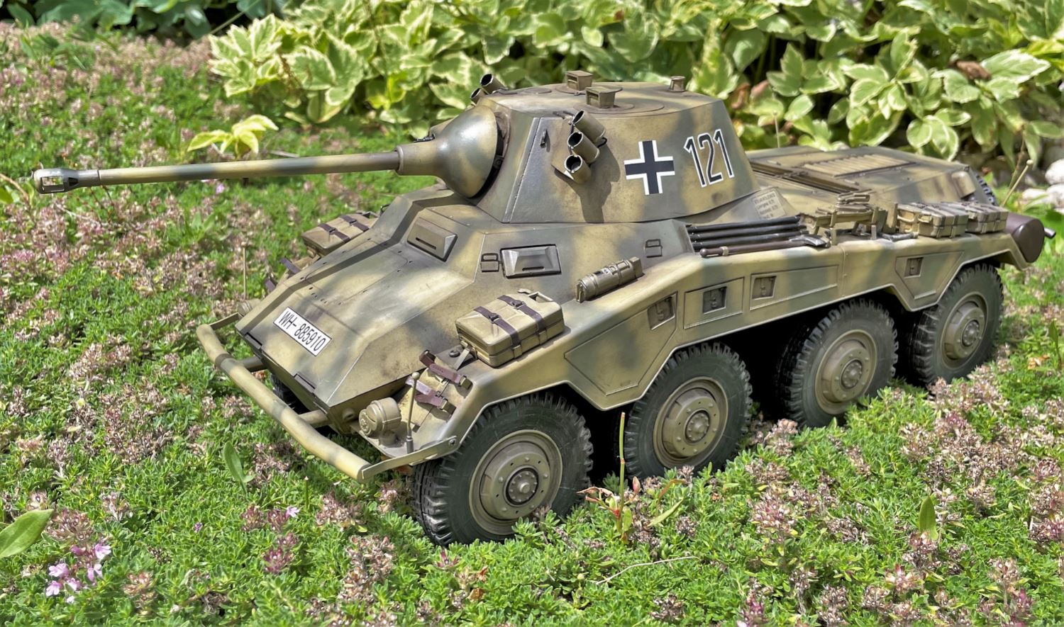

NUMBER 1
This is a Metal Origin Sd.Kfz. 234/2 Puma built last month.
The model has the following features;
- Clark TK22 control board
- Metal origin Cardan half shafts
- Heng long turret rotation unit and Mato 360 rotation wheel
- Modified MK Modellbau Puma metal gun barrel
- Custom servo gun elevation and recoil, with flash and sound
- Coax machine gun flash and sound
- Headlights with LEDs
- Steering with 35kg servo
- Painted with Mig Ammo Dunkelgelb RAL7028 and Olivgrun opt2 RAL6003
- Applied with black and dark steel pigments
It was a fast and pleasant build, no major issues encountered. I've found the model to be well designed and it operates well after a break-in period and some tweaking of the drive cups with the optional cardan drive half shafts. I had no issues with the gearbox. The build can be seen at viewtopic.php?f=23&t=31750&start=20
Pictured in my wife's garden.

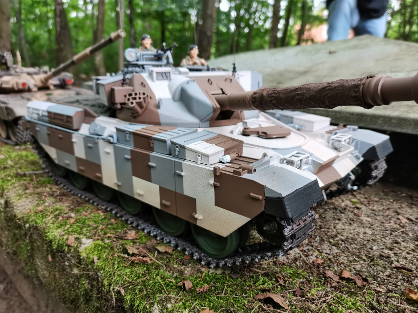

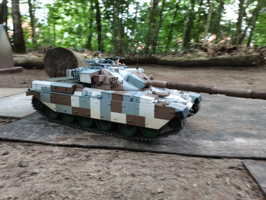

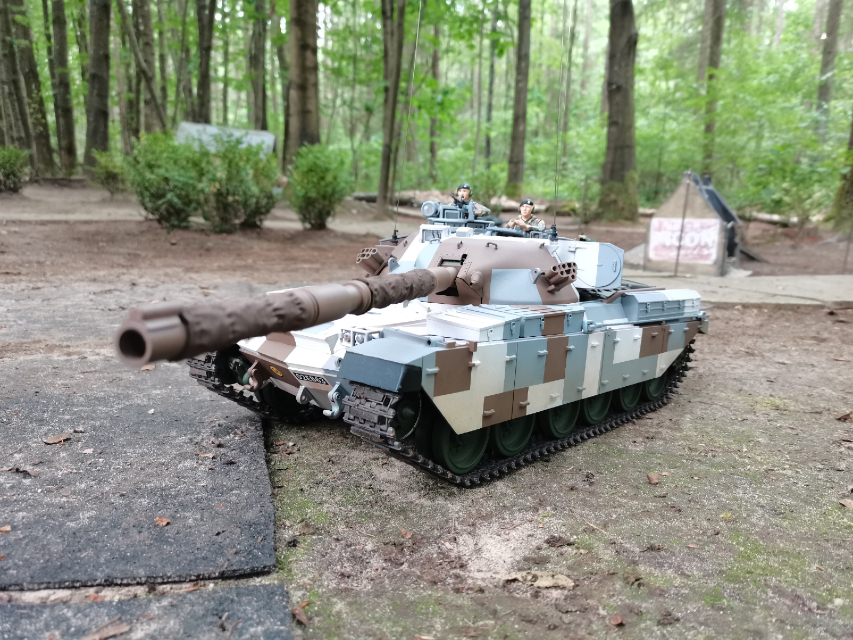

NUMBER 2
i bring a little more color .... my Chieftain with Berlin Camouflage.
Base is the Haya Chieftain with metal tracks.
- Open Panzer control board with Benedini sound module and own soundset
- Modellspiegel Transmission
- DKLM metal turret rotation unit
- both coax machine gun flash and sound
- headlights and rear lights with LEDs
- Haya Chieftain MK5 Upgrade Kit
- Commanders cupola and the two cover behind, antenna sockets and locks for storage boxes from Oliver Rauls
- Painted with Mig Ammo AMIG7150 "BRITISH BERLIN CAMOUFLAGE COLORS 1988-1991"
Painting took two days, masking took most of the time...
Here some pictures:
