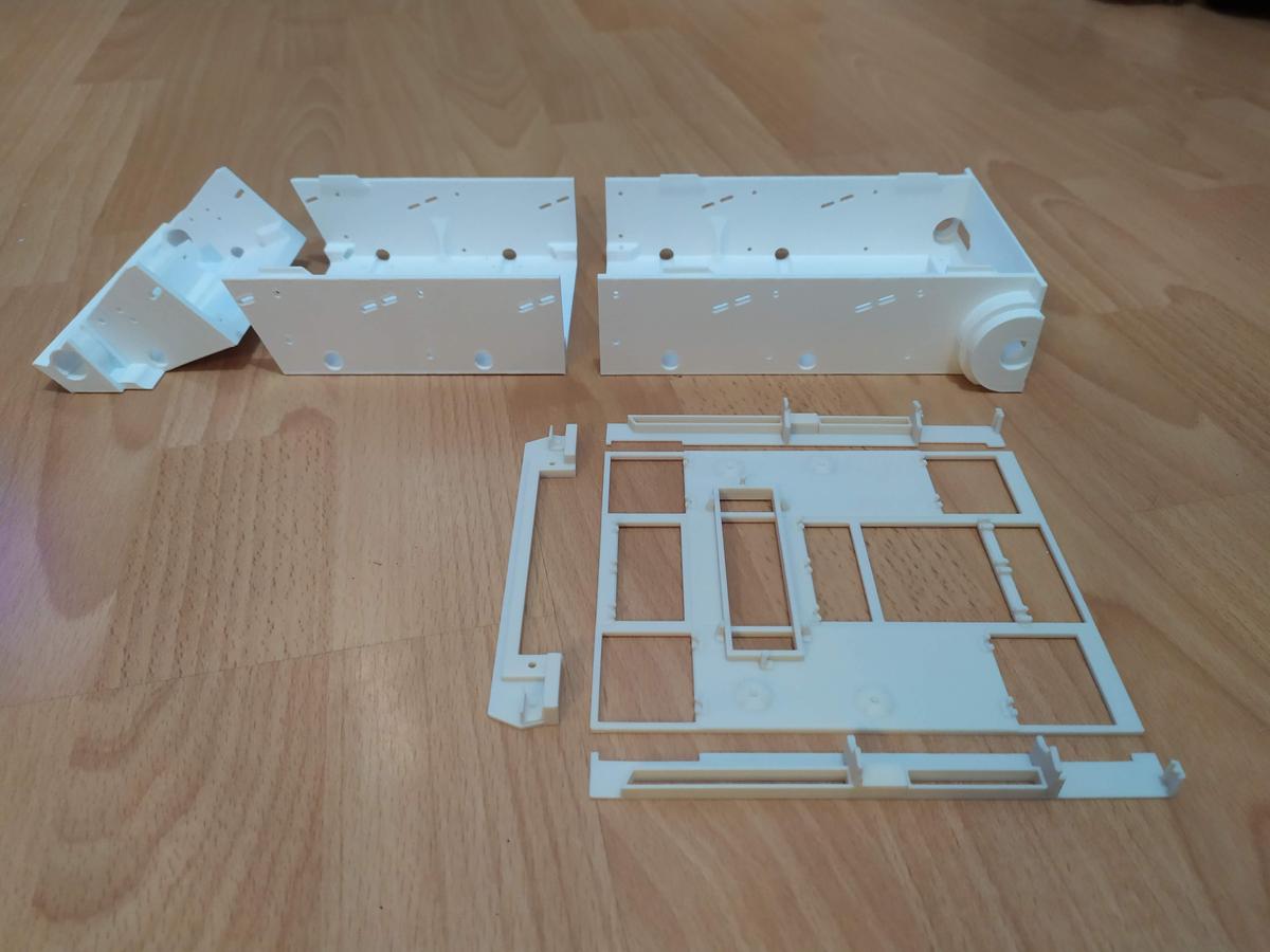

after all those Hetzers, I finally have a new project.
I am always learning new things and improving.
I'd like to show it on my Cromwell.
The Hull is ready, waiting for test prints and assembly.
I have developed a new type of 3D printed belt tensioners. They perform a rotary movement.
Two different rings and three types of motors can be used to rotate the turret.

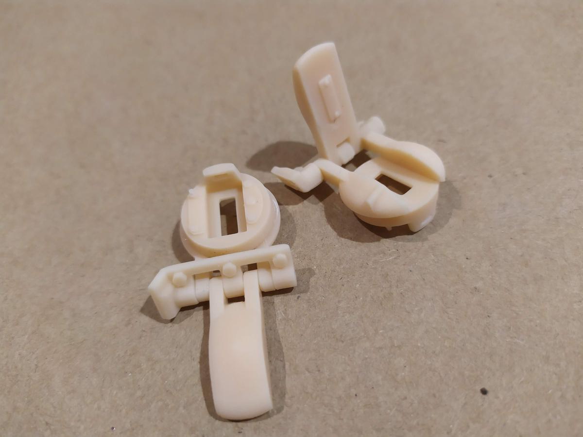

Have 22 moving parts like hatchets and machinegun right now.

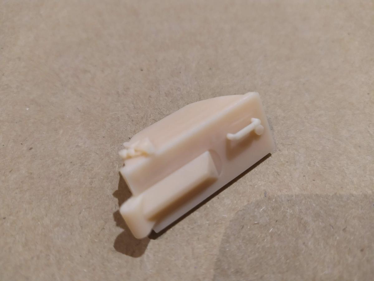

I care about every detail.I always try to create the most accurate model.
Cromwell will be available like KIT or STL files for 3D print as soon as I finish the tests.
I will bring new info and photos soon.

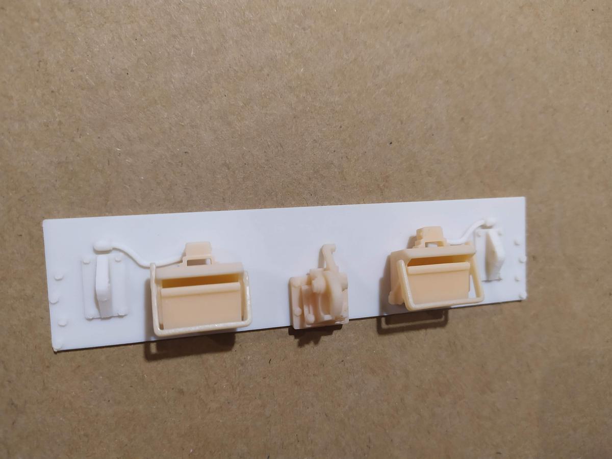

I love the look ofr this! Would you consider selling individual items like fire extinguishers, smoke launchers etc separately?

Looks great. White parts are resin printed also?

Of course, separate parts will be available.
Actually, most of them are available even now.
Send me a PM for this, please.

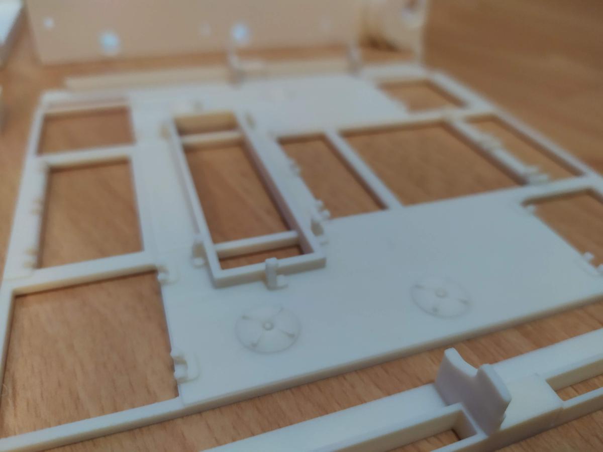

Kaczor - white parts are printed with ASA.This is Fillamentum ASA Natural.
It looks so smooth, because its printed with activated ironing.
Well tuned FDM printer (4Max pro).
