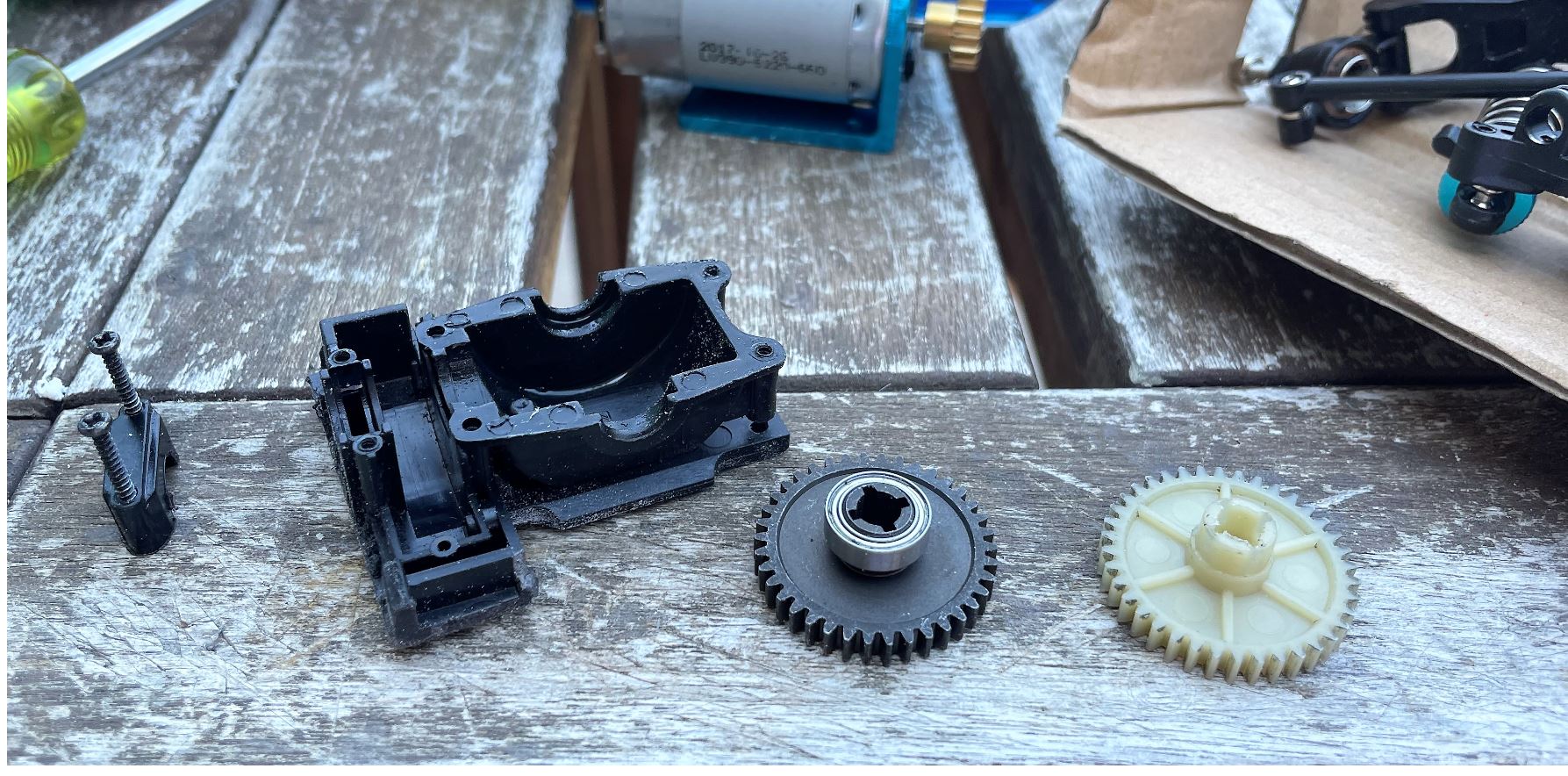

The standard gears come in plastic.
RC 1/16 GTK Boxer 8x8 Armoured Fighting Vehicle - Build
But i have the metal upgrades for them all, including the main shaft.
Looks like superb gears to me for the price...

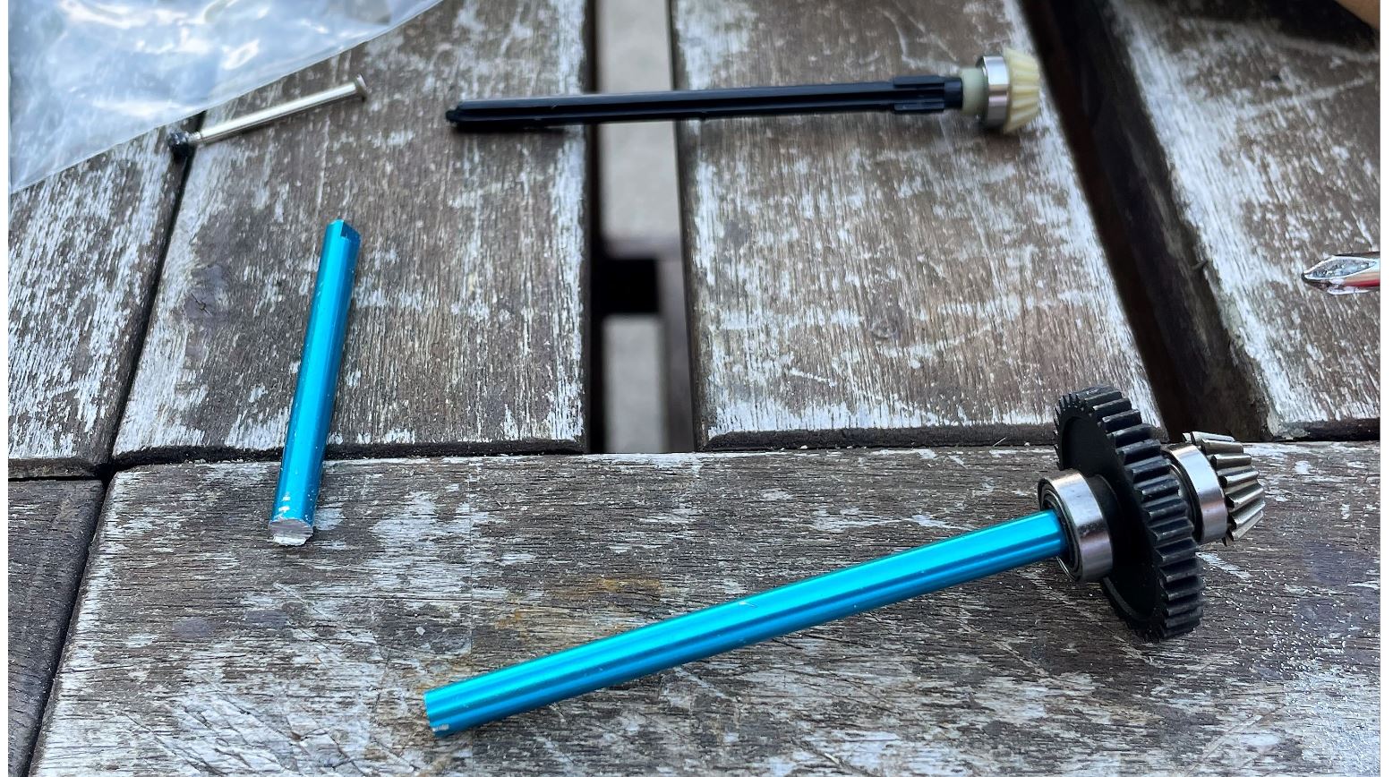

A critical step is to determine the optimal length of the shafts. It is better to cut it longer and then fine tune with a hand file. The groove for the gear is made with the hand file.
The replacement parts are made ready. Comparing here the original plastic and metal replacement. They need to be filed a bit.

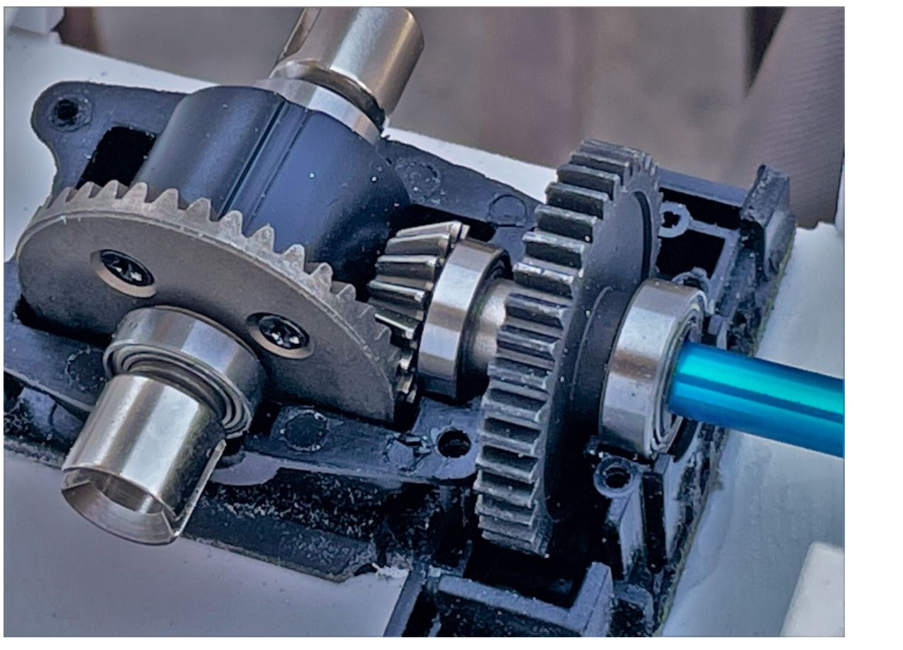

Thorough testing and fine tuning is required in order to make the shafts and gears turn freely without too much resistance or bumping. The first tests showed poor results.
I found that each gear seems to have a natural mate. Simply switching the gears has improved the situation dramatically.
Nice gears. The guy that wants to sunk in another couple of hundred bucks can use metal parts for the whole thing, eliminating the need to buy plastic buggies for core components, like the gearbox housing.

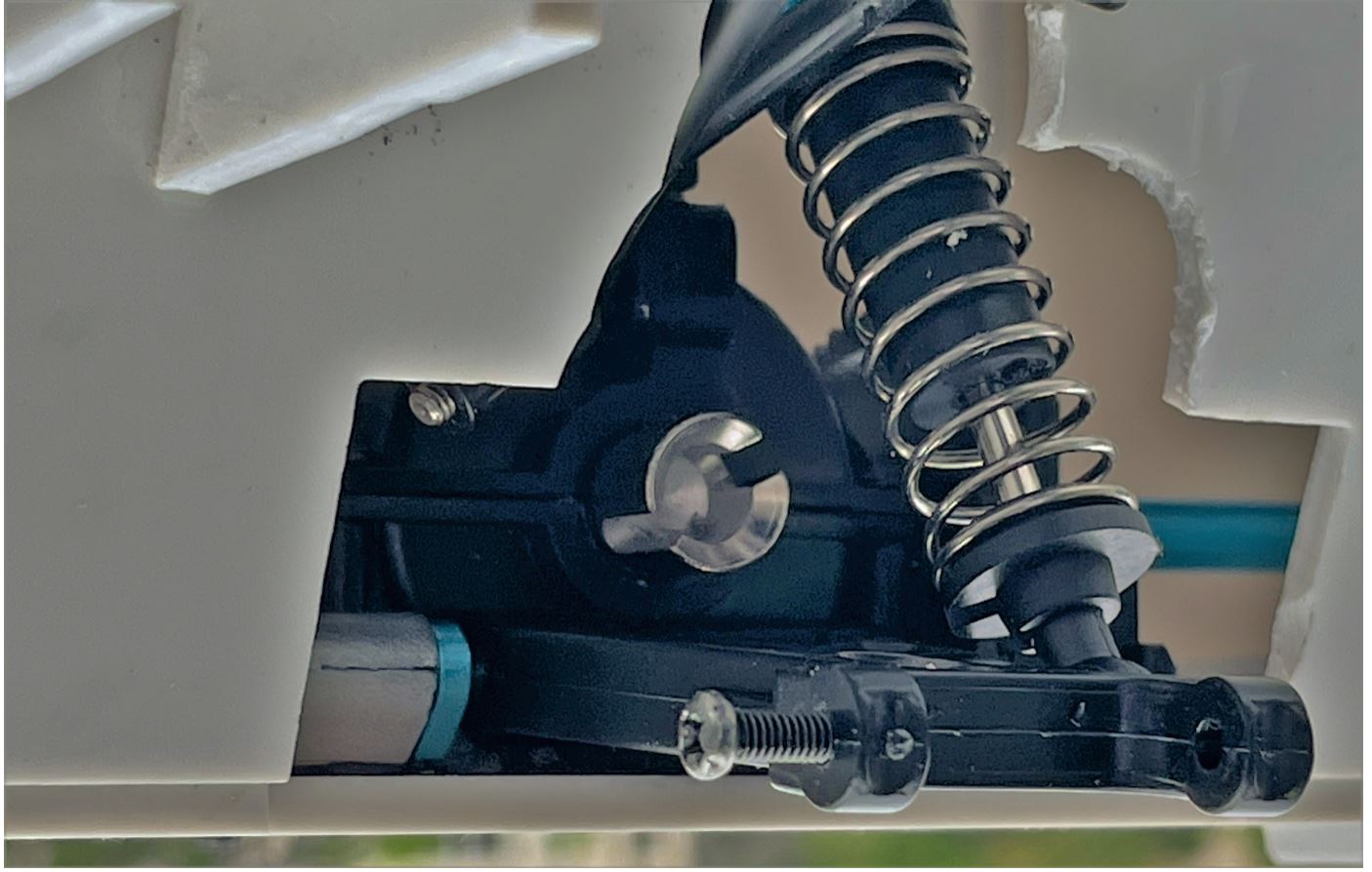

Here we are, all units are installed. The steering on Unit A and B will be configured later once motorization is designed and built.
Notice the hull was cut around each suspension unit so that the components can work freely up and down. As these holes will be behind the large 85mm wheels, they should not show too much. I might improve the look later if required by adding some plating to cover non essential areas.

Close up on the suspension units and alignment.
For motorization, the RC buggie motor cannot simply be linked to the driving gear without any reduction gearbox. What would make the heavy GTK Boxer completely uncontrollable and way too fast.
I am currently analysing two options;
Option A is a twin engine configuration using a good metal gearbox with strong gears linked to a 370 motor that will be independently connected to the two sets of suspension (A and B) and (C and D). A twin motor configuration for front and rear is just like tanks for right and left track... Its seems to be the simplest option.
I did a small test by plugging a gear on the shaft and manually make the first set of gearbox run. Its seems to offer good strength, control and speed.

Option B is to centrally plug in a 1/10 truck gearbox with 540 Brushed Motor, designed for Axial 90046 SCX10 SCX10 II, with a pair of strong drive shafts that would be connected to another gear that would activates the drive gear on the gearbox main shaft... Now, this is way more exciting than option A but it is very powerful, maybe too powerful for the drive train i have.
This is the version with the 55T gear.
