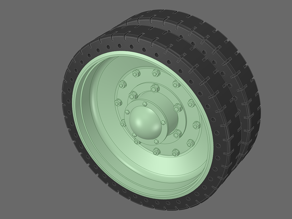

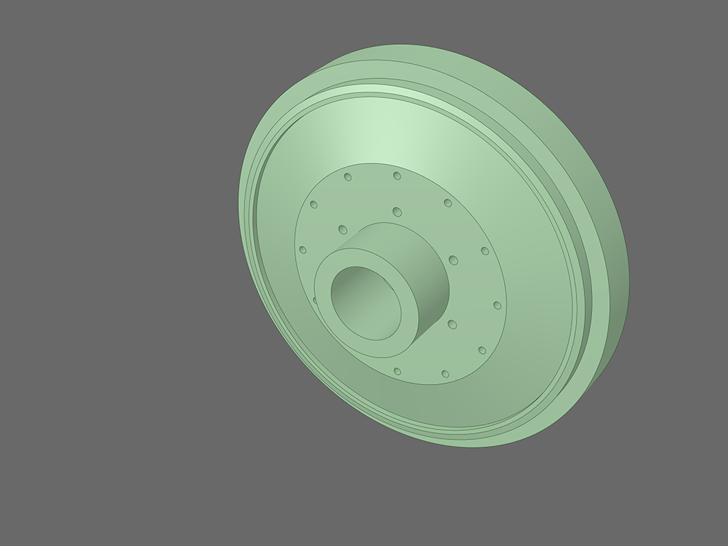

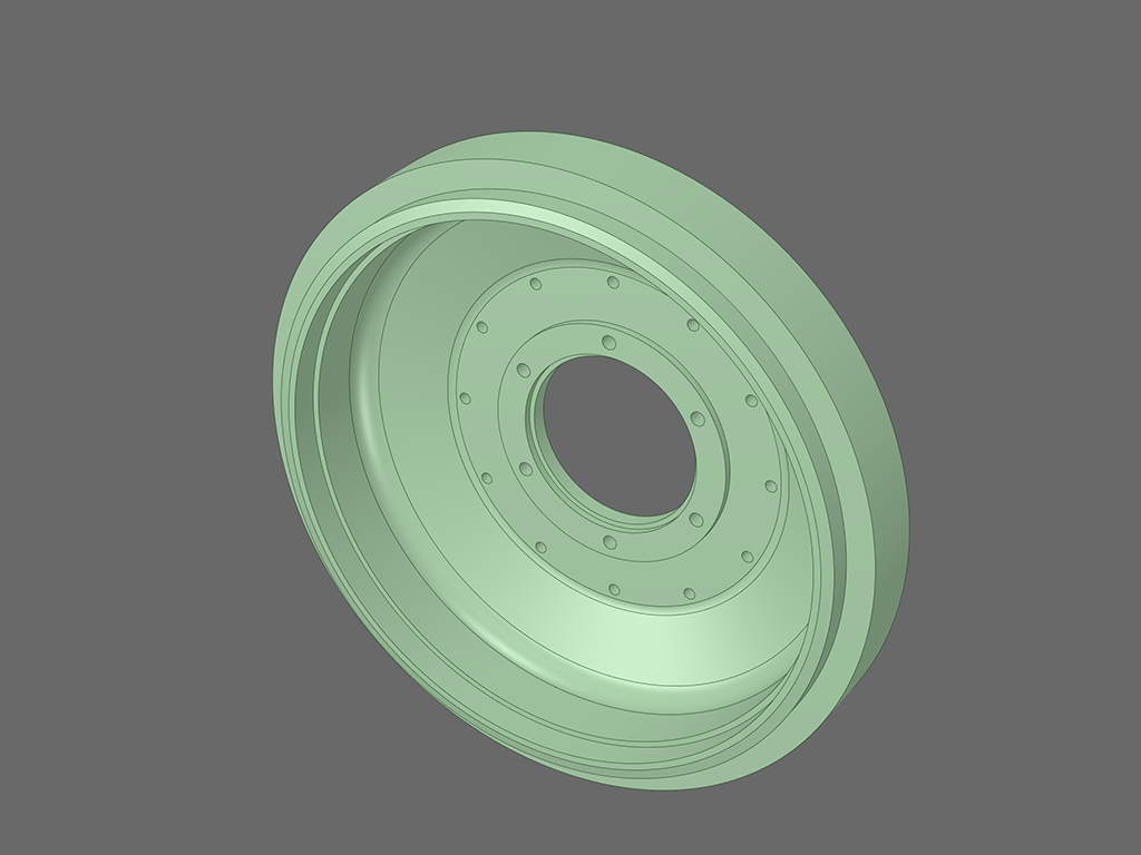

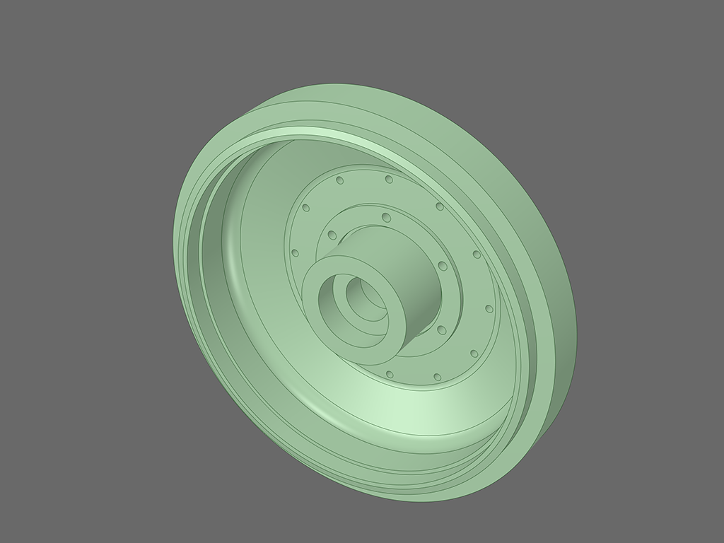

Spent a bit of time over the last two days drawing these up. They're designed to fit the standard metal HL swing arms with bearings (I happened to find a set in the cupboard this week).
The bearings will go into the inner roadwheel (last two pics), so it'll be supporting most of the weight. The outer wheel will mostly be for show, same as the stock HL set up. I've got some plans for the tyres, but if it doesn't pan out I've made the rims the same dimensions as the HL metal ones, so their tyres will be a direct fit.
I'll spend some time setting things up and experimenting during the week. Keep your fingers crossed for me, gents!

All crossed here too (just polished off a bottle of vino so most of me is crossed anyway). Is the HL metal suspension arm the same as the Taigen one, that is, simply a 3mm hole with a stub axle retaining grub screw?
A single bearing on the inner wheel should do providing the wheel is kept square and vertical. If the tyre availability is an issue, a printed wheel/tyre rather like the HL plastic example would do a fair job. I have to press a finger nail into the tyre to tell anyway. Either way, that's great news for all of us - thanks!
