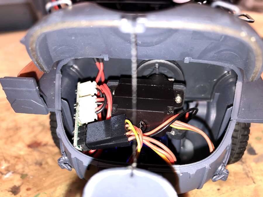

The boards seem fine, with no obvious damage or disconnections.
How does one get at the goodies? I see that Fred the French, especially, and others have done so.

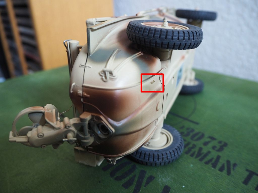

I also noticed what appear to be two metal nibs sticking just a bit out of the bottom rear of the Schwimmwagens. Does this work as some kind of contact?

The propeller will not activate while it is out of water as some kind of safety feature and you are right about the two prongs underneath, they are sensors to activate the propeller. A simple way to test while it is out of water is to put a drop of water on your fingertip and hold it on the prongs then it will work as intended , hope this helps :thumbup:

Many thanks, Lee! I was beginning to think that the two might contact through water, but I couldn’t believe it. I guess I should trust my goofy ideas because others usually beat me to them. Now my curiosity wants to know WHY? Does anybody know? Is it to protect some kid, aged 65+, from sticking his finger in that wimpy little propeller?

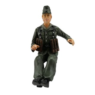

I am reactivating this discussion to ask how in tarnation one is to get these guys behind the steering wheel of a Toro Schwimmwagen. The only solution I can figure out is to put them into the box a magician uses to saw the pretty lady in half. :haha:
Any help?

Is there a 1/16 figure of Douglas Bader available somewhere? :D
