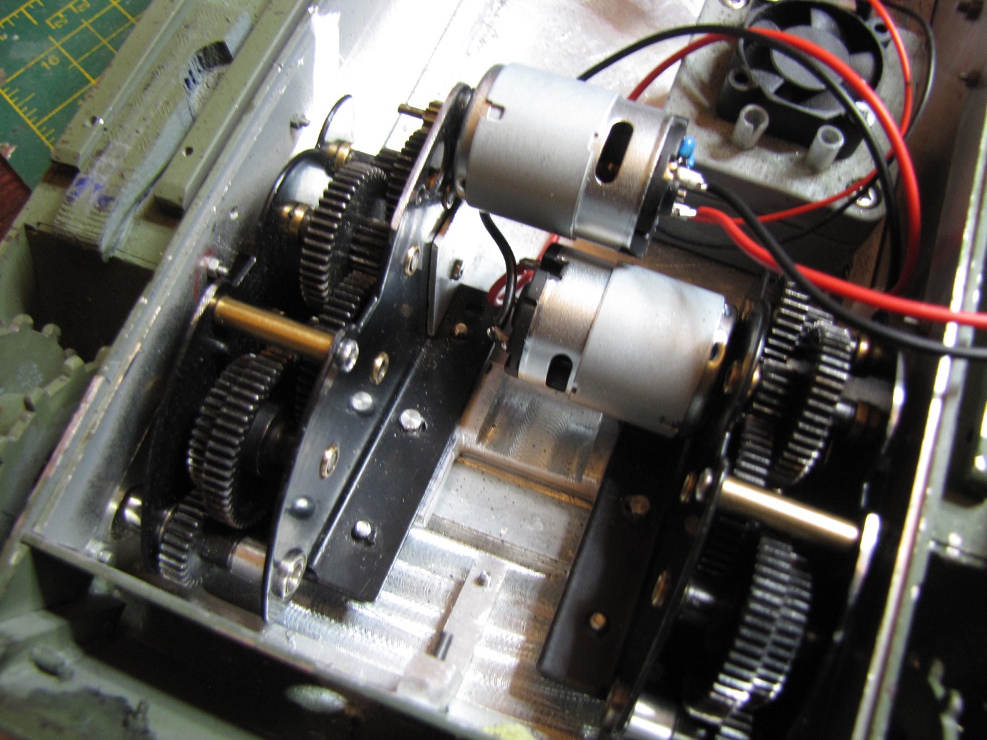

The 47mm body length of my present Taigen motors, assumed to be 390’s, were as long as I could fit in the space available without making custom gearboxes. I had already moved a motor on a 4:1 gearbox in order to fit the space available in my tank.
Space ruled out moving up to 480 or 500 series motors as well as my amps limit of 20a.

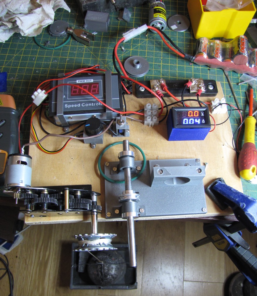

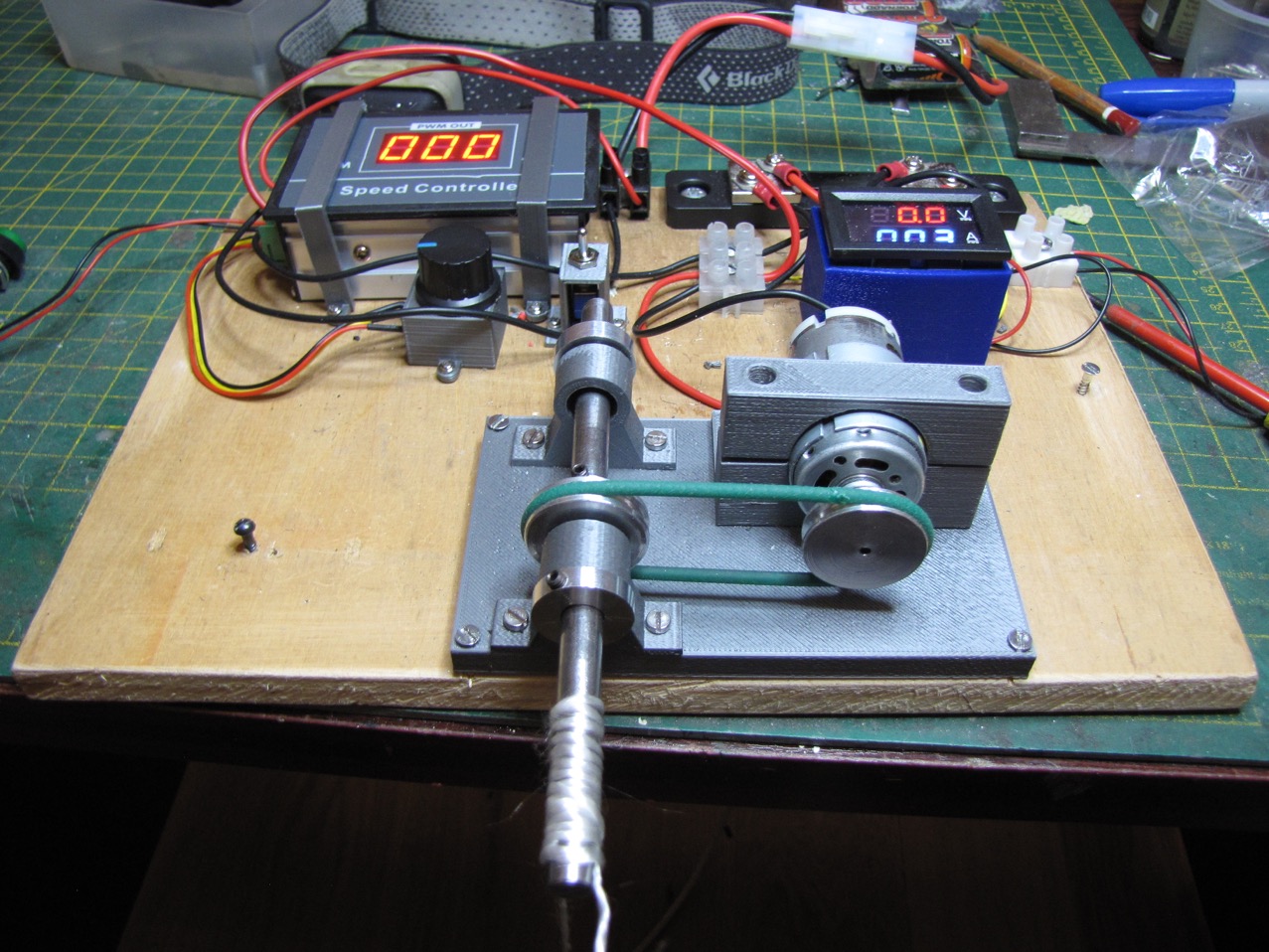

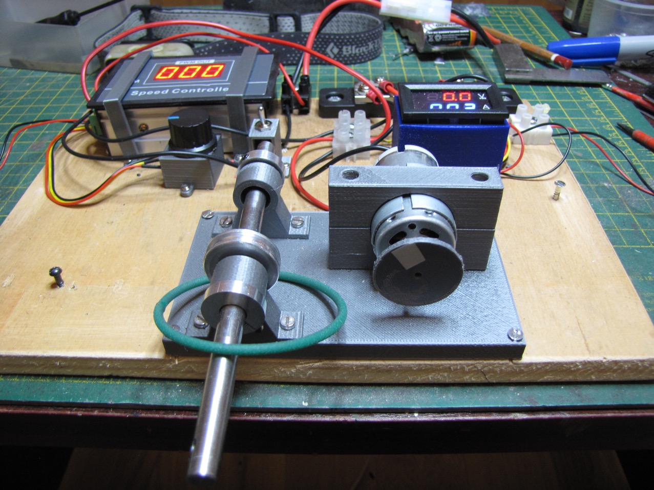

After looking at the gearboxes I then thought about conducting some experiments to see what motor suited me best. As mentioned earlier there was a lack of information about the standard Taigen Motors. I therefore decided to build a test rig in order to obtain some measurements.
My measurements of the Taigen motors would not be directly comparable to any of the data sheets available for other motors in view of the vagaries of my test rig. I then purchased other motors so I could compare results.
The test rig was made to measure the amps drawn, and provide an adjustable voltage supply. The addition of pulleys and a drive shaft running in ball bearings, enabled me to measure of weight lifted and stall amps.
Unfortunately, I did not have a 380 motor without fully stripping one of my older tanks.

Next, I measured the maximum weight the motor could lift without stalling (just) and the amps used to lift the weight. These measurements were repeated to gain an average and there were pauses in the process so the measurements were not distorted by a hot engine.

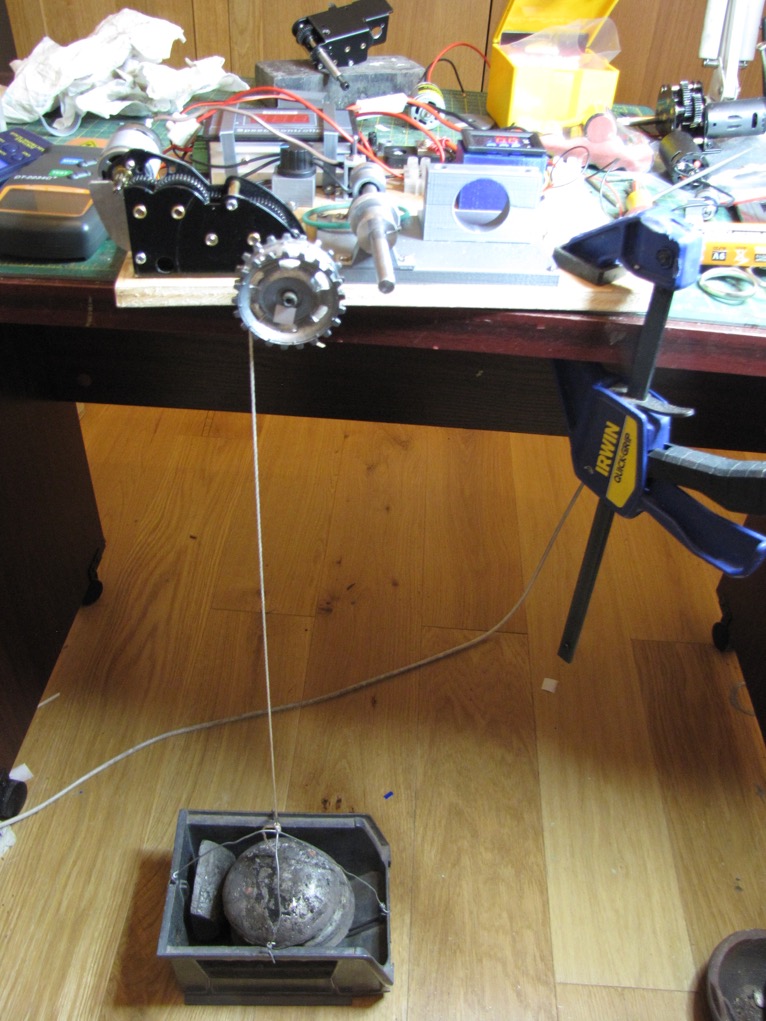

The next experiment was to test the Taigen 390 and Igarashi 048 connected to the 4:1 gearbox.
Edit - The 4:1 gearbox was used for all experiments.
This test involved lifting a weight at maximum voltage – generally 7.4v with the amps also being measured. The weight were blocks of lead hence the odd numbers.
6.4 kg 8.3kg 10.6 kg 13.7 kg 15.5 kg
Taigen 390 8.4amp 11.0 amp 14.0 amp 18 amp > 20 amp
Igarashi 048 5.2 amp 6.5 amp 8.7 amp 12.0 amp 13.3 amp
One thing that amazed me was the sheer amount of weight the motor/gearbox could lift.
Finally, I tried to plot the weight lifted to rpm. This was not easy as I only had a short time span to measure, particularly for the lighter weight/higher revs. It was not easy with only one pair of hands to control the motor, hold the tachometer and keep an eye on when the weight is about to smash into the pulley. Numerous readings were taken to obtain average results that I felt comfortable with.
3.2 kg 5.45kg 8.15 kg
Taigen 390 216 rpm 192 rpm 148 rpm
Igarashi 048 140 rpm 127 rpm 105 rpm
The Igarashi 048 lifted the greatest weight, at the lowest amps and at a rpm that better matched my needs, so these were fitted to the Black Prince.
