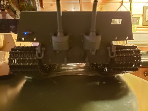

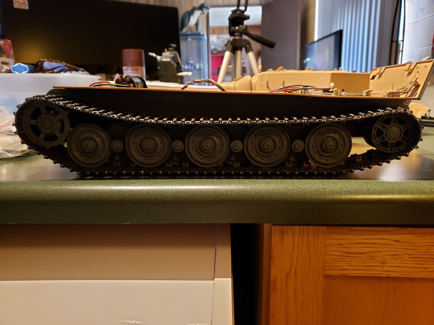

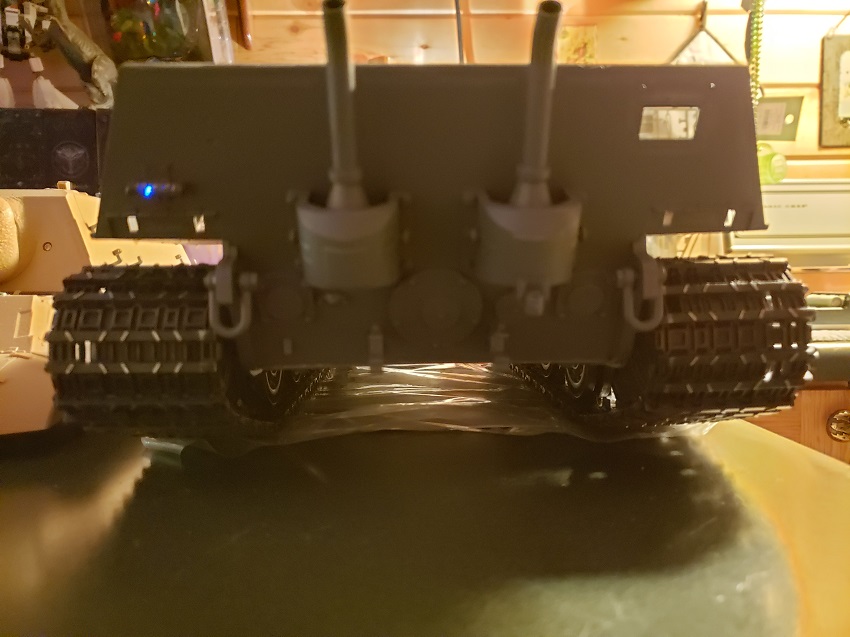

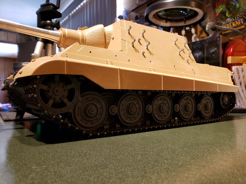

Afternoon all! Jimster, truer words neer' spoken! Even after 41 yrs here, it can still surprise me. Max! Thank for looking in again! I've lived in the small ( and cozy ) space here for 5 yrs now. Even tho' a bigger space is in the offing, I think that I will still do my old guy Hobbies here. Gillaspy, Thanks, Doc! The fun continues! The vistas I owe to the mountain ranges that surround us here in the Valley. Eric! A very truthful saying. It is coming along, my friend. Tonight I put the road wheels and idlers back on the Lower and remounted the tracks. I was pleased that I could now adjust the idlers and track sway with the adjusters after the circlip fix and they stayed where I left them at. A small fix but important when your tank weighs as much as this monster.

Those tracks are hanging just right! Very nice.

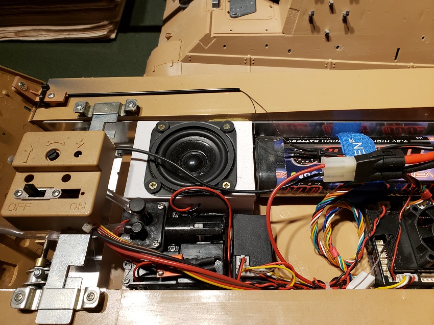

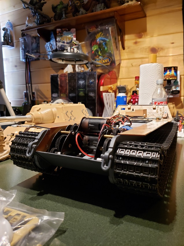

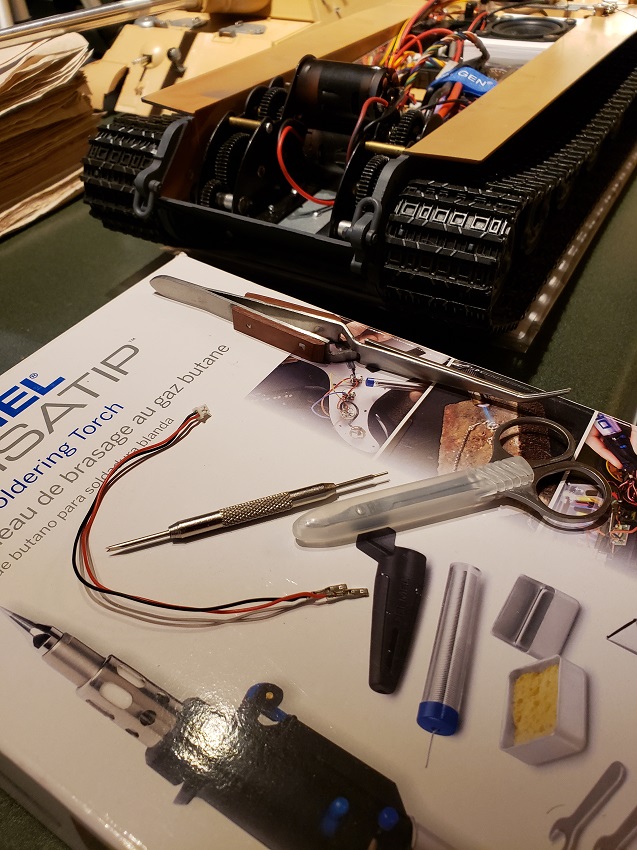

I picked up tools over the last couple of days to do the last bit ( fingers crossed ) of electrical work on this Build. The brass convoy light is of the type where only one of the lens illuminates. Great for looks and requires no dimming down. Two power ports are available on the Taigen series 3 board. There is the standard 'rear lamp back up' and on these new boards with their receiver option, there is the two pin circuit close mini port which is always powered. I have never liked the standard option since there is no Light unless the tank is in reverse. To use the two pin mini port, a cable has to be soldered together to work with the coated wire of this type of light. The results are worth it.
