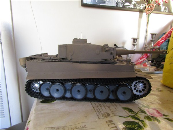

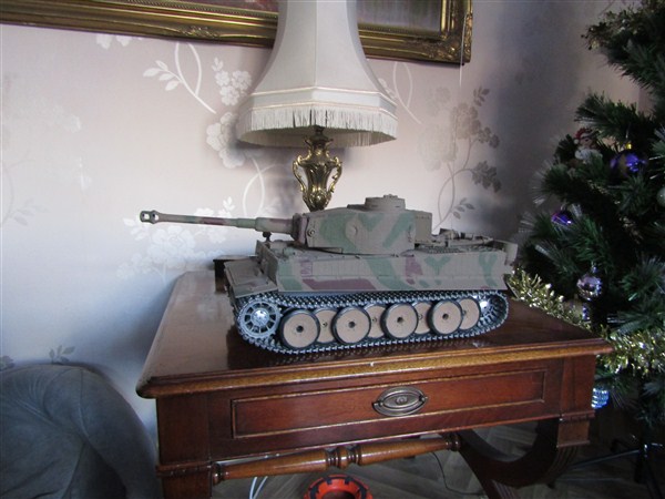

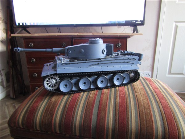

I attached 3 pics, would it be possible to upgrade to a rx18 ? are there kits available?
Thanks again
Frank
Thanks again
Frank
- Tiger 003.jpg (56.85 KiB) Viewed 1733 times
- Tiger 002.jpg (64.78 KiB) Viewed 1733 times
- Tiger 001.jpg (63.39 KiB) Viewed 1733 times

I feel in this case it will be cruel to be kind and fob you off with the ease with which a Heng Long RX13 equipped Tank can be converted to an RX18,
People will try to help you but the truth is it is a pain and what you would gain for the effort frankly just is not worth it,
If you are intent on upgrading the electronics on your Tank from the 80s to the 2010s this is what i would do,
I would gut the RX13 including the inaccurate and soon to be redundant engine cover mounted aerial and the PCB beneath it and spend £70 approx on a Taigen V3 complete R/C upgrade,
It Contains in one box the V3 Control board,Updated Speaker, Smoker, Sound card (When ordering do specify Tiger 1), Transmitter and all wiring
There will be the very basic modicum of Soldering required but very little and not particularly challenging,
The product is available from Dave @
www.forgebeartanks.com,
You will then have a system that will provide a reasonable sound/smoke and R/C Tank that should with very little effort be simple to install and would have the added ability to convert to using an aftermarket digital Radio Transmitter if you got fed up with the new transmitter that is part of the V3 Upgrade.
That is one mans opinion I wait with interest anyone elses offering

Hi Frank, you have a nice collection of Tigers there, as Jarndice has already advised it would be wise to upgrade the electronics to a more up to date version such as the taigen v3 offering, personally I have not done this surgery on a Tiger but take a look in the heng long and electronics sections and I'm sure you'll find what you need to know in there and if not the folks here will help out where they can, contact ( Dave ) at forgebear tanks and you'll be in safe hands for your tanking fix

Two tigers run well, the unpainted tiger will not start the RX13 needs to be replaced, I might upgrade sometime in the new year.
