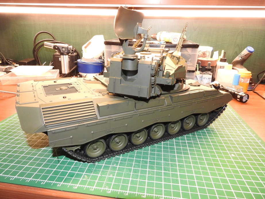

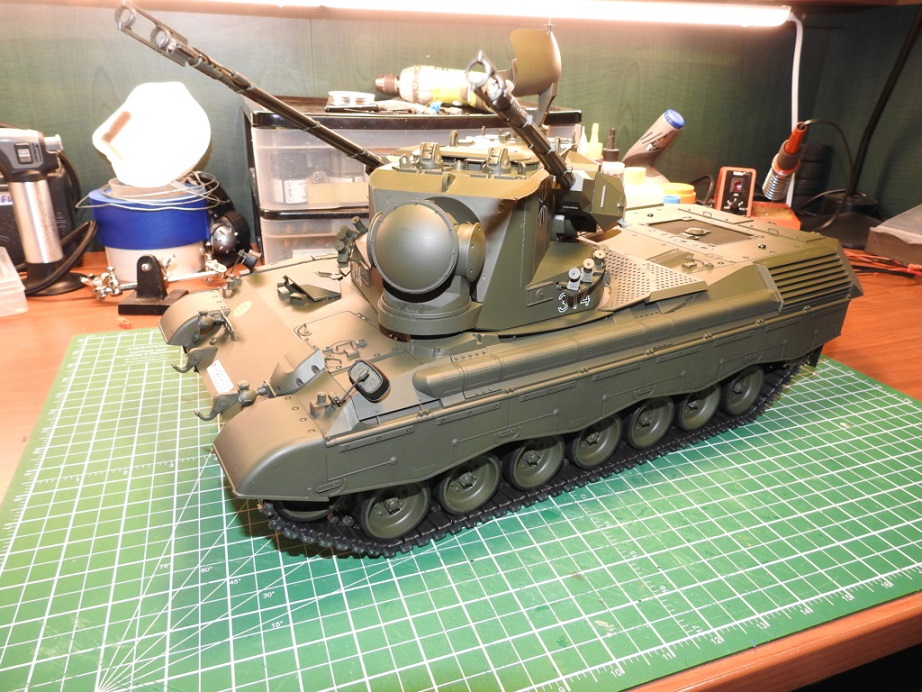

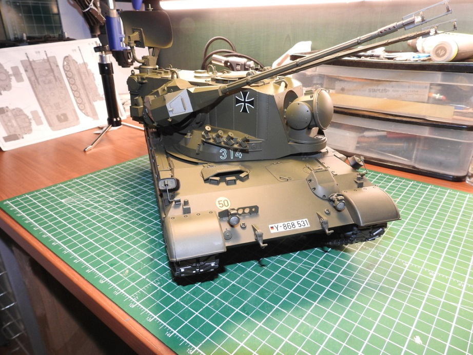

Well finally calling this done. Longer than my usual build. Can't even remember when I started but I think it was after the 1st lockdown here in Toronto, Canada. Anyway, got this display model off eBay for a reasonable price last year, then headed over to AFV website for the RC parts but they are not shipping then because of COVID, but Dom at rctank.de comes thru again, got it for me from them and shipped over. Order the gearbox, turret mechanical mount, front radar rotation unit and resin replacement. Turns out that the gearbox and motors is just an upgraded Heng Long set with the right mounting plate and shafts (I was hoping OEM Tamiya), and the resin front radar replacement is like in another scale, so ended up DIY the front radar from the kit but RC it, same as the rear radar. Also hook up the twin cannon with LEDs. I think total was about $1000 CDN. Not bad for a Tamiya, and definitely not bad for a Gepard which is rare as hell.

I used to have one of these back when a cable was needed to control everything. Let's see a video of all the neat functions going! ( a walk down memory lane for me )

Painless there is a youtube link on my original post with all the turret function going !
