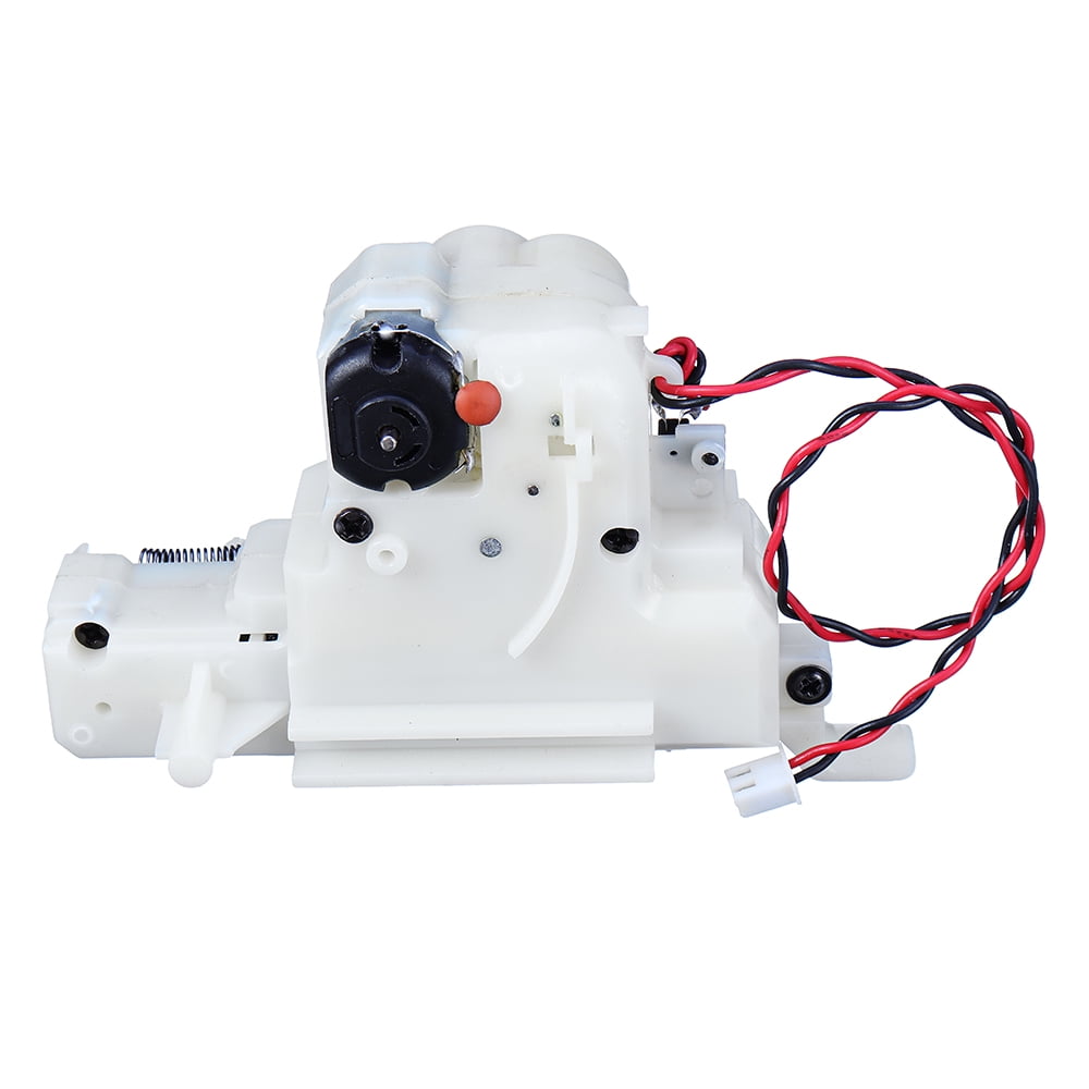

I upgrade a tiger 1 1st generation of my son. :crazy:
My problems, the connections of the electronic components and especially their wired connections.
The equipment to be installed is a transmitter kit and a receiver V 5.3s (TK-RXMB-301)
Currently it is the connection of the new white firing engine (BB).
I did spot the positive on the top of the engine (engraving) but the doubt is for the other two connections.
For me, after the brown circular capacitor (center) it would be the negative (black). and further, after the resistance it would be another cable (signal or auitre).
All is to be connected to the 8-pin connector.

To the best of my knowledge the MFU wiring is as follows... Unsure about the CN10 taillight polarity...

Also, the upper hulls have never truly changed a lot. Wiring is still basically as follows.
Or are you talking about the capacitor and polarity on the airsoft unit?

To Mr Jarlath, yes, in fact, I talk about capacitor and polarity on the airsoft unit.
Following the transmitted photo and BB unit, we can see three connection points per weld.
For me, the first is located at the top, near the resistance waiting to be connected.
The 1 is a wire which I do not know the outcome of the connection (thank you for informing me),
the 2 plugs into the positive, red thread,
and the 3 is connected in negative, black wire (although indicated + on motor).
2 and 3 = the motor that drives the gears that drives the internal recoil movement of the firing pin rack (airsoft).

OK. From every place I have seen. The polarity should be as follows.
Mind you I don't have any airsoft left in my tanks and have not looked at one in years? So I could be wrong....

Thank you but my BB is the white as in photo 2 of your first answer.
I had already noticed that it was necessary to weld the black wire in front of the + sign engraved on the engine.
I’m trying to send you pictures of my montage.
It is not definitive because do not know which wire I have to weld after the resistance of 70 ohms or where this wire branch.
Do you have that information?
