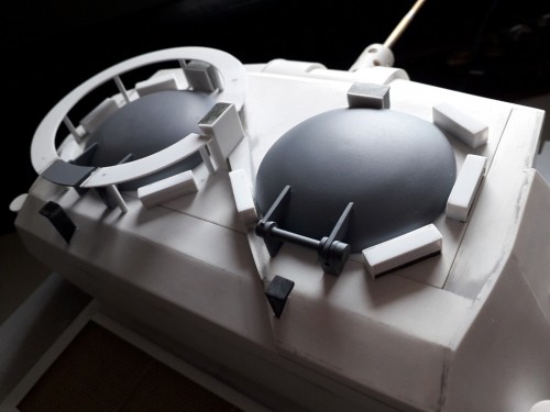

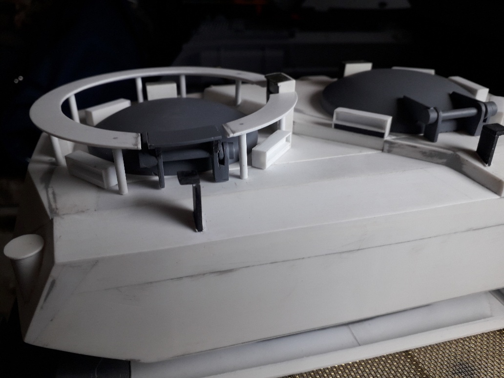

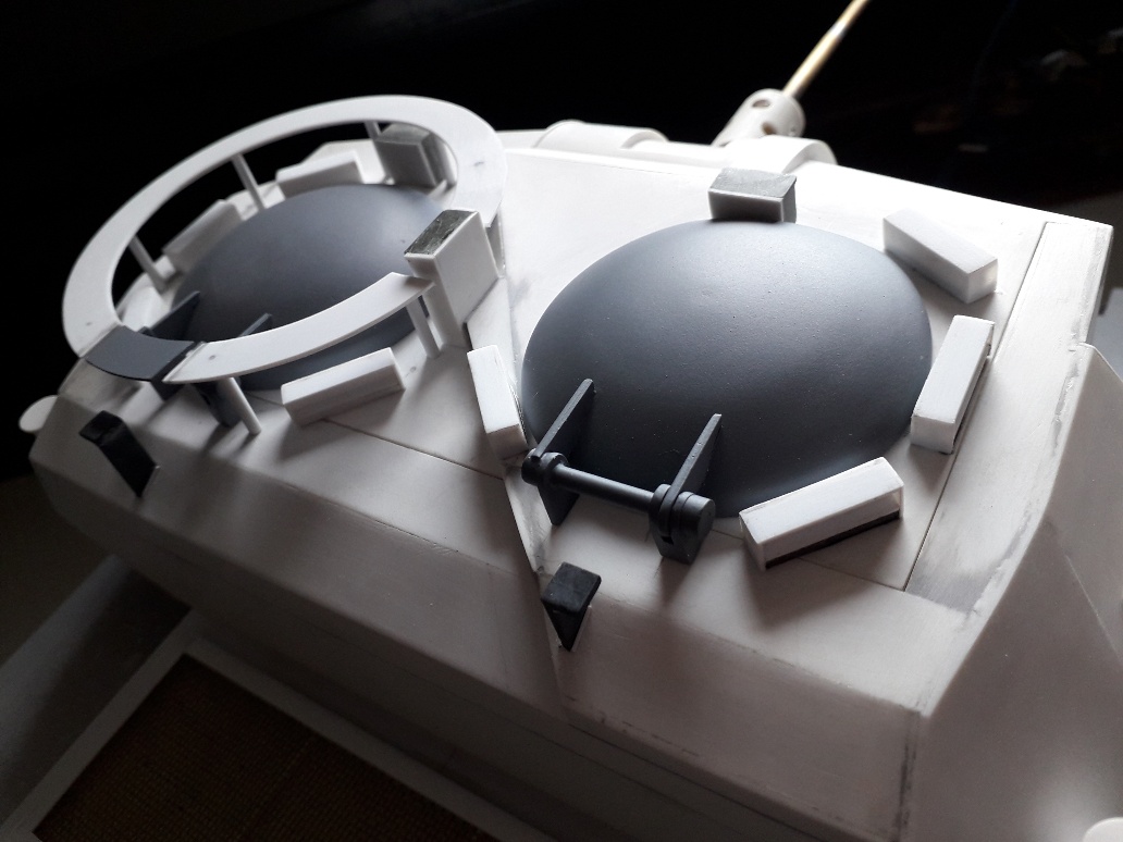

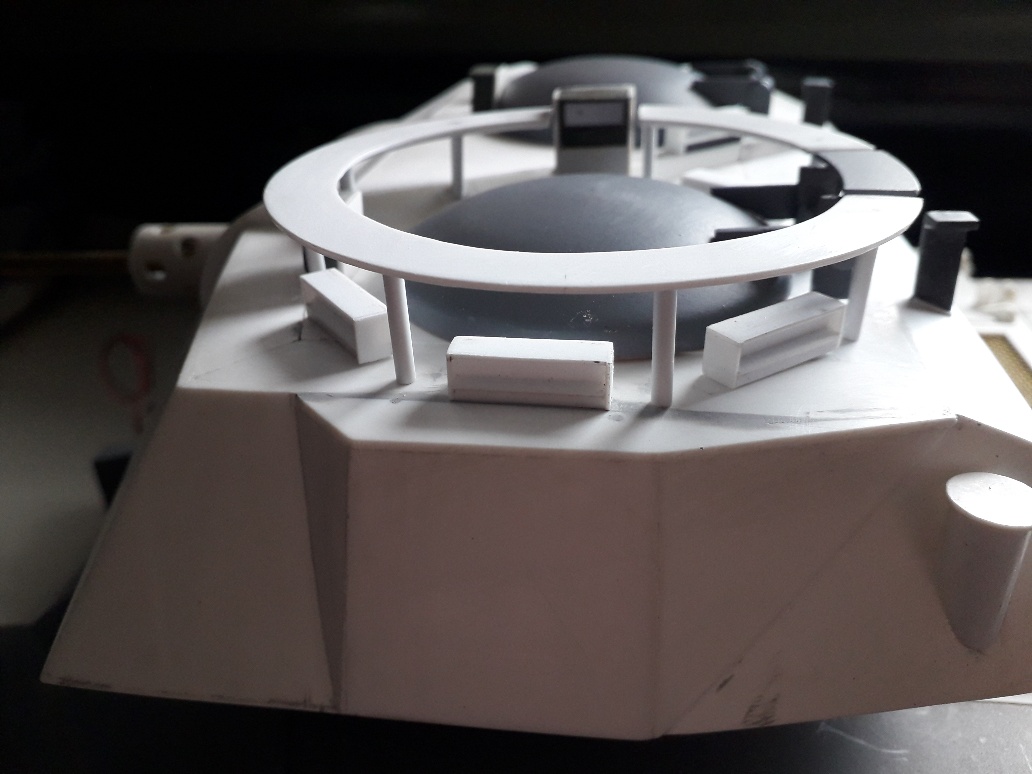

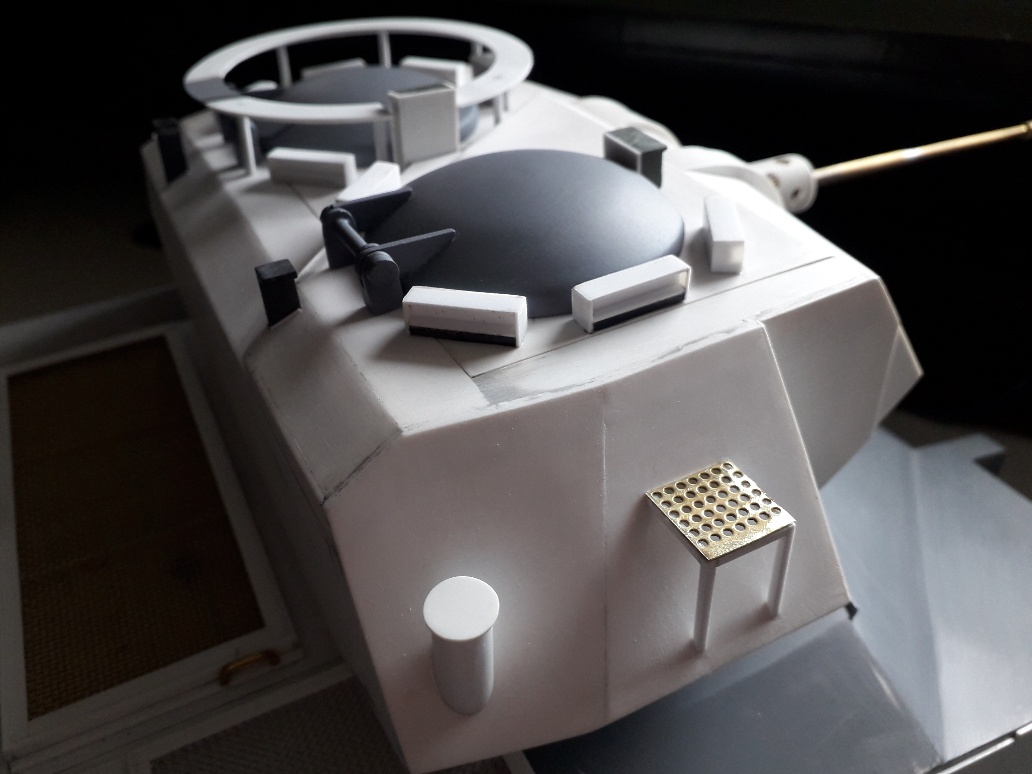

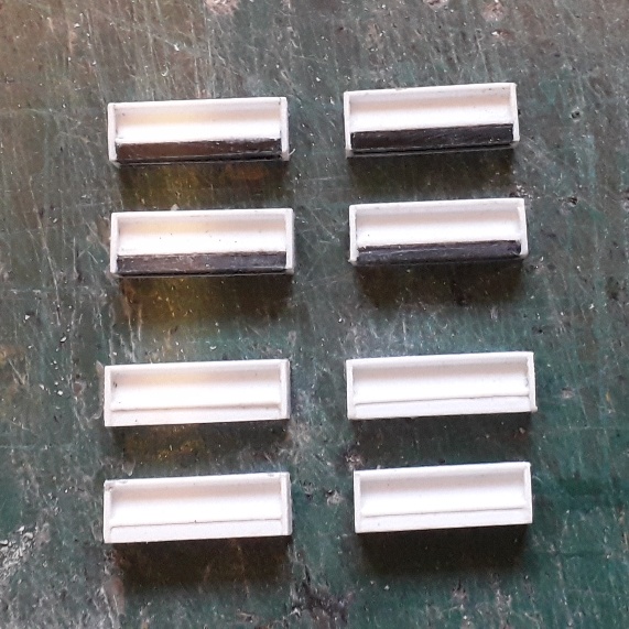

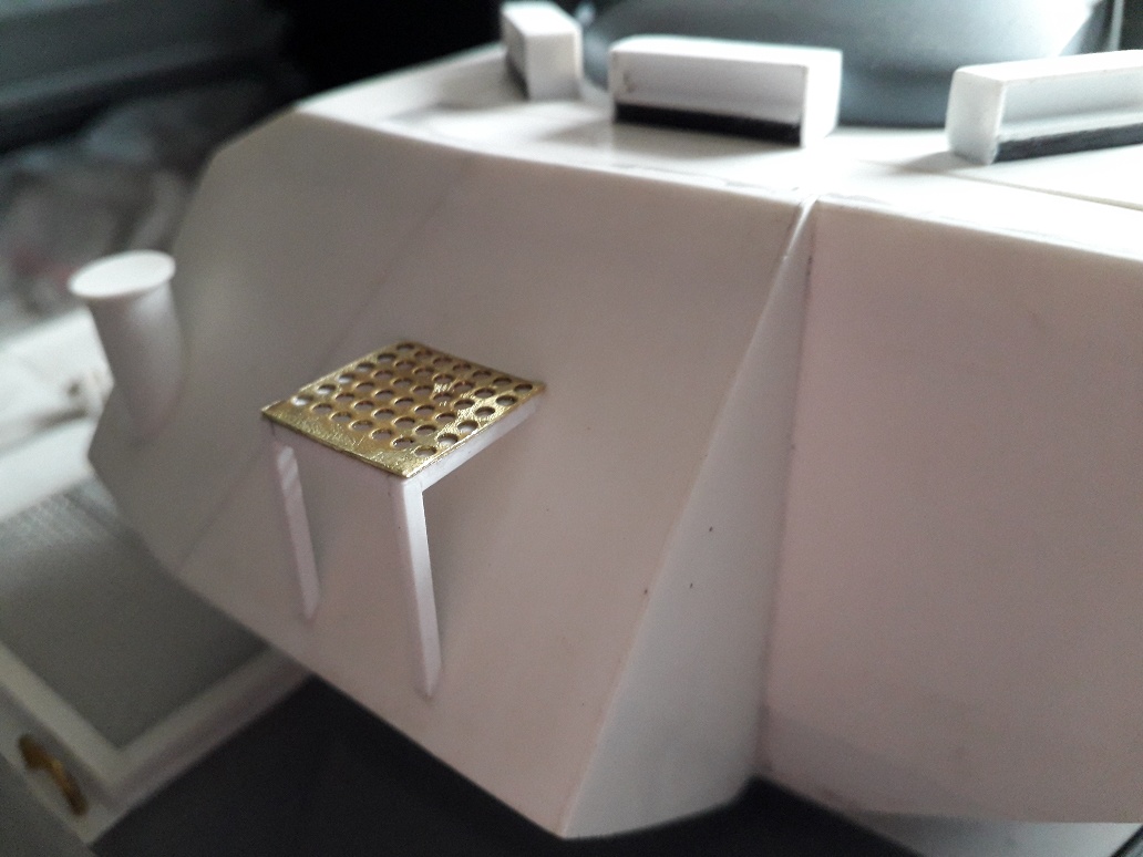

Further work done i made 8 low profile periscopes for the turret top and glued them in place, plus some form of bracket and step on the turret commanders side.
Sub.
Thank you for your interest and kind words, it is a real shame that folks don't look at the post WW2 era of Armoured vehicles so much as the scope for different vehicles is enormous, as for scratch building its been a case of over 50 yrs of experience, and learning the hard way over the years, and starting off making something simple and gradually making more difficult and complex shapes and throwing most in the bin and restarting lol...most people get overwhelmed by looking at the whole thing, but you really need to look at it in smaller bits at a time, make that then move onto the next piece and so on...
Someone once asked an airline pilot how they managed to look at all those guages and dials at once....they replied I don't I only look at the one i need to read!!!.

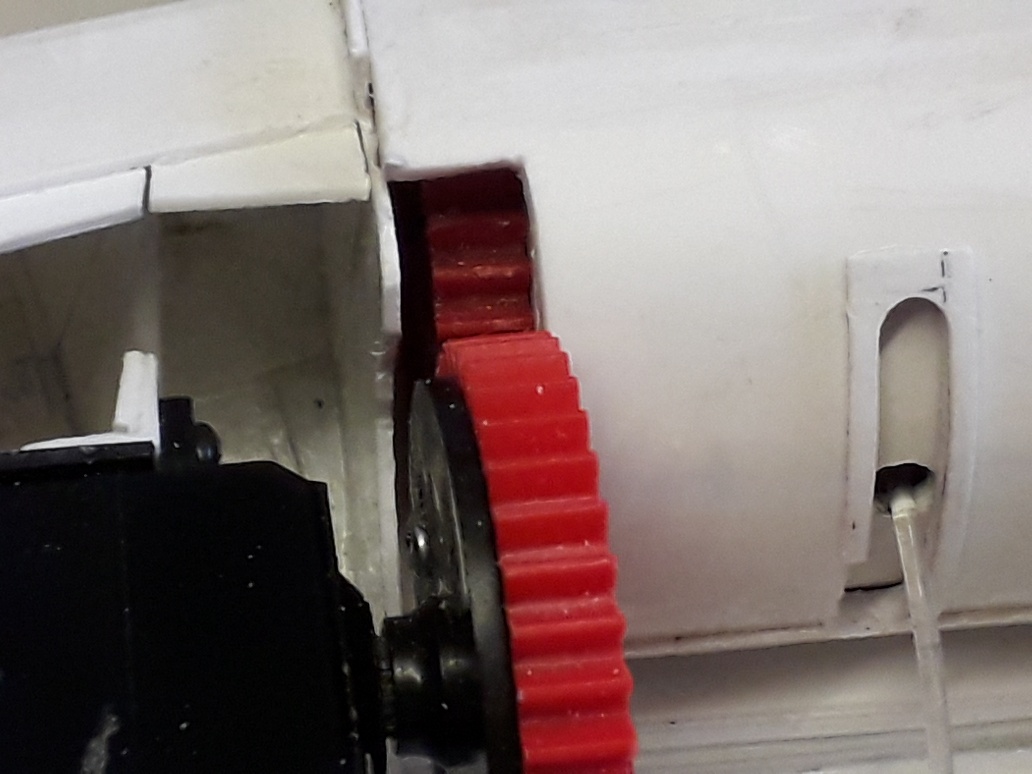

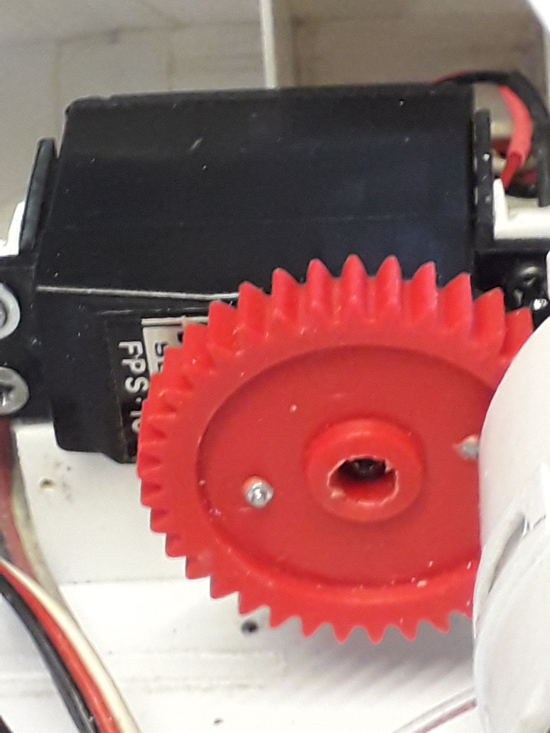

I had to modify the Cannon barrel lifting mechanism as i wanted to fit my gun barrel deck auto leveller into this model, it worked fine for normal servo operation but just lacked the finesse of what was required for the electronics i made so i converted it from servo arm operation to a set of gears and this was much more suited to the deck level sensor.
A few pics of the conversion and a short you tube video of the now installed Cannon auto deck level sensor working and fitted to the tank, now onto barrel stabalisation if i can figure it out.
Please ignore the wonky brass barrel as it is not centralised or fixed in position yet, its just pushed in its hole for demonstration purposes.

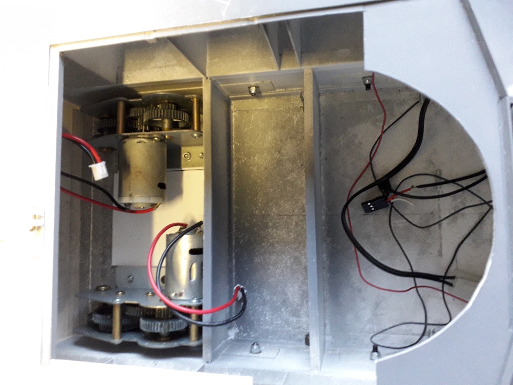

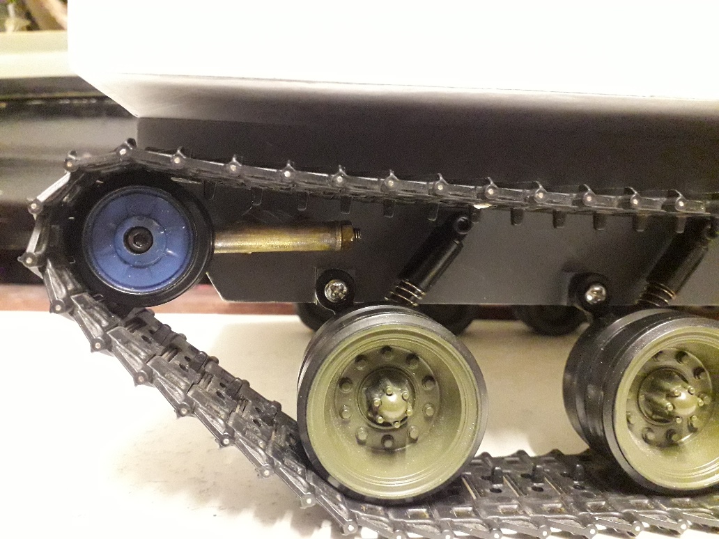

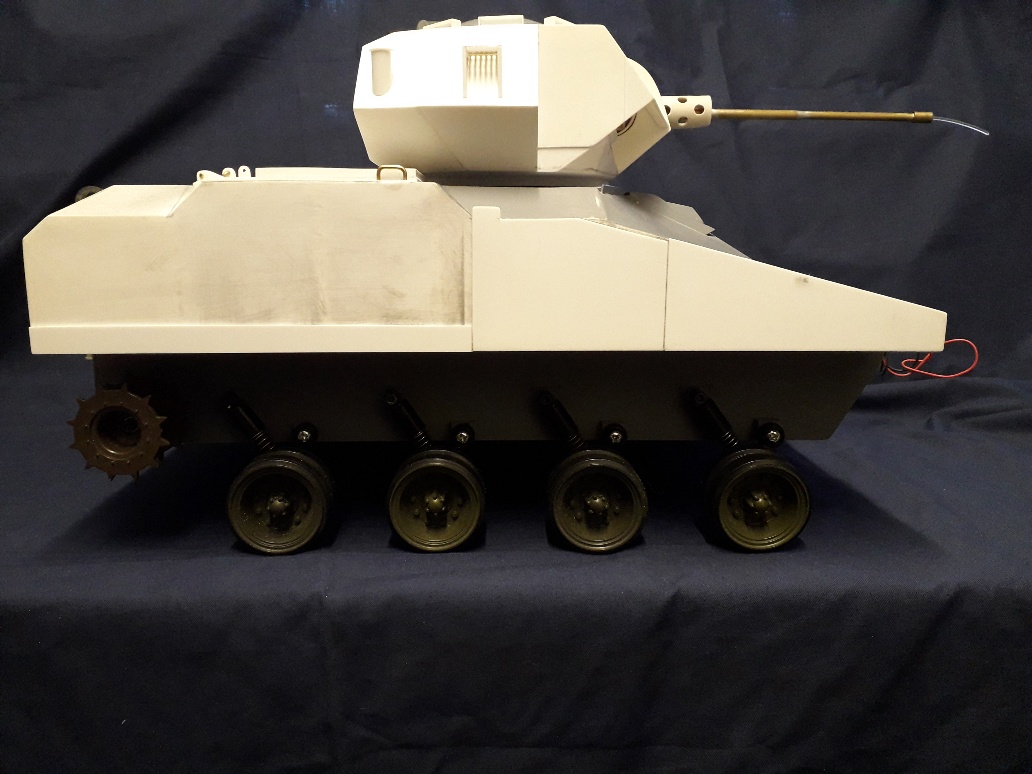

Motors, gearboxes mounted for trial fitting.
Road wheels, suspension all fitted for alignment tests.

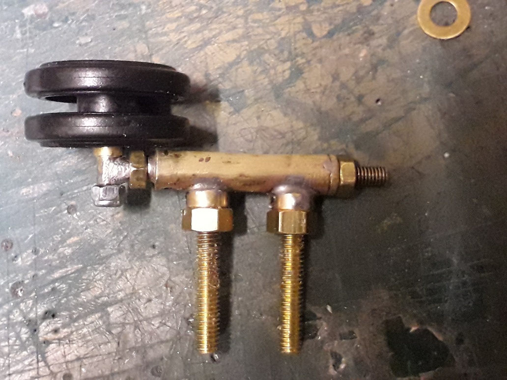

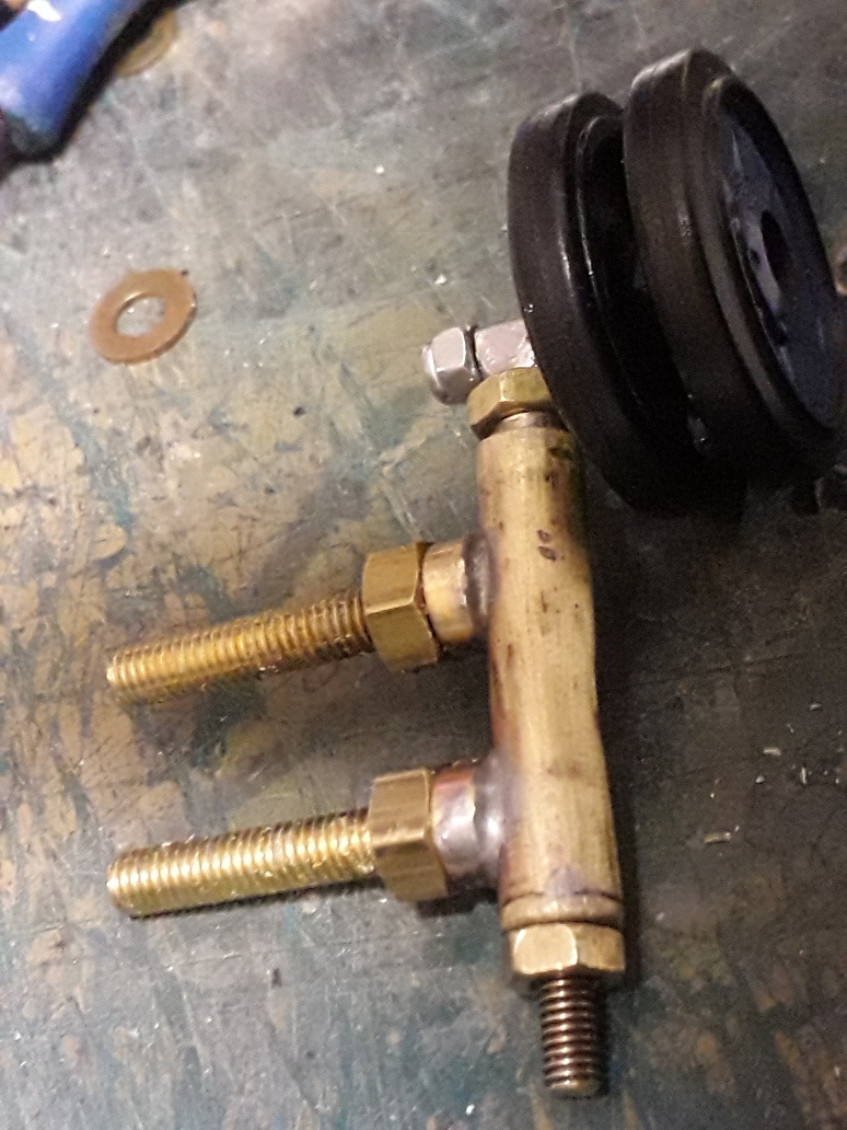

Scatch built idler mounts and track tension adjusters from brass fitted together with modified P1V road wheels for the smaller idler wheels that are fitted.
All bolted up and track had perfect alignment ( The time spent early in the build measuring and working out all the positions proved time well spent).
Wheels need cosmetic upgrades to resemble plain steel wheels of original.

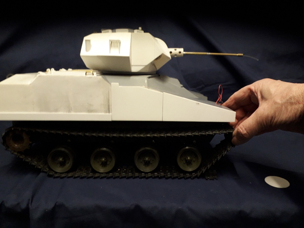

Few photos added of the above and final track fitted and adjusted to correct tension.
Video to follow shortly of testing of rolling chassis.
