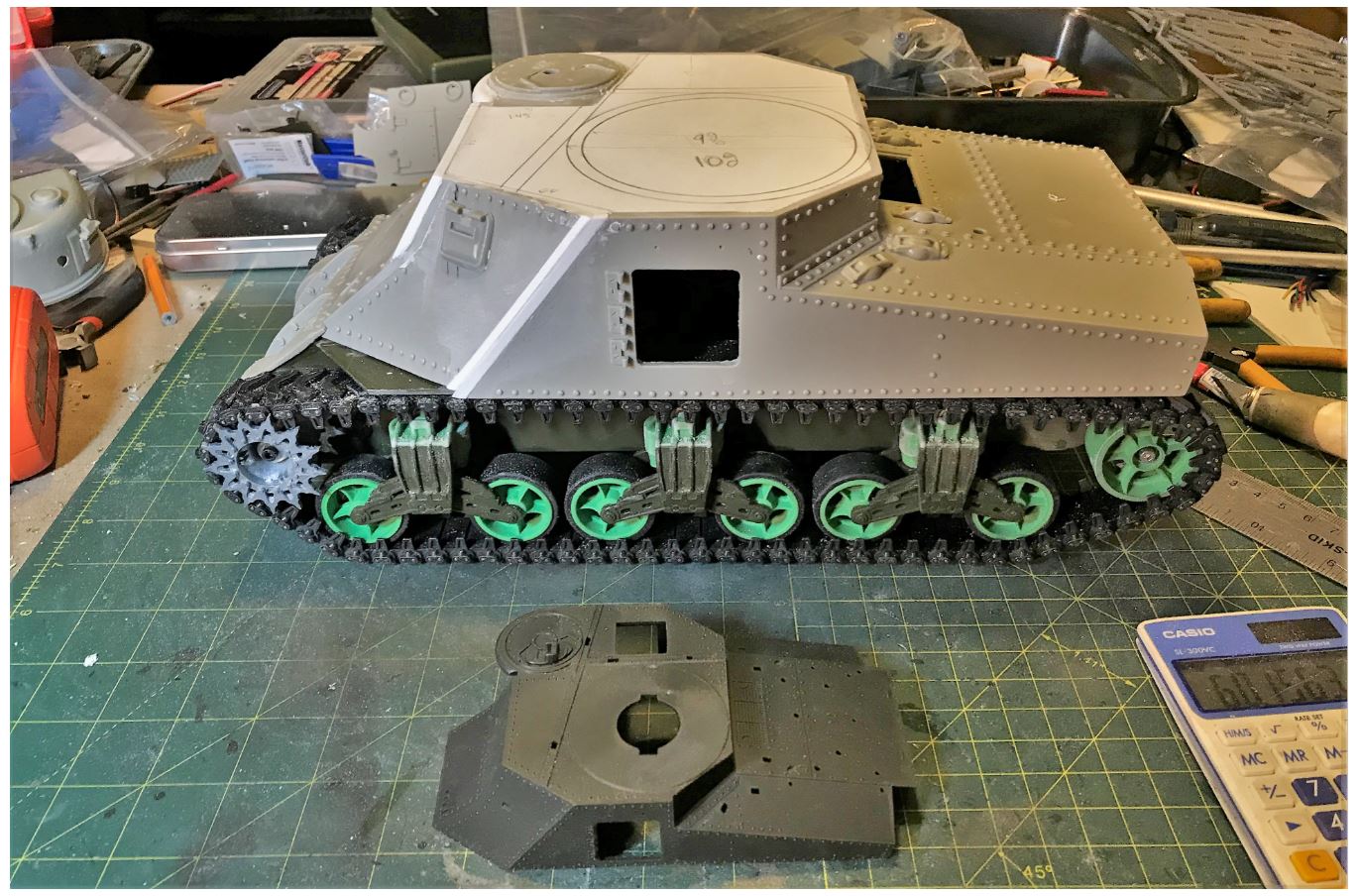

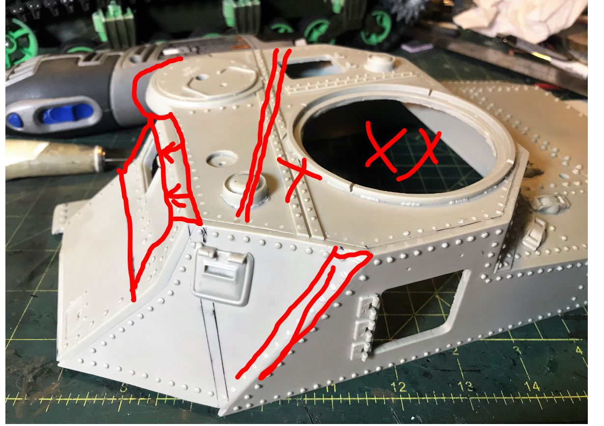

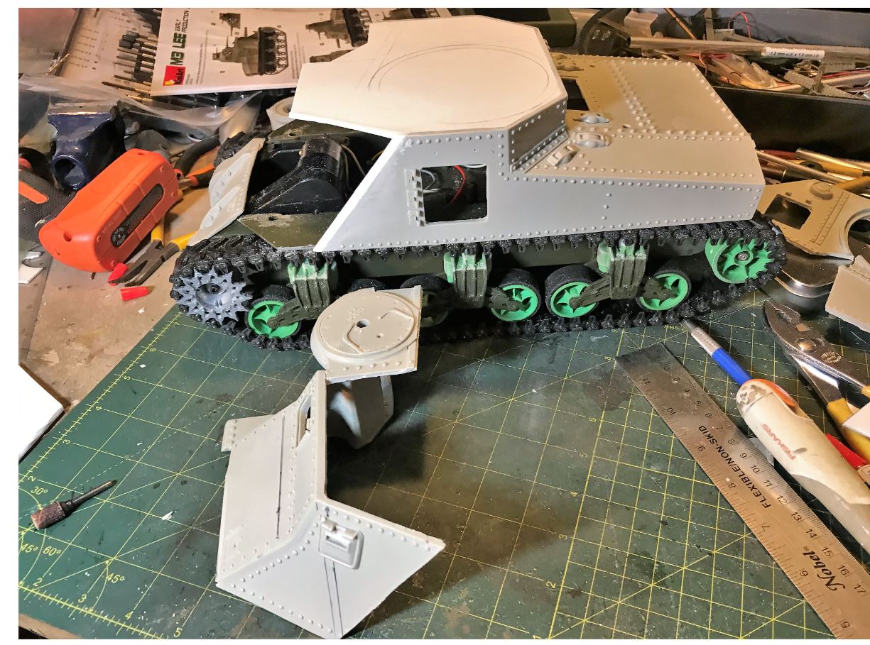

Final plans are made for the surgery. Need to extend the upper hull by at least 5mm towards the front to make room for the larger turret on top, redo the frontal plates and all features as per references.
Many modellers, having paid good money for a kit, feel somehow obligated to build the model as per instructions. Personally, i never follow instructions and i am not too worry about cracking a hull open to correct designer mistakes.
RC 1/16 M3 Lee early production tank - build

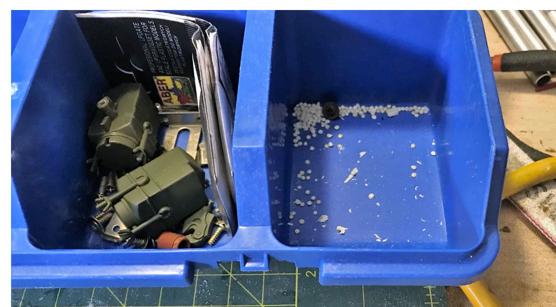

In order to maintain consistency across the tank, all the bolt heads in the areas of rework were salvaged for reuse on the upgraded hull.

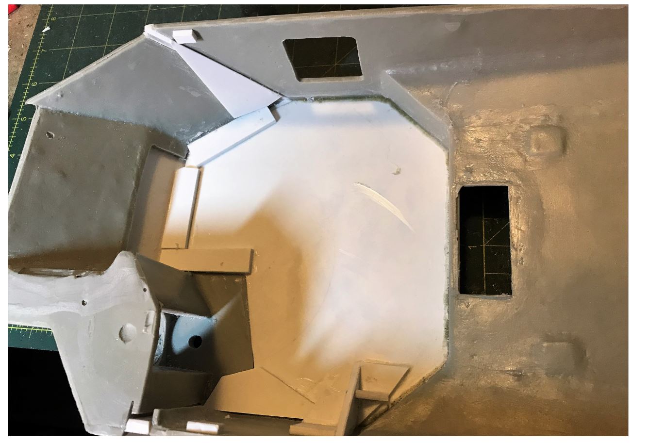

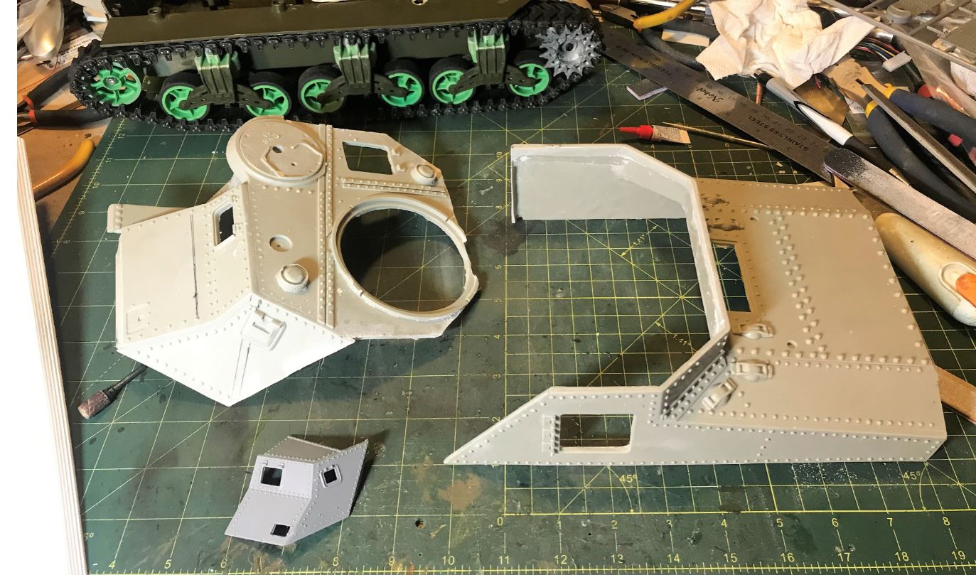

The upper hull is cut open with a heavy disk blade on the Dremel. The whole operation was cutting through and burning resin with heavy fumes. All the cutting need to be done outside and in a light breeze. All the plastic and resin sanding for this work is done wearing an N95 mask, an absolute must to preserve lungs and health.

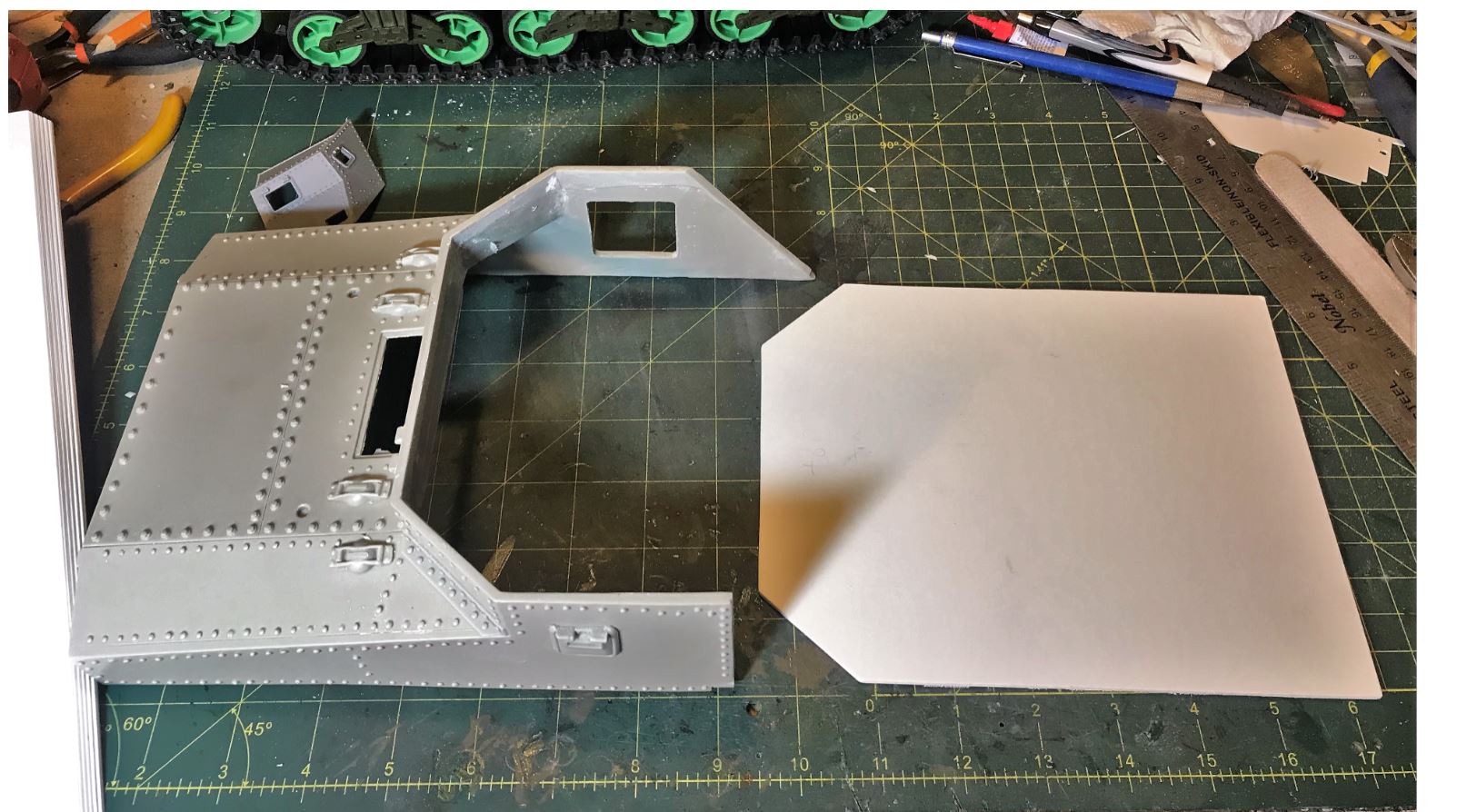

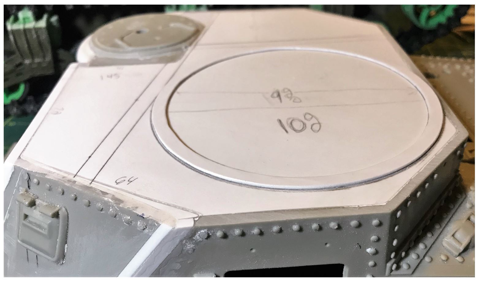

A new upper plate is created in 2mm plasticard with the optimal dimensions required. Remains to be seen how it can fit.

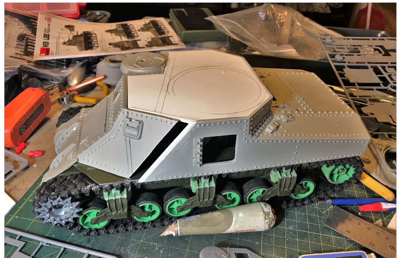

With the new top tentatively in place, the frontal section need to be put back... All the rework is done in a telescopic fashion, one area at a time, and cutting the plasticard slowly while positioning each touch points.

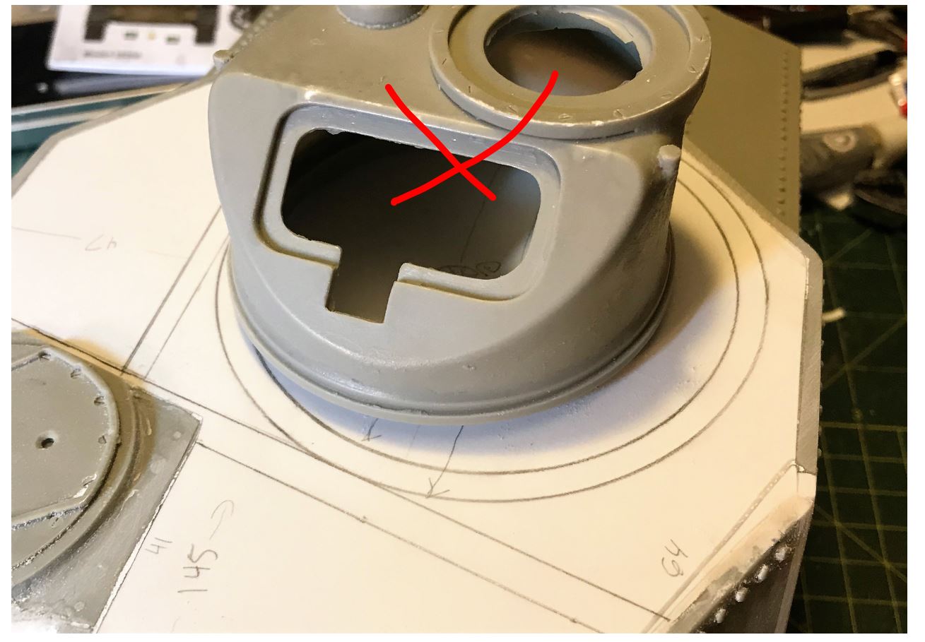

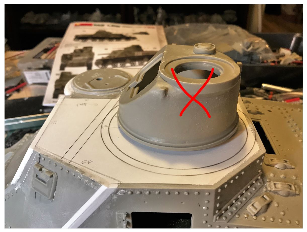

You can see where this is going. The ring for the new turret has been drawn on the upper hull, that is untouchable and must fit. But all the rest needs to be adjusted. I found that the Miniart kit is a bit longer than a regular Sherman hull and using it to extrapolate 1/16 measurements for this conversion is creating issues, parts becoming too big. For the hull dimensions, i recommend using the Tamiya kit which is a bit smaller and closer to the Mato hull when trying to replicate in 1/16. Small adjustments and cheating is required here and there to adapt to the rest of the Vandra hull, which is not perfect. In order to have a better fit and get back a few mm in length, i can see now that redoing the frontal armor as per references is essential.

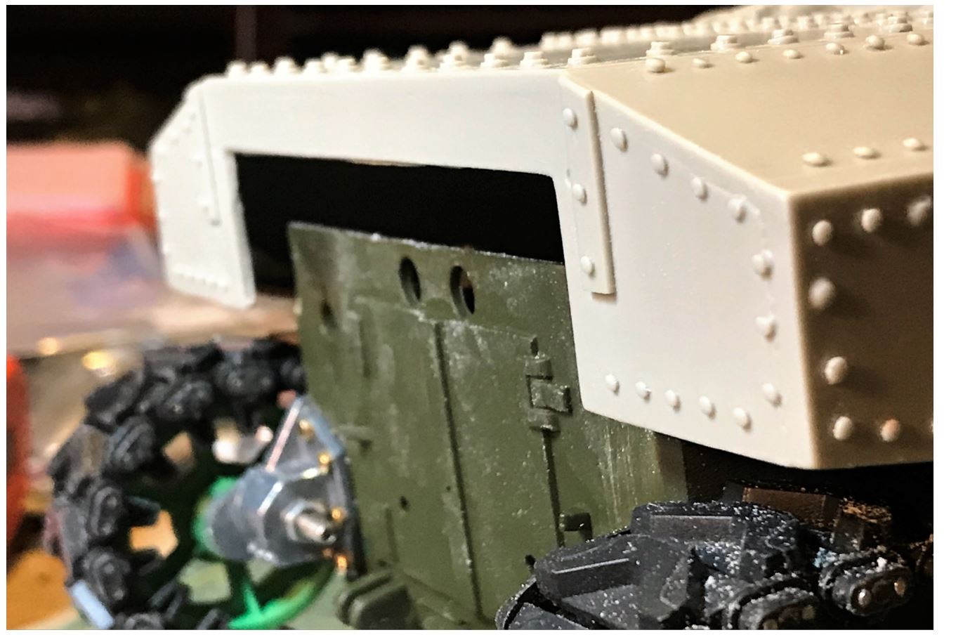

The upper section of the glacis is too short. The visor is totally squeezed in and not realistic.

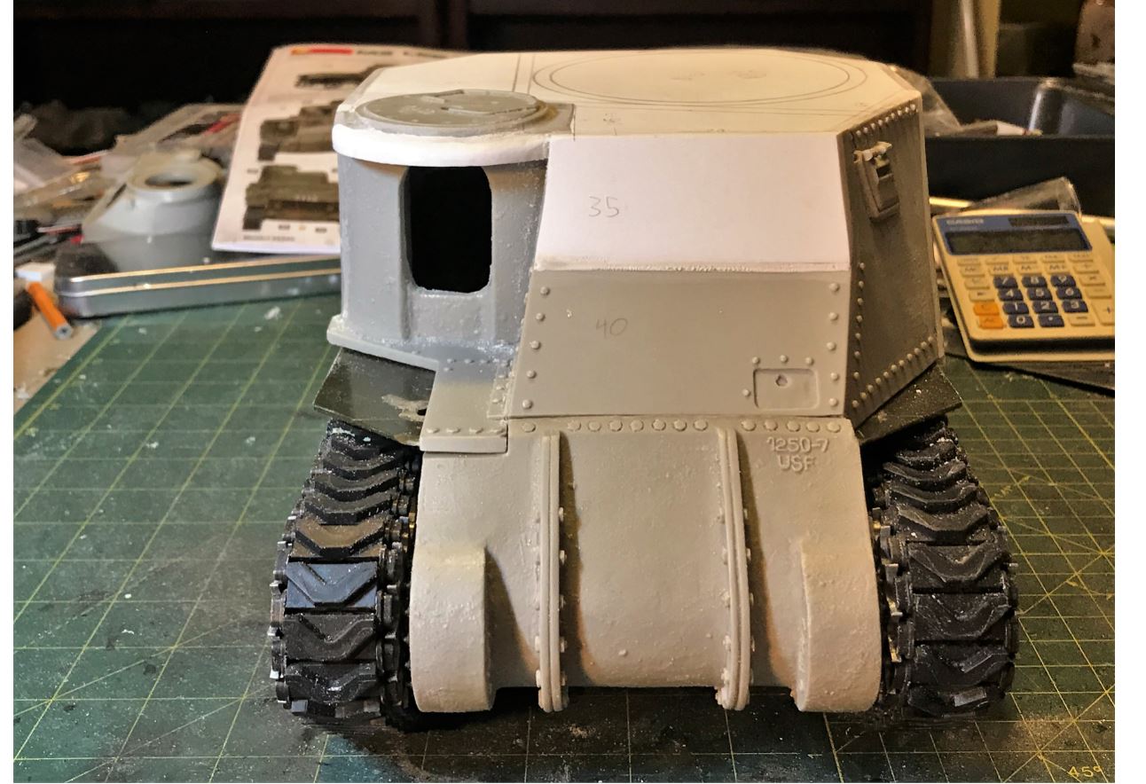

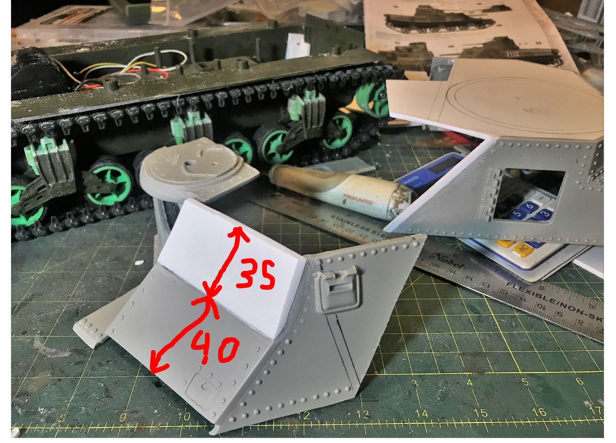

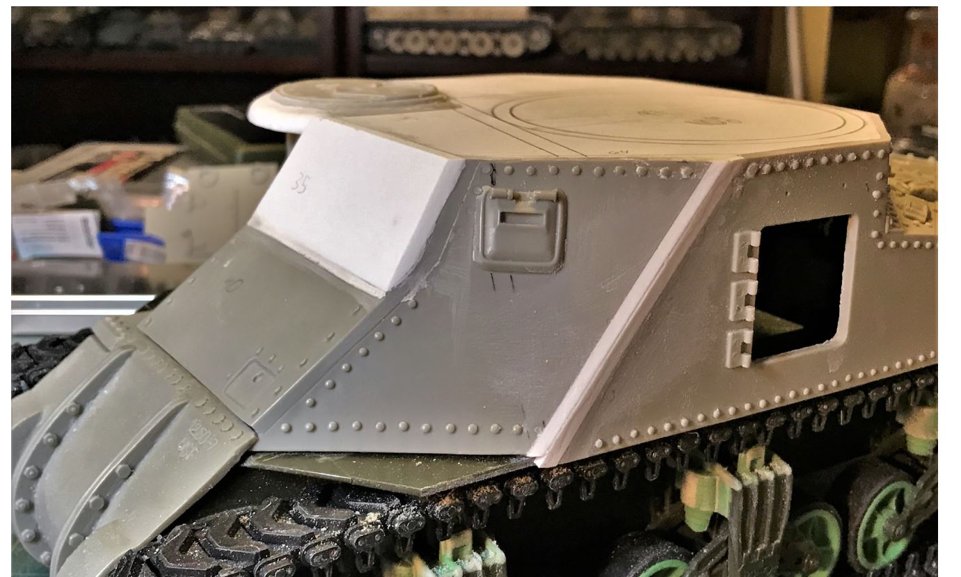

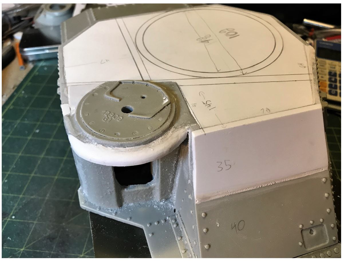

The upper section should be 35mm in height, the lower one 40.

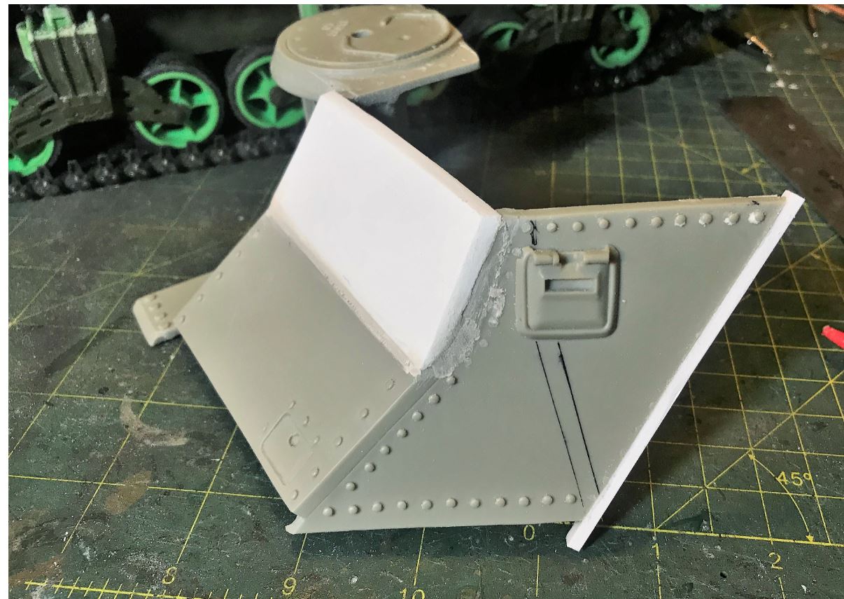

The new upper section is applied as an overlay, the old one behind is removed, freeing about 3mm in space on the turret top.

Superglue is used as putty and sanded smooth in 2 or 3 rounds for a strong joint. All the lines between the armored plates will need to be re-scribed.

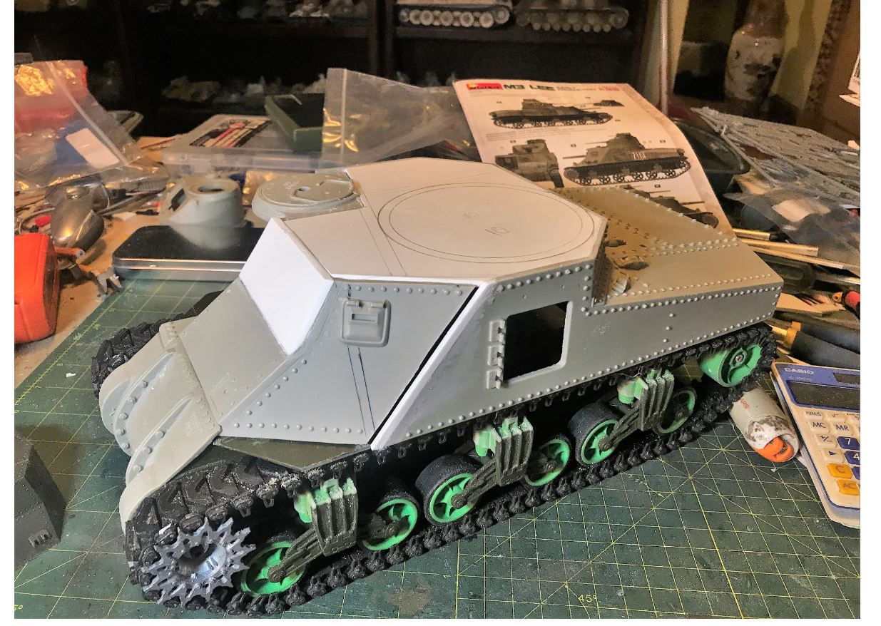

This is the situation on the right side. The gap needs to be filled.

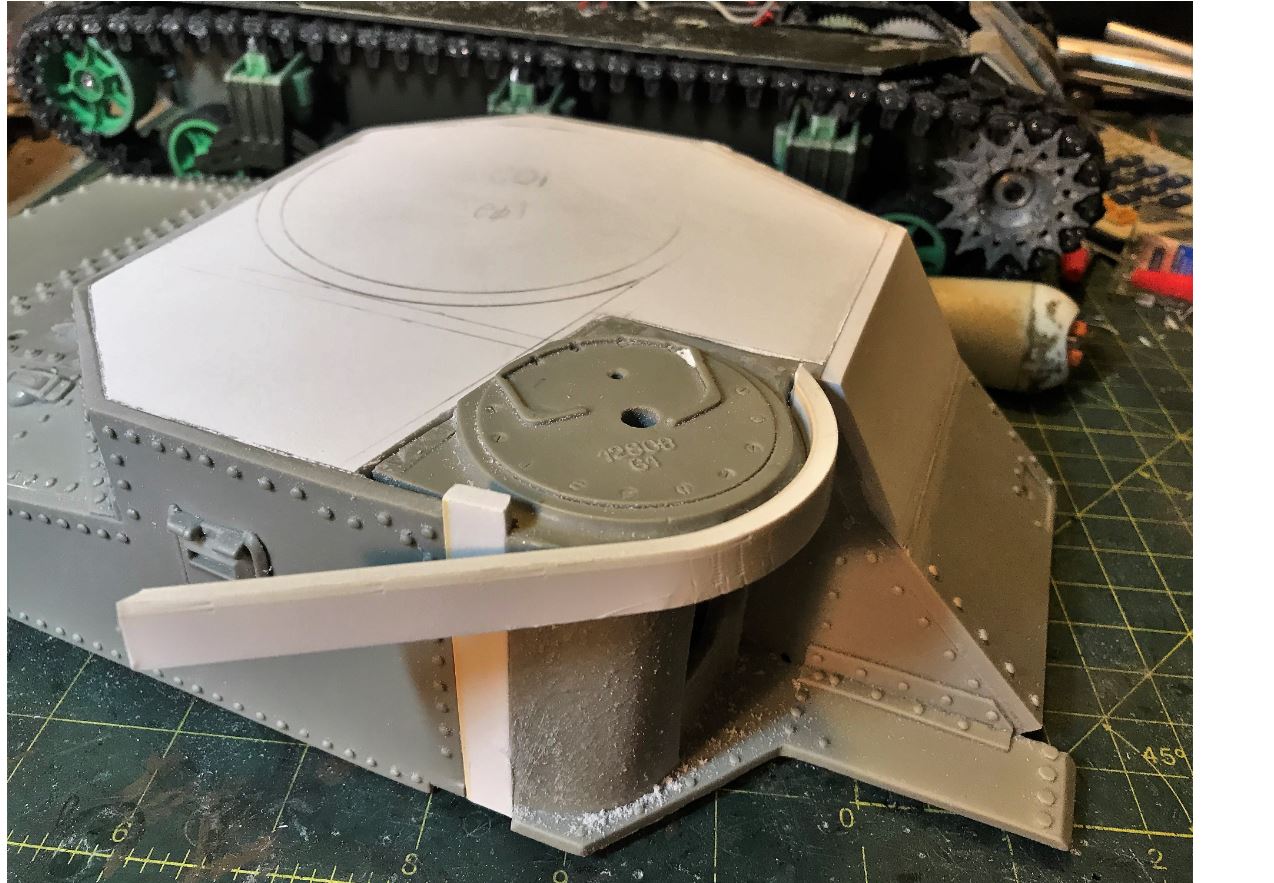

The tower rim needs to extend more towards the front. a 4mm plasticard are used.

Every joints are reinforced underneath.

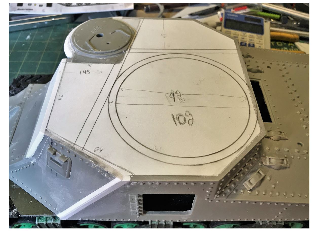

This is the new upper hull top, with the dimensions indicated.

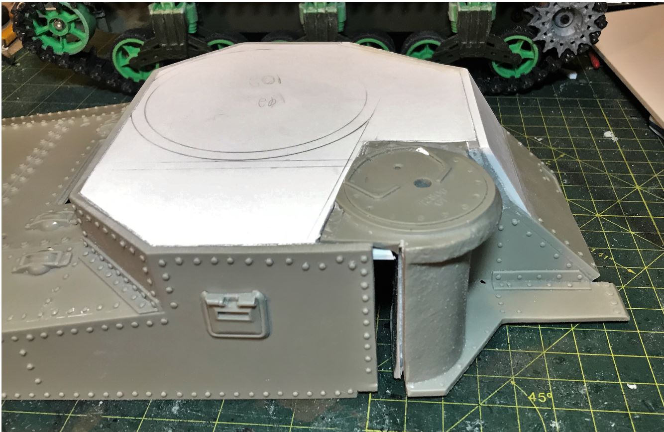

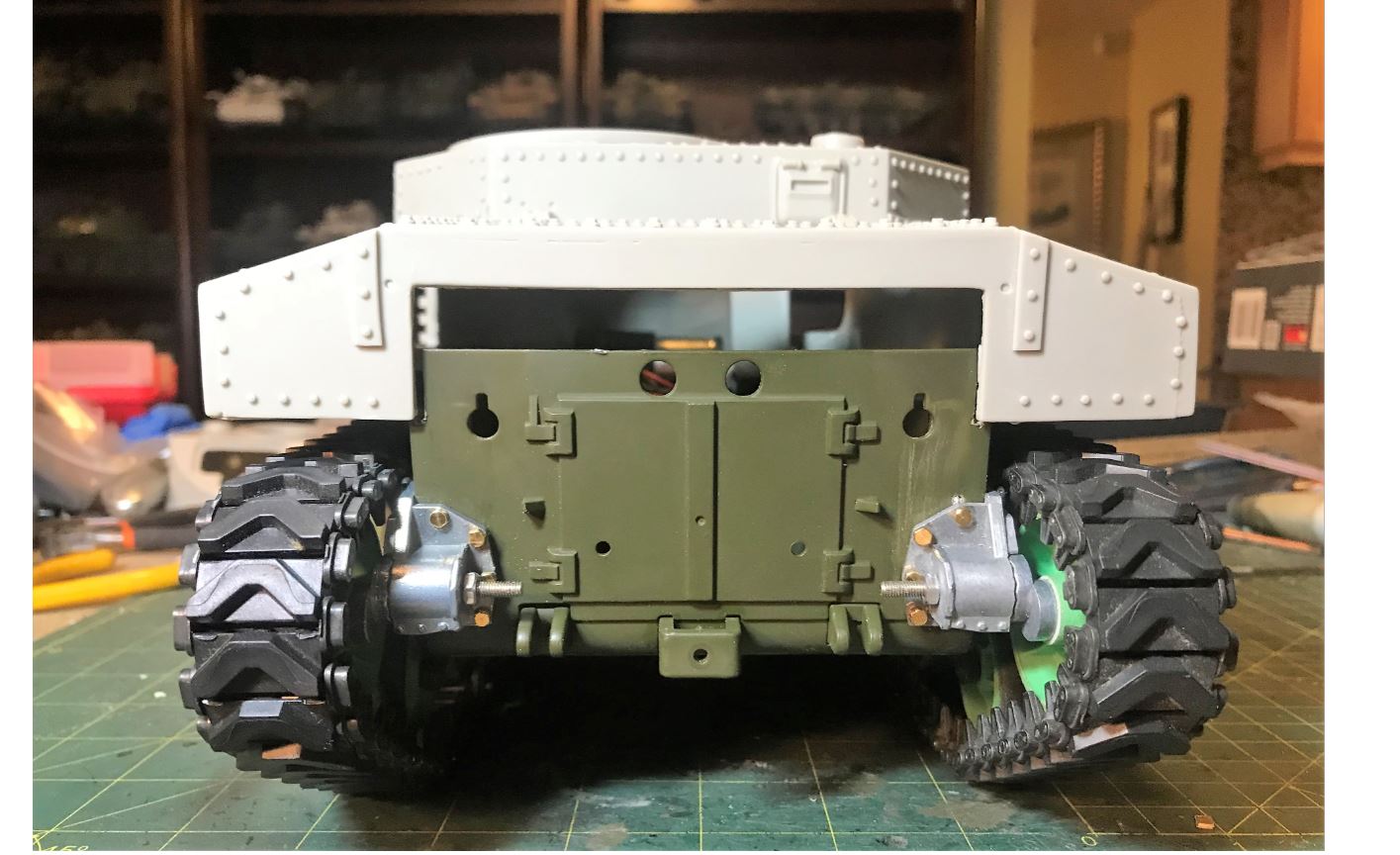

Space for the turret needed to come from somewhere. The upper hull now extends by 5mm towards the rear, 3mm more than before. But this area is covered by the air filters and the armored plates on top, it will not show much. Compared with having a perfectly sized turret, this is the better compromise, a decision the designer should have taken.

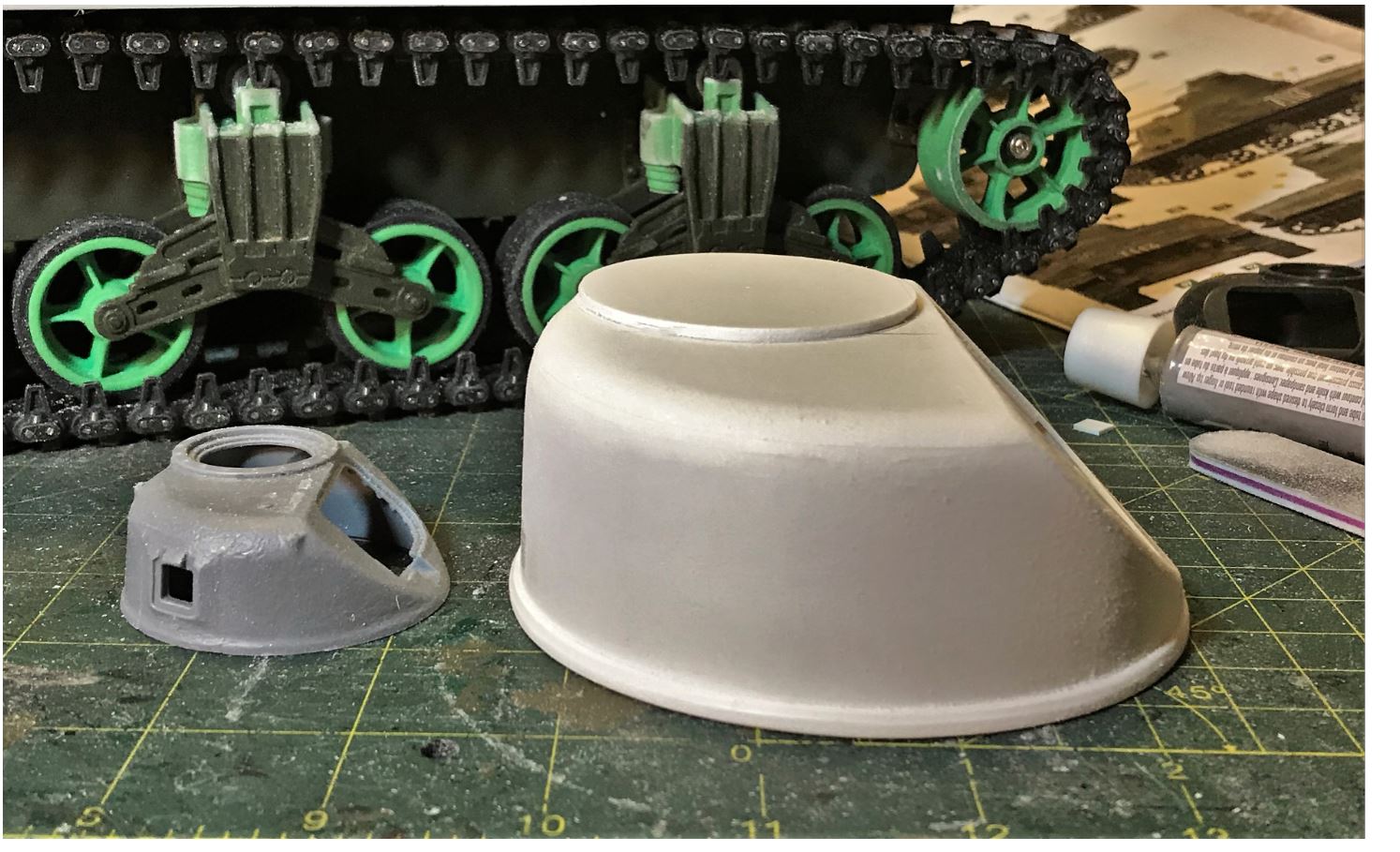

This is comparing the Vandra kit turret to the new ring size of proper dimension, showing how undersized it is. I am surprised that the Americans did not complain much, not that i have heard. Do this to a Tiger turret and there would be an uprising, fresh meat for bloggers who would complain for months.

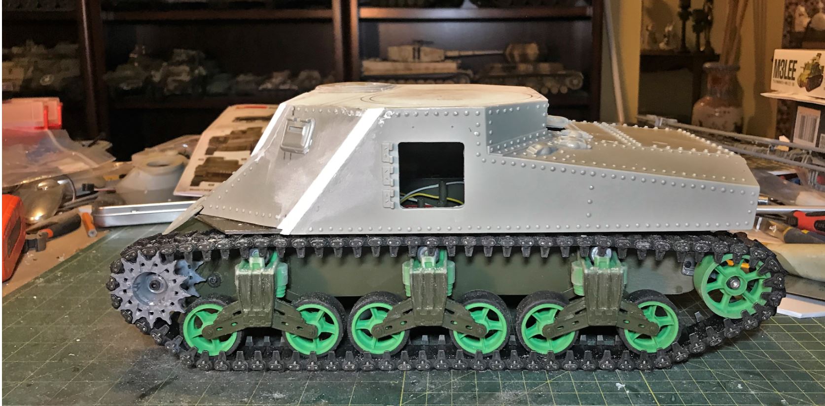

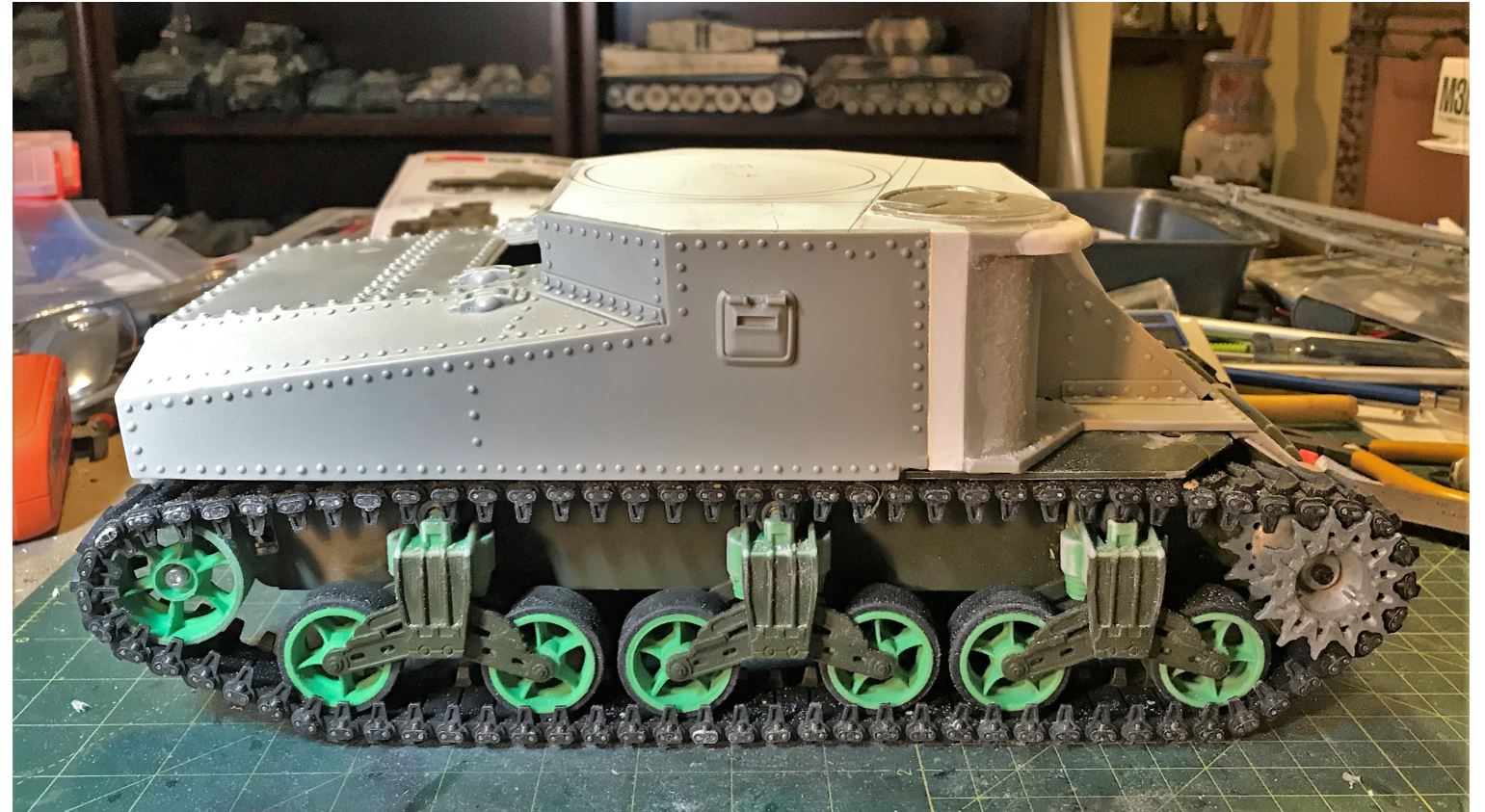

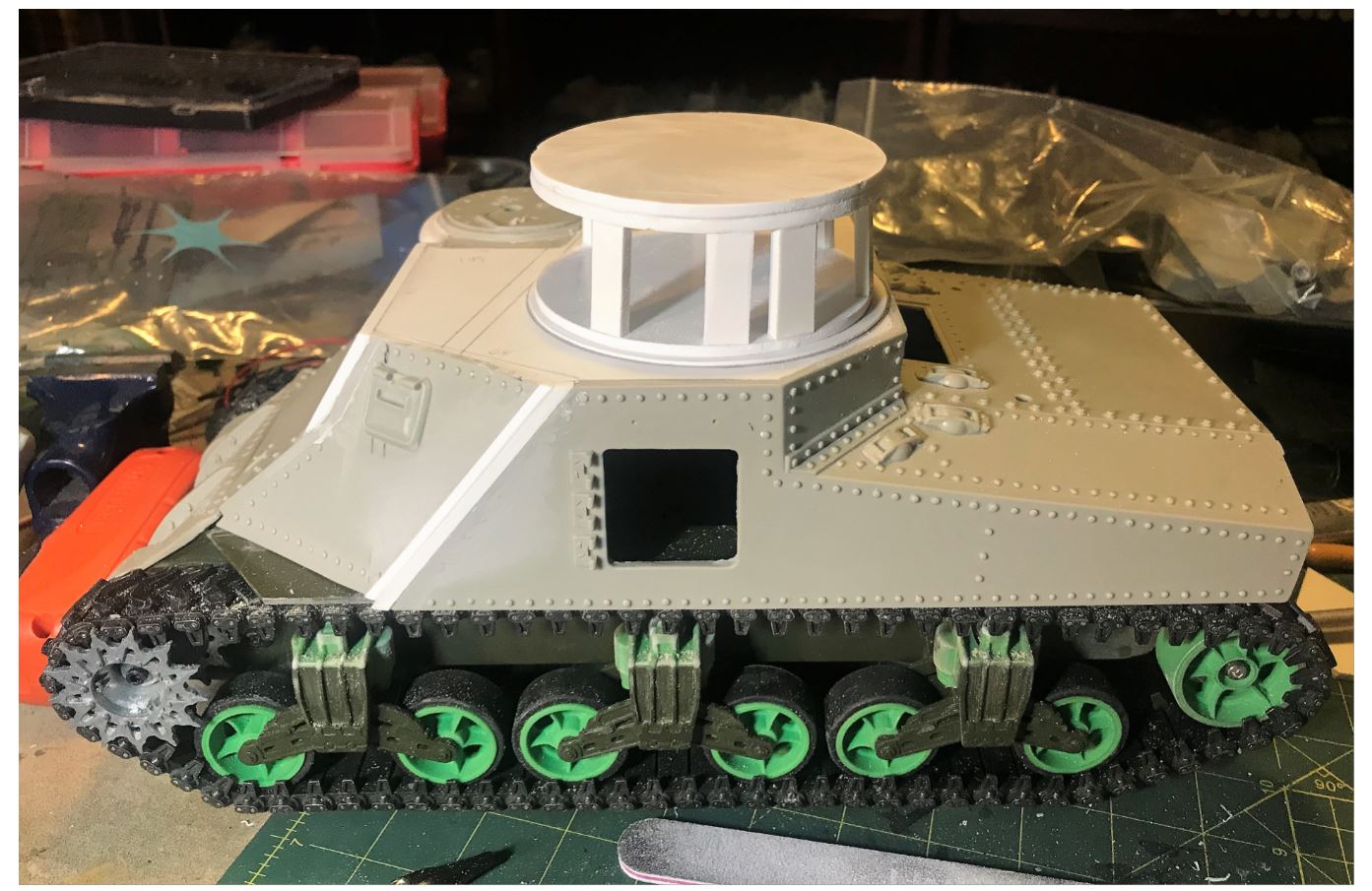

This is the model as it stands today.

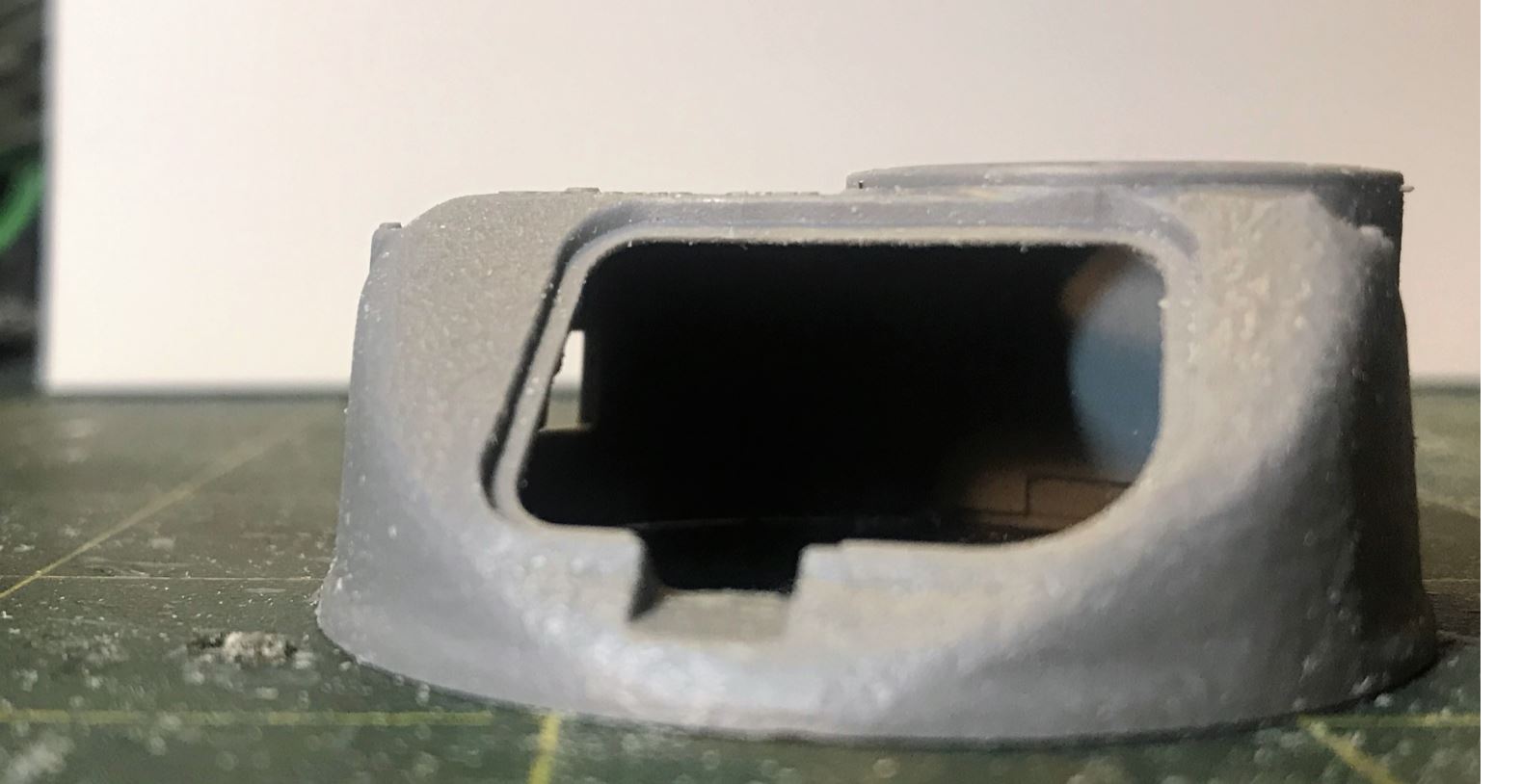

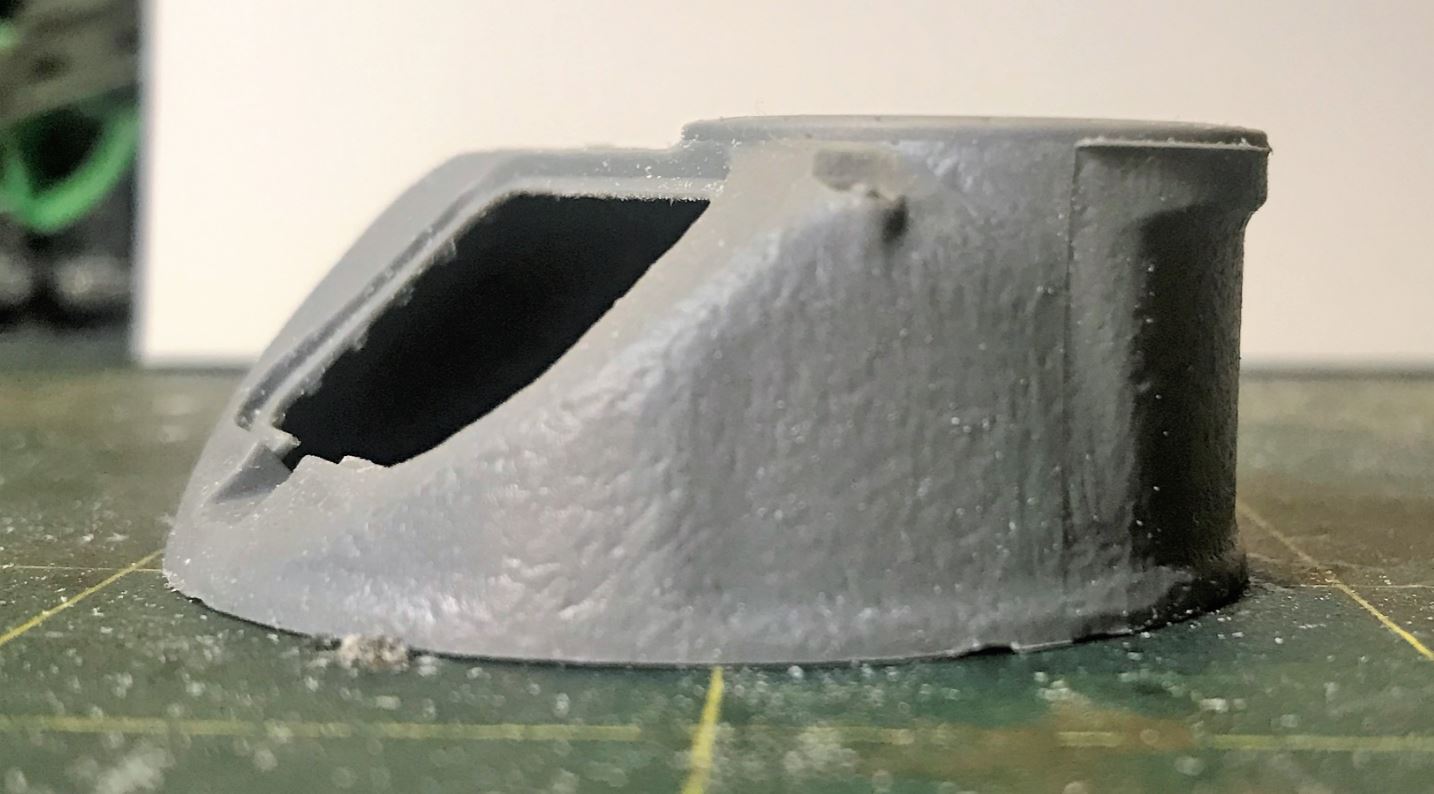

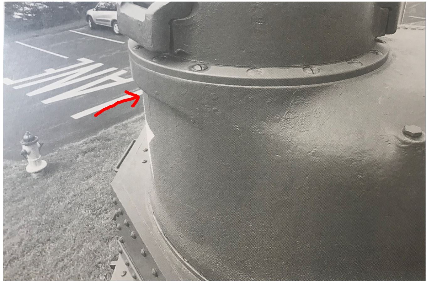

I did study the Miniart turret. The turret is not cylindrical, it has a small slope going down from the top in most areas.
However, under the cupula, the turret is fully vertical.

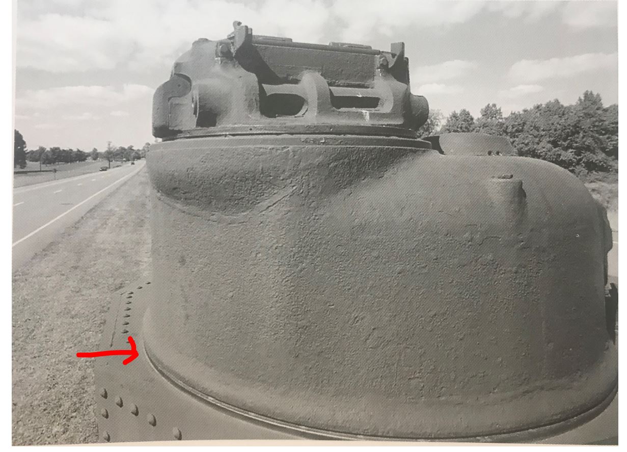

Study of references show that the turret of the early versions is sitting directly on top of the hull turret ring, not inside but directly on top. Vandra is correctly showing a late model outer ring that i have seen on Prime Portal surviving example.

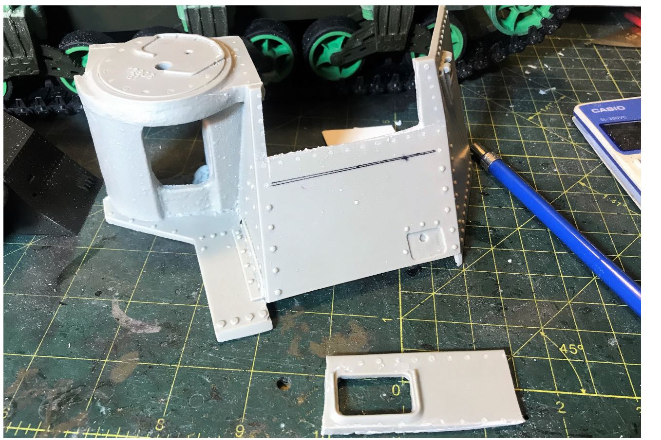

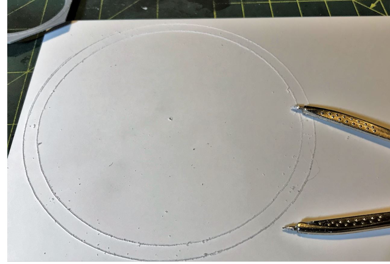

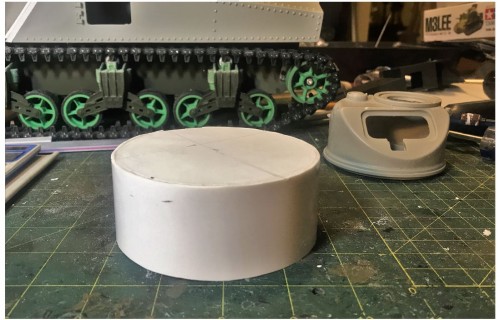

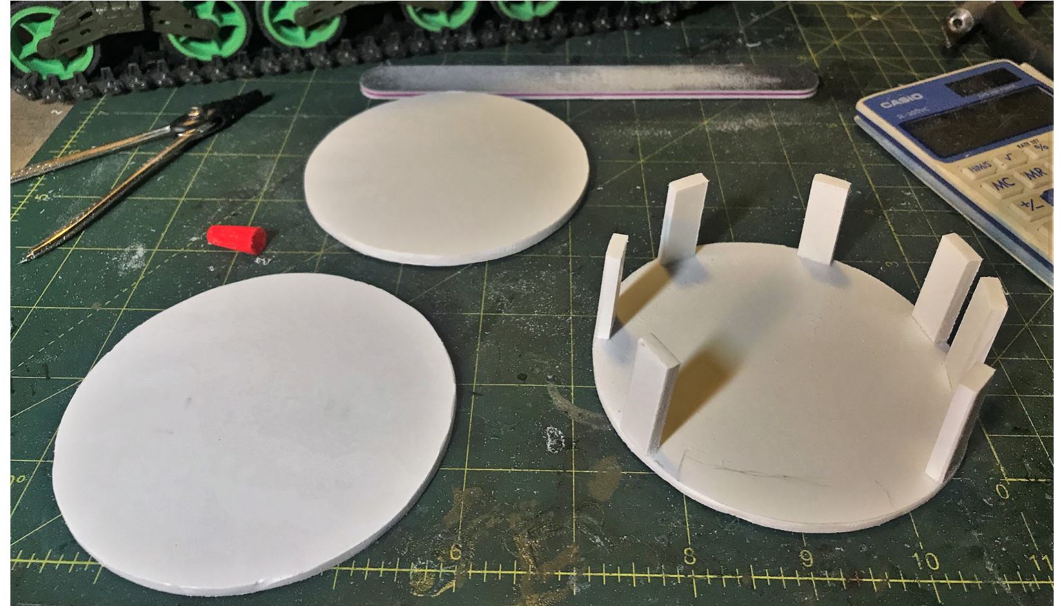

The hull turret ring of 102mm in diameter is made in 1mm plasticard using a simple geometry kit. The plasticard is lightly engraved with the point of the tool in a circular movement, then the plasticard is snapped off the part and sanded smooth. With the number of rings and roundels needed on my builds, i am getting a compass cutter, more efficient.
The ring is positioned on the hull.
The turret body is made to be 102mm in diameter at the bottom and 40mm high. The turret roundels are made to be 98mm wide knowing that the 1mm side armor plate around will add 2mm and the ring at the base is adding another 2mm in diameter, giving a planned total of 102mm. The mounts are given a small slope towards the inside top, except under the cupula.
Checking the situation on the hull before applying the armor plates. Thickness is given to the turret top in order to create a curved shape around it later.

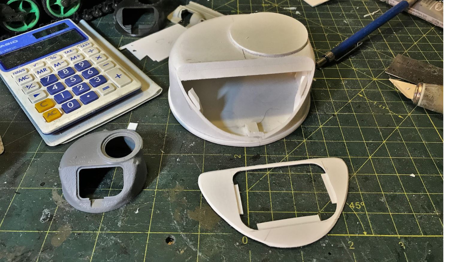

The angle of the armored plate for the gun mount is carefully calculated, cut off with the Dremel and then sanded flat.

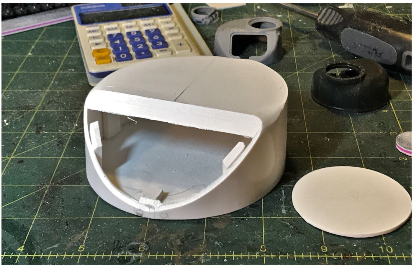

After 30 minutes of sanding, the 1/16 turret body is taking shape and it is starting to resemble its smaller counterpart. Not bad for 2 evenings of work.
Still need some sanding to do to get it right, but i will finish it outside tomorrow. Dust management is starting to become an issue inside the workplace.

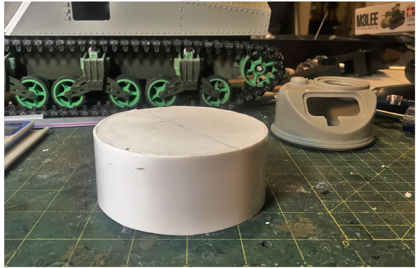

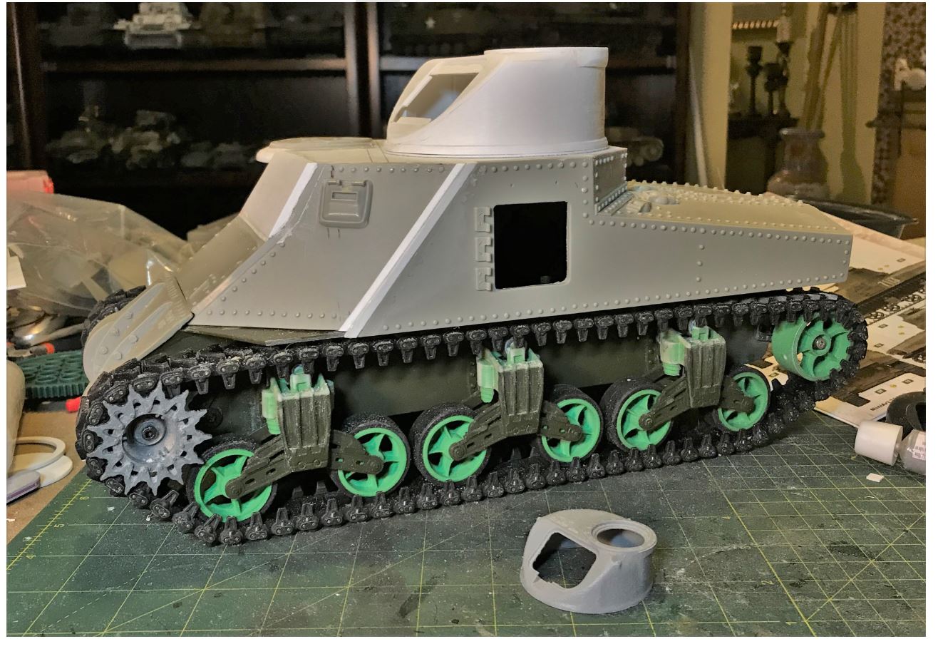

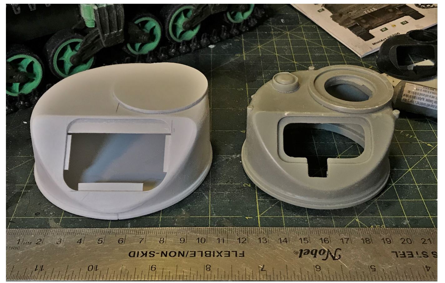

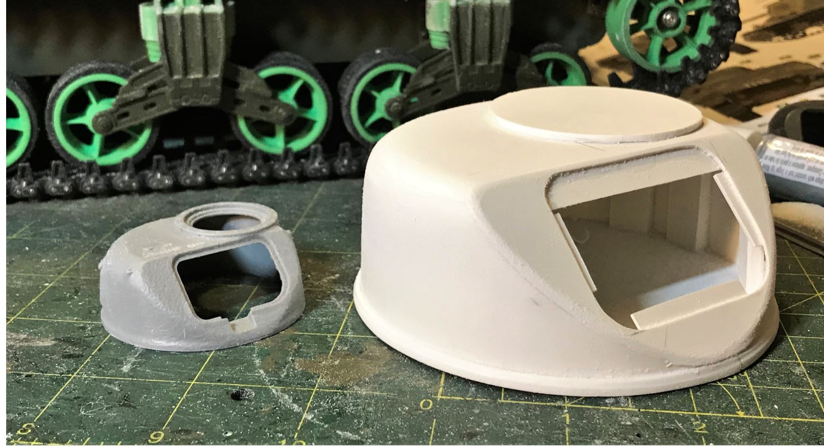

View of the new turret body next to the Vandra kit turret.

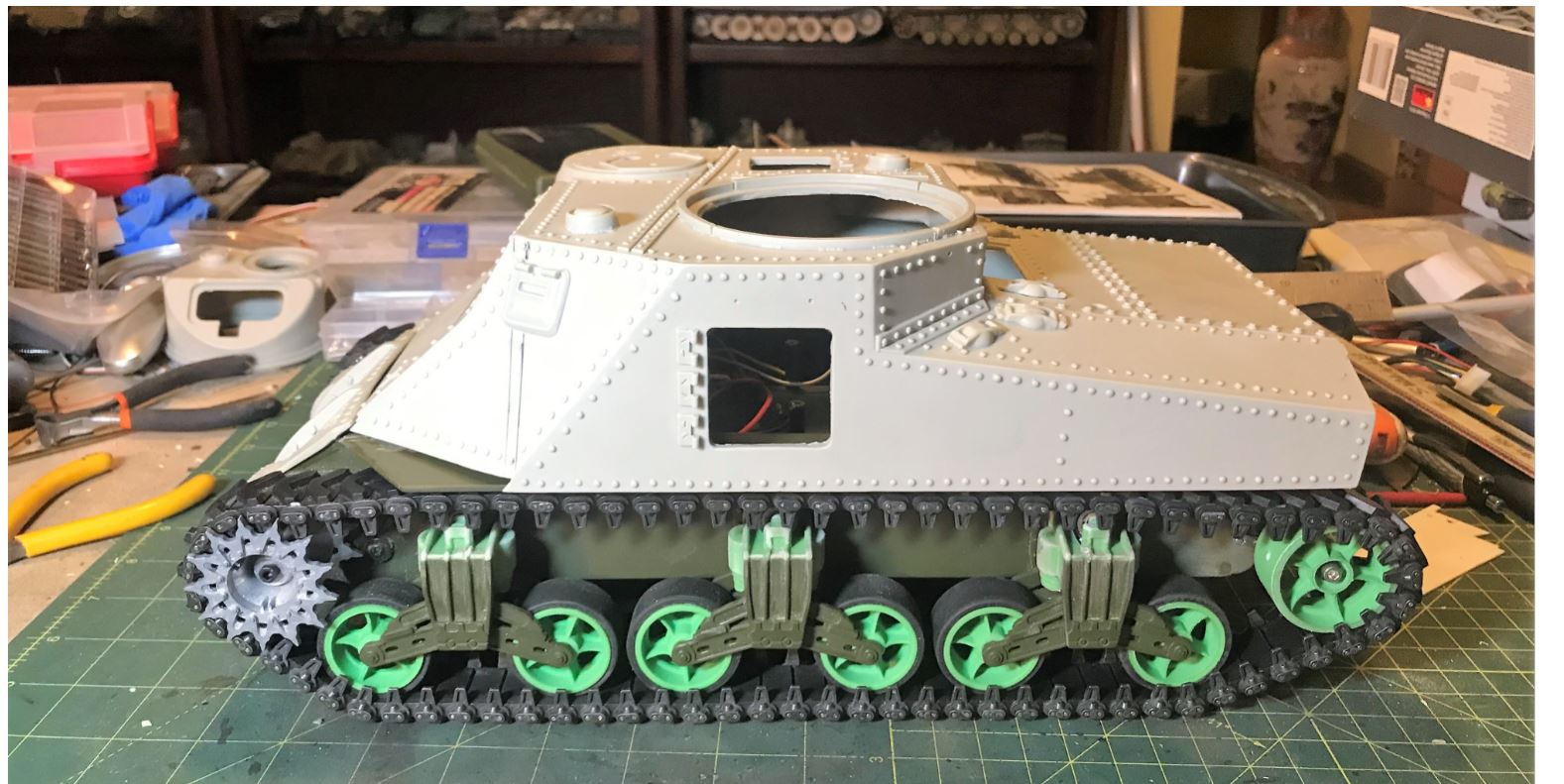

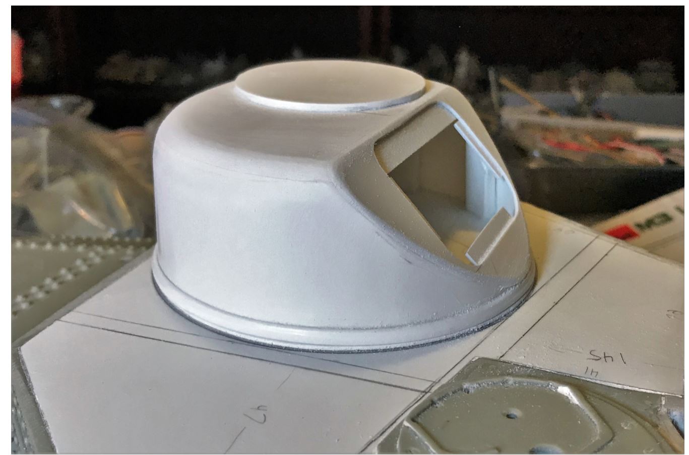

View of the turret body on top of the chassis.
It is refreshing to finally see a 1/16 scale M3 Lee with its turret having the right size and shape. Thank you Miniart for the measurements.
There is so much left to do but i am satisfied with the way the build is going so far. This will be a good looking M3 Lee.
